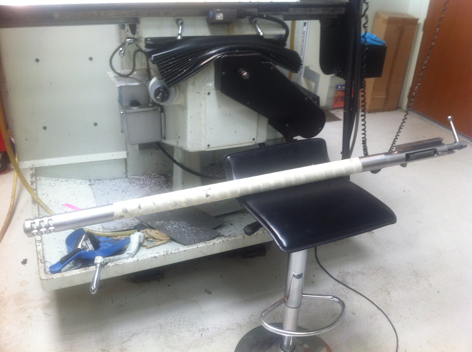

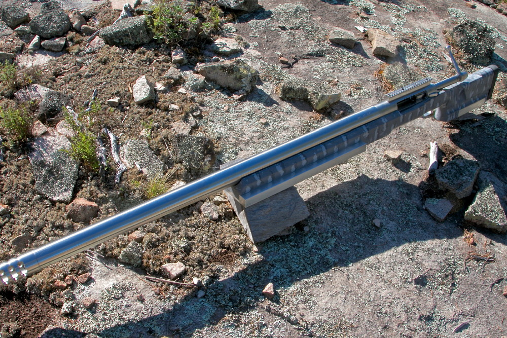

Been a long time between updates but finally the finish line is in sight. Stock is finished and should arrive from MacMillan mid next week ready for final fitting prior to shipping. Phil has kindly made me a custom action wrench and barrel clamp so I can screw it back together when it arrives in Sydney as it's too big for shipping and even disassembled he's knocking up a custom shipping case for me.
Can anyone recommend a good place for Cerakote in Sydney with a quick turn around time?
5 feet of crotch hardening barreled action
The brake, not sure if its resemblance to a sex toy was on purpose or the smith expressing a wicked sense of humor.
Next FCSA Australian competition is in Mildura on the 1st of April....Appropriate date, Clown debuts huge cannon on April Fools...
Next update with pictures and maybe video once I get it home in a few weeks :)

That brake is a little embarrassing..... a smidge phallic ..
But I'd possibly make the trip to Mildura to watch you shoot it... What should i bring? I dont have anything bigger than a 45cal though...

<<Genesis93>> wrote:That brake is a little embarrassing..... a smidge phallic ..
So you see it as well....Since the stock will be grey I might do a grey camo cerakote job on it and name the rifle "50 Shades" :D

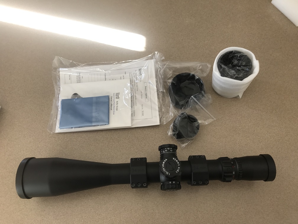

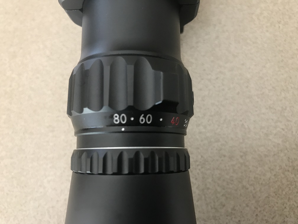

I felt a bit guilty about fitting a S&B PMII 12-50x56 on this rifle as my theme was to use the best of the best on the market. While the S&B is an awesome bit of glass and capable of doing the job it wasn't quiet the "Best" on the market for this class of rifle. I bit the bullet so to speak and purchased a March 8-80x56 tactical with MTR-1 reticule and the clarity blew me away. I set the zoom to 80x and had no difficulty reading parking signs out around 1200m, could probably go much further if I wasn't holding it in my hand.

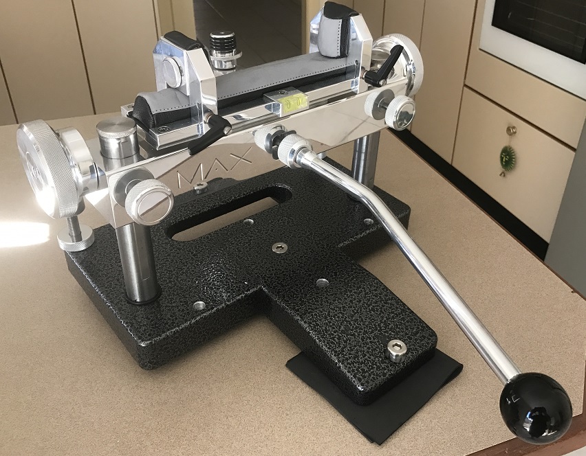

The final big dollar item was a proper rest and I chose the SEB Max coaxial joystick because it'll handle the mass of the rifle with ease. I unboxed the unit on Saturday afternoon only to discover a part was missing. There's a shaft with a set of counter weights on it to balance out the joystick movement when using >25kg rifles. I called the supplier this morning and was promised a call back in 10 mins, 4 hours later I called them. Apparently I have to wait till they check with the manufacturer to see if that part should be included. They checked a few other boxes and the counter weight is there, it's clearly stated as included in the manual and the advertisement so I fail to see why it's now my problem that it's missing.
The SEB rest is a work of machining artwork, pure precision and right up there with the best of the best of F-Class rifle rests. I have to wait till tomorrow now to see what the boss has to say so hopefully he'll put the customer first and send me one from another box. Worse case is they dick me around and i'm up for a long wait for the manufacturer to sort it out.
Finally, the stock is in the country and the smith has filed the paperwork to get it released from customs. I'm hoping for it to be released in the next day or so and the final work can be done before shipping back to Sydney next week.
Photo's....cause we all know it's B.S without pictures :)
SEB Max Coaxial Joy stick rest
What's in the box - Scope, Flip up covers. Mirage hood, Manual and cleaning cloth.
Mount just temp fitted till I get the rifle as I'll need to set proper eye relief.
Yep...80x which is better then my 60x spotting scope
