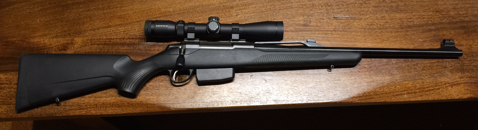

over size bolt handle is a must have for 30-06 especially for blue barrel and composite stock, it feels even lighter than the original one

Very nice gun, I reckon that the Tikka sights are some of the best iron sights out there, what do you think of the scope?

tikka battue's iron sight is a little too thick(good thing is easy to see at low light) but still can blow the soft drink can at about 25 meters easily
2-7x33 or 3-9x40 scope looks alright on it and works fine

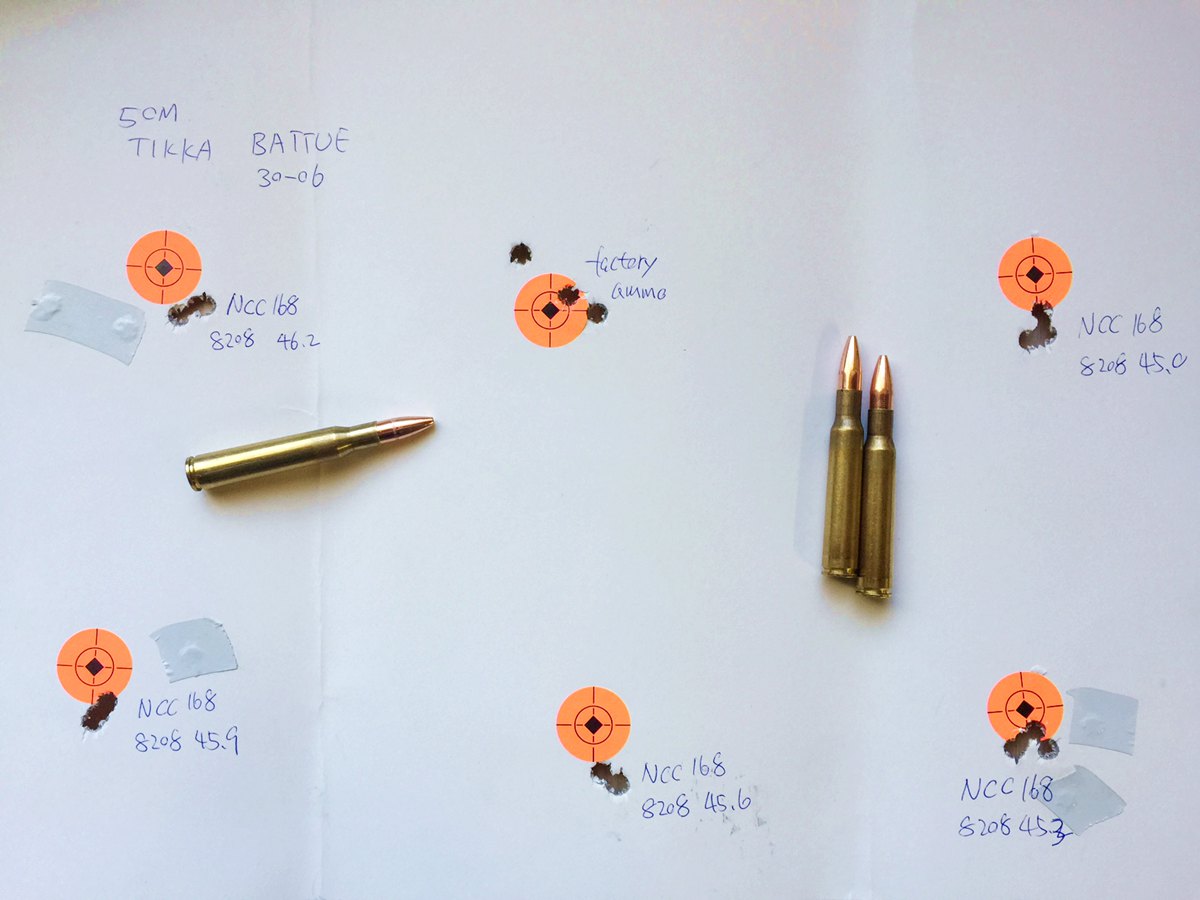

try to find the best charge for it but 50 meter shooting range is not good enough, looks like 45.8gr is good

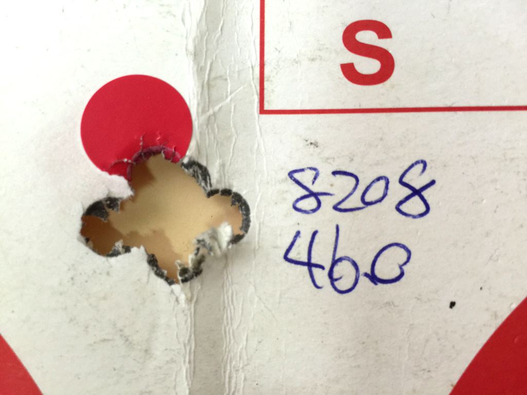

Re: tikka battue T3X 30-06
Post by SHV » 28 Sep 2017, 7:28 pm
Hornady Z-max 168gr projectile, Bench Mark 8208 46.0gr powder, OAL 3.340 CCI primer, tried few times, always good resorts, 50 meters 5x

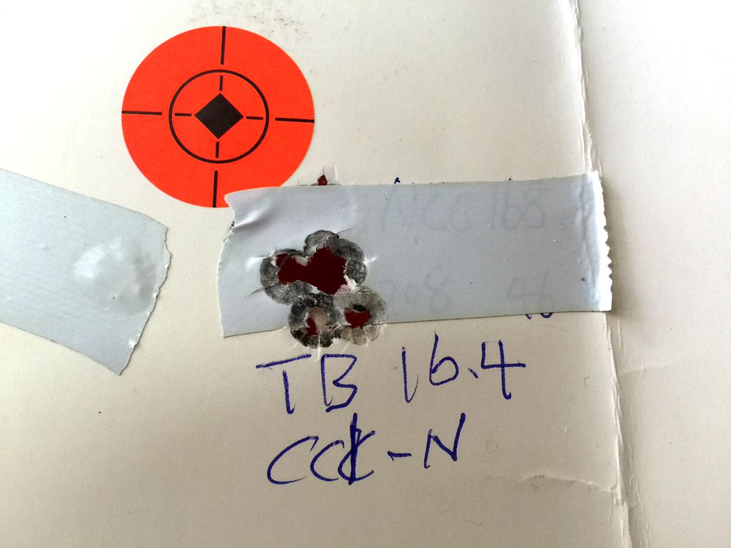

TBF 150gr projectile, Trail Boss 16.4gr powder, CCI normal large rifle primer (my mistake, forgot to charge to magnum primer) OAL 3.185, surprisingly good :lol:
50 meters 5x

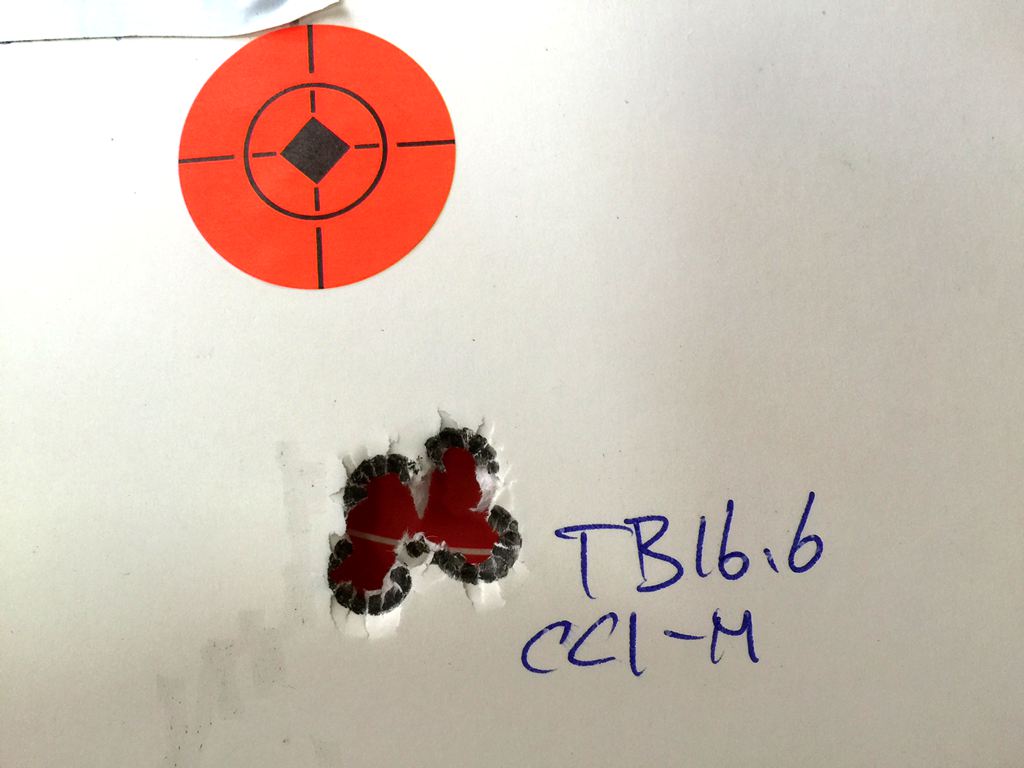

Post by SHV » 28 Sep 2017, 7:37 pm
TBF 150gr projectile, Trail Boss 16.6gr powder, CCI magnum primer, OAL 3.185
50 meters 5x

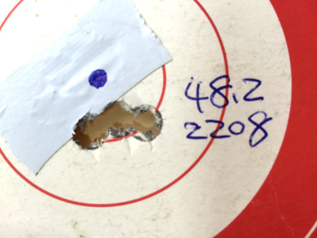

a friend gave me 3.5kg 2208 and the TBF 150 projectile seems no supply issue, so give them a try
this is 3 shot, looks ok, will try 5 shot to double check
150gr TBF projectile, 48.2gr AR2208 CCI primer OAL 3.185

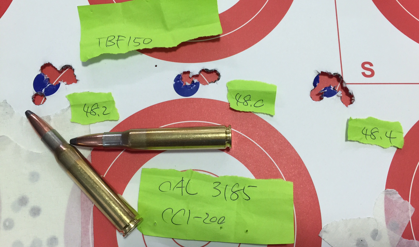

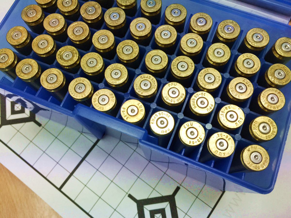

Post by SHV » 21 Jan 2018, 3:48 pm
48.0 48.2 48.4gr AR2208 150gr TBF projectile CCI-200 primerm, PPU once fired casse
looks like 48gr is the best, one away from the main group, could be me

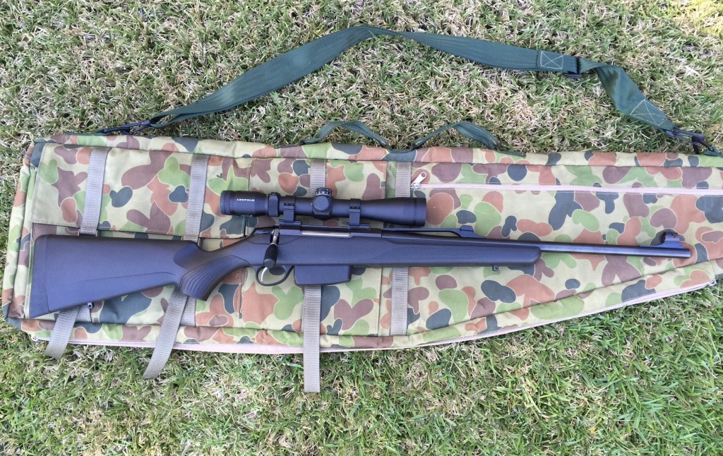

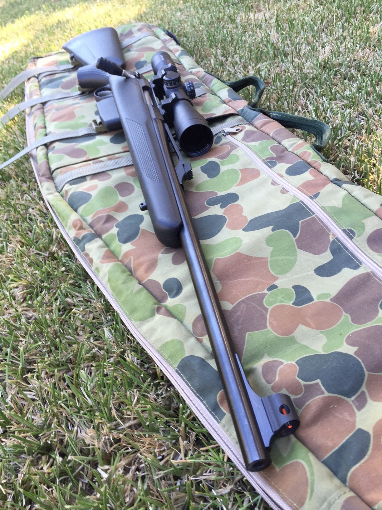

Post by SHV » 29 Jan 2018, 2:10 pm

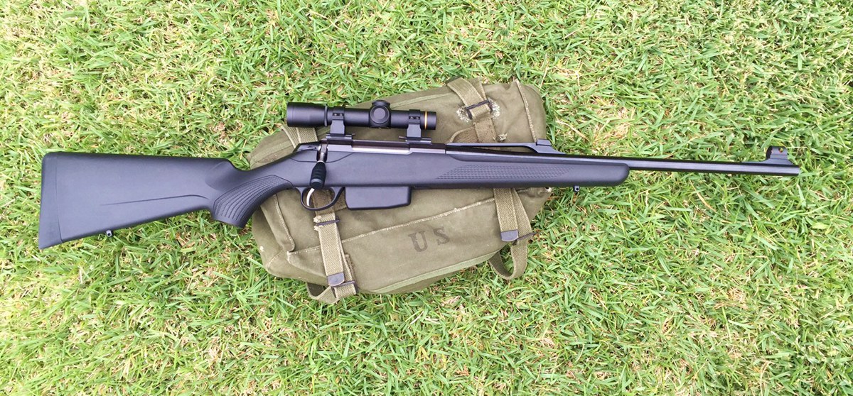

new short/light scope for pig hunting Leupold FX-II 2.5X20
FullSizeRender (16)_副本.jpg (331.97 KiB) Viewed 49207 times

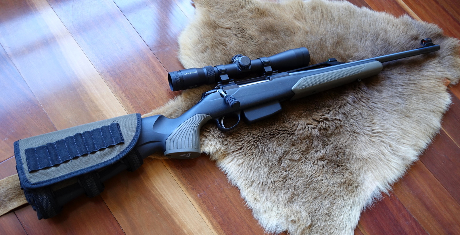

Post by SHV » 05 Aug 2018, 11:22 am

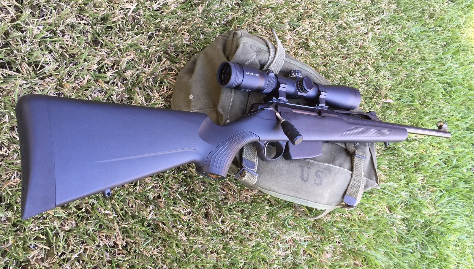

“new” battue
