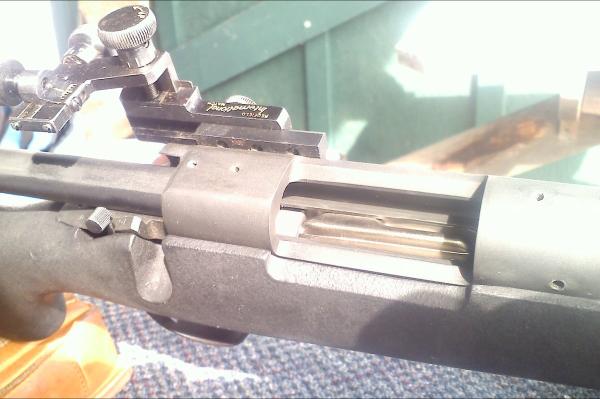

BTW does anyone know what brand sight this is?:

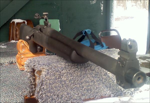

This is very similar to the setup I'm aiming for, only I'd prefer a properly dovetailed front sight:
Re: 300blk Howa Crossover Rifle
Post by bladeracer » 19 Jan 2017, 12:15 pm
in2anity wrote:BTW does anyone know what brand sight this is?:
No, but there are a number of manufacturers of peep sights - have a look at Brownells.com.au.
The front sight is possibly done that way so the barrel doesn't need a new dovetail cut every time the chamber is recut or the barrel replaced.
Post by Gamerancher » 19 Jan 2017, 1:15 pm
Yes, as is written on the sight, Redfield. Type / model is International. They are a match grade sight with positive click adjustments for both elevation and windage, made in U.S.A.

Post by in2anity » 19 Jan 2017, 1:26 pm
Gamerancher wrote:Yes, as is written on the sight, Redfield. Type / model is International. They are a match grade sight with positive click adjustments for both elevation and windage, made in U.S.A..
I'm impressed :clap: How about the attachment on the side - do you know what the official name for that piece is?
Post by Gamerancher » 19 Jan 2017, 1:42 pm
Come on, bit of tongue in cheek. Damn, I forgot the sarcasm thingy again.
Seriously though, that is what it is and the attachment on the side is part of the sight. They make the sight and then basically an adapter for different brands/models of rifles. The Redfield 75 is a similar sight made for flat sided lever actions. They are very sought after in my sport and getting harder to come by. There is also their "Olympic" and "Palma" sights that are similar to the one in your pics.
Front sight?
