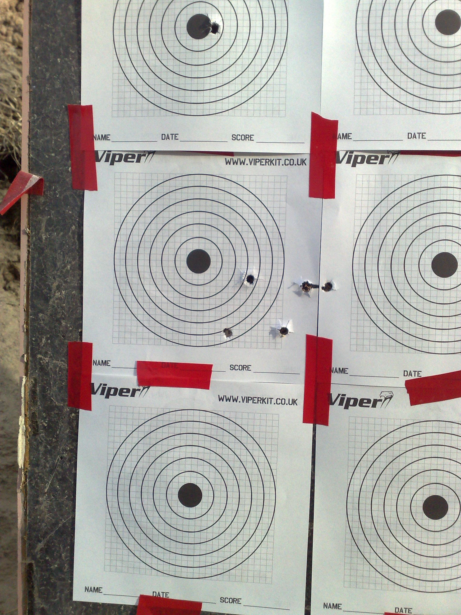

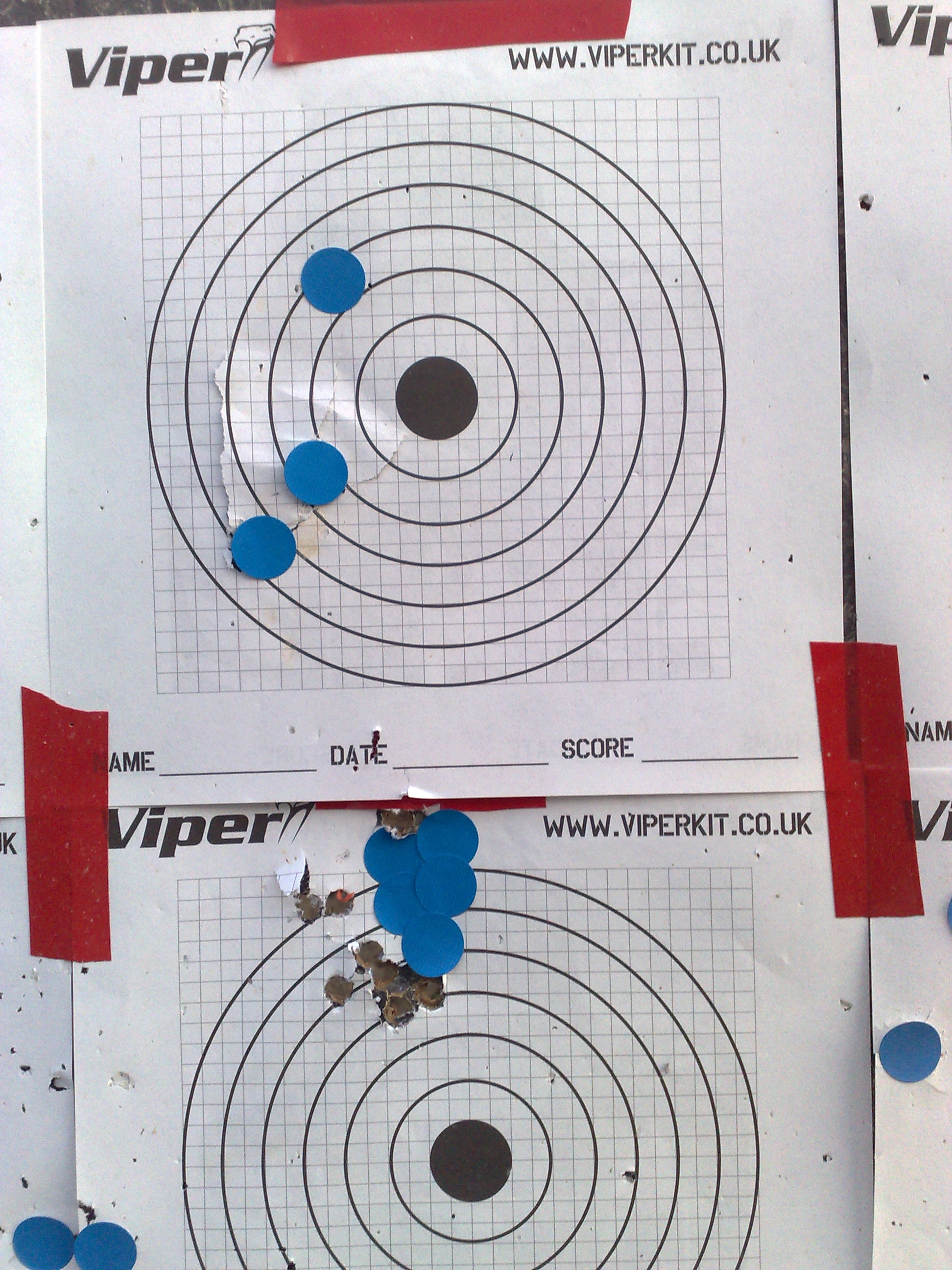

Post by bladeracer » 25 Apr 2017, 6:04 pm
duncan61 wrote:I will have to find what the barrel twist is in the Ruger as it claims that the 107 will not stabilise in less than 1.8.It has been run in and cleaned correctly
Ruger American .243 is 9" twist.
I have some 105's to test in my Predator, if they work then I'll try 107 and 108.
No running in, but after 40rds had been put through the barrel, my brother, who has done next to no shooting at all for the last thirty years, put five rounds with 58gn VMax on 12gn of Trailboss into 20mm yesterday at 100m. And I discovered last night while cleaning his rifle that he hadn't done up the scope rings on the rail - the scope was sliding backwards and forwards :-)
Running at 2040fps these will be a great cheap load I think. Trailboss 8gn up to 12gns all run around the 2040-ish mark, but the 12gn load was the most accurate and the neatest groups. This is basically a .22WMR load with a 50%-heavier bullet. 100m zero gives 20mm high at 50m and 110mm low at 150m, at 140m it drops below 1600fps.
These were aimed at the target above and dropped about 180mm below his zero with Federal 75gn HP factory ammo making 3240fps. I wish we had actually dialed the scope up to his point of aim to remove cant from his effort, he might've done even better. In comparison, the Federal factory stuff holds 5rds under 2MoA at 100m in both our Predators. A few weeks back I put four rounds of the Feds through mine in the MDT chassis to zero it - the first four rounds that went down the tube, then put him on it at 50m and he put the next five into 22.7mm, with four of them covering 16.8mm.
