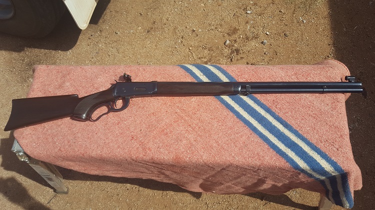

Post by wrenchman » 28 Oct 2017, 9:01 am

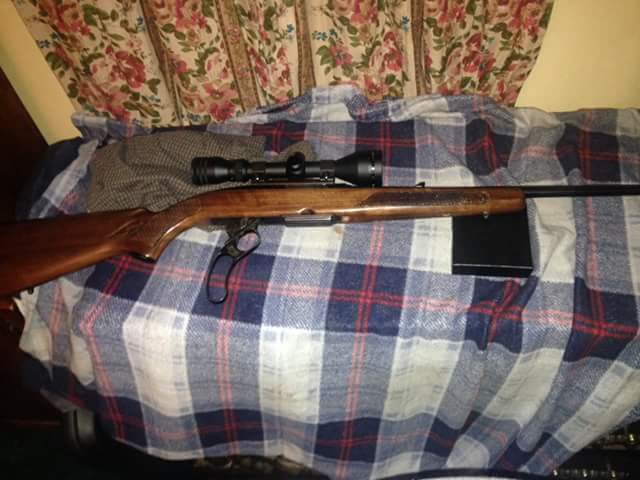

here is a old model 88 in 308 i dont shoot it much i dont no why becouse it does shoot nice

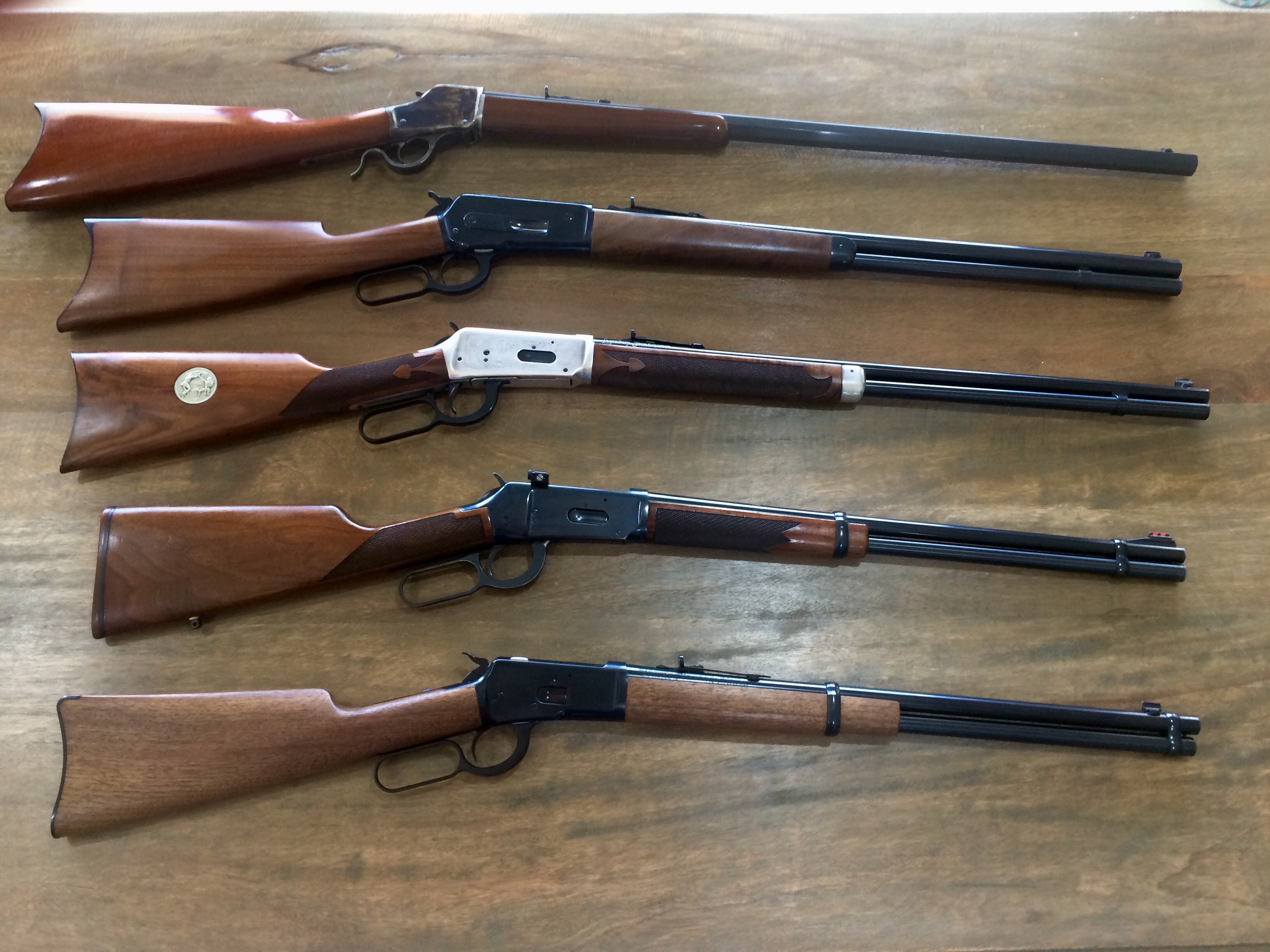

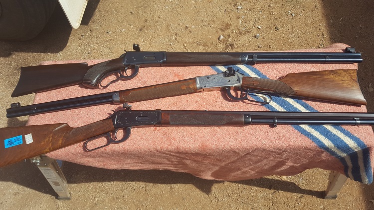

Photos...I forgot the photos! Here ya go.
38-55 Deluxe.jpg (188.17 KiB) Viewed 7266 times
Deluxe 2.jpg (172.54 KiB) Viewed 7266 times
Thre of a kind.jpg (189.81 KiB) Viewed 7266 times
Top one is the 1915 made Deluxe
Middle one is a Legendary Frontiersman, late1980's vintage.
Bottom is a 1960's 1894 Classic that was originally a .30-30 but was re- bored and chambered to .38-55 by none other than Mr P.O.Ackley himself.
All get used for lever-gun silhouette and all have been used to hunt with.

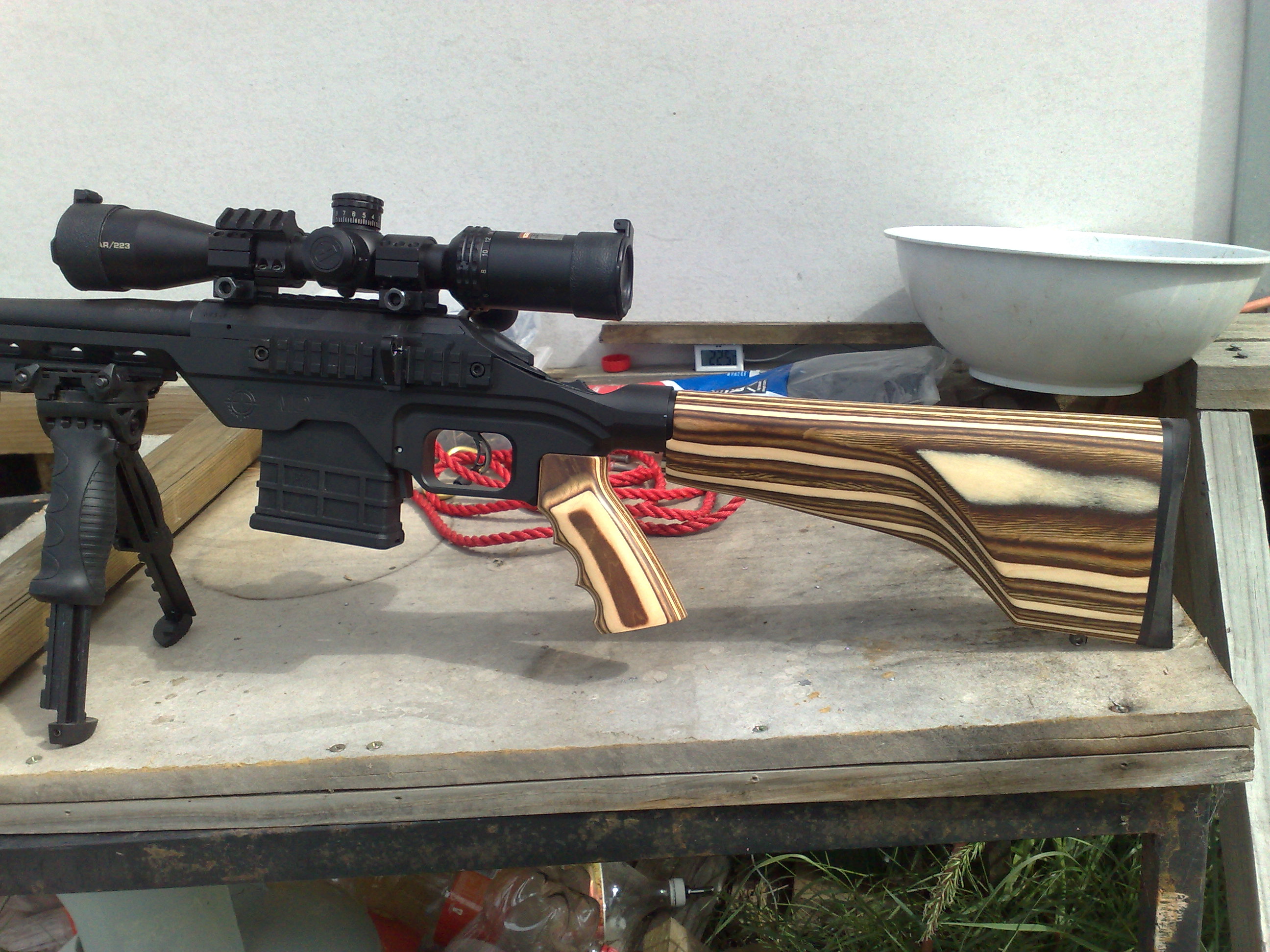

On a side note, my high-power metallic silhouette build came together recently Gamerancher check it out:
Tikka CTR 308w, 6.5-20 lewie on top; absolute f*****g tack driver that balances beautifully on your thumb and index finger underneath the box-magazine (@4.1kg). It shoots way better than I can :shock:
