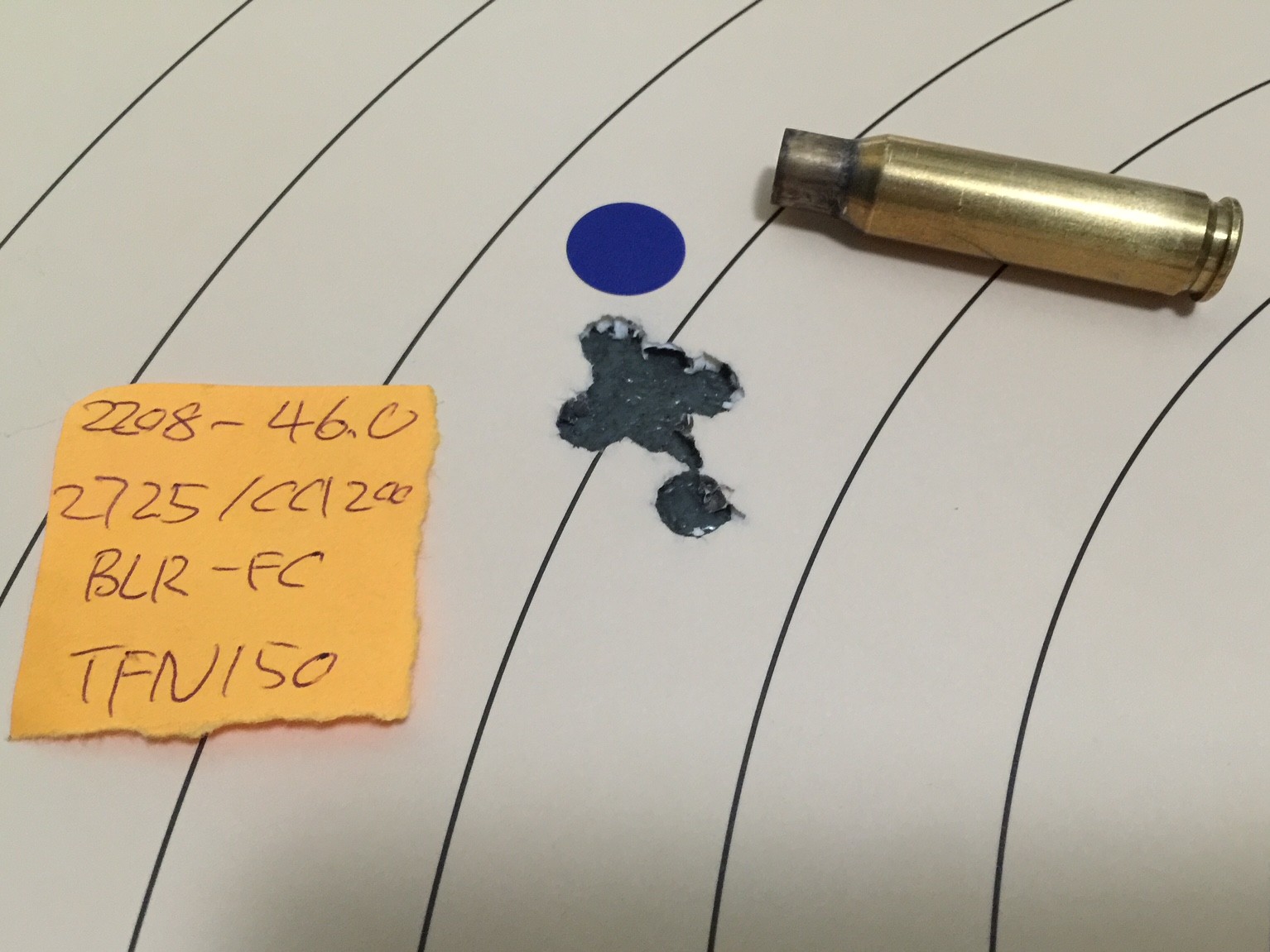

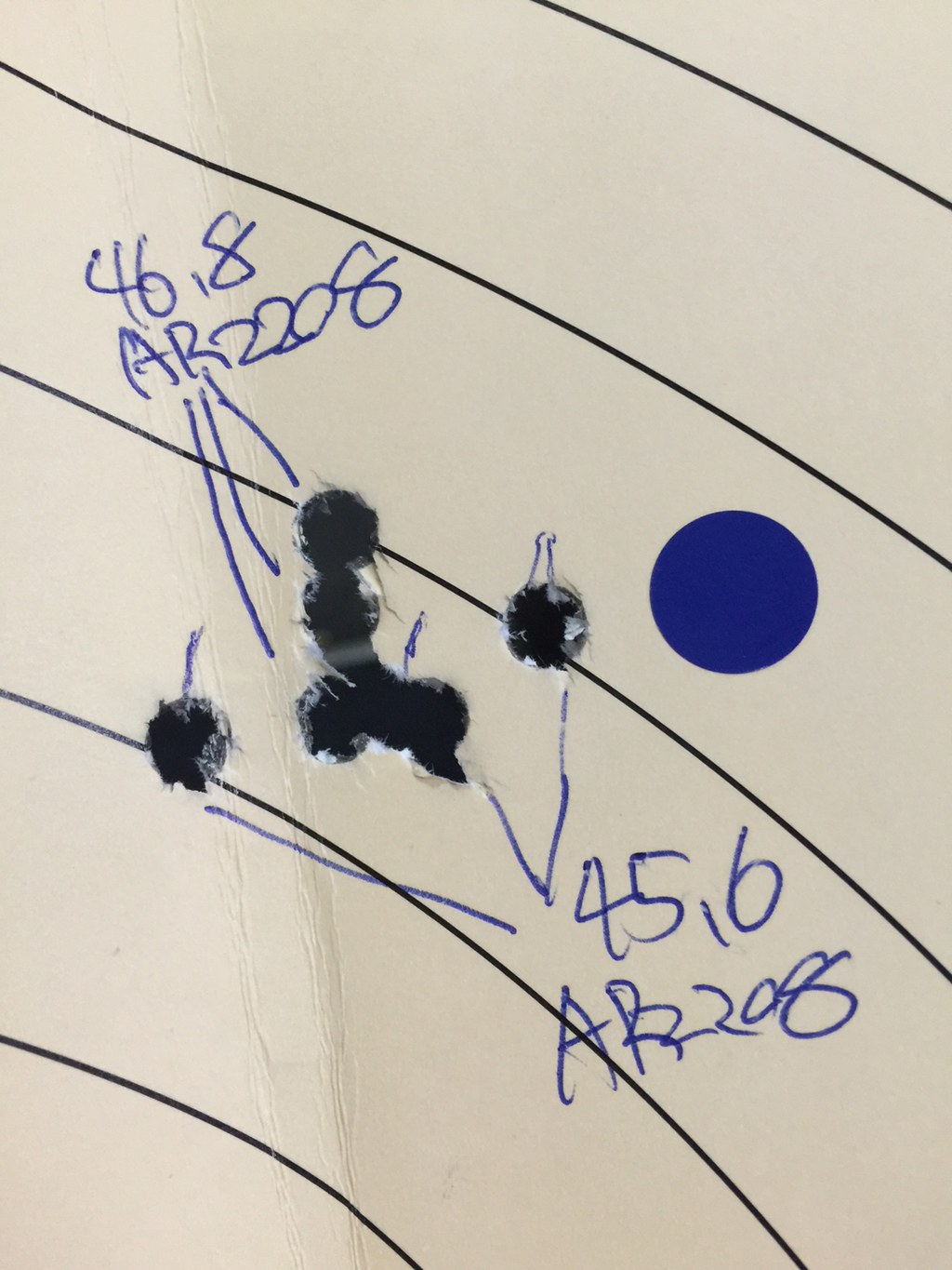

Post by SHV » 16 Nov 2017, 9:29 am

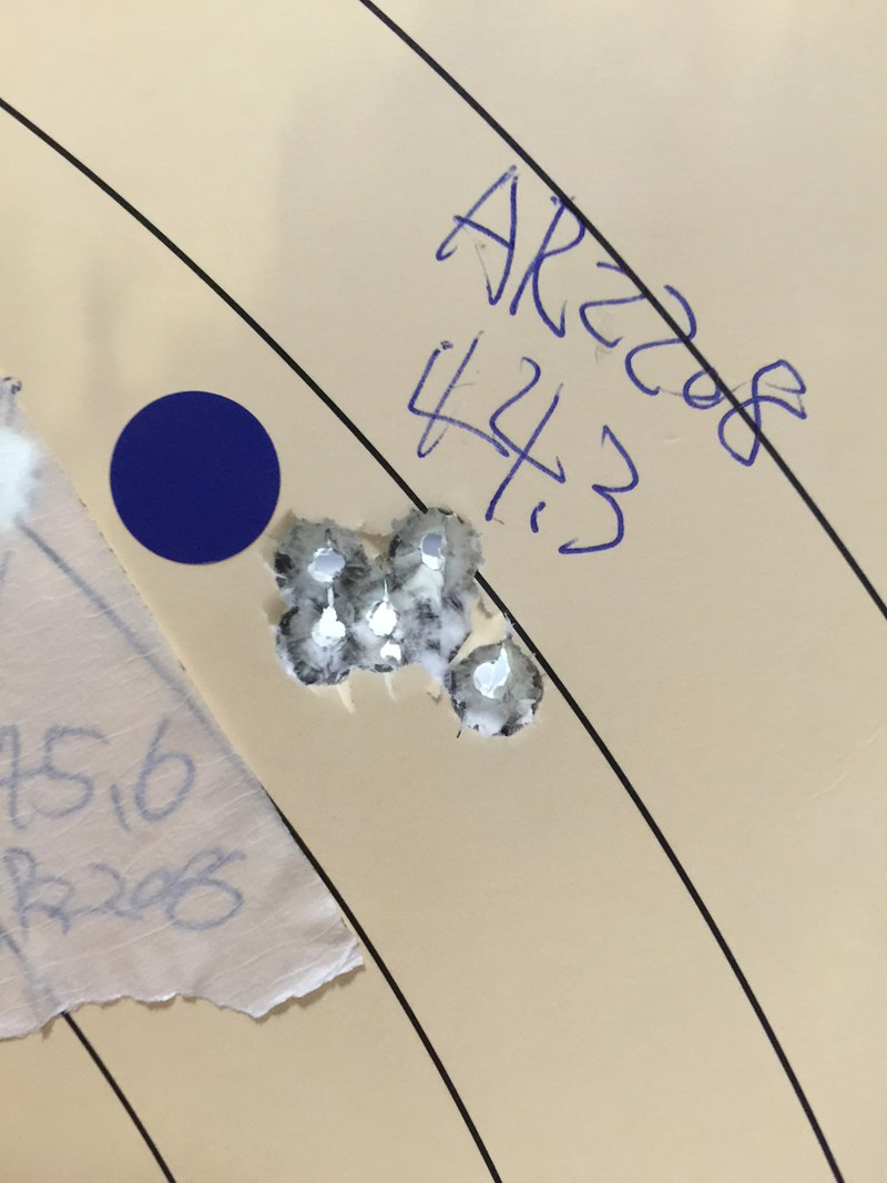

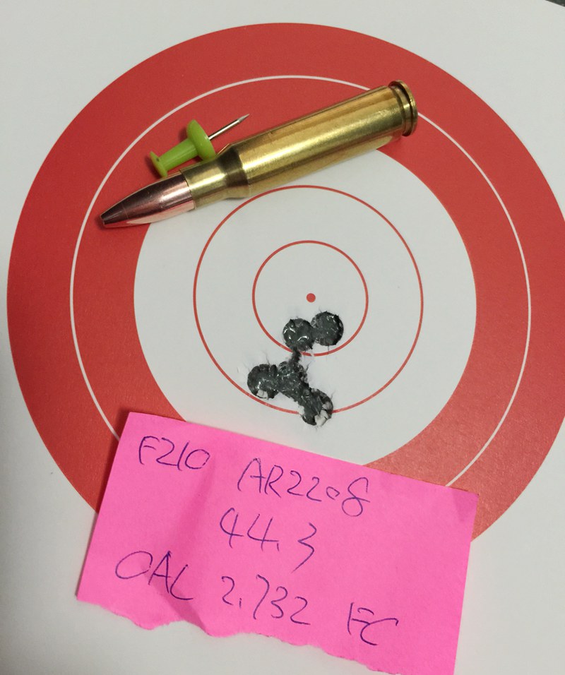

more ammo test, some 3 shot groups, looks better than factory ammo, need further test
maybe will try 46.6 46.2 45.8 5x groups
SHV
Posts: 1780
Re: New Toy, BLR Lightweight ‘81 Hog Stalker Takedown 308W
Post by SHV » 16 Nov 2017, 9:31 am
44.0 and lower are not good, 44.3 looks nearly the best low end point, next time will try 44.3 and 44.5 to find out
SHV
Posts: 1780
Post by Wm.Traynor » 16 Nov 2017, 2:13 pm
Your 5 shot group of 45.6 grains looks pretty good. Opened up a bit on the 3 shot groups, that's all. And the charge isn't too hot either :thumbsup: so extraction should be easy.

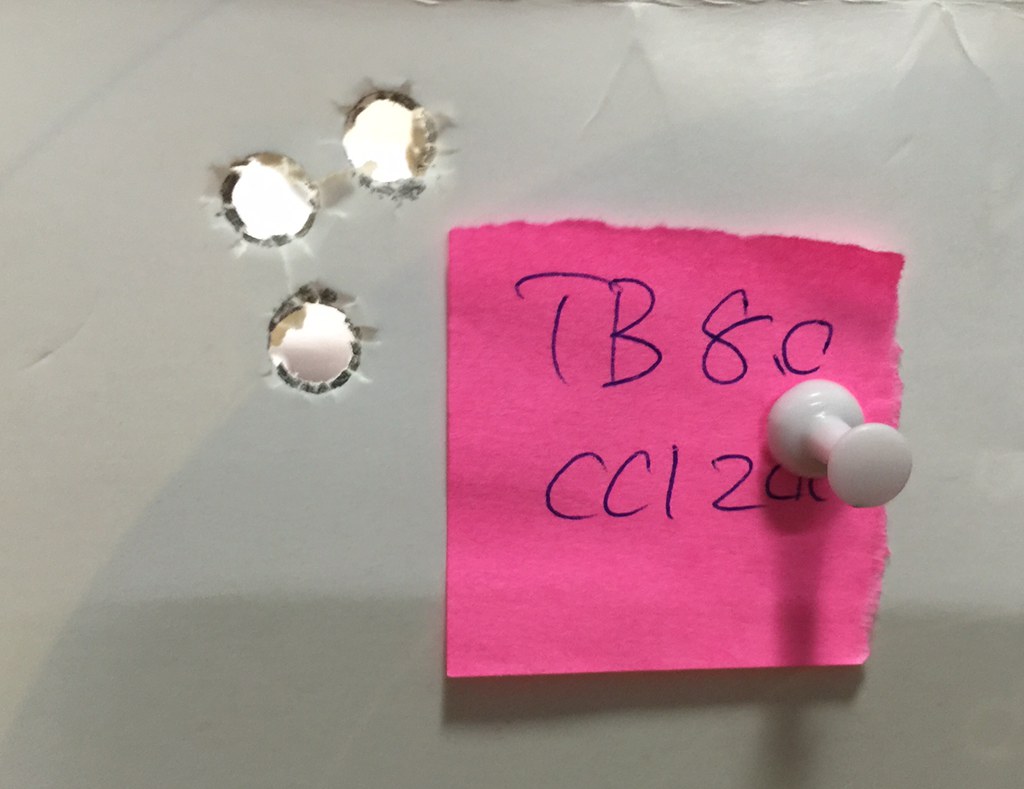

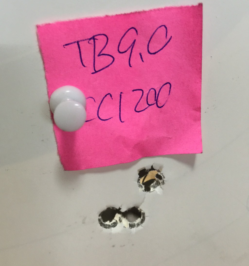

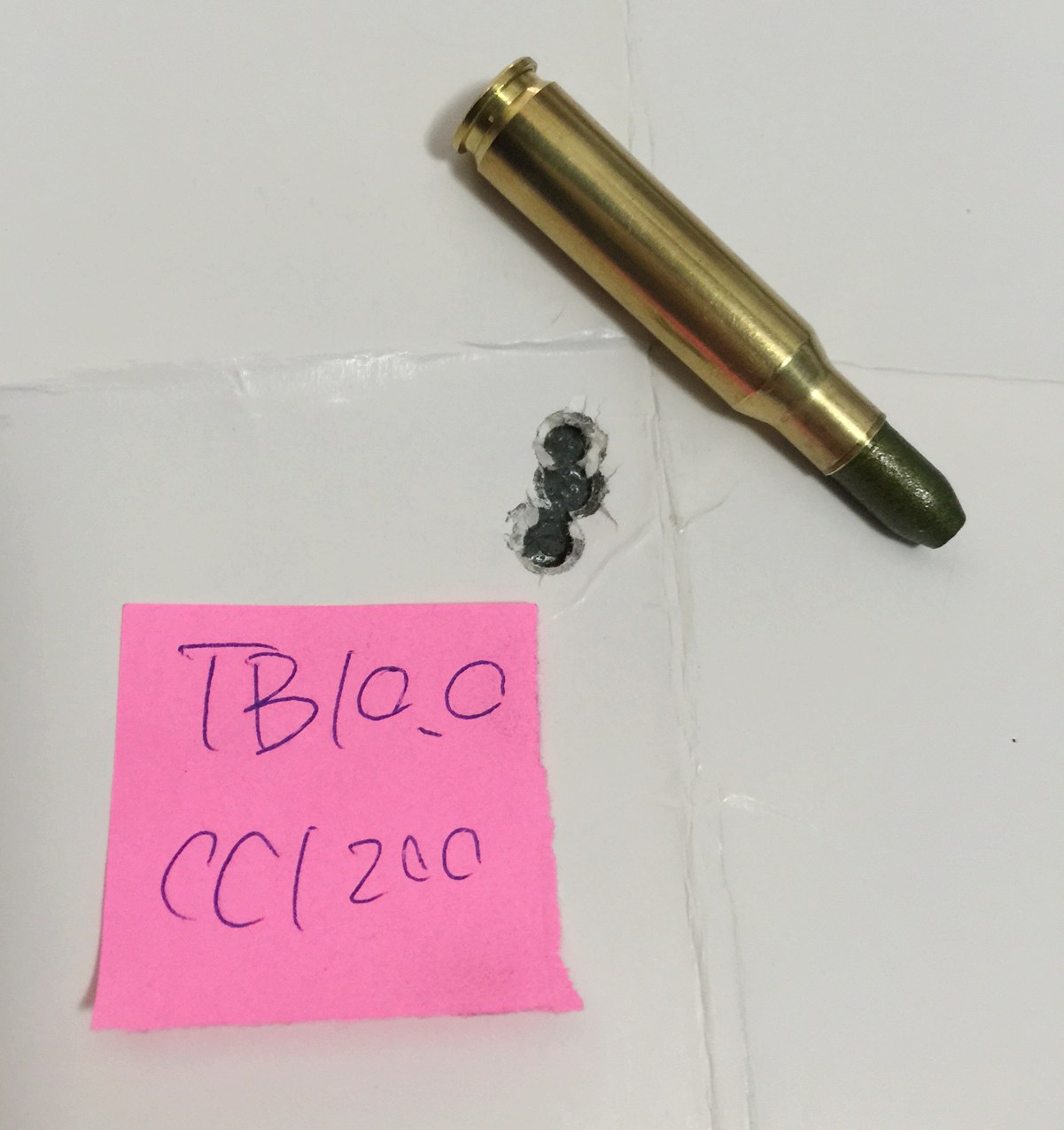

Post by SHV » 23 Nov 2017, 10:06 am
tried TB with lead bullet 4-14x56 scope, CCI primer No. 200, 50 meters indoor, benchrest and rear bag, looks around 10gr is the best
SHV
Posts: 1780
Post by in2anity » 23 Nov 2017, 11:35 am
Groups a little tighter than ye-olde thudy-thudy doesn't it! :thumbsup:
Post by SHV » 23 Nov 2017, 12:49 pm
in2anity wrote:Groups a little tighter than ye-olde thudy-thudy doesn't it! :thumbsup:
This is scoped, next time try 9.8, 10.0 and 10.2 TB :lol:

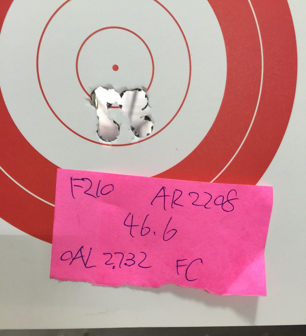

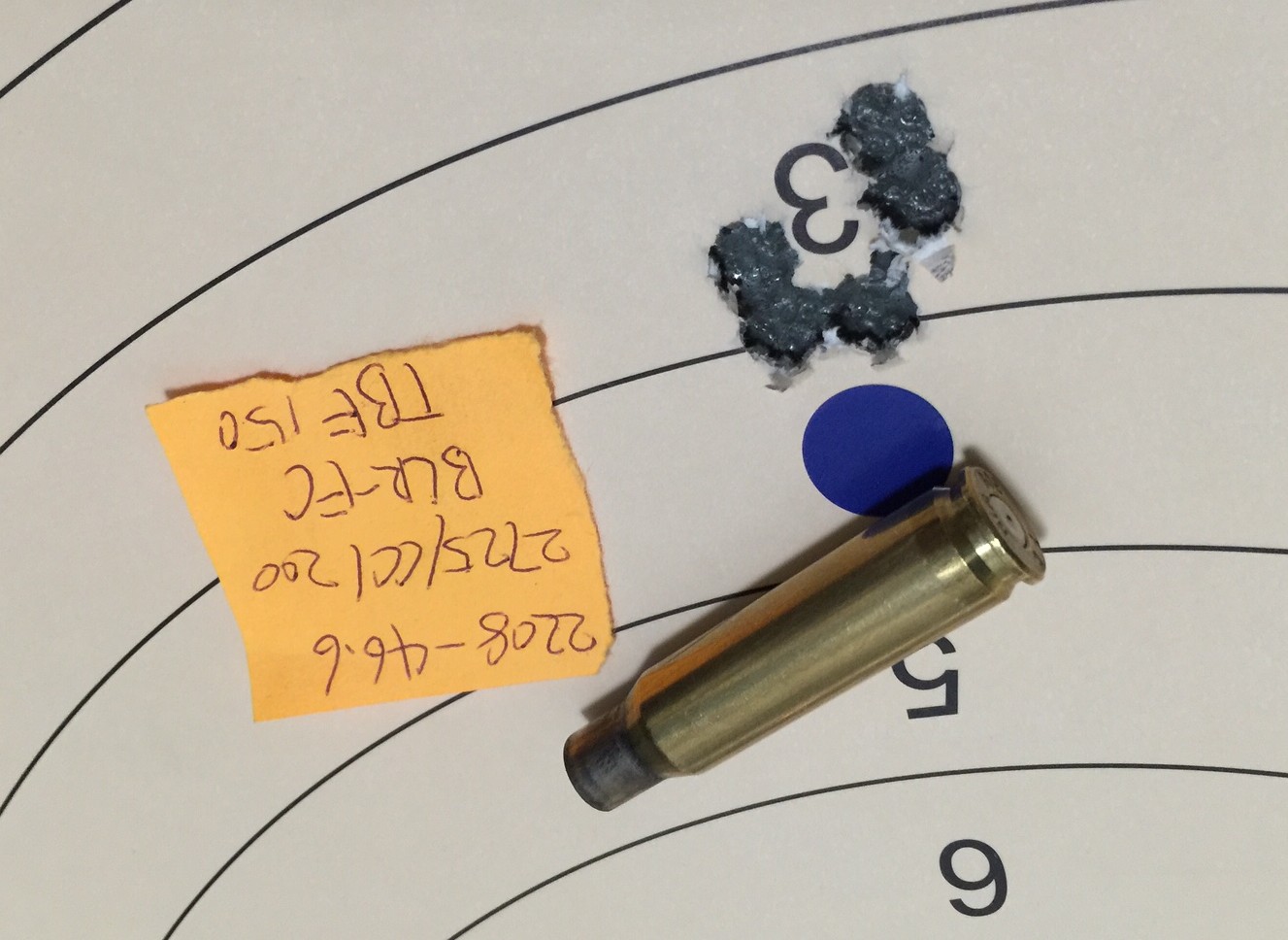

Post by SHV » 23 Nov 2017, 1:00 pm
5x 46.6
SHV
Posts: 1780
Post by SHV » 23 Nov 2017, 1:02 pm
5x 44.5
SHV
Posts: 1780
Post by SHV » 23 Nov 2017, 1:04 pm
5x 44.3

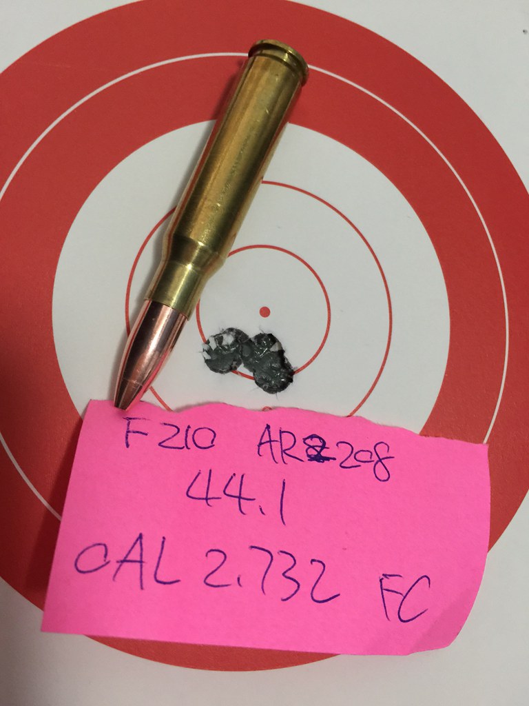

Post by SHV » 23 Nov 2017, 1:06 pm
4x 44.1

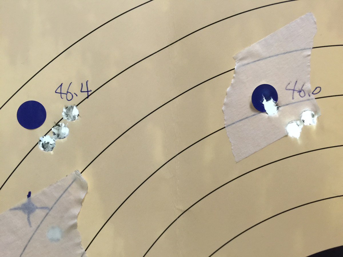

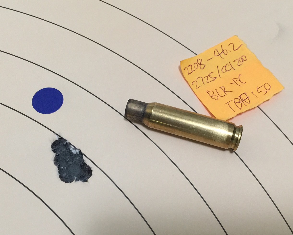

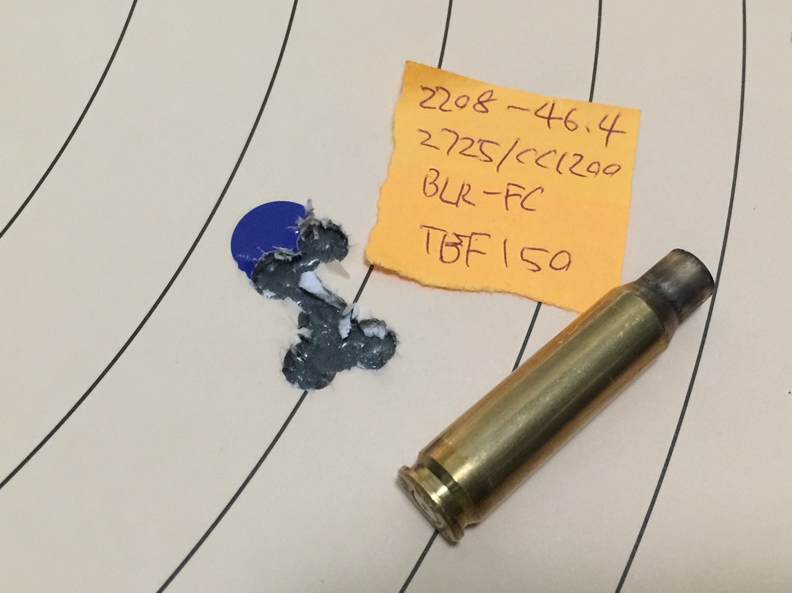

Post by SHV » 29 Dec 2017, 10:11 pm

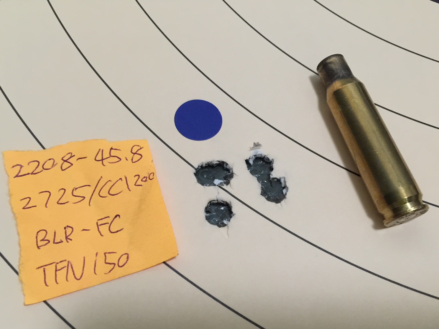

finally got time to do a little seriously test,
45.8gr 5 shot, there is typo, should be TBF 150
SHV
Posts: 1780
Post by SHV » 29 Dec 2017, 10:13 pm
46.0
SHV
Posts: 1780
Post by SHV » 29 Dec 2017, 10:14 pm
46.2
SHV
Posts: 1780
46.4
SHV
Posts: 1780
Post by SHV » 29 Dec 2017, 10:15 pm
46.6
Post by SHV » 29 Dec 2017, 10:23 pm
looks like 46.2 is the ok, this is a hunting rifle, the barrel is not free floating, external hammer lever gun, it is takedown version, trigger is heavy, later will put Leupold VX-III 1.5-5x20 or Leuopold FX-II 2.5X20 or just use the iron sight, so the accuracy should be kind of ok I reckon...

Post by Gwion » 30 Dec 2017, 7:43 am
Gotta be happy with 46.2!
Good stuff... load a few more up to confirm.
What distance are you shooting the groups? Hope you've found somewhere to shoot 100yd by now.
