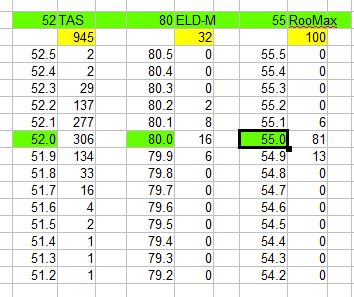

I spent several hours weighing the remaining 945 52gn bullets, as well as 100 RooMax's and my 32 remaining 80gn ELD-M's for comparison. I was going to weigh 600 RooMax's but after the first 100 the consistency was so good I didn't go any further.
75% of the swaged bullets were within 0.1gn high or low, and 90% were within 0.2gn high or low. 6% of them being 0.3gn high or low though is a problem which may offer better accuracy after weight batching. All of the 55gn RooMax's were within 0.1gn of 55gn.
Now that I've batched them all, loads from now will be using bullets with less than one-tenth of a grain variance.
Bullet weight consistency.JPG (39.02 KiB) Viewed 4790 times
