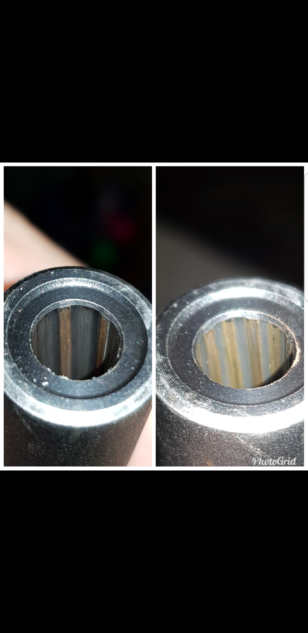

Post by Bushie » 02 Feb 2018, 8:14 pm
Right is before left is after
I've gone through with sweets 7.62 3 times letting it soak for 10 minutes each
I've ever tried using a copper brush to brush it off aswell
Am I doing something wrong or is this surface rust or corrosion from the copper??
This gun was purchased second hand and when I first bought it and took it down to clean it , it was FIIIILLLLTTTHYYYYY
12G > Anything else
Bushie
Posts: 157
Re: Is this something to be worried about?
Post by Oldbloke » 02 Feb 2018, 8:32 pm
It's copper.
More Sweets and leave it 30 minutes.
Scrub with a good nylon brush upon application and after soaking.
Don't use a bronze brush, the sweets attacks the bronze.
Your about halfway there.

Post by juststarting » 02 Feb 2018, 8:34 pm
Looks like copper. Sweets instructions says, keep patching out until patches stop coming out with blue streaks. 3 times doesn't sound like you've dissolved everything.
Posts: 2727
Post by Bushie » 02 Feb 2018, 9:19 pm
I'll give it another crack tomorrow I was thinking about leaving it on longer but the bottle says no longer then 15 minutes
I figured it would attack the brush so I gave it a good wash and dry before I put it away
And JS I mean like 3 separate soaks and stuff but I guess this one must be built up a lot I'll keep at it and let you know how I go
Post by Stix » 02 Feb 2018, 10:10 pm
Hi Bushie.
I had a rifle like that a couple of years ago...
I dont think copper had EVER been cleaned out of it.
It took me weeks & weeks of scrubbing, but i got there....i went through a good dozen brushes...!!!
In the end i used nylon brushes.
Try cleaning when you can shoot it...as in stuff the sweets down the tube when the barrel is warm & the copper is a bit softer.
If you're using bronze brush, every few times you clean, if you still get the blue on oatches, try scrubbing with a nylon/alloy brush...that way if you still get blue you know its copper & not the bronze brush.
Hope you got lotsa patch material...Big bicep is coming your way...!!!
Best of luck.

Post by Stix » 02 Feb 2018, 10:12 pm
...and 10 mins is nothing...
I ended up leaving barrel full of sweets o/night on several occasions...but kept the barrel wet with solvent.

Post by sungazer » 03 Feb 2018, 6:58 am
Pour Hot water down the barrel I mean boiling water. Then patch with solvent then brass brush then patch out then the sweets. If you had JB or Iosso past or even some autosol put that on a patch wrapped around a nylon brush and give it about 5 pass through s. This would be after the hot water.
Post by Bushie » 03 Feb 2018, 7:39 pm
Does anyone else use the hot water method??
Post by Oldbloke » 03 Feb 2018, 7:48 pm
Not me.
Just keep brushing with a nylon brush when applying the sweets. , then let it soak for about 30 minutes.
Patch a few times and then repeat until no more green/blue on patches.
Sometime it takes a fair few goes.
Don't use copper of bronze brushes. You will get false blue on patches because the sweets attacks the copper in the brush.
