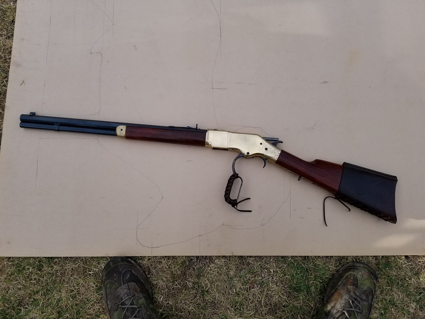

Been busy with the cows, swapping an engine in a bike and working on the Uberti - the fun bit :-)

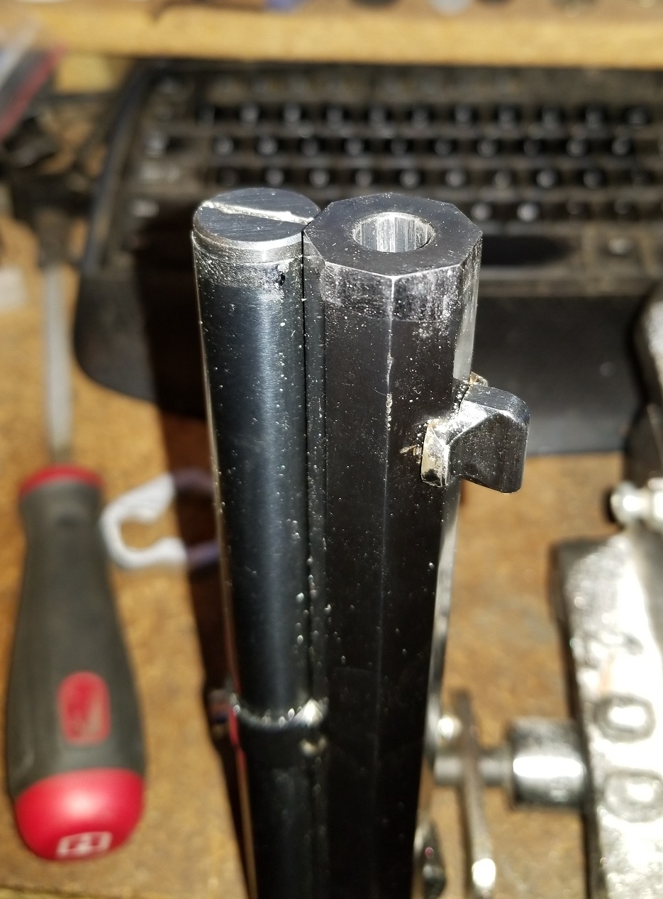

The stock sights are horrendous for precision shooting, the front sight bead covers an A4 page at 50m.
And the rear buckhorn sucks as well, probably works like a ghost ring for huge targets under fifty meters though.

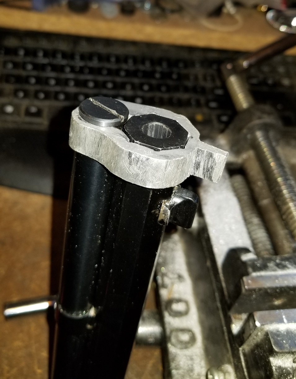

Trying to mount a peep sight or scope is virtually impossible without drilling the brass receiver somewhere, and I'm loathe to do that.

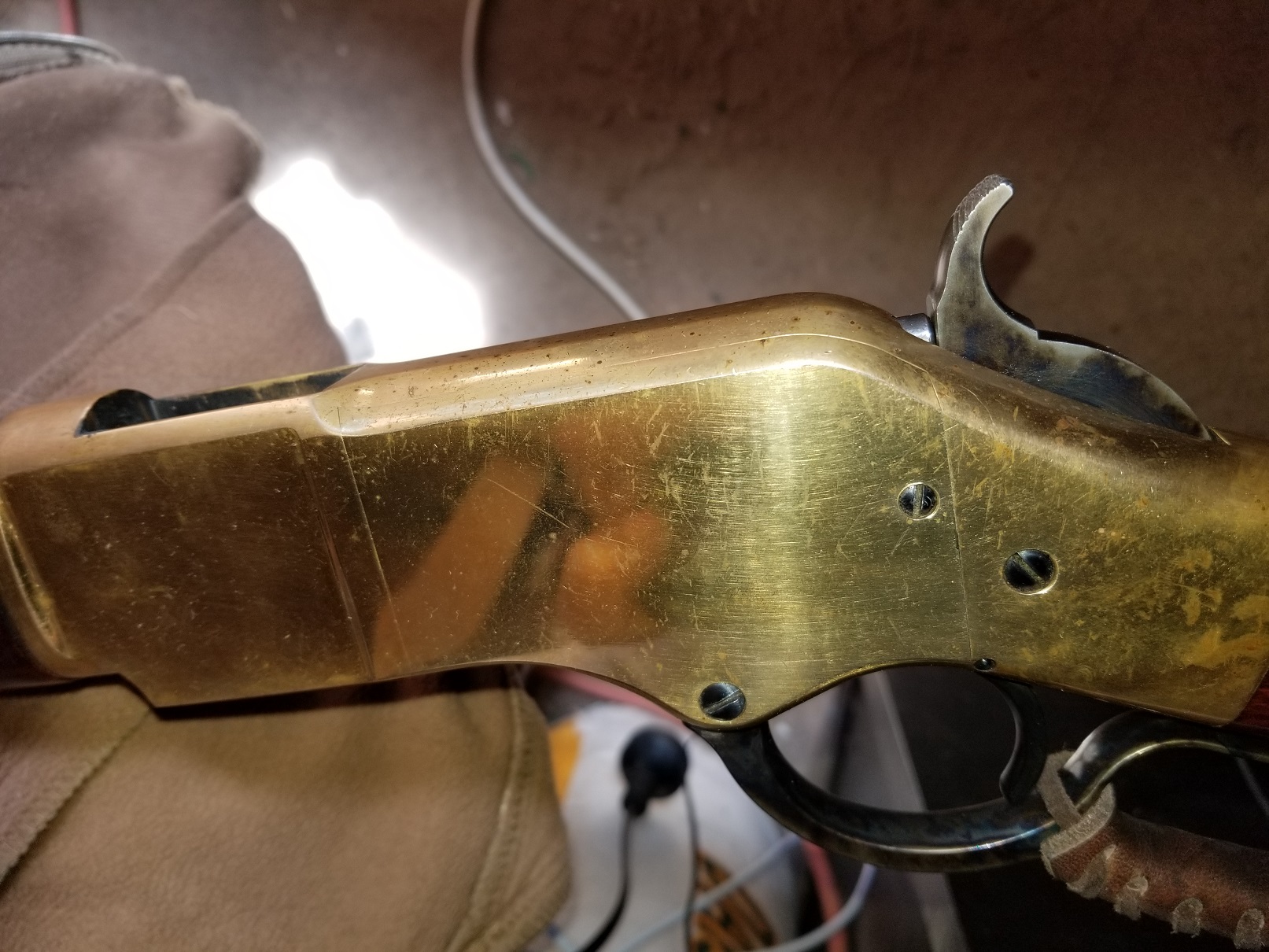

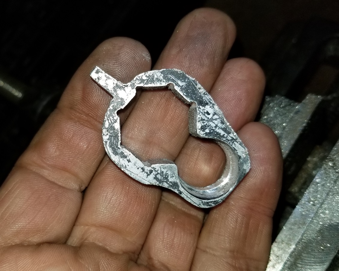

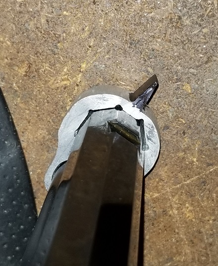

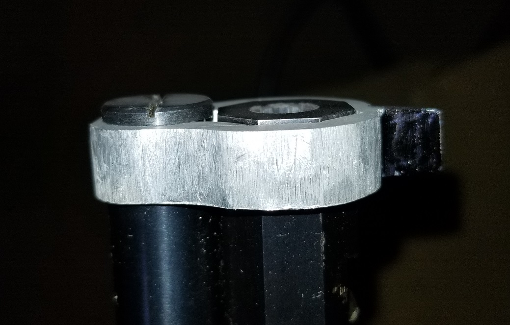

But, since the side plates of the receiver come off I decided to make a new left side plate that includes a mounting bracket above the action. Couldn't get any brass plate so I did it in aluminium.

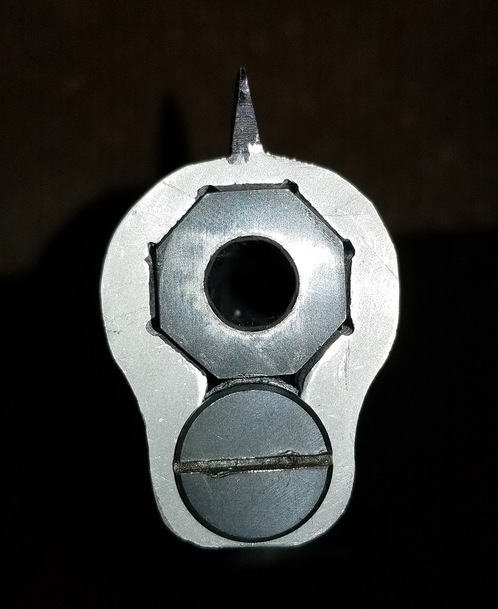

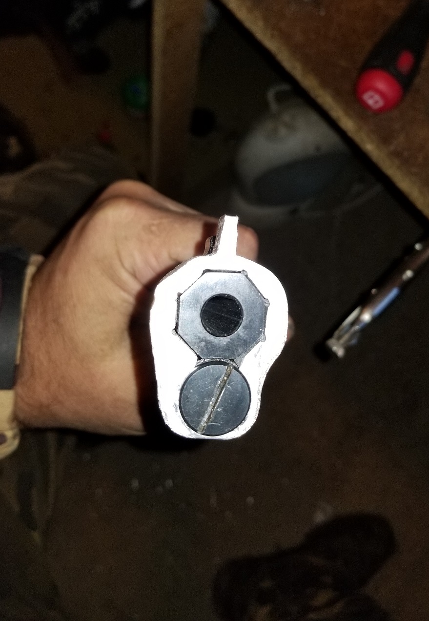

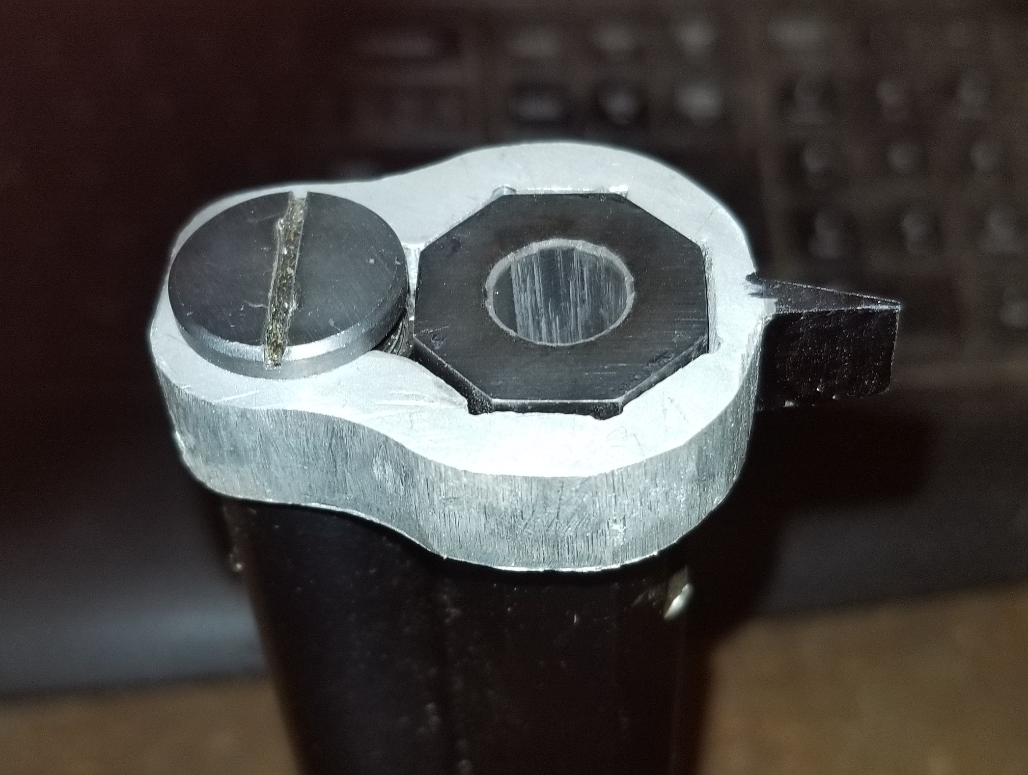

And I made a new front sight that simply attaches to the muzzle and held in place by the magazine tube plug.
I'll test shoot it tomorrow to see if they're an improvement.
Then I need to finish the final shapes and polish them up.

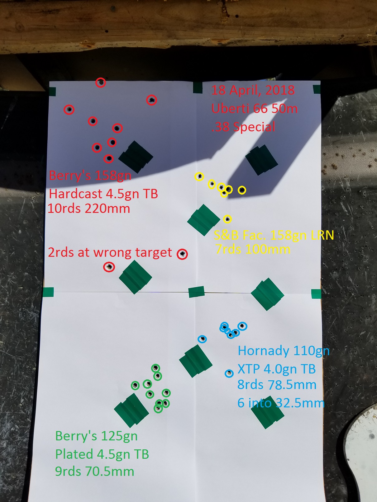

Post by bladeracer » 04 Apr 2018, 6:10 pm

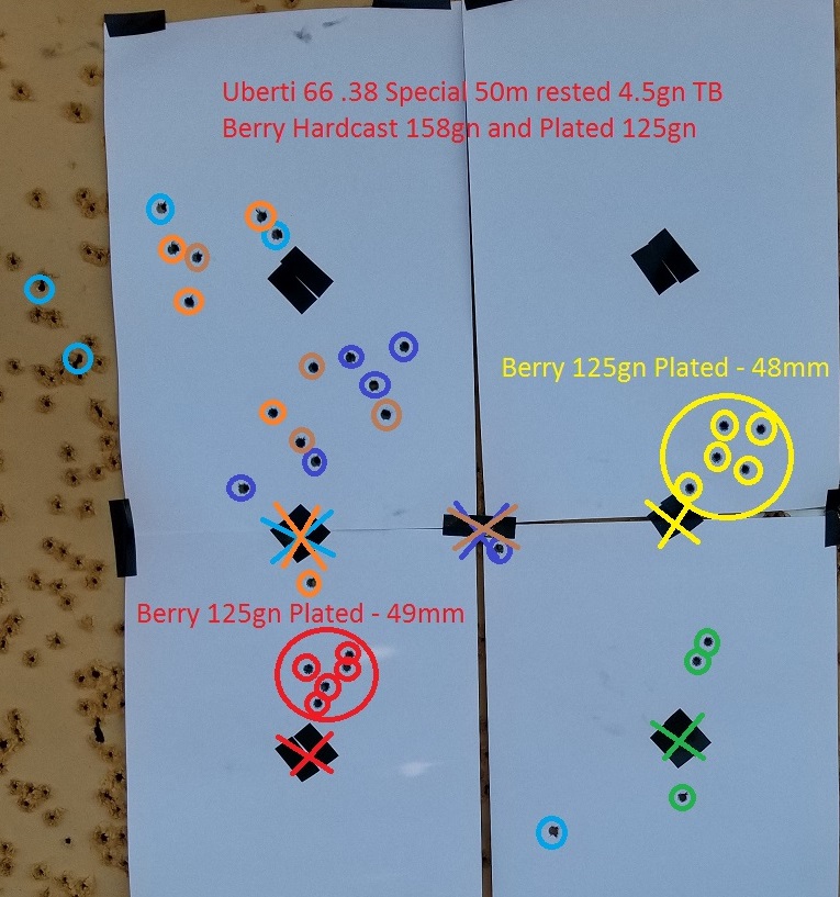

The new sights are a huge improvement, and I finally have something I can work with.
I tested two bullets today from Berry's, the 158gn Hardcast and the 125gn Plated.
The Hardcast are no better than my own cast bullets, pretty hopeless.
But the Plated bullets group nicely around 50mm rested at 50m.
I'll have to get some jacketed bullets as well to see if they shoot even better, but the Plated bullet will do the trick for now.

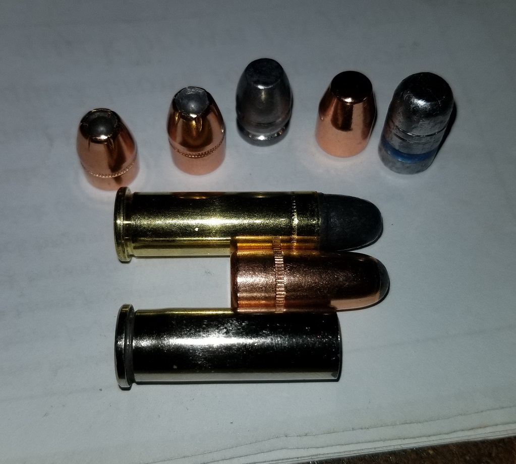

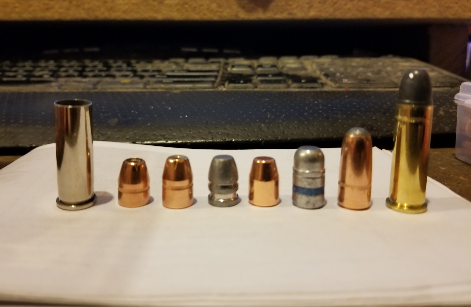

Got a range of jacketed bullets to test in the .38 now.
Empty Starline brass, Hornady 110gn XTP, 125gn XTP, Lee 125gn cast, Berry's 125gn Copper Plated FN, Berry's 158gn Hardcast, Hornady 200gn Interlock RN, and S&B factory loaded 158gn LRN.
Will be curious to see what velocity I can get with the 200gn bullet with light loads.
I'm also curious to try it single-loaded with the bullet out as far as it can go to see if it's any more accurate.
I've only been shooting 4.5gn Trailboss loads behind the 158gn and 125gn bullets so far, with the 158gn running just about right on 1000fps. I haven't noticed a sonic crack to the 125gn so I think they're still subsonic. I can't imagine you'd even see any pressure signs in this design, the toggles would likely let go immediately as there's really nothing else that can "give" a little to warn the shooter.
Also have to load up some .30-06 test loads if I can find time.
I'm only trying the Hornady 178gn BTHP initially as I'm curious to see how well she might be able to shoot.

Wow how resourceful BR - how do you attach that front sight? In a time passed I would have said that additional junk may have interrupted the harmonics, but based on my own findings with 92 I don’t think it would really be that detrimental (yet it adds a hell of a lot of function!)
Re: Uberti 66
Post by bladeracer » 10 Apr 2018, 8:02 pm
in2anity wrote:Wow how resourceful BR - how do you attach that front sight? In a time passed I would have said that additional junk may have interrupted the harmonics, but based on my own findings with 92 I don’t think it would really be that detrimental (yet it adds a hell of a lot of function!)
The sight simply fits around the octagonal muzzle and the mag tube, and is held in place by the mag tube plug. I still need to finish the final shape, and polish both pieces to a nice shine.

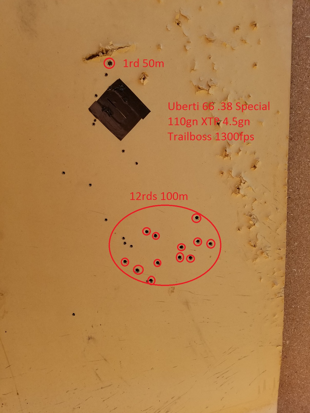

Post by bladeracer » 13 Apr 2018, 10:21 am
I made up some test ammo with the 110gn XTP on 4.5gn of Trailboss.
Only got one round down range, but it failed to extract the case, which locks the action up - bugger.
Walked back to my office to disassemble it and couldn't be bothered walking out again last night.

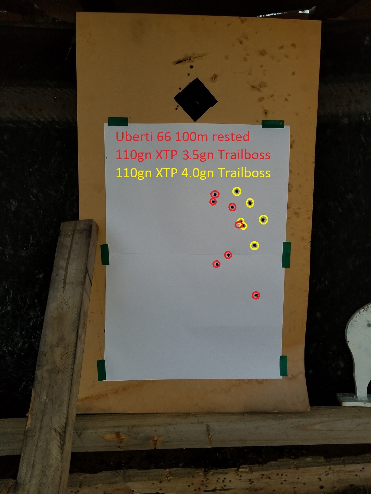

But I shot twelve rounds just now off the bench at 100m into a group 150mm wide and 106mm tall - looks promising.
Managed to shoot some more 110gn XTP's on 4.0gn and 3.5gn of Trailboss, but I didn't bother with the chrono.

Post by bladeracer » 18 Apr 2018, 2:46 pm
More ammo testing.
Berry's 125gn Plated is still the most consistent, but the 110gn XTP shows real promise.
I loaded some 200gn RN's on 2.2gn of Trailboss but the first only got halfway down the bore.
I'll try them on 3.0 and 3.5gn.
Posts: 14003
Re: Uberti 66
Post by bladeracer » 18 Apr 2018, 7:26 pm
bladeracer wrote:I loaded some 200gn RN's on 2.2gn of Trailboss but the first only got halfway down the bore.
3.0gn of TB got further down the bore but was still a squib.
3.5gn punched the 200gn bullet downrange so I loaded five rounds.
Accuracy is on par with the 125gn Berry's Plated, but it shoots 480mm low at 50m...at 400fps :-)
Very surprised it grouped so well after strolling down the range.
.38 is supposed to be a .357" bore, but this slugs at .355", and the recovered bullets are .355", despite starting out at .358".
As the 66 was never designed to shoot 200gn jacketed bullets, I've erred on the side of caution to protect the action, and my face. I was hoping to calculate bolt thrust, but the tight bore makes for a very wild guesstimate of chamber pressures - just how much pressure does it take to swage a jacketed bullet down three-thou?

No knocking required, just push them out with a length of 6mm aluminium rod.
I like messing with light loads so I get lots of squibs - they don't do any harm.
With this toggle-lock action I'm much more concerned about warmer loads than squibs. .38 Special runs around 16-17,000CUP, and +P runs around 19,000CUP. Uberti say not to run +P, so I guess the action is rated to maybe 17,000CUP max for extended use, which as far as I can determine is roughly the same pressure as .22LR (24,000psi max). According to ADI, the 110gn XTP at 1100fps is around 17,000CUP, but I'm making 1300fps, probably due to the bullets being over-size for the bore. The 125gn at 1000fps is around 17,000CUP - I'm close to 1200fps. 158gn cast at 850-900fps makes almost 17,000CUP - I'm seeing 1000fps. I don't have any numbers for 200gn jacketed bullets, but the 170gn at 850fps makes 16,000CUP. A 200gn at 1000fps would be pretty hot, but I'd be willing to try them for the ten-rounds needed to drop the rams at 200m, but it's still far short of the knock-down energy of the .44. I might resort to it if I can't make a good .44 load, but I don't think it'll be necessary.
For practicing, I'm happy to shoot lighter loads that are less accurate, but for actual competition I need the best accuracy I can find. At this point I'm pretty happy with the accuracy of the .38 for CLAS I think. I'll keep practicing with it but I need to work out an accurate load for the .44 now.

in2anity wrote:Good progress Blade, you’re definitely squeezing the most out that little 66! I’d be scared loading under mins but I suppose if you’re acutely aware of when squibs occur then there’s nothing really that can go wrong right? Just knock em out with some dowel right?
