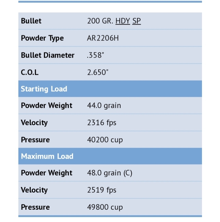

Post by bigpete » 30 Jun 2019, 5:39 am
My data says max speed of 2520fps with 200gn pills...
Posts: 4177
Re: 358 winchester nearly there...
Post by bigpete » 30 Jun 2019, 5:42 am
Straight from ADI
Screenshot_20190630-051045_Samsung Internet.jpg (129.28 KiB) Viewed 7197 times

Post by bigrich » 30 Jun 2019, 9:21 am
sorry pete, was looking at the wrong bullet weight . speer 180's can be pushed that fast supposedly . you are correct about the 200 gn load . i was looking at nathan fosters load data and simply looked at the wrong line . :unknown:

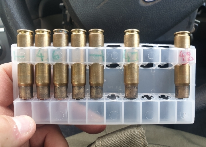

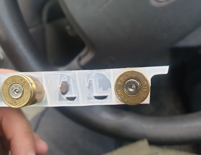

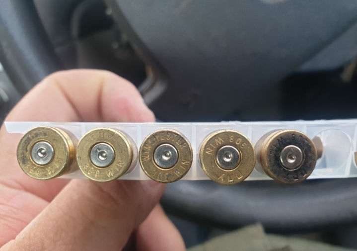

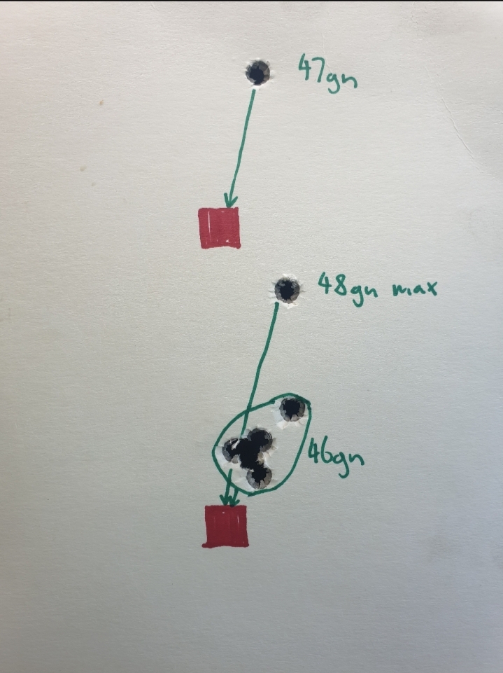

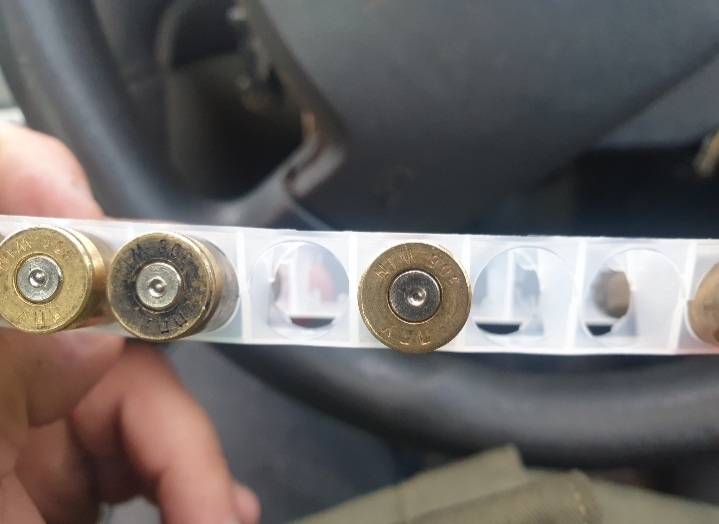

Ok,just ran in/sighted in my 358.
Fired 20 rounds loaded 1gn over minimum with a good clean every 5 rounds. Didn't bother photographing the group's,they were s**t,and half of them were shot with one of the QD rings loose.
Then I fired 5x 46gn loads. Point of impact was slightly higher,but a nice group was had except the flyer. No pressure signs.
Then I fired a single 47gn load. Hit heaps high of point of aim,still no pressure signs.
I went for broke and fired a single round loaded at max. Hit higher again,and was a little difficult to extract. But still no pressure signs on the primer.
So far,so good. I think I'll load a few at 47gn and 47.5gn and see how they go.
Rifle is a 1982 winchester model 70 featherweight with a sprinter 358 light weight barrel with open sights and leupold 1.5 to 5x20 vx3 scope in warne QD rings. Targets are only 60m for now.

Post by JimTom » 30 Jun 2019, 12:55 pm
46gn loads look like the one mate. Nice one. Be interesting to see the 47 and 47.5 loads.

Post by bigpete » 30 Jun 2019, 1:04 pm
I'm definitely going to try some groups at 47 and 47.5gn. I only made one of each just to see what pressure signs there are

Post by Tank » 30 Jun 2019, 3:21 pm
Hey Pete what’s with the sooty base?
Was that the tougher case to extract?
Crap weather here but you’re inspiring me brother!
Tank
Posts: 200
Post by bigpete » 30 Jun 2019, 3:28 pm
It's ink. I think it was a subsonic load once
