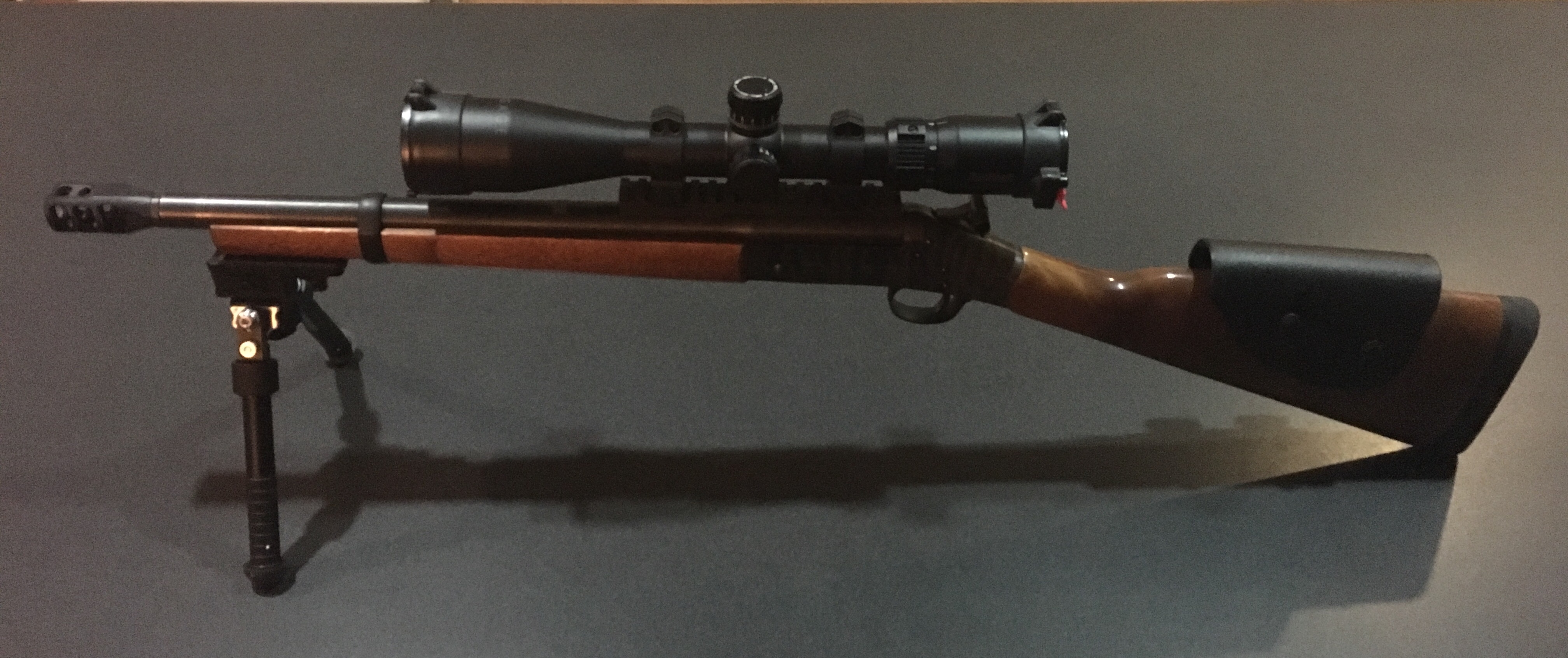

The ‘Wombat’....complete with the M-11 brake off eBay from Gunbloke.

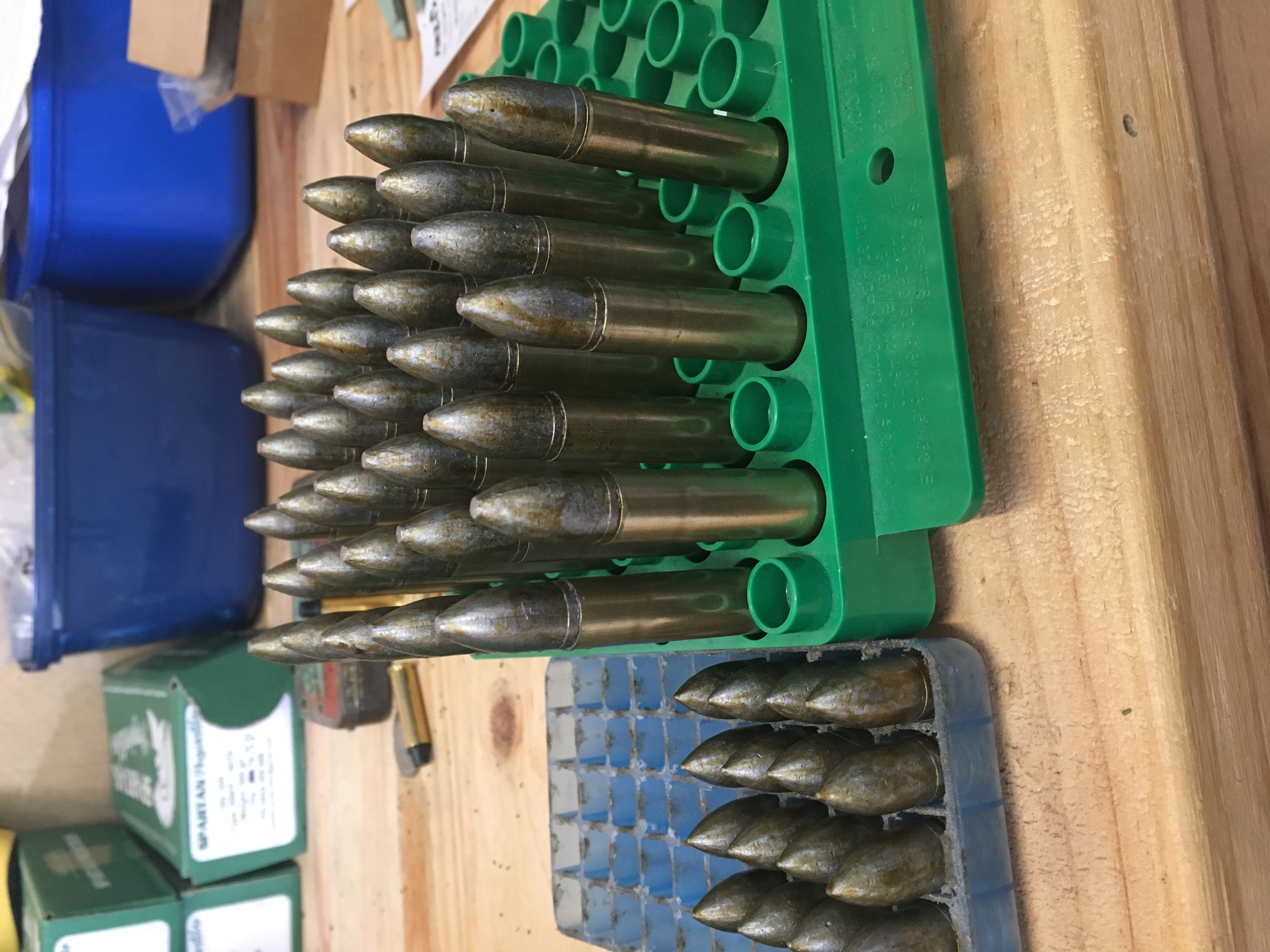

A few Alox lubed loaded rounds ready for the range.

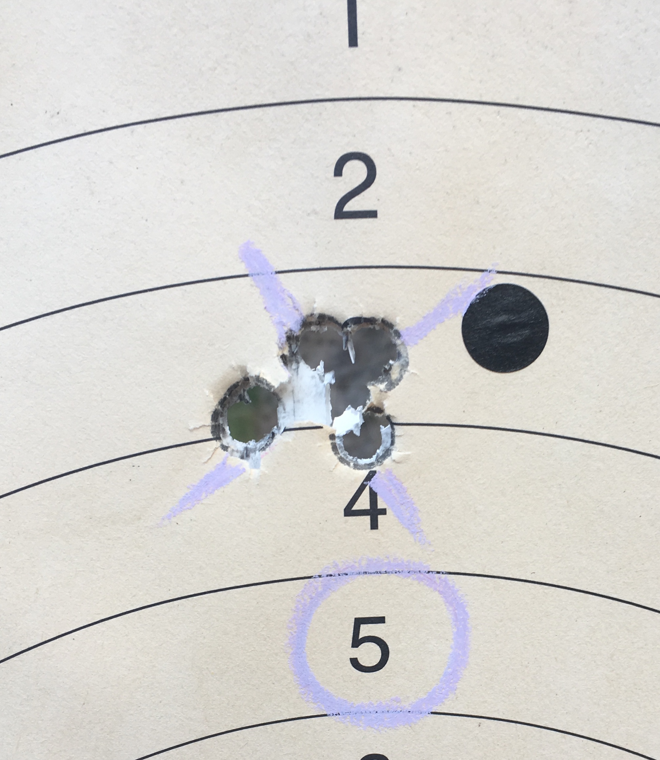

6 shot 100yd group with ‘range trash cast’ Lyman 457468 mold proje over 33gr 2207.

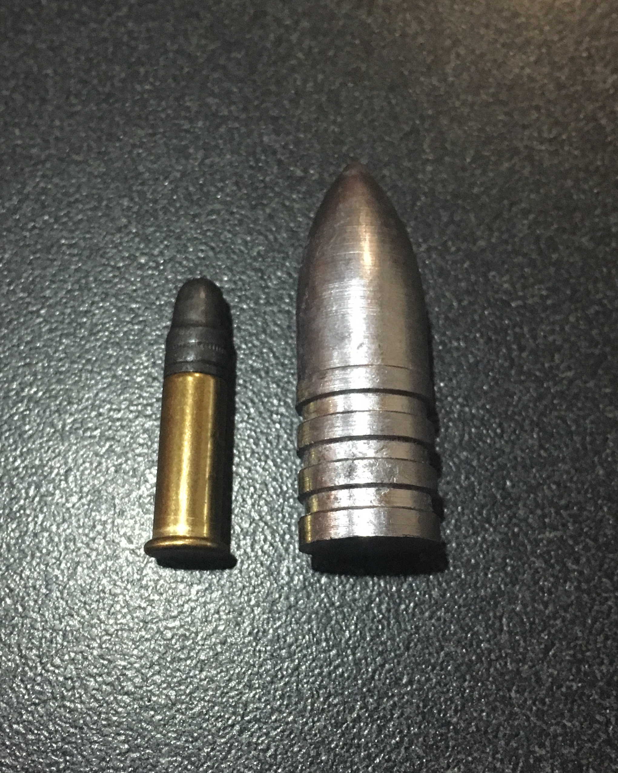

Range trash cast Lyman 457468 497gr before being Aloxed.

Quick summary.
Great fun package that is dynamite on steel at ranges out to 400yds.
The combination of the brake and decent butt pad make it easy to shoot all day. Significant recoil reduction with the muzzle blast trade off being something I’m quite happy to live with.
15 cents a shot for a rifle that develops this sort of grunt just adds to the equation.
I WON’T be removing the brake anytime soon.
200 rounds on.....it just keeps making me grin. Surprises with its exceptional accuracy, economy and grunt.
Would love to see anyone else’s current project.....and hope this inspires discussion.

What the actual Fark is that, and why are my testicles tingling?
Re: Muzzle breaks - are people using them?
Post by Tank » 17 Sep 2019, 9:53 pm
It’s a H&R 155 ‘Shikari’ in 45-70Govt. It originally had 28” barrel. Now 16.5”. 2.5-10x44 Bushnell Engage scope in Warne rings on a ICE 20MOA pic rail. EBay Atlas copy bipod with Pic rail adaptor. Pachmyr Decelerator pad and Karsten Kydex adjustable cheek rest from ScopedOut.....and M-11 Gunbloke muzzle brake. That works brilliantly!
Tonne of fun. :thumbsup:
Tingling balls.....yeah that was me when I got everything fitted up. :lol:

Mate quite the group for such a pill/cartridge/gun :clap: A CDS from NIOA would work a treat (if you settled on your load). How much does the thing weigh? Also, with your 33gr 2207 lead-load, what would you say the recoil is comparable to? A hot 30/30?

Cheers In2anity!
The load works and I’ll stick with it. Shoots way better than I could have dreamt.
I’m hearing you on CDS but the Engage with the 30MOA vertical hash plus target style turrets (15MOA per rotation) give me a bit more flexibility.
It weighs just over 8lbs with everything hanging off it. Recoil is much lighter than my 30AS Marlin in 30-30. It is mild as!

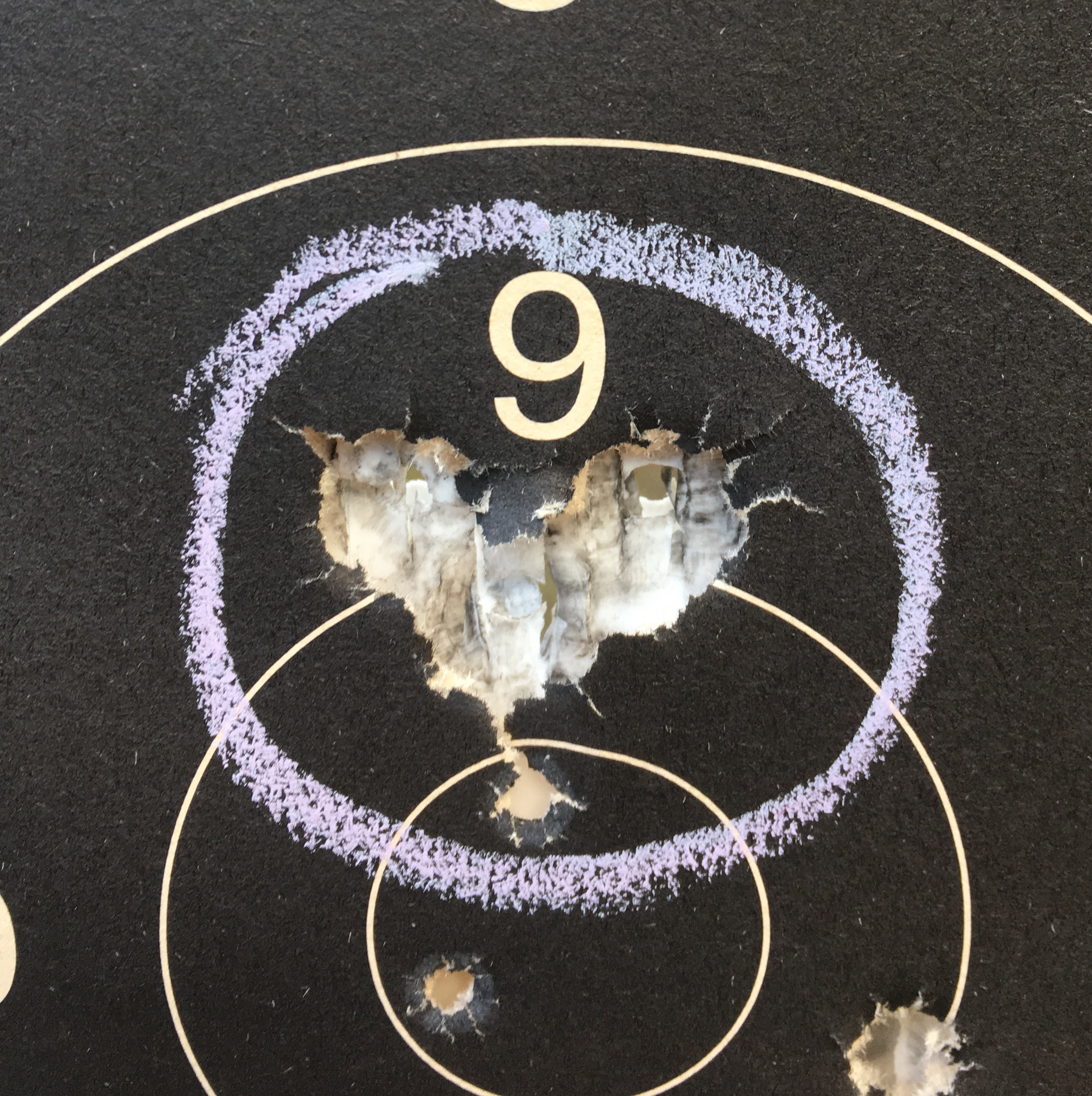

It was at this stage I called Project Wombat.....zeroed.
3 shot group from the same session. (Not that 3 shot groups mean a lot....but I was still impressed).
