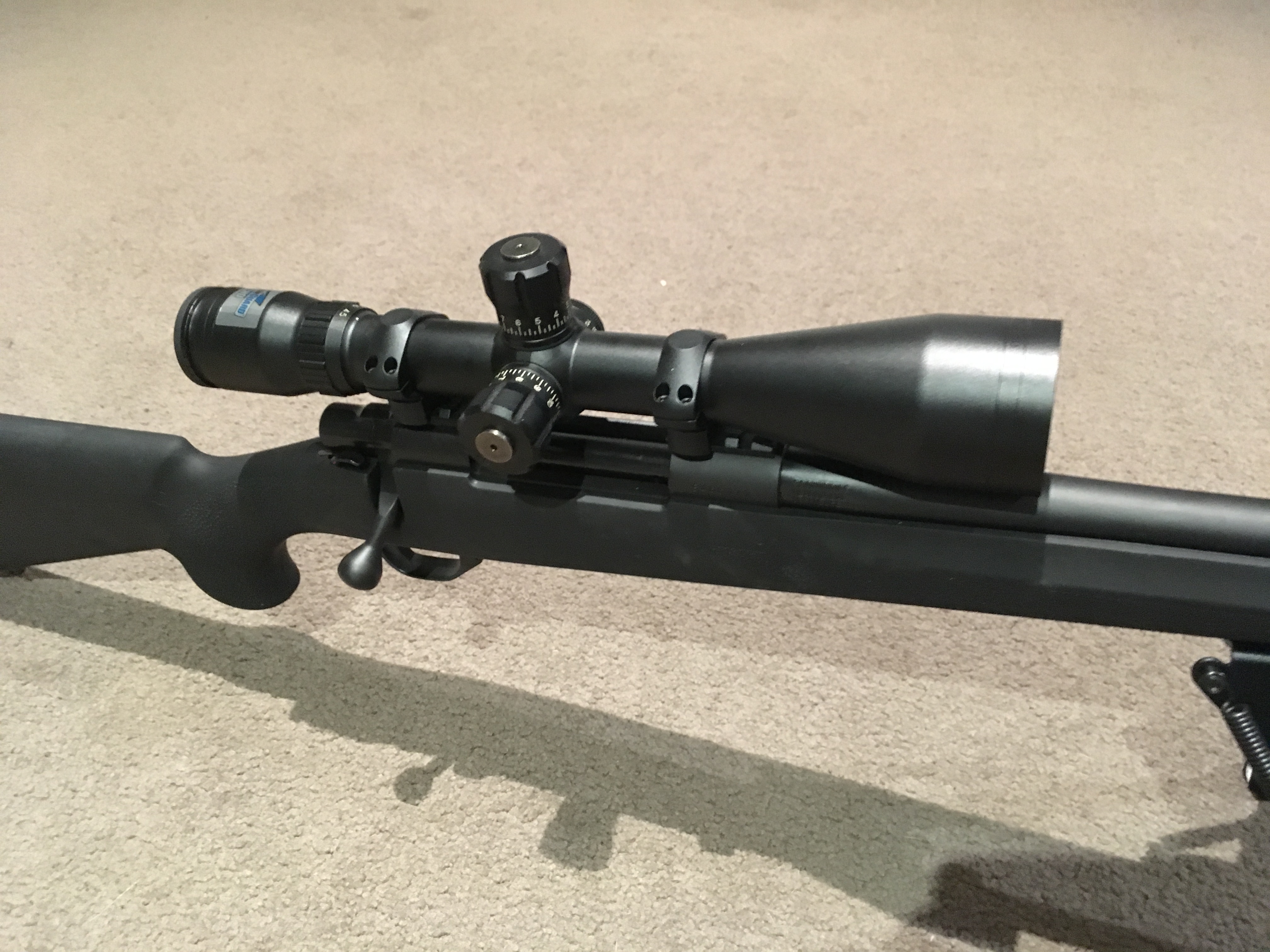

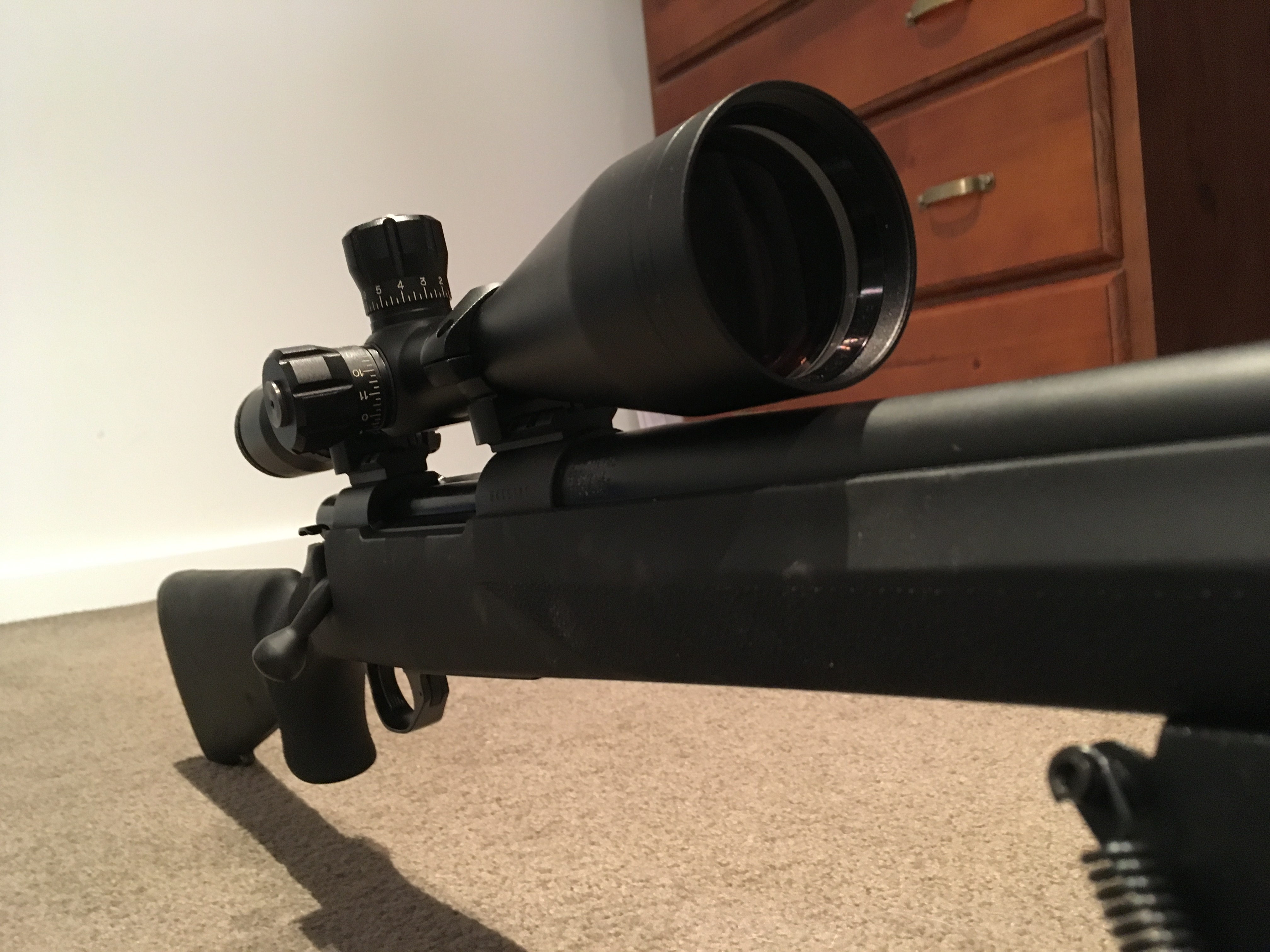

Scope mounted - objective lens is now 2.5mm clear instead 25mm.

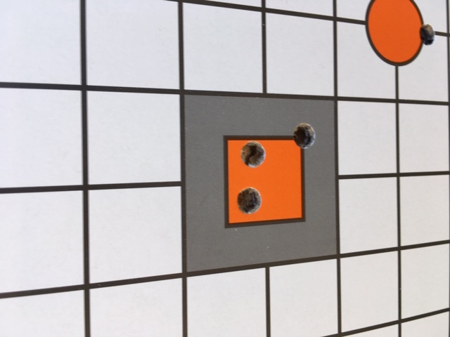

So - 1st day of the 300 load testing between tikka vs howa...distance was 106 metres.
Tikka was shooting 155 Berger’s with 70.0gns into square.
Howa was shooting 180 sierras with 66.0 at the bottom of spika - update, measured at .55 of an inch.

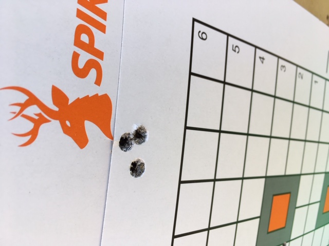

After mr tikka shot all his 150’s he started looking at my loads...I’d already settled on 180’s for the 300win and 168’s for my 30/06.
Mr Tikka 300 has then produced this (below) with a completely different bullet - was one I had loaded for myself to try...66gns of 09 pushing a 168 zmax’s but I’d ruled out after the 180’s shot so well.
Mr tikka is recoil sensitive and was NOT happy RE the 168’s but this was def his best group today (below and measured .64 of an inch ) and he’s now accepted 168’s are going to be his go to 300win projectile....overall, there was nothing between the two best over all groupings.
