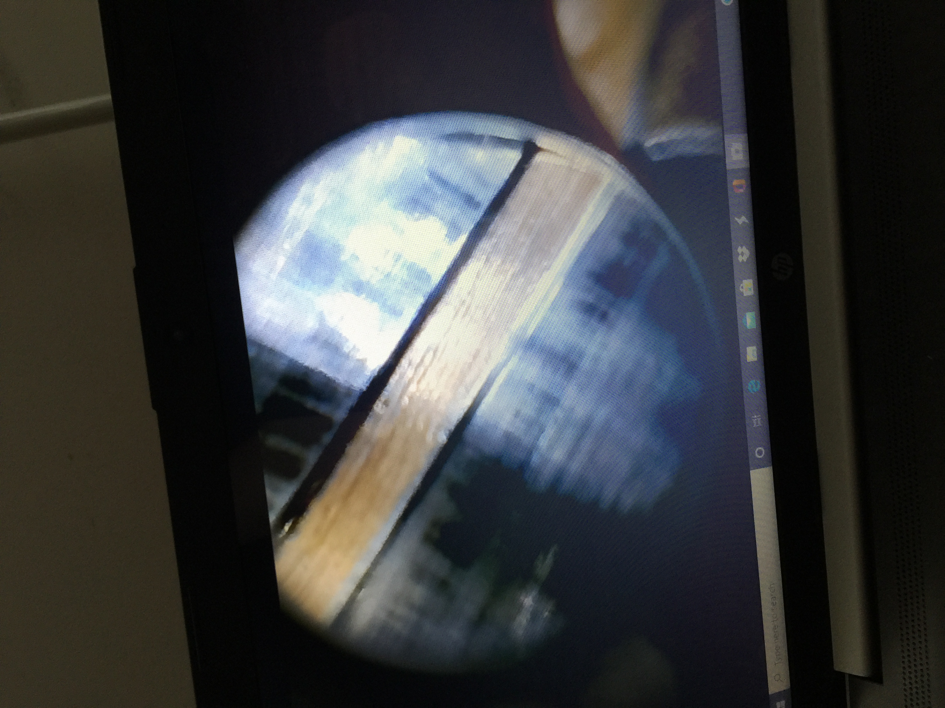

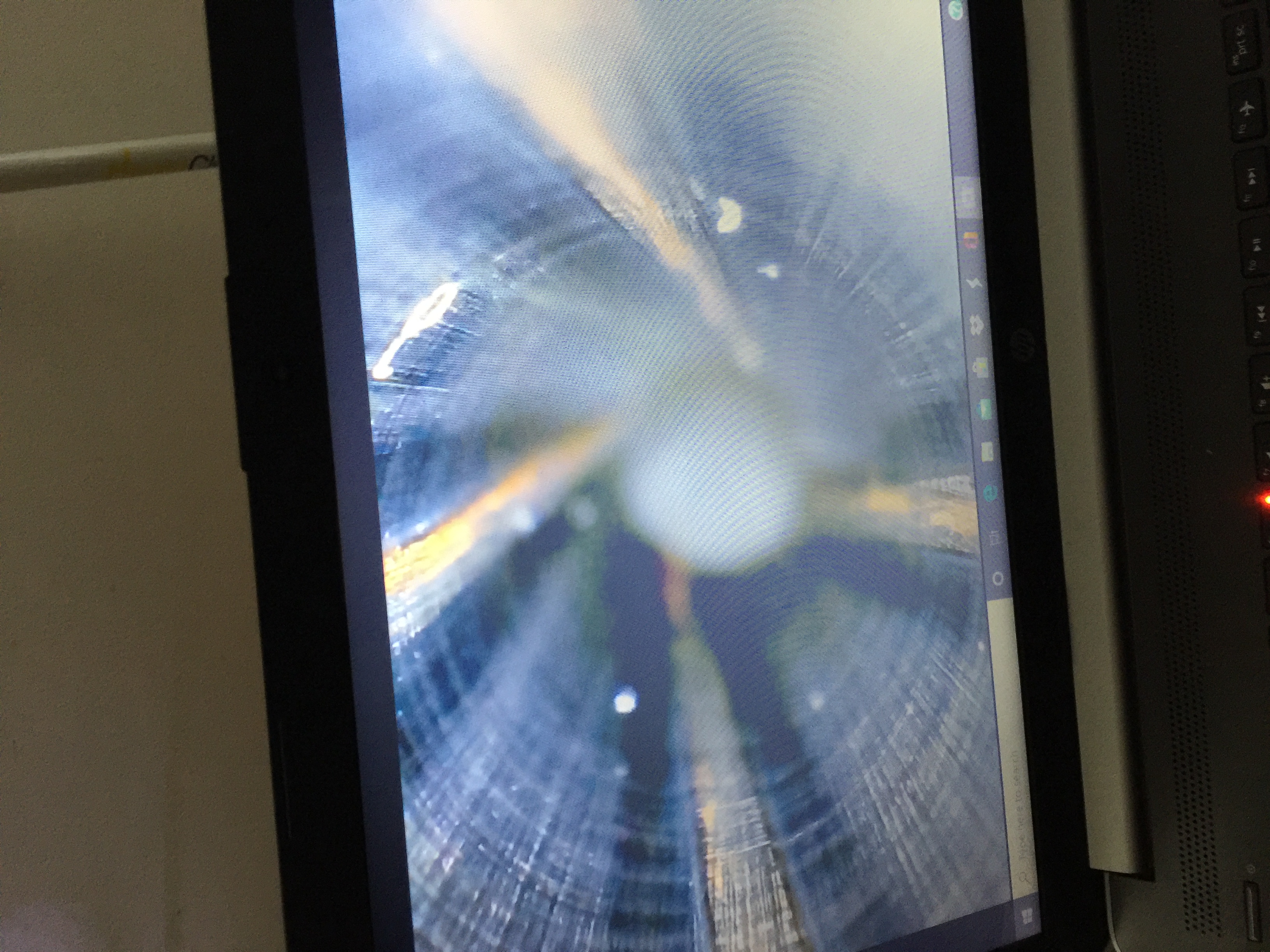

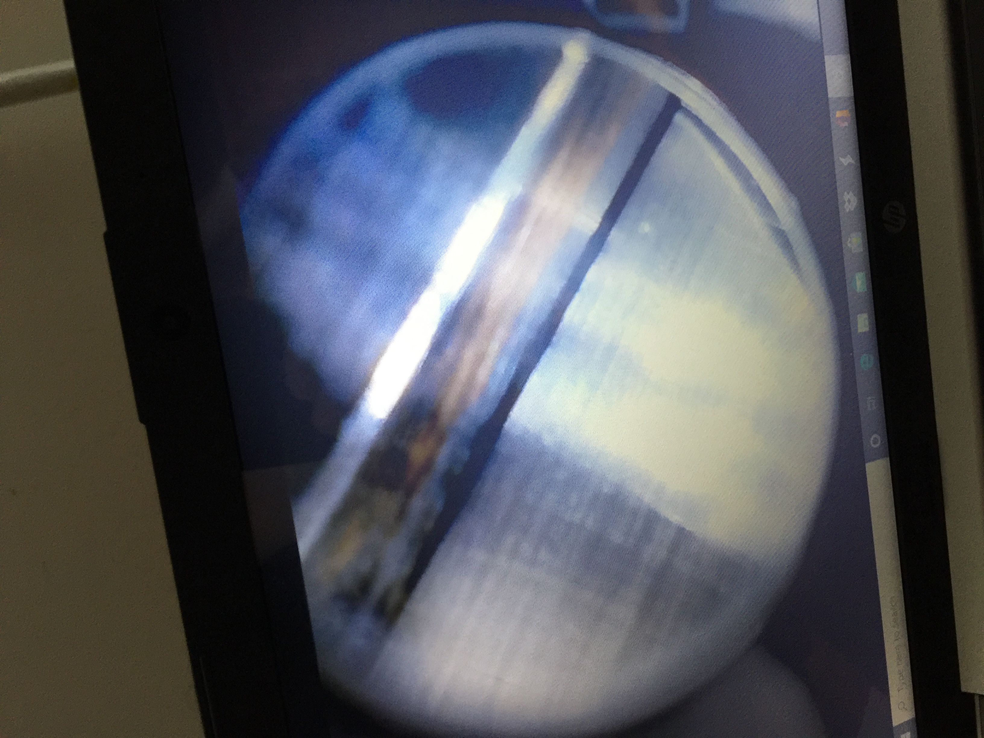

Post by TassieTiger » 29 Mar 2020, 1:49 pm
Mr Gazer - you have prompted me to get off my bum and fire up the scope...
So the bottom pic is 1 inch inside muzzle, it looks quite heavy and is across all riflings.
Second pic is 4-5 inches further back, again across all riflings.
At half way along bsrrel - it becomes much much lighter, streaky and then 12 inches in - looks clean.
Top photo is from 8 inches in looking out to muzzle.
I can’t see anything that resembles a burr, but as Mm said, I wouldn’t know what I’m looking for, how big is big, etc.
This scope thing is cool as. But I’m too scared to look inside my other rifles now lol.

Post by TassieTiger » 29 Mar 2020, 3:49 pm
Madang185 wrote:One of the items that I have noticed is that with non brushing liquids it often takes two applications to get the barrel clean.
The other issue is that I am not sure a barrel has to be pristine clean to shoot well, like people, they are all different.
When storing barrel after shooting we normally use a 50/50 mixture of Hoppes #9 and Penetrene, works on any residual copper and prevents rusting.
Mate - to give you some idea Re cleaning overvthe passed two outings.
I’ve used 1/3 bottle of sweets on patches - maybe 100 wet patches? With nylon brushing soaked as well.
At least 100ml of kg12 - maybe 60 patches. With nylon brushing as well.
200 mls of hoppes soaking over night several times and scrubbing intermittently (I usually put some hoppes in after using the other two - as a pre cleaner I guess).
And carbon cleaner and oil and everything in between....
I’ll just add.
As much as I’m whining about this - it has taught me a lot and continues to do so. I would have never bought a scope if it wasn’t for this issue and sungazers recommendation. I’d have never found kg12 without researching. Etc etc. it’s true that we learn more from our failures...I seem to fail a lot :drinks:
Re: Copper fouling - how bad ?
Post by sungazer » 29 Mar 2020, 4:27 pm
Yep that is pretty bad. looks like your fingerprint on the top photo :) The barrel does have quite a bit of tooling type marks in that last picture if that is not mere fingerprints. Its not really bad chatter type marks like I had in one barrel but not a mirror finish either. The top photo without the mirror on seems to show quite a few parallel type scratch marks but they don't show up as much with the mirror on.
I will go and have a play with my scope on a rifle I got a few weeks ago. I couldnt give any advice based on the photos other than you have a bad copper problem.
With the KG12 I use a Parker Hale Jag I use them for everything actually I like the extra surface area they give. I wrap a bit patch around it that is a loose fit so that all the chemical doesn't get squeezed out. I then run it back and forward a few times and add a few more drops after a few passes. Then I will leave it for 15-30 min a commercial break or two then run a dry patch down and inspect. Repeat the process if necessary.
With sweets I do much the same thing but use a nylon brush loose fitting so it can be worked back and forward I keep topping up the brush until it good and wet. With sweets you use quick back and forth strokes to work it into a lather then again let it sit for 15-30 min dry patch and inspect.
I would then run a brass brush with some Hoppes or Butches and then just a wet patch with Hoppes. I do this as a first step always to remove carbon first so the chemicals can get at any copper if there is any.
Also between changing from one chem to another I will run a patch of carby or brake cleaner down the bore esp if the first chem was oily and then you are going to run KG or sweets it need to be dry and free from oil so the next chem can work.
Check out the Parker Hale jags http://www.midway-australia.com.au/j-de ... 2-caliber/ They are available in nearly all calls not a lot in stock at Midway Aus ATM the Montanna look like a copy of sorts.
Post by TassieTiger » 29 Mar 2020, 4:37 pm
I noticed the marks you are referring too - I think it’s reflection back - you’ll see what I mean when you use the LEDs on the cam. It’s a bit weird. The mirror is obviously more accurate as it focuses on a specific point. There are some scratch marks along some riflings but other wise it’s pretty decent compared to my tikka barrels.
I def should try some brake cleaner in between - I have a few bottles...but was worried Re potential residue.
I’ve tried a 264 nylon brush wrapped in patch - soaked to get barrel wet. Other than that - I’ use slotted patch holders. They are pretty loose...compared to brush/patch combo.
I’ll check out the PH sticks.
