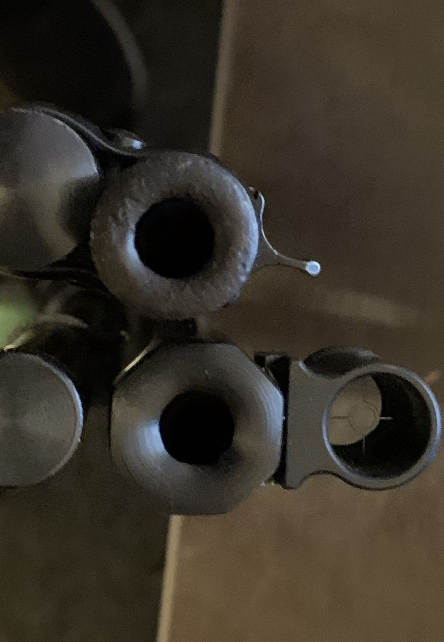

I think very broadly speaking, the octogans are slightly heavier and more rigid than their round counterparts.
For example here’s two marlin 30 cals, a standard 336 and a “”cowboy”:
336 vs CB
Often the 45/70 barrels on a cowboy gun turn out a bit whippy though - big hole down the middle and all :D
