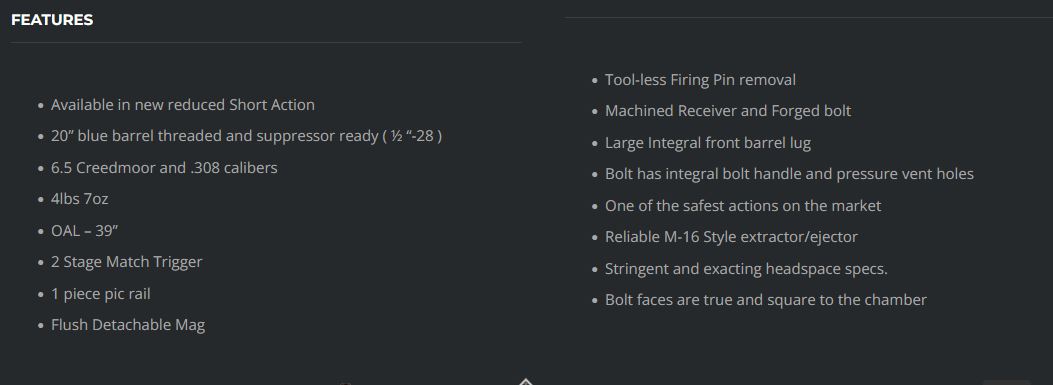

New Howa Short Action only 4lbs 7oz
Re: New Howa Short Action only 4lbs 7oz

Two of the Howa reps responded to my emai with "Yes, it's 4lb 7oz!", without answering any of my questions, like how it can feed 2.800" cartridges if it's shorter than 2.800".
We'll have to wait and see guess.

Bladeracer why do think its shorter than 2.800 ??
Bill
Posts: 1242
Post by bladeracer » 25 Jan 2022, 6:02 pm
Bill wrote:Bladeracer why do think its shorter than 2.800 ??
Because they're claiming it's a new action length between the 2.260" Mini and the 2.800" short-action.
"This new offering has a unique Howa Action build that is in between the popular Howa Mini Action and standard Short Action platform.".
I can't see how it can be, and they probably mean they've reduced the external dimensions of the short-action, which they could just explain.

Post by LawrenceA » 25 Jan 2022, 7:57 pm
Perhaps they shortened the knox and rear bridge as well as the diameter, Same effective length but shorter, thinner and lighter.
Not sure that could account for a coupla pds though.

Post by bladeracer » 25 Jan 2022, 8:36 pm
The website calls it a reduced length short action, or something like that.

Post by LawrenceA » 26 Jan 2022, 10:21 am
And it would be.
Knock a 1/4" off the front and back so the action operating length would be the same but the overall length would be shorter. Or perhaps the operating length has been reduced such that 180 or larger pills need to be seated deeper to ensure feeding.
Time will tell.

Post by bladeracer » 26 Jan 2022, 3:25 pm
LawrenceA wrote:And it would be.
Time will tell.
All factory ammunition for short-actions is made to 2.800" maximum to be able to feed (it would be nonsense to choose to load ammo short, reducing case volume for no purpose). It's possible some niche target ammo is loaded longer requiring single-feed but I don't know of any. Even 220gn bullets would be seated to 2.800" to fit the magazine and action. It's possible Howa could make a reduced length short-action, that will not feed factory ammo, but I really can't see any manufacturer doing that.
Post by LawrenceA » 26 Jan 2022, 6:04 pm
Still able to take some off the front and back. Christensen say they have a new lighter carbon fibre weave. Maybe Howa did that as well.
Time will tell
LawrenceA
Posts: 446
Post by bladeracer » 26 Jan 2022, 6:13 pm
LawrenceA wrote:Still able to take some off the front and back. Christensen say they have a new lighter carbon fibre weave. Maybe Howa did that as well.
Time will tell
Yes, but nobody would refer to that as a reduced length short action, unless they're deliberately trying to suck customers in.

Post by bladeracer » 13 Sep 2022, 4:50 pm
The Super Lite is finally making it out to customers in the US.
In .308 it has been weighed at 2.13kg with a rail. One bloke reckons he might be able to save about 40gm with different mounts.
I can't find it listed on Cleaver any more, but I've written and asked the likelihood of getting one in .308 any time soon.
Skip to 9:40 to see it weighed at 4lb 11.25oz.
https://www.youtube.com/watch?v=pa9UH6Ms-wA
