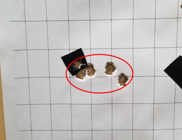

Put some targets on MDF, and got ten rounds each of Driver's and Hornady's 174gn bullets for testing tomorrow. Same 38gn charge of AR2206H.
Also checked if the screws were still tight on the Arctic Fox mount, got just a few degrees on both screws but they were pretty tight.
174gn Hornady FMJ 38gn AR2206H.jpg (221.53 KiB) Viewed 7122 times
174gn Driver Bullets 38gn AR2206H.jpg (219.05 KiB) Viewed 7122 times
174gn Bertram Bullets 38gn AR2206H.jpg (215.28 KiB) Viewed 7122 times

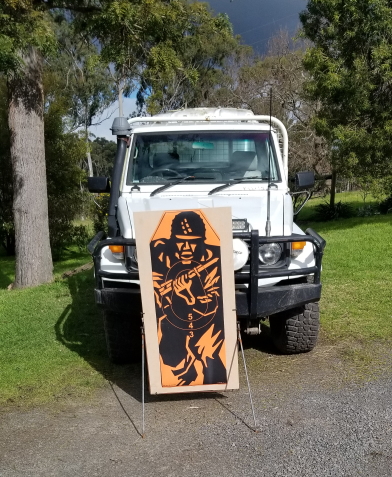

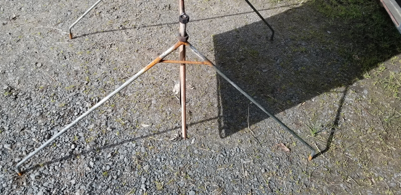

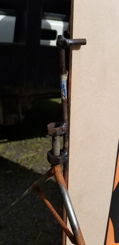

Made a very simple target frame just now.
Three pieces so it's cheap, very light, lays flat, and is not too awkward to carry up the paddock. The main frame is a simple U-frame of 6mm rod, sprung so you pull it apart to slot the target in then it hangs onto it. I made the "U" 580mm tall and 600mm wide so it'll hold boards 600mm or taller. A couple of big nuts on each side to drop over the bayonets on the A-frames simply because I couldn't be arsed looking for some tube :-)
The targets are held in by short lugs of 6mm rod welded to the U-frame. Will fit 6mm MDF or anything thinner.
A pair of A-frames with bayonets on top to drop things over. Was considering putting some feet on it but I thought it might be better to have the option of spiking them into the ground in case of wind - I'll see if that works.
If it works I'll make some more in different sizes.
Cost about $20 in steel from Bunnings and some welding rods.

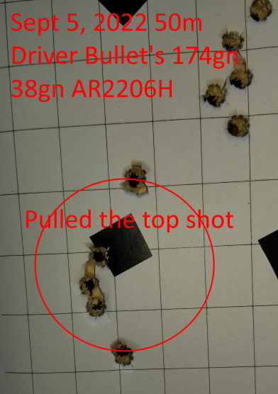

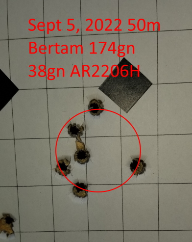

Got out this arvo to test the Driver's and Hornady's alongside the Bertram's.
First I fired a 5rd group with each but I wasn't happy with my shooting position so didn't place much value on the groups.
I started with the Hornady and although I don't think I pulled any, the one to left may have been. Then the Driver's in which I badly pulled one shot, then the Bertram's which were fairly neat. The bloody safety is flicking itself back under recoil with every shot though. I remade my position and taped the safety out of the way for the second round. I also made a scope adjustment as all three were shooting to the right.

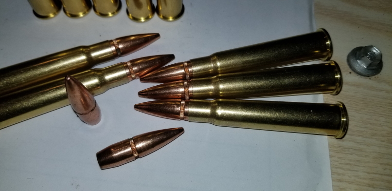

The Bertram's are my case life test brass. I trim them all to 2.217" every time before loading. After the fifth firing they've stretched to 2.218" to 2.219", after neck-sizing they're 2.220"-2.221", so another .003" trimmed off them - that's a total of .022" minimum now trimmed off these. No obvious external indication of separation though yet. This 6rd group of Bertram's was the final group, and it was off to the right again so it's possible the scope mount moved. I didn't have any more ammo with me to check it though, and the group itself wasn't terrible.
The Driver's bullets shot pretty well also.
And the Hornady's were very good.
I received another 500 Hornady's this morning. They're bulk that are rebagged in plastic. Two bags tore in postage but were encased in bubblewrap so none went astray. I boxed them in 50rd plastic boxes.
The 38gn AR2206H load seems pretty good with all three bullets so I'll load some more of each and try them again. They don't shoot to the same point so they're not interchangeable, but with a sight adjustment to suit, any of them will be more than adequate for this sort of competition, or for hunting.

36gn and 38gn. 36gn is the "standard" load I'm using with the 150gn so I used it to get a base velocity with the 174's, and I already explained my methodology for choosing that, I saw a two-digit number starting with a three floating by on the breeze so I grabbed it. Velocity was too low so I upped it to 38gn and it was good. If I decide I do need some more out of it I can seat the bullet another .100" or more, but I think I'm happy with where it is now.
As for distances, I didn't have any faith the scope mount would work, so I started at 50m, and the mount didn't work so I had to remove it. Now that I replaced the screws it appears to be holding zero quite well, although, as I mentioned, it's possible it shifted at the final round of the Driver group as the Bertram group is quite a long way to the right. The odds are steep that it could choose that specific shot to move, and still throw a decent group, but it's possible, and I didn't have any more ammo to test it with. It was also handy that I had a bench set up from testing the Aguila 60gn .22LR ammo at 50m at the house. And, being a .303 it doesn't shoot such tiny groups that you wouldn't be able to tell that one bullet or charge shoots better than others at 50m. The groups I shot yesterday are hanging around 30-35mm or two-minutes, which I'm pretty happy with. A neighbour currently has his horses roaming the paddocks near the house, and I hate shooting around horses, they're mental. So I'm shooting in the bush on our middle block, where it's isolated from wind. This restricts me to having to shoot prone, lying downhill while shooting uphill, which is far from comfortable. Until I can clear some dead branches well above head height I'm working with the limitation. I'm sure I can shoot the branches off with 12ga. birdshot but I keep forgetting to grab a gun when I take the rifles out there. Once I clear those then I can take a standing and sitting bench out there and should be able to clear foliage to stretch it to 200m, and still be isolated from the wind. A neighbour has Parkinsons and is a lifelong smallbore competition shooter (still licenced), so I want to make this spot accessible and comfortable to take him out there as well.
The plan now is to shoot perhaps ten or twenty rounds of all three loads at 50m to see if one bullet is measurably and consistently tighter than the others. Then pull the scope zero the iron sights to that one at 200yd/180m - the closest military shoot I'm aware of is shot at 100yd, but only requires holding a few inches low on the target with a 200yd hold.
The Hornady is looking better to me so I'll likely use that one for actual competition and use the Bertram and Driver for practicing.

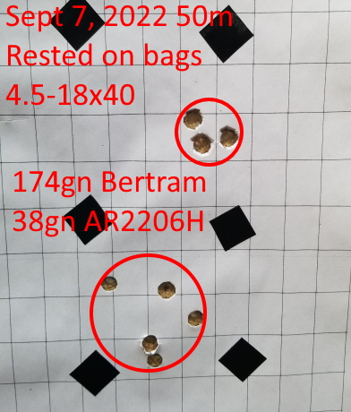

Your groups aren't terrible - about standard for a No1. Probs around 4moa? (which was spec). Patterning looks pretty ok. Time and again i witness the POI change over a couple of stages as the barrel heats, particularly noticeable at distance. Not sure about the AF mount - I've not had a lot of luck with them myself. A few very experienced shooters have told me they won't do much better than "minute of man" at 300m, but I'm not convinced it's the mount, rather the hot barrel.
Re: .303 shooting
Post by bladeracer » 06 Sep 2022, 12:51 pm
in2anity wrote:Your groups aren't terrible - about standard for a No1. Probs around 4moa? (which was spec). Patterning looks pretty ok. Time and again i witness the POI change over a couple of stages as the barrel heats, particularly noticeable at distance. Not sure about the AF mount - I've not had a lot of luck with them myself. A few very experienced shooters have told me they won't do much better than "minute of man" at 300m, but I'm not convinced it's the mount, rather the hot barrel.
Yes, I was surprised when I measured them to find they were tighter than they looked. Excluding the fliers I called, the groups with the Driver and Hornady are around 32mm, or just over two-minutes, the 6rd Bertram group is only 43mm. The 4rd Hornady group is 28mm.

Only fired 15rds of Bertrams today mainly to check the scope. I took a table and bags out today which was far more comfortable and far more stable.
I think any issues now are due entirely to the scope mount shifting.
G wanted to test his W748 loads as well.
First three went fine, then number four went fffttt again, bugger, another melted turd of powder left in the case.
Lodged the bullet 12mm into the rifling and I didn't take a rod out with me.
I filled the barrel with .22LR cartridges to push on the bullet but it needed more than I was willing to put into it :-)
He's going to shoot some more in hopes that that might've been the last bad one, and then try some filler material to try to keep the powder against the primer. If that doesn't work we'll try magnum primers, and then I think we'll give up on Winchester powder and switch to AR2206H.

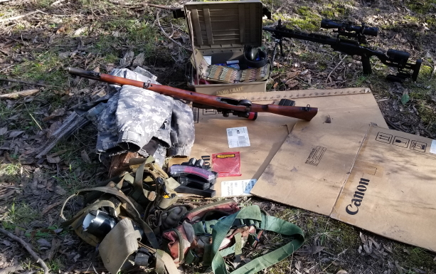

We got out again this arvo.
G loaded ten rounds each with magnum primers, and on standard primers, with an over-powder card of tissue paper then loose dacron filler. All twenty fired just fine, though the dacron left floating fibres in the air about two metres in front of the muzzle - like you get blowing on a dandelion :-)
But hopefully the magnum primers have fixed the issue of the W748 melting rather than burning. Groups were all around 1.5".
I fired my case life test rounds for the sixth time and they are starting to get tight, so probably best to bump the shoulders every five firings. I'll bump them just enough to chamber before loading them again. Measuring after firing they have stretched no more than .001", so after bumping and neck-sizing probably another .003" to trim off I guess.
Then I tried my 1932 M91/30, starting with five rounds of subsonic 174gn which was very pleasant after the .303 :-)
At 50m they dropped about 200mm lower than the full-power loads, which were about 80mm high. Then we each put ten rounds of full-power loads through her. These are old 174gn Super SP's on 40.5gn of AR2206H and both of us grouped them around 1.75". I'll load up some Bertram's, Driver's and Hornady's for her and see how they shoot.
