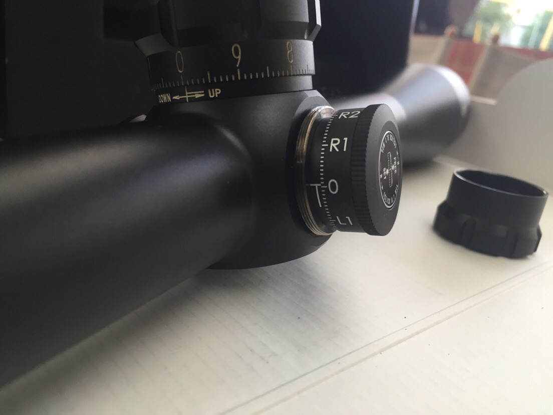

Post by MalleeFarmer » 05 Jun 2016, 10:40 pm
Cheers Gwion. Missus ended up getting me a scope for our anniversary got a 4.5-18x44 Bushnell LRHS so far the clicks are much more crisp than my ET6245FG and the turrets are more user friendly and have zero stop and glass is definately better. Looks pretty good. At $1400 it would wanna be even though retail is 2k. Also the GRS stock (Gwion suggested them earlier in the post I'd never heard of them before) arrived and my EGW HD mounts. All I need now is a barreled Action to put it all together on and I'll be right..

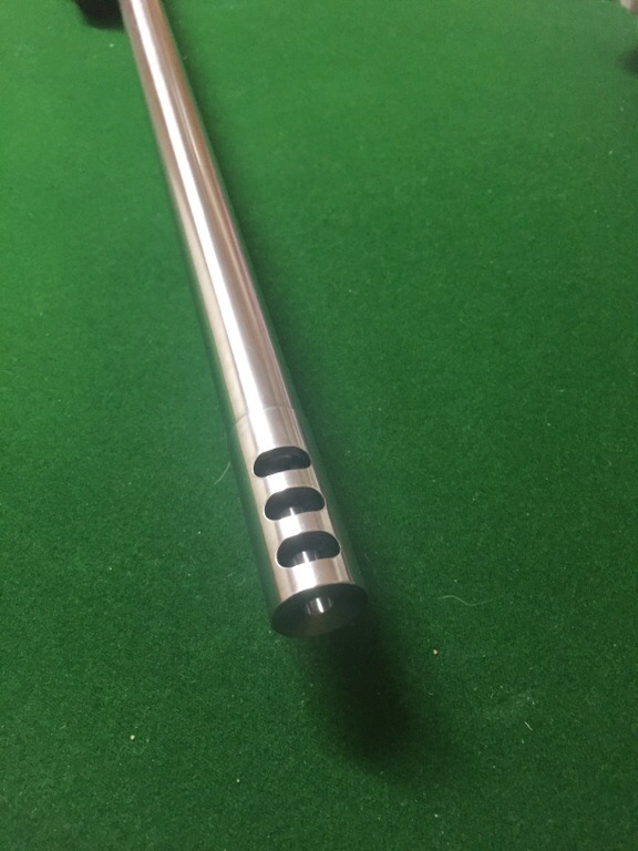

Well I have my barreled action back and I'm like a kid at Christmas. :clap: I couldn't wait to get it all together so I have assembled it finger tight and admired it for the last half an hour. :D I have everything I need to start shooting except powder and bedding compound. :thumbsdown: I have got 2 boxes of 105 Amax and 1 box of 87gr Vmax bullets. And 100 pieces of brass to resize.
Here is an overview of my rifle now.
Howa SA blued.
Maddco Howa Varmint profile 1-8 twist barrel. With a ZCR brake. Chambered in 6slr

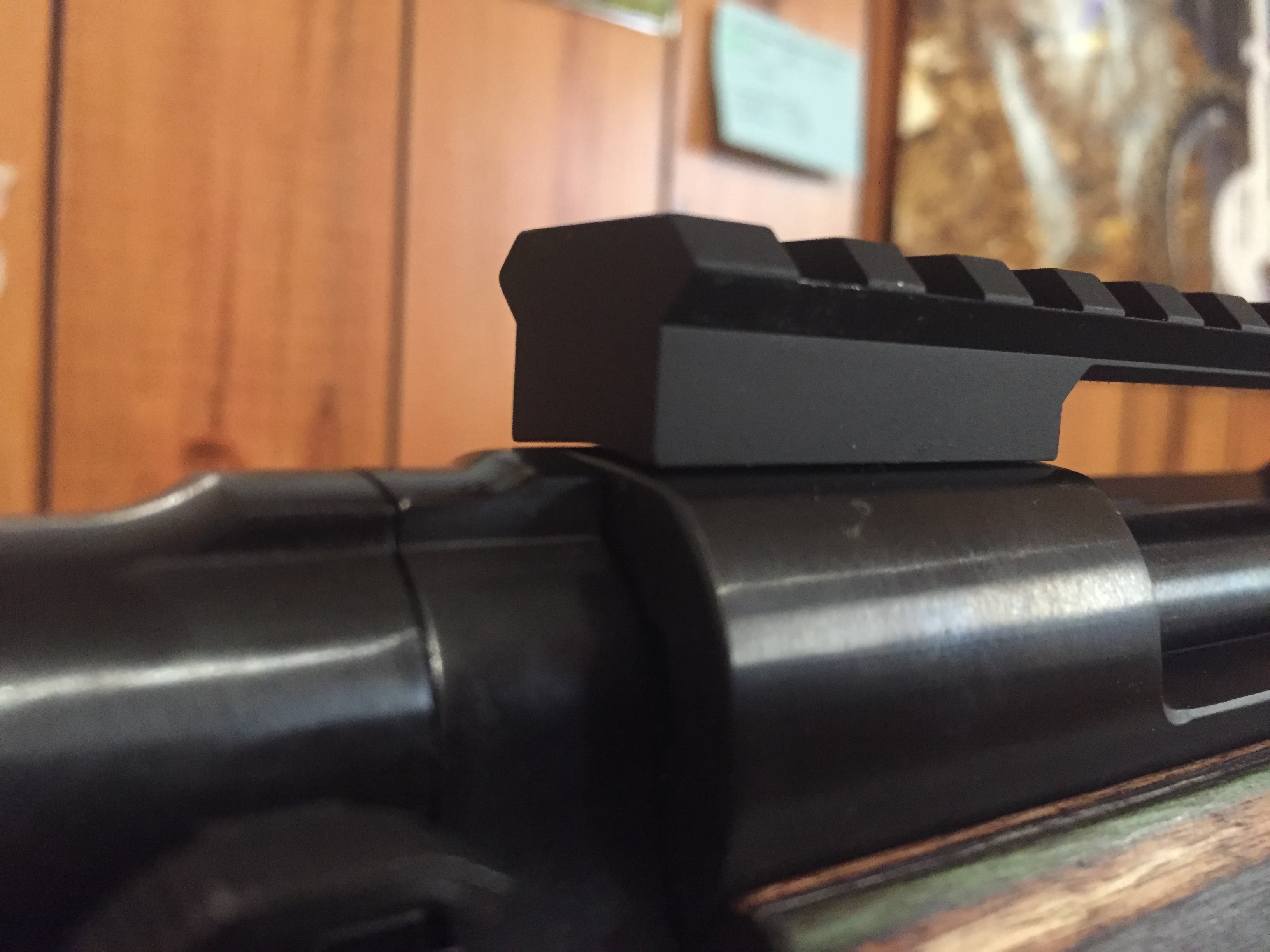

I will be bedding the action into the stock and will also be bedding the rail as there appears to be about 3-4 thou clearance at the rear of the rail when only the front screws are firm. And then I'll Lap the rings and mount the scope. :drinks: :drinks:

I do like the stock, and it looks like the hand would hold very comfortably with that contouring...
Also the brake looks rifled?? or is it the shadows......

Post by on_one_wheel » 11 Jul 2016, 2:11 pm
What a great looking rifle.
That barrel looks like it's got some serious length.

Gwion, definately went straight to the pool room... Then promptly to the safe! I can't wait to start developing loads either even more to the point I can't wait to find a good load and start busting bunnies and foxes with it. Perhaps the odd long range "sighting in session"
On One Wheel, the barrel does look oddly long doesn't it. I think it's a combination of the shortish forearm (2" shorter than boyds) of the GRS and the almost seamless transition from barrel to brake. I never liked the big brakes with the wings out sideways. The barrel itself is only 26" +50 or so mm for the brake.

Post by MalleeFarmer » 11 Jul 2016, 8:14 pm
Genesis, nah it's just the shadows I almost had to go have another look.

Re: Varminter Build or Factory buy
Post by MalleeFarmer » 13 Jul 2016, 10:50 am
Why I'm waiting for my bedding compound to show up.
Post by MalleeFarmer » 13 Jul 2016, 10:51 am
Finally realised why people bed their rails and Why I'm waiting for my bedding compound to show up.

Post by Gwion » 13 Jul 2016, 12:42 pm
That doesn't look right at all, mate. I'd be looking for a replacement. My rail sits nice'n'tight on my Howa action.

Post by MalleeFarmer » 13 Jul 2016, 2:33 pm
I thought that too but if you only firm up the front screws it may be the same. When I sat it on without tension it sat perfect and it took no pressure from the rear screws to get it to seat. Having said that I'm not overly experienced with mounting rails so I might put this out there to those in the know in the gun smithing section.
Post by Apollo » 13 Jul 2016, 3:10 pm
That is what happens with this type of Action design .. ie Howa / Remington with the rear being lower. Mass produced actions aren't exactly all the same and nice and true. The advice is all over the net to check the alignment of the rear by just installing the front screws.
I put a rather expensive high quality Steel Ken Farrell Rail on my custom Remington 700 and the instructions that were supplied said exactly that..use the front screws to check the alignment of the rear and mentioned that in the majority of cases it will need bedding otherwise you will pull the rail out of shape.
I used JB Weld for my bedding compound, Kiwi Clear Boot Polish as the release agent and WD40 to remove surplus compound before it set. It was fiddly but was all worth the effort.
I had a much stronger Ken Farrell Rail on my Tikka T3 .. ie no cutout for the port. I found that the machining of the top surface of the action was not perfect and when the rail was tightened it pulled the action out of shape so much so the bolt was difficult to cycle.
Post by Gwion » 13 Jul 2016, 5:48 pm
Bloomin' heck. Better check mine and bed it if necessary. All looked good when I installed it, though.

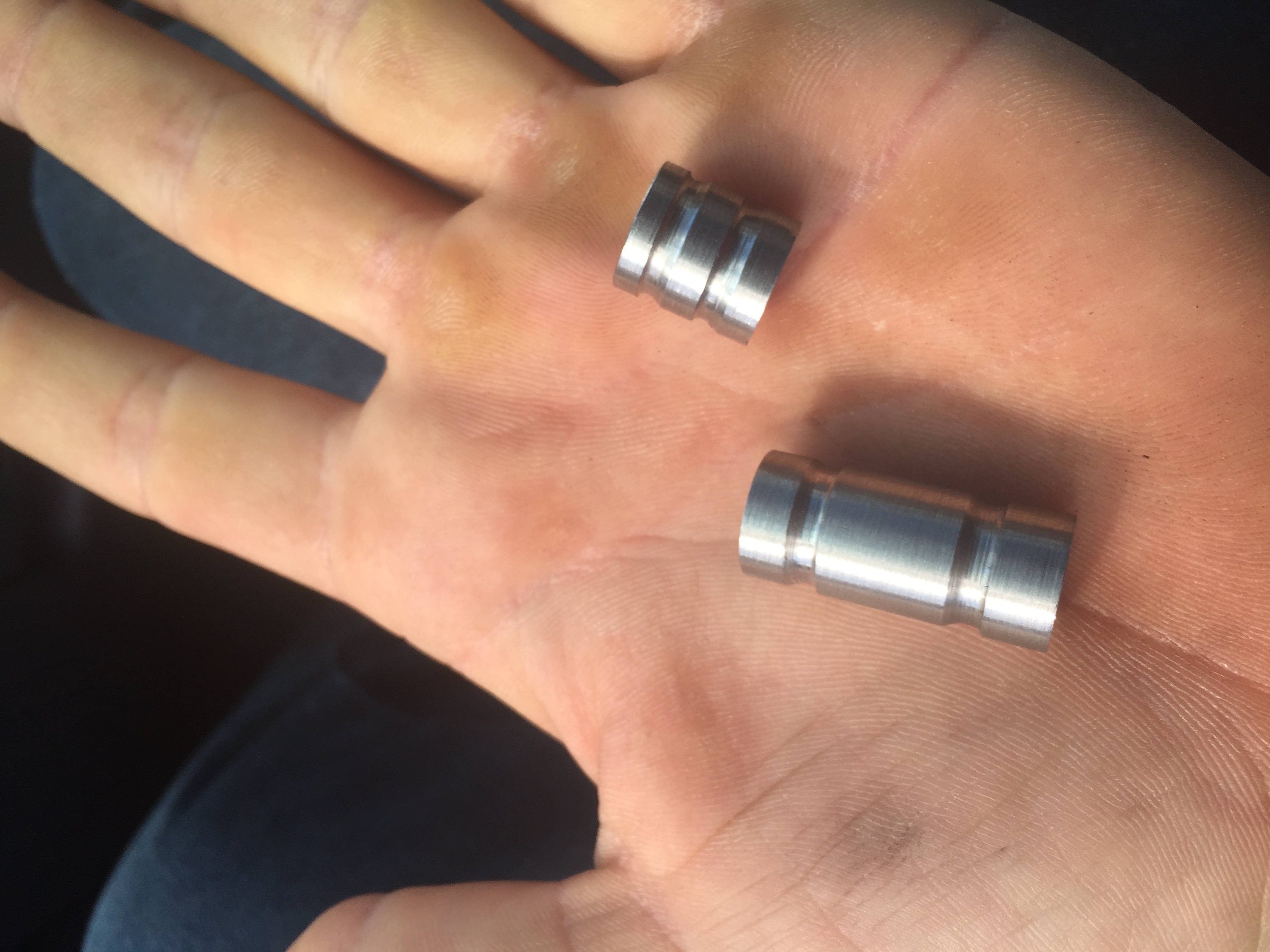

Post by MalleeFarmer » 25 Aug 2016, 1:57 pm
Pillars are done just need to fit them.
Stainless Pillars

Post by bigfellascott » 25 Aug 2016, 3:58 pm
Nice one mate - a friend of mine is machining up 3 sets for my howa/boyds
