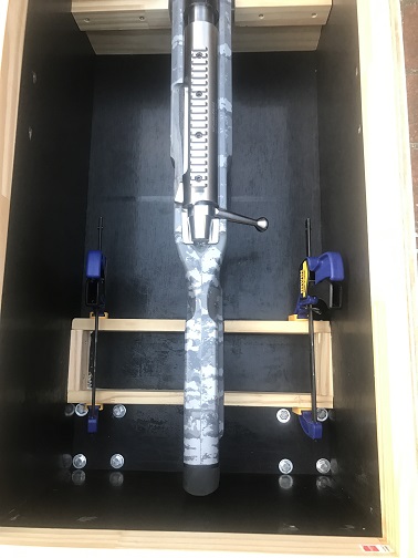

Post by brett1868 » 26 Mar 2017, 9:56 pm

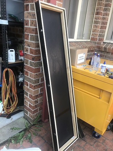

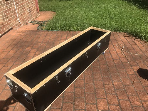

Spent a solid 2 days making a case and should be done by Tuesday evening. Timber is 17mm form ply which I chose for its price, strength, rigidity and it comes in big sheets. I made a box using PVA and 10G x 40mm wood screws then screwed a guide around the outside to keep the lid square when cutting the circular saw. I cracked the $hits swapping the drill / screw bit all the time so I drove to Bunnings and bought another "Drill" skin which saved me a couple hours as least. I then used some pine to form a lip on the inside to prevent moisture ingress and recessed the pine in the lid so I end up with 2 mating surfaces. I sealed all the edges with PVA and will stick on some foam to keep the environment out. I was originally planning to use a hinged lid but getting a good seal would be too much work so I went with a fully removable lid. To keep the lid on I used 8 60mm S/S catches which are adjustable so I can increase the clamping force as the seal compresses. To finish off the outside I fitted 8 handles, 75mm wheels (2 fixed, 2 rotating with locks), using stainless steel nuts, bolts and fittings where possible.

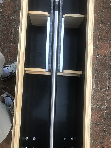

Next task was to build the internal brackets to support the monster, I've designed it in such a way that the fore end block will lock in place, preventing any fore / aft or vertical movement. The butt will get a clamp over the top and once I screw the barrel in I'll make the supports for it. Everything will then be braced in such a way to prevent any timber from splitting. When I get back and have more time I'm thinking to gladwrap the rifle and fill the case with expanding foam if I can find it in commercial quantities.
I'll do another update from Mildura this coming weekend with some feedback on how it shoots :)
1800x400x400
The Lid
Rear Support
Fore end Support
Overall

Post by bigfellascott » 26 Mar 2017, 10:45 pm
Nice Job Brett, I see it has wheels on it (good idea) all ya need now is a crane to lift the bugger up into the ute. :lol: enjoy it mate and I look forward to hearing how it all goes down south. :thumbsup:

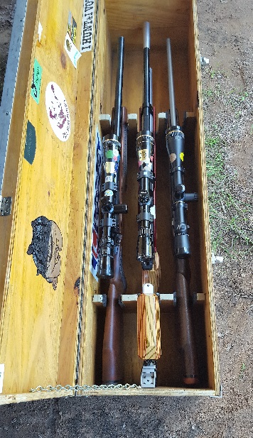

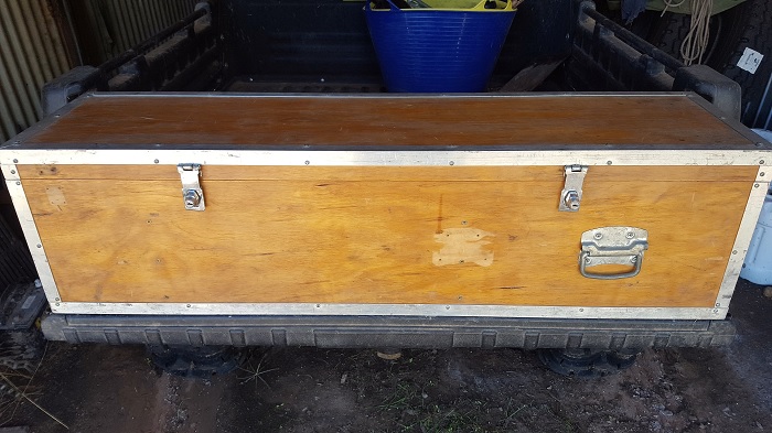

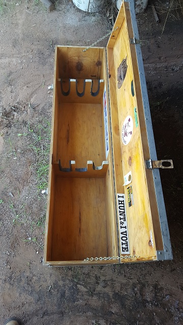

Here's some pics of one I made years ago for carrying multiple rifles to competitions. It has been re-modeled from original form by cutting about 250mm off one end. ( I made it too long to start ) This has carried my rifles all over the country without any damage for the last 18 years and has the added bonus that you can stack stuff on top. A 6mm steel cable threaded through the handles and locked to the structure of your vehicle satisfies the authorities also.
I've actually made another one identical to this without any frame-work inside which I can get about 6 lever-guns in, in rifle bags, needed when all three of us in the family were shooting that.
Dimensions are: L = 1200mm, H = 300mm, W = 300mm.
Bit small for your "Project 50" but the photos show the aluminium angle that protects and strengthens the corners.
Placing the side handles diagonally opposite each-other makes it easier to carry by yourself, if somewhat heavy. :D
