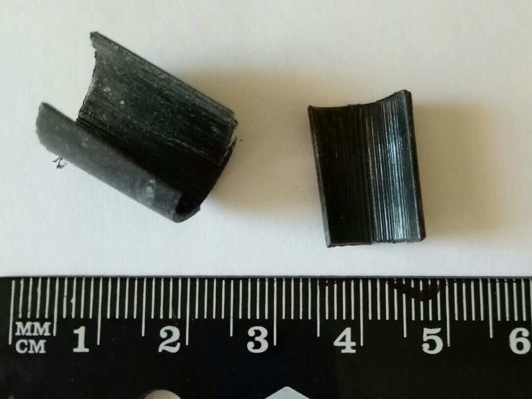

Some thing firm. Cardboard, plastic, hard rubber.
My solution was a small piece of plastic pipe used in gardens. Cut and small piece removed to create a 1cm long U. Then placed under the barrel.

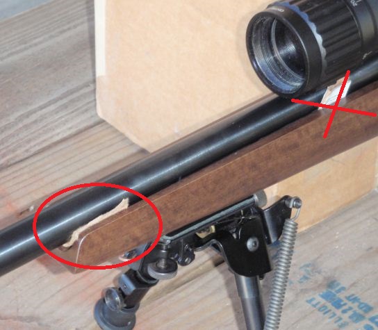

Any chance of a clear pic looking down at the inletting.?

You mean this?
I will contact them after my next range visit where I test the action bolts with my torque screw driver and perhaps shimming the barrel.

Post by Wylie27 » 09 Dec 2016, 7:27 am
With the shim. An out of the box solution may be required... eg small piece of plastic with a hole drilled and shaped to fit the space etc
Don't lose hope.. this is part of the fun of shooting.. no mass produced rifle doesn't need a tweak... some just need more than others..
Is it the light or does there appear to be rubbing marks on the wood in several places?

Post by Tomek » 09 Dec 2016, 7:43 am
Its the light. I tried to show how its evenly smooth. One thing I tried yesterday was to tighten the bolts and then while vertical, loosen then slightly. I could fell the action moving away from the stock. I read that it shouldn't move at all but it just seemed like it being tightened or loosened from the stock.
I also looked at the barrel screws. They were very tight. I lubricated then and put them back in at 32lbs.

Post by Gwion » 09 Dec 2016, 8:31 am
32lbs is a lot for a 22lr.
If you can't use a washer you just need to find a way to lift that one point a little: like the suggestion above or even a folded piece of card board.
The inletting might look smooth but my thinking is that it may actually be slightly higher in the middle, so as you tighten up the screws, stress is being placed on the action. This will cause the bolt to seem tight and will effect the precision of your rifle.
