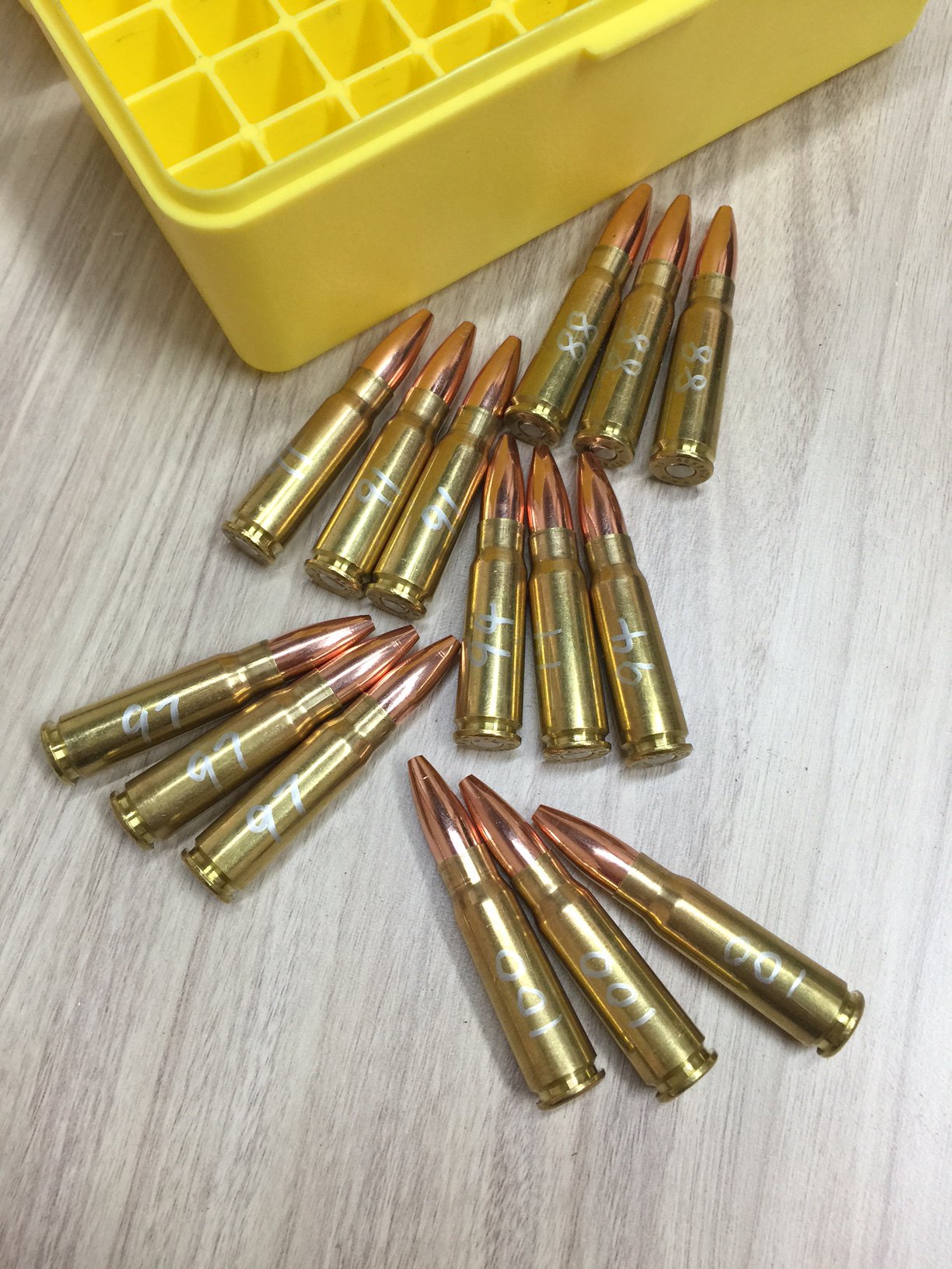

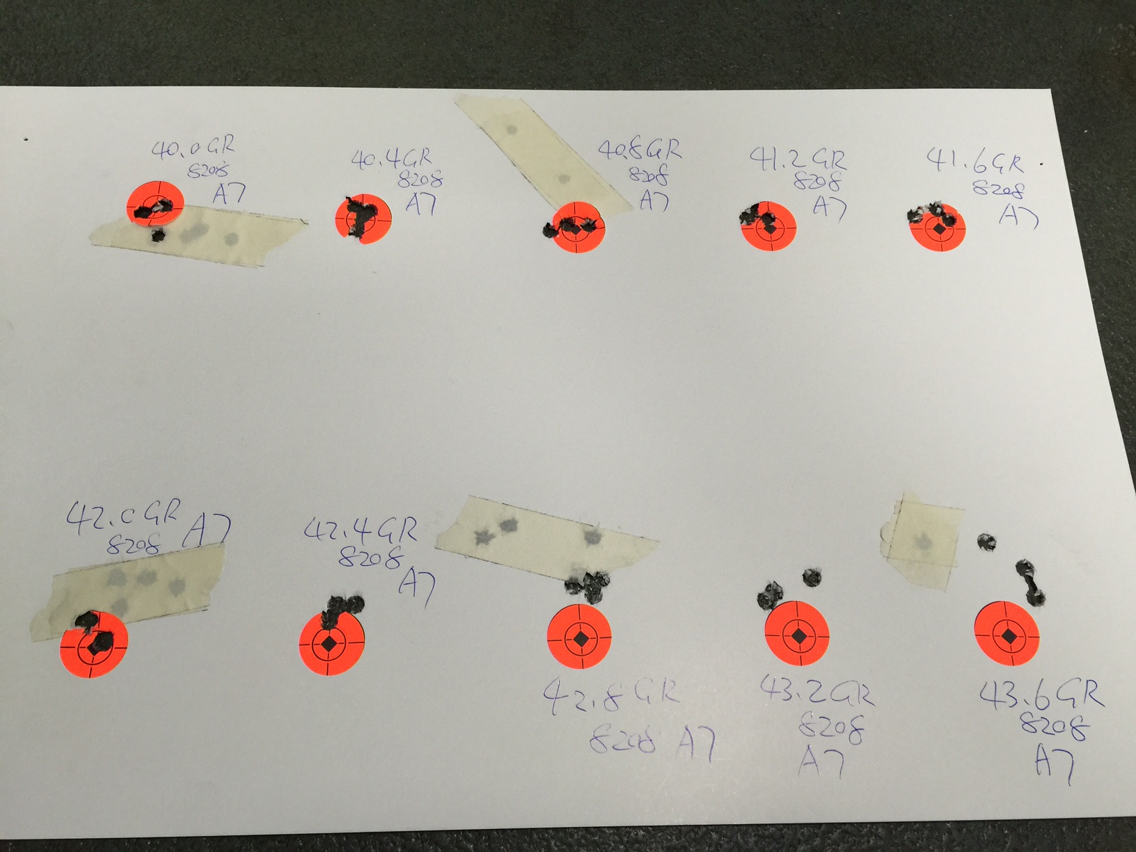

I'd personally just load up 15 at 28.3 and confirm with 3 groups of 5. Looks consistent through that range where as other loads spread on either side, if that makes sense. This should give you a little leeway for changes in conditions or 0.2 grain variation in charge.

Gwion wrote:I'd personally just load up 15 at 28.3 and confirm with 3 groups of 5. Looks consistent through that range where as other loads spread on either side, if that makes sense. This should give you a little leeway for changes in conditions or 0.2 grain variation in charge.
good idea, will try, thanks
also will try trail boss, I don't know why the reloads drop few cm compares to the factory ammo and looks like it stay there no matter how much powder loaded, maybe it is due to the different projectile or maybe the 8208 burning rate is too slow for the 7.62x39, especially for the sort barrel carbine?

Post by Gwion » 09 Jul 2017, 8:41 pm
I wouldn't be too worried anout that different POI. As lol Ng as it is consistent and you can learn its drops. If it is s concern, as above, try a different powder.

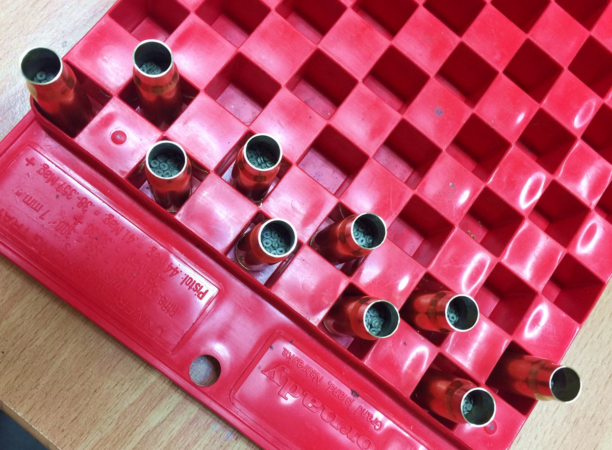

will update once get chance to try, full capacity for 762x39 case is 10.0 Gr TB, I‘ll try 8.8---9.1---9.4---9.7---10.0’ these 5 groups, best accuracy should be around 9.4, will see :lol:

Gwion wrote:I wouldn't be too worried anout that different POI. As lol Ng as it is consistent and you can learn its drops. If it is s concern, as above, try a different powder.
my SAKO A7 308 looks alright, the POI almost the same for the factory hunting ammo, factory target ammo and reload, the bad thing is maybe the barrel is too good, reloading test looks like the same, hard to tell which is the best point, any idea? which load I should try? maybe 42.5 gr?

Hard to say. What range are those groups shot at?
Maybe try 3x5 each of 2nd from left top and 3rdfrom left bottom (on my phone hard to read charge weights).

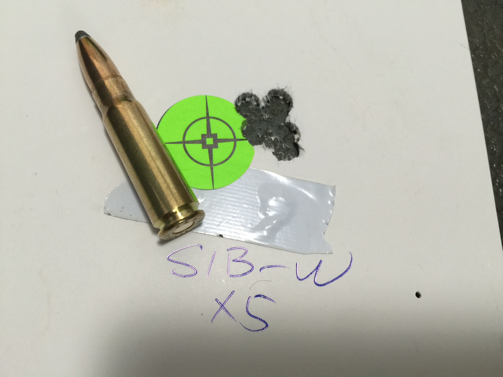

the best factory ammo 5 shot(indoor 50 meters), S&B ammo is good but different batch performs different, the plastic divider in the ammo box white color batch is much better than the green color ones

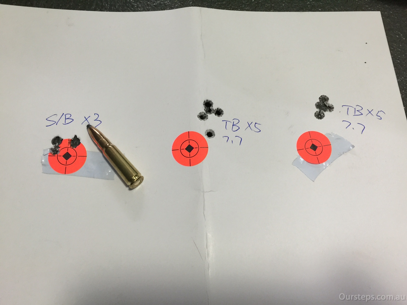

TB load, 10.0---9.6---9.2---8.8---8.4--8.1, at max load it spreads a lot, getting better at 8.1, seems nearly there, next time try 7.9---7.7---7.5 each 5 shot to find out, the good thing is POI didn't change too much compares to factory ammo

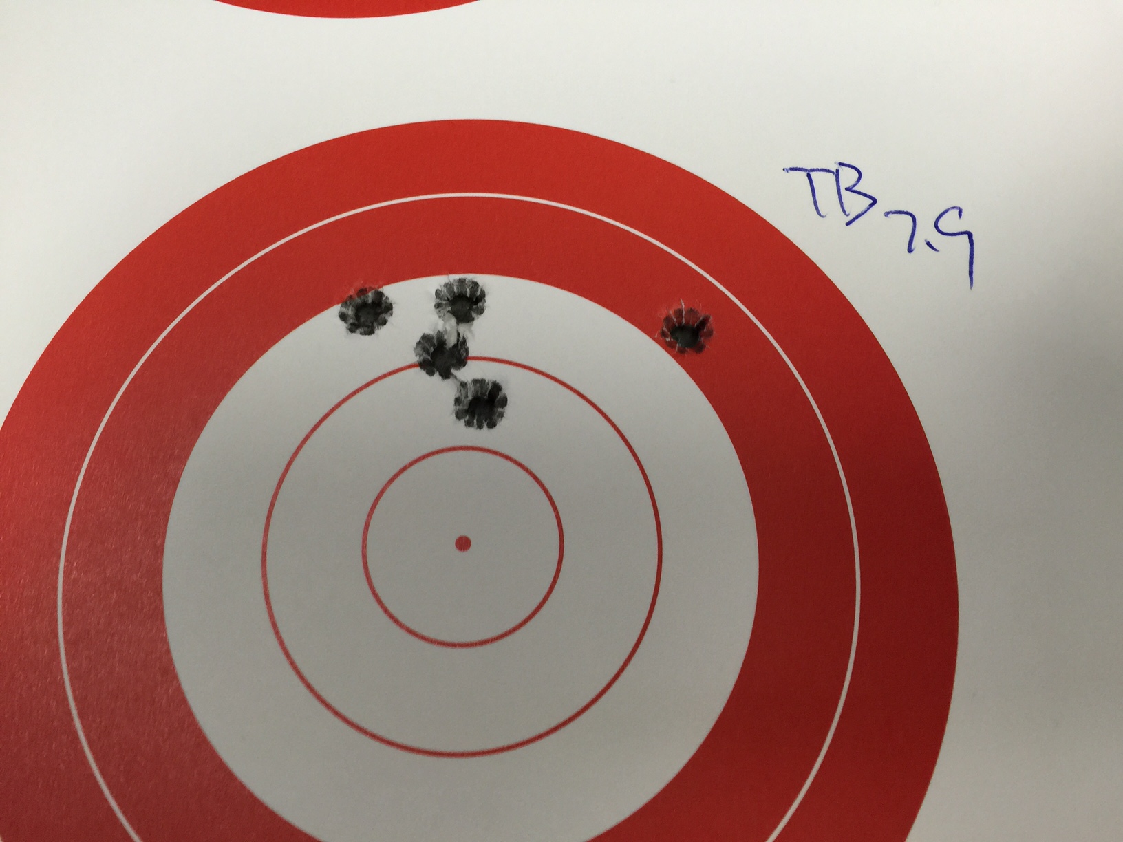

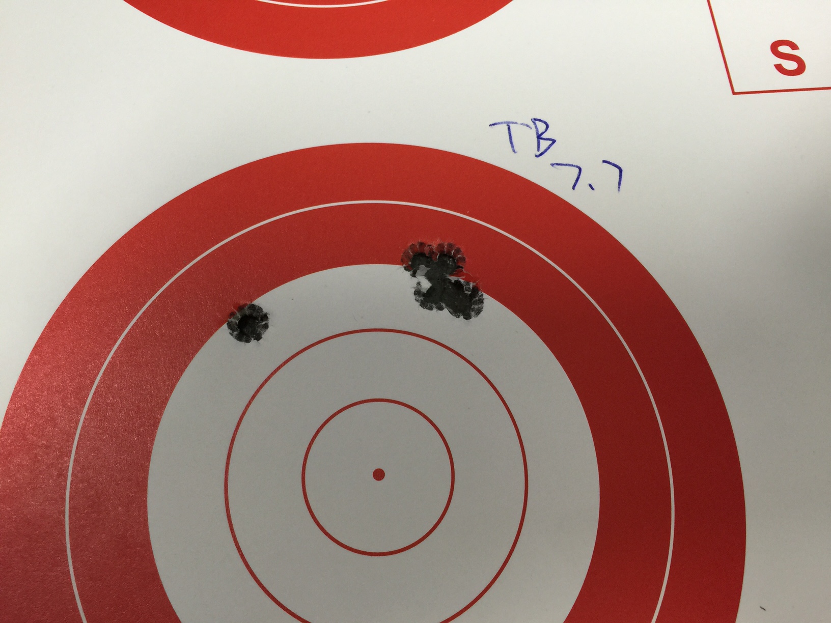

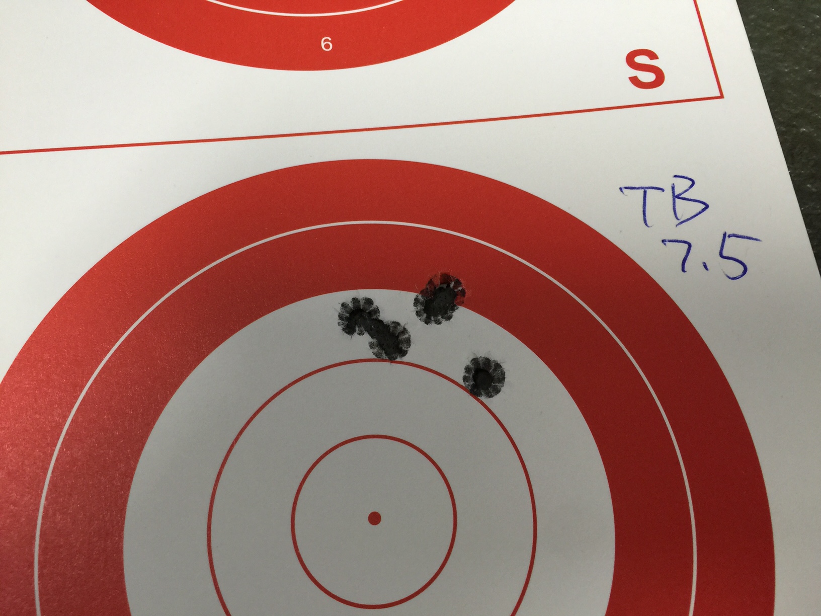

Post by SHV » 10 Aug 2017, 12:20 am
Trail Boss test
7.9gr, 7.7 gr and 7.5 gr
seems 7.7 is good but got one fly and it's far away from the main group cluster :oops: next time will try 10 x to find out if it's the best
SHV
Posts: 1780
Re: CZ527 carbine 7.62x39
Post by in2anity » 10 Aug 2017, 12:21 pm
Nice SHV - remember TB isn't renowned for it's pinpoint accuracy. It's advantage comes from its economy and less wear-and-tear on your rifle.

Post by SHV » 10 Aug 2017, 4:03 pm
in2anity wrote:Nice SHV - remember TB isn't renowned for it's pinpoint accuracy. It's advantage comes from its economy and less wear-and-tear on your rifle.
reasonable accuracy will be ok, it is fun to shoot
SHV

got magnum primer to try 7.7 gr trail boss next time :lol:

forgot to say last time tried 2x 5 shoot, 7.7 TB with normal primer, first 5 shot is normal, last one is not to bad
