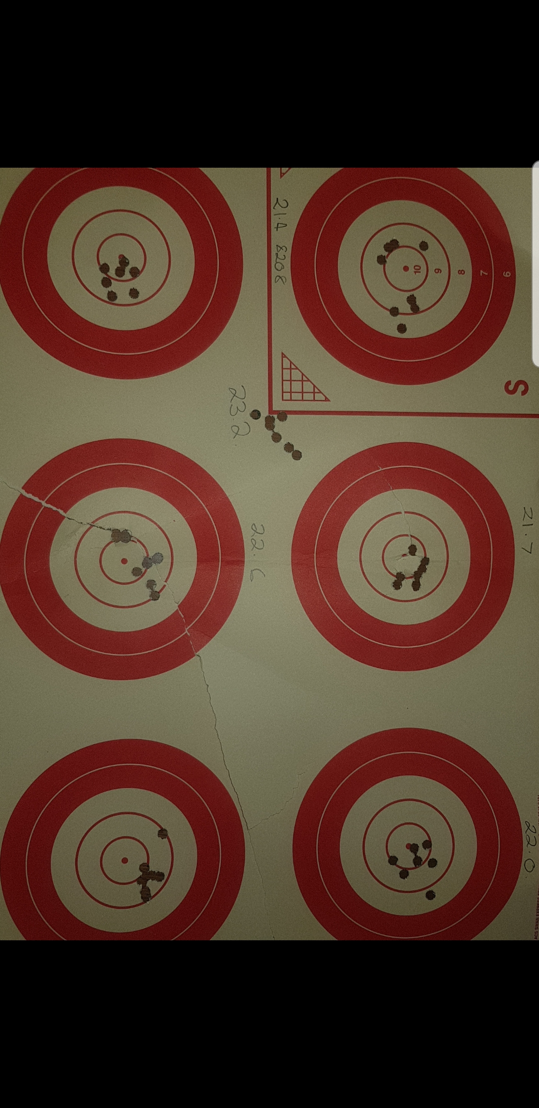

55gr super roos showing promise happy with what im seeing

AZZA'S HJ47 wrote:Has been a while since i saw this thread. I have a load also for 40g zmax as well as the 40 siearra bltz king thats good. I have some more to shoot tommorow hopefully find a load for 55g Sierra super roos that im happy with.
What twist rate did you get in your 222 again azza?
1-12 seems to like almost everything ive tried in it.
I got a 1-12 barrel of swan as well, 23 gn BM2 with 55 vmax or 23.5 with 50 gn Hornady soft point give very , very good groups

The thing I found with the change in twist from the original 1-14 barrel is my rifle likes projectiles with more bearing surface. Doesn’t shoot boat tails well, and it also likes a slower powder .BM2 over the ar2207 that it liked previously . Hope someone finds this information useful. Cheers

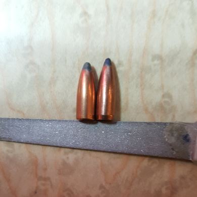

Found an old box of Australian made 222 projectiles in the bottom of my reloading box. Made by "Super Cartridge Pty Ltd" and google search says they folded in the late 1970's due to some sort of legal dispute over a patent infringement.
Comparing side by side with the Sierra Spitzers they are a little bit shorter and unlike the Spitzer which has a slight boat tail the Super has a completely flat bottom. Packaging of both bullets says 50 gns but on my scales the Sierra Spitzer is 49 gns and the old Super is 52 grains so they look to be a tad heavier. I was going to put them aside but I'll load up a few and see how they go. No point wasting them...

Will be interesting to see how they shoot mate. :D
Re: BSA CF2 222 on the way
Post by gordicans » 15 Jul 2019, 8:17 pm
bigfellascott wrote:Will be interesting to see how they shoot mate. :D
I'll let you know ... it would be a shame to waste some beautifully crafted bullets that some old Aust company went a lot of effort it make. My guess is they'll shoot just as well as the new fancy ones, but we'll see
