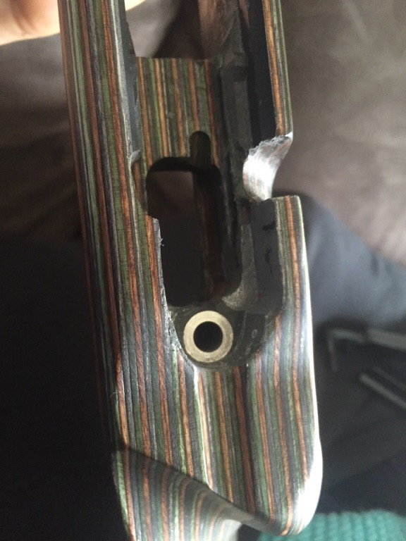

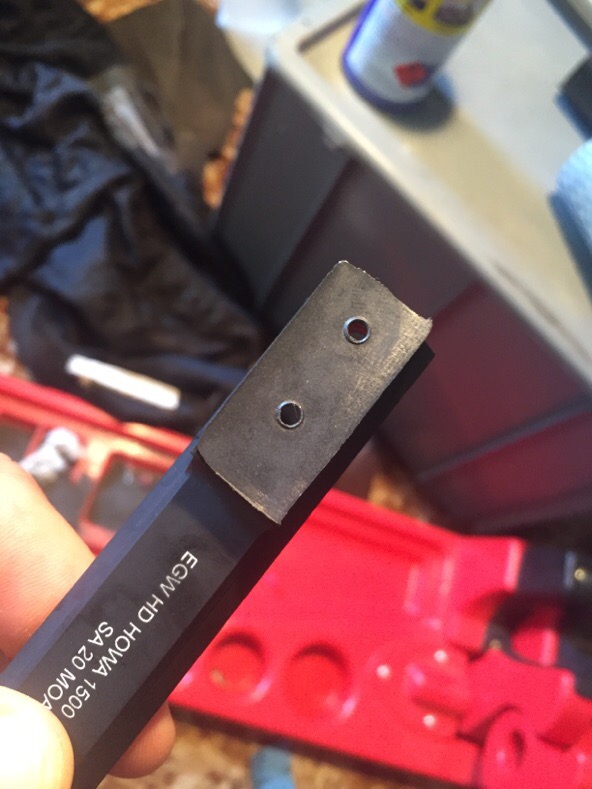

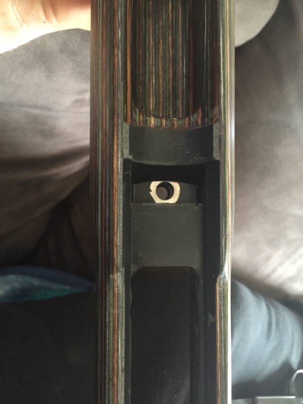

Getting close.. I have glass and pillar Bedded the rifle now and glass bedded the rail. Just need to get some lapping compound so I can mount my scope.
Ready to lap.
Bedded rear of rail.
Rear action pillar
Recoil Lug and front action pillar.

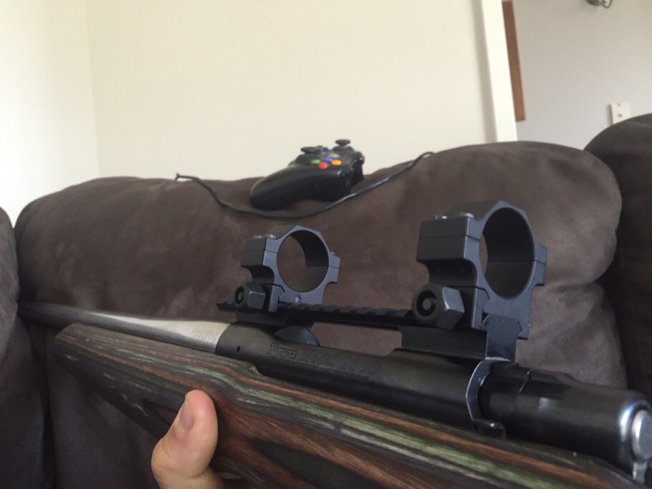

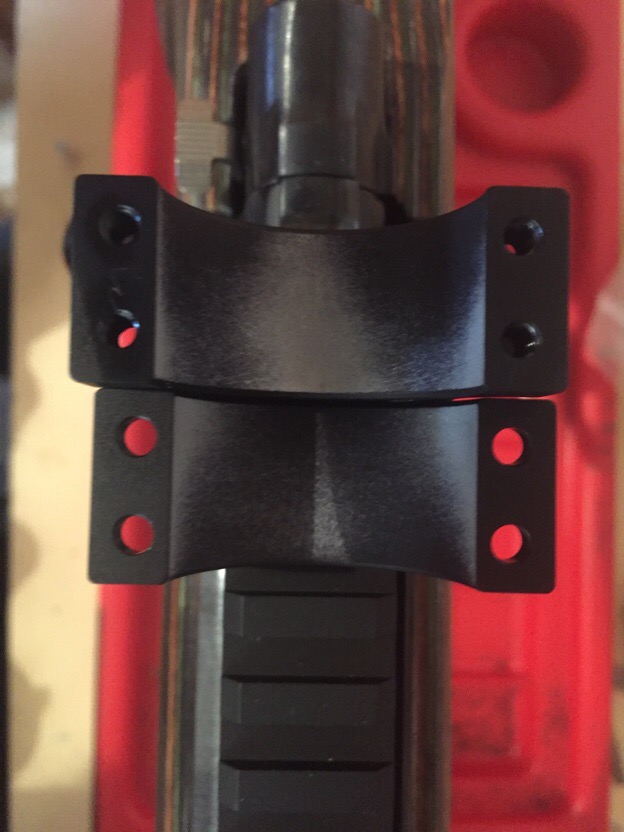

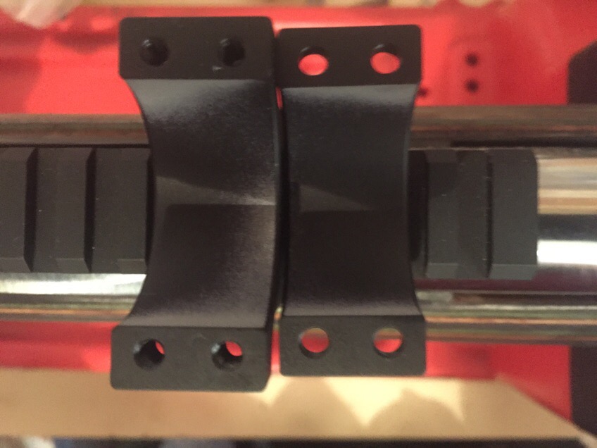

Post by MalleeFarmer » 30 Aug 2016, 6:15 pm
Rings Lapped... Used medium valve lapping compound By Holts seemed to work well but I should have used fine seemed too coarse and was very harsh while lapping. The triangle shapes in the middle of the rings is shadow not an inconsistency in the rings. All ready to mount the scope.

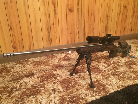

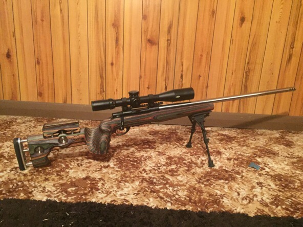

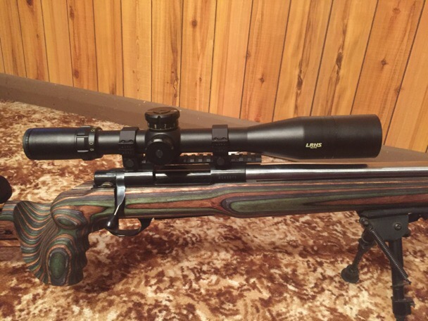

Post by MalleeFarmer » 30 Aug 2016, 6:26 pm

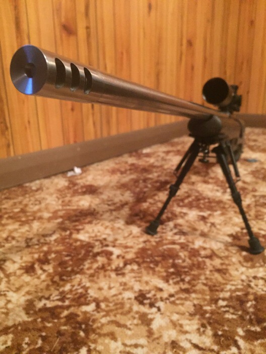

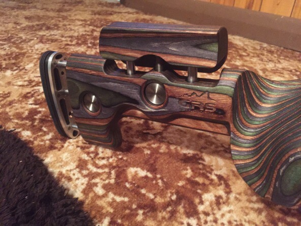

Scope is mounted and squared with the bore. Eye relief is set. LOP and cheek weld is set. First loads are ready to go. :thumbsup: Here's hanging out for my leg to be usable again.. :thumbsdown:
Here is some pics of the rifle ready to go.
MalleeFarmer
