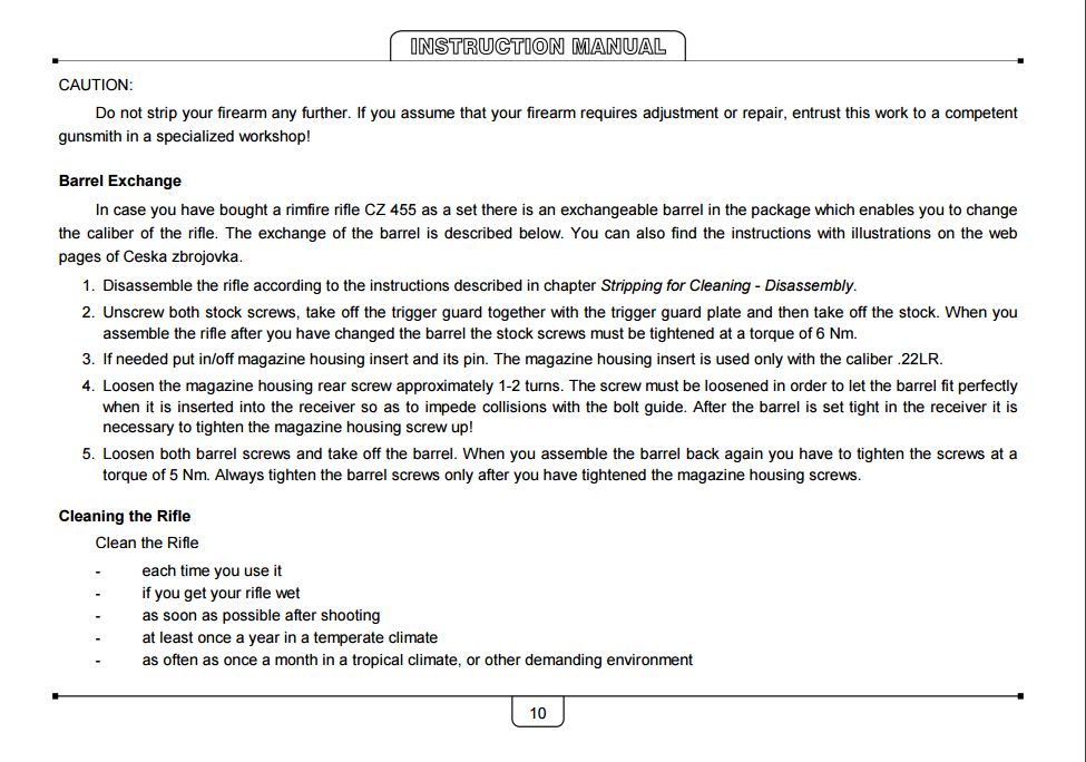

The manual states the action screws are 6Nm (53in/lb) and the barrel screws are 5Nm (44in/lb).

Re: Very Disappointed in my CZ 455. Is my 1st Rifle Faulty?

Post by bladeracer » 09 Dec 2016, 5:56 pm
happyhunter wrote:The factory spec for the 455 is 25 in/lbs. I'm betting the *was* nothing wrong with the rifle before the owner starting tampering with it.
Can you post a pic from your manual?
The only one I found states different.
CZ455 Torque.JPG (129.24 KiB) Viewed 10672 times

Post by Gwion » 09 Dec 2016, 6:36 pm
deye243 wrote:this is why I don't buy 2nd hand firearms 32lb bugger me that stock is stuffed now it is COMMONLY known that all settings (except for barrel threads)are in inch pounds
Clearly not commonly known by the manufacturer though...
http://cz-usa.com/hammer/wp-content/upl ... CZ-455.pdf
Bloody hell!
I think i'm going overboard when i screw my 7-08 down to 55"lb, and that is fully glass a pillar bedded. 53"lb is well and truly enough to crush the timber in the stock, causing bedding issues.

My point is jumping on a new owner for doing exactly what the manual dictates is just rude.
Whether you buy new or secondhand, odds are it's going to have been torqued to those figures by the manufacturer at least.

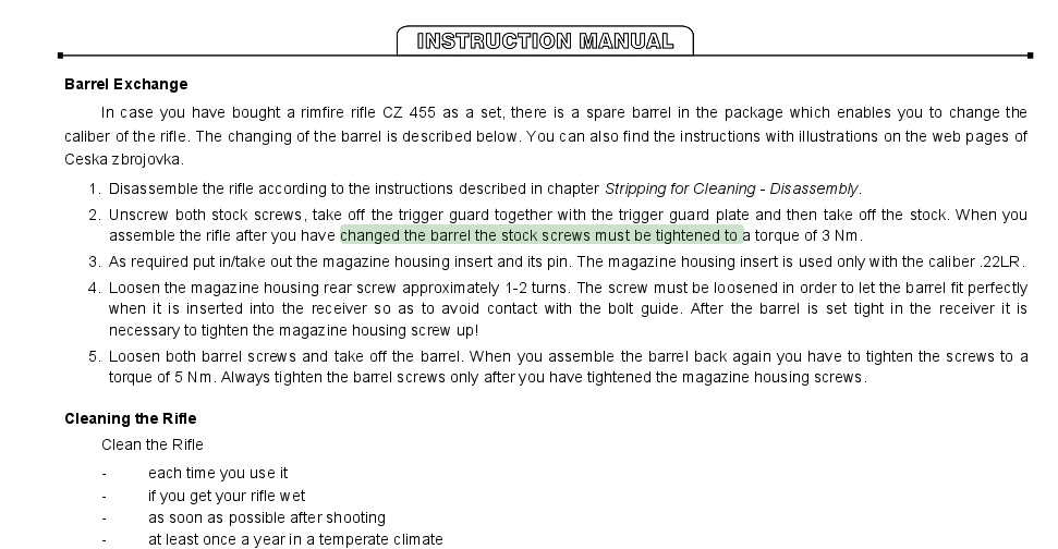

Post by happyhunter » 09 Dec 2016, 8:21 pm
Sure dude. You must have the miss print version. 3Nm is approx 25 in/lb. If you message the question to CZ they will respond "25Nm" for timber stocks. There is an updated manual available from CZ.
Post by bladeracer » 09 Dec 2016, 8:26 pm
Cool :-)
I wonder if he's got a claim then if the manual that came with the rifle has that same typo?
