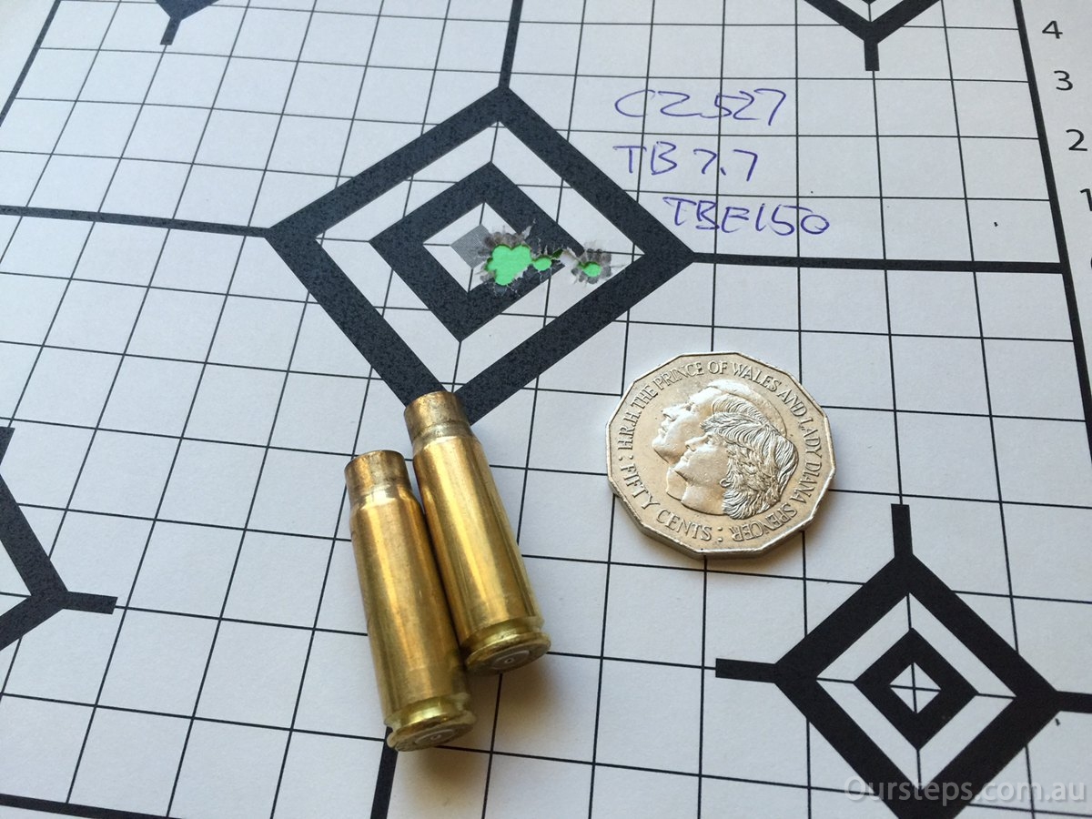

cz527 77tb.jpg (487.39 KiB) Viewed 7074 times
forgot to update, the 7.7 TB is good

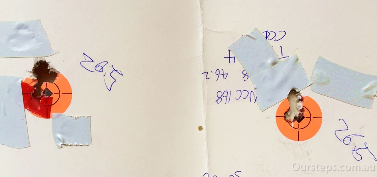

Post by SHV » 10 Mar 2020, 9:39 am
26.5gr 2207 TBF 2 X 5 shot
cz527 265 2207.jpg (174.81 KiB) Viewed 7124 times

Is that at 100m mate?
Re: CZ527 carbine 7.62x39
Post by SHV » 10 Mar 2020, 12:58 pm
that's St Mary's 50m indoor
SHV
