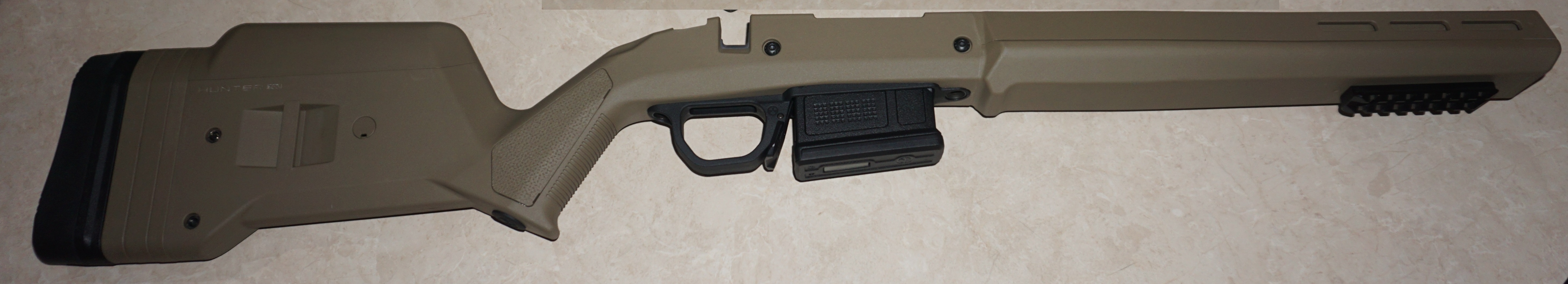

actually have a magpul 700 if you are interested lol just steeped up to a KRG chassis lol

Mate if you shoot at waneroo , i would be happy to bring it and a torque wrench out and stick it in the Magpul will straight up tell you if its the barrel or stock
