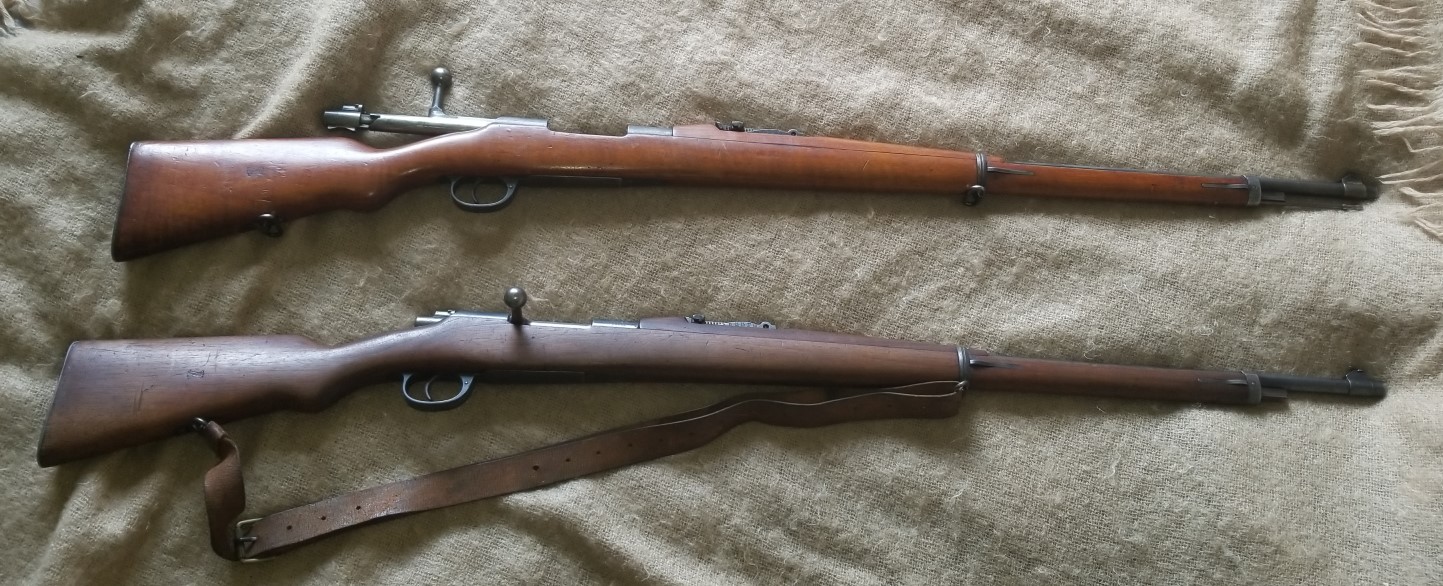

Post by bladeracer » 05 Jan 2019, 10:25 am
After five months and one day, I finally have them :-)

Post by bladeracer » 05 Jan 2019, 12:14 pm
JimTom wrote:Long wait mate. Are you happy with them?
Let us know how they go.
Over the moon mate, they're beautiful :-)

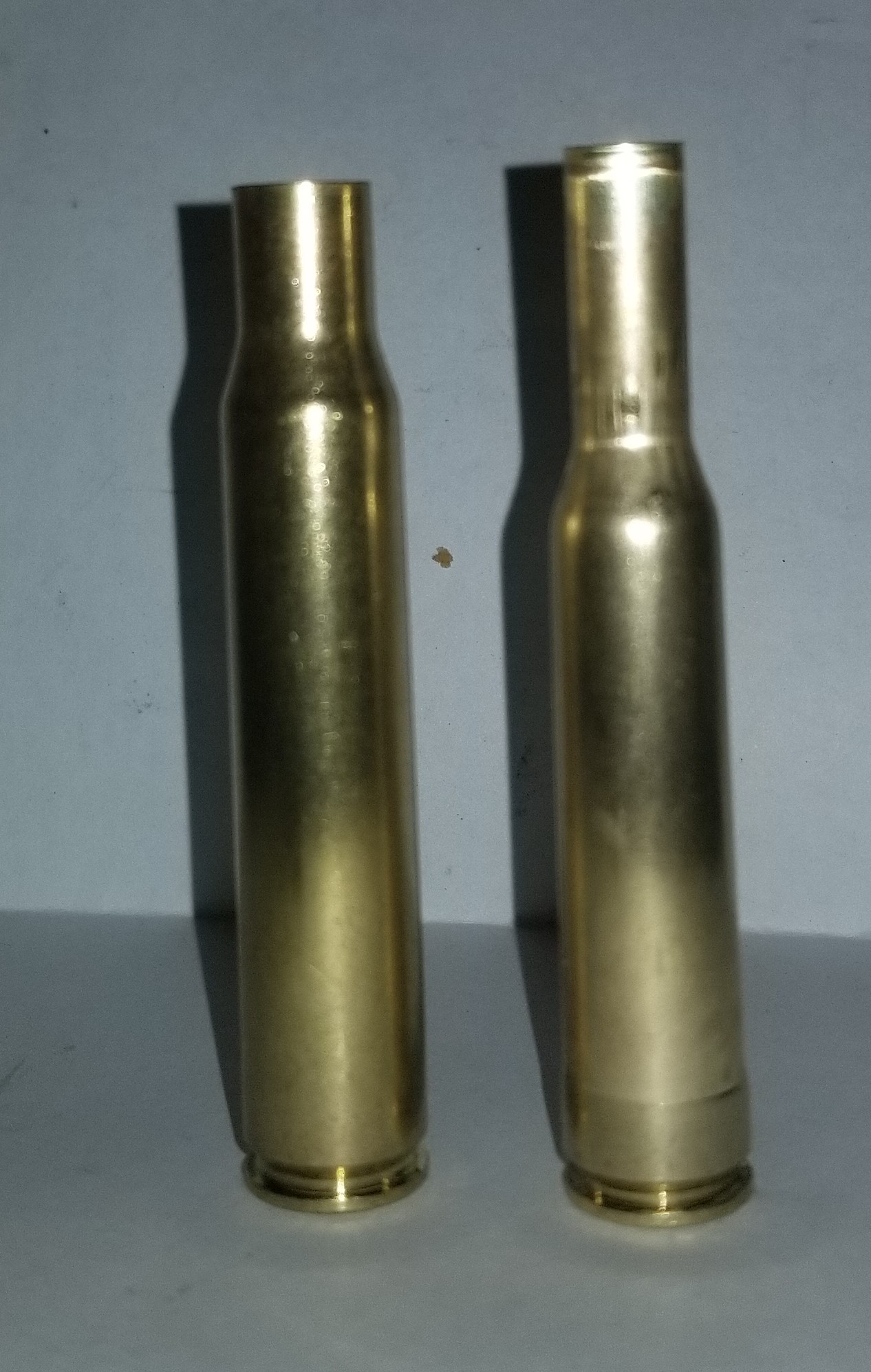

Sizing.30-06 down to 6.5mm is a good workout!

Post by JimTom » 08 Jan 2019, 12:00 am
That's a fair old modification of the brass mate. I have never had a cartridge that I have had to do it for.
Just out of curiosity mate, does this have any adverse effect on the longevity of the brass?

Post by No1Mk3 » 08 Jan 2019, 5:27 am
G'day JimTom,
The brass lasts as long as most commercial offerings if it is annealed during resizing and regularly in use. I would like to know what your loss rate is, bladeracer, as I was losing 3/10 during resizing for my M1904, mostly using Winchester brass. Fortunately had a lot donated to me and was making 8mm out of it when the Vergueiro came along so I still ended up with 100 good cases, Cheers.

Post by bladeracer » 08 Jan 2019, 1:53 pm
JimTom wrote:That's a fair old modification of the brass mate. I have never had a cartridge that I have had to do it for.
I don't think it has any effect on longevity as it's actually making the neck wall thicker.
It's virtually identical to making 6.5x54R out of .303 brass, except the length of the .30-06 means you're pushing the shoulder back into the thicker wall of the case. I may have to turn the necks but they look okay so far.
I have the shoulder back to spec now but it still won't chamber, I think the long neck is bottoming in the throat and it'll be fine once I trim 7mm off it.
