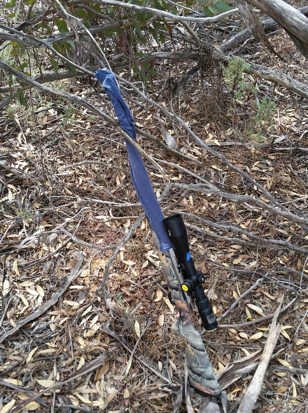

For what its worth, one of my rifles has a fluted barrel & it does 'seem' to cool down quicker. :thumbsup:
Also, not that it helps your predicament, when i target shoot/load test on warm days i shoot 3 shot groups & use a damp cotton rag (just wet enough to not drip)...i wrap it around the barrel with bolt & mag removed & the sporter weight barrels cool down in mo time...
Rapid barrel cool.
2018-11-06 09.31.52.jpg (734.79 KiB) Viewed 8417 times

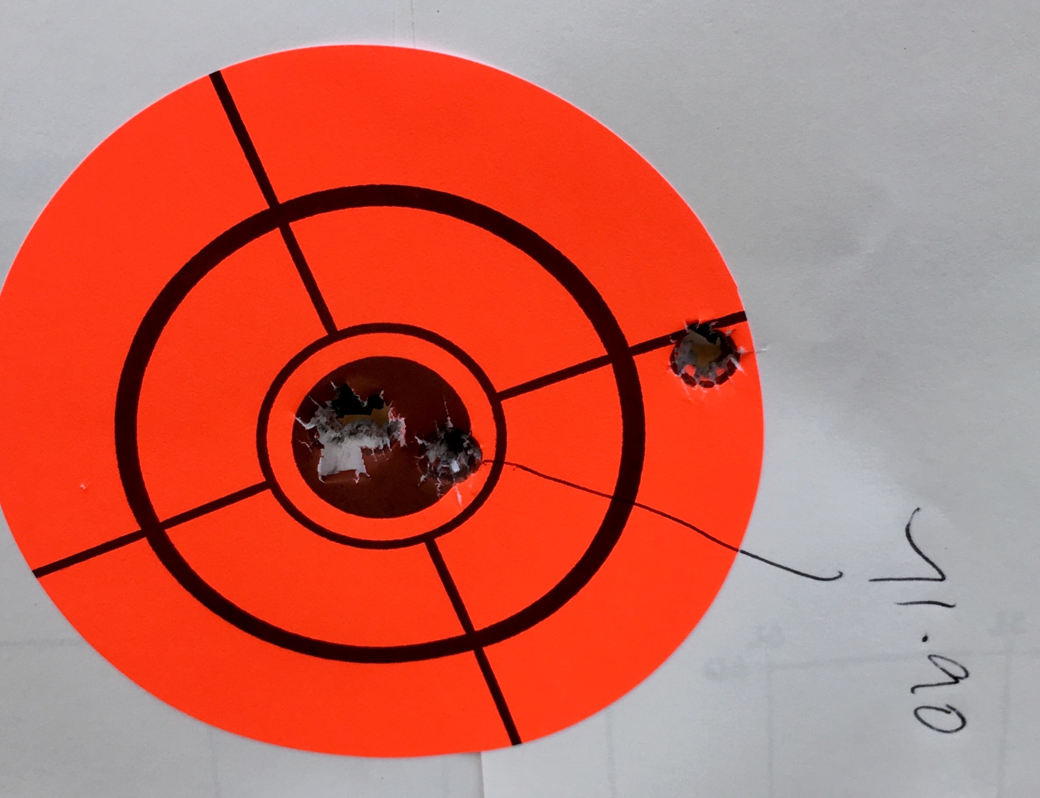

SCJ429 wrote:Five cut and recrowning? What did that cost you? You will lose a little velocity but that barrel will be nice and stiff. What ranges did you want to compete at?
Not competing - just fun and hunting...I didn’t build the gun - a local shop owner did and i was then in the right place at the right time and I’ve now done a couple of my own mods - but the hard yards was all local shop and local Smith.
I was told before purchase that With 120gn Nosler and 45.5gns ar2209 it’s shooting 2 inch groups at 500 metres with an experienced rifleman and 4 inches with a newbie / anyone. Whilst I was initially very sceptical of these claims, I can now say with some recent lands testing - that I’ve witnessed the capability and have personally shot a group of 3 to 13mm at 200m which blew me away - as I’m pretty useless. See pic.
It was cut .5 inches a time to ensure velocity
was not being given up holistically and the chart shows that only some 50fps average was lost from the 24 inches to 21.5 with the above load and apparently even less with 140’s. I’d guess it may lose a little more with the lighter projectiles (it was shooting well over 3300 FPS with hornady 95’s at full length but due to the work put in - they stuck with120’s as a middle ground for full testing - so I’m told anyway). This shorter barrel completely screwed with my head - as growing up in something of an “ignorant” firearm household I was lead to believe that longer barrels = speed and whilst that remains true to a degree, its definitely snot clear cut.
I’ve never owned a centre fire like this - one that Instills so much confidence. It’s a bloody good feeling lol and that’s part of the problem - because now I want a light weight 06 hunter to do the same lol and it’s prob not realistic (sad face).
I’ll try and load my first photo - if it works it’s 260 lapua cases, 120gn Nosler, 45.5 ar2209, cci primers, bi pod and desk with Caldwell rear bag at 200m.
Slight confusion now is that this group was matched whilst testing, with a projectile that was seated out 1.9mm further - a hairs breath away from touching the lands so now I need to test again both lengths again.
71.90 COAL and pulled one shot right
13mm
Re: Stalking Vs Target shooting
Post by bigrich » 07 Nov 2018, 4:39 am
That’s a very fine shooting rifle with great capabilities. From what you’ve posted, I think the 260 Tikka is probably utilised as a long range Varminator and target rifle. A stalking rifle needs to be lighter and more “pointable “ IMHO. I think a 30-06 might be more rifle than you need for fallow deer, light rifles in larger caliber tend to recoil a lot more as well. Cheers

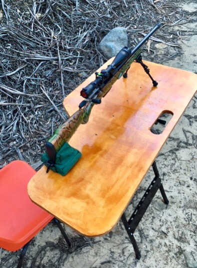

Pic of 260 Remington I keep referring too...attached.
Going to try the new Mauser M18 for weight in the 30/06...someone on here has said they are guaranteeing sub moa with 5 shots - so that implies they can deal with at least some heat...as 5 shots rolled out in quick succession is generally enough to get the sporty barrels that I’ve owned - very hot...

yup, nice rifle tas. i just hope you don't come back to it one day to find it's been swallowed by a bush python :lol: anything with "mauser" on it and made in germany should be good. wouldn't worry about five shots in a hunting rifle mate. first two or three shots is all that counts. i recently got a stainless/synthetic . some of my friends give me greif cause i swore i only ever wanted wood and blued steel rifles :lol: i got a sako a7 in 308 win. it's light, very accurate. it's like if a sako and a tikka t3 lite had a barstard child :lol: sako 85 trigger , and sako 75 action/ barrel means it's a pretty good thing :thumbsup:
