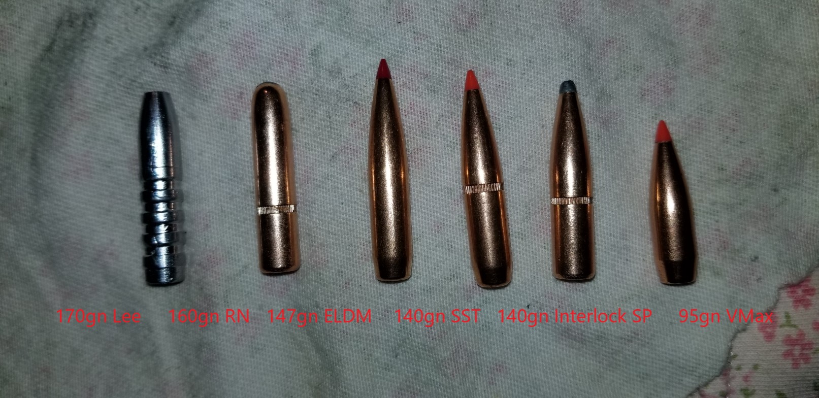

Post by bladeracer » 07 Dec 2018, 6:57 pm
Urastus wrote:I want to be able to go hunting. The range for me means proficiency and familiarity with the rifle ultimately with hunting in mind. 24" is OK. The LA-102 in 6.5CM is looking good. Not a tight twist though (1:8). Barrel is looks med like the .22, kind of looks OK for range and hunting - 22". I suppose my only question is, is this twist OK? I'm going to look at what you have - haven't come across it yet.
That's my view of what all range shooting should be, relevant to the real world :-)
The Ruger Predator in 6.5CM is also 8" with a nice barrel contour. 8"-twist should easily run the heaviest 6.5mm bullets - like the 170gn cast I'm playing with now.
