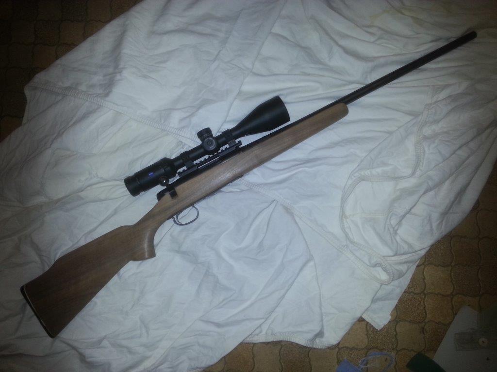

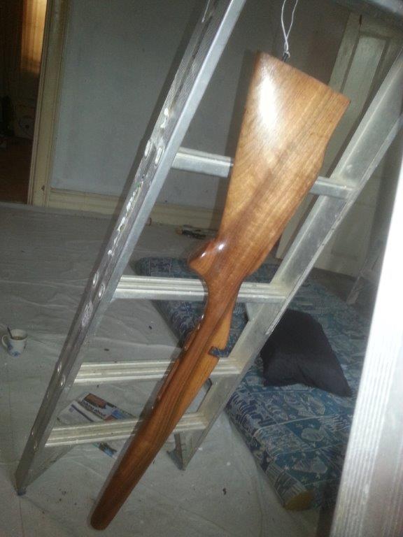

Love mine...was the ol' mans.
Everyone tells me to sell it, but it doesnt shoot no more...some of the pics below show me draining some of the last bits of life out of her.
As has been mentioned, they have a name for bad triggers, & its interesting what Marksman says about them being dangerous....because, i developed a flinch from shooting this one. (may sound weird but its true).
Unbeknowns to me, i was starting to flinch & eventually honed in on it being due to the trigger releasing at different tension--in other words, i couldnt tell when it was going to release the shot.
Everyone says i was nuts & making excuses, so i took it to someone who had a trigger pull weight doova thinggy-bob & it showed the trigger releasing anywhere between approx 2.2lbs to 3.8lbs, but was mostly between the 2.5-3 mark...
My ol'man told me he had the trigger done on it which didnt make sense, so i got it cleaned out & now...let me tell you...whilst i dont know much about the mechanics of the trigger, it is one of the crispest triggers on a production rifle that ive shot...
I have my Tikka's wound back to as light as possible with the factory spring, & although my 788 is a little heavier (bit over 2-maybe 2.2-2.5 lbs from memory) it is every bit as crisp as the Tikka trigger.
A few people who owned &/or shot the 788's in their day, who have shot mine initially thing it must be an aftermarket trigger in it.
Ill have to watch out for the cleanliness of it though, although i knew it was just dirty, its good to know about the danger so thanks Marksman... :thumbsup: :drinks: (not that i shoot it anymore)
Id really like to get it re-barreled one day & have a fancy custom chamber in an AI version or something, but i struggle with the cost of doing that vs just trying my luck with buying a Howa.

Mine is a 22-250 :thumbsup:
Stripped the stock
Baking the tru oil
Another Coat
Yea baby...!!
Plain but pretty looking rifle i rekon...!!
