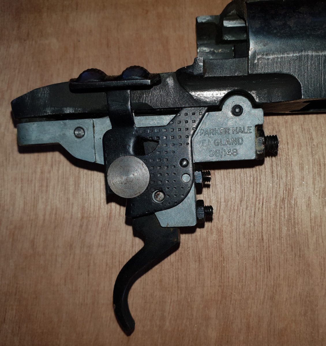

i recall reading somewhere that the three way adjustable triggers on the PH were copied and the design used for other makes as well by timney triggers. i'm sure someone will correct me if i'm wrong, but that's a big vote of confidence in the PH trigger.

bigrich,
Attached is our 1200 trigger; looks very similar to a Timney trigger for a model 98 action.
Cheers,
Rod.

Post by bigrich » 03 Mar 2019, 4:44 pm
it bloody does, hey rod ? i forget where i read it, but i reckon it's probably true

this is where I was talking (the yellow arrows) about that make it harder to get the tang bedding right, better with a short pillar IMO
this area is also a pain in the @rse when adjusting the trigger as it flaps in the wind until you clamp it all together
but with patience can make a very good let off :thumbsup:
