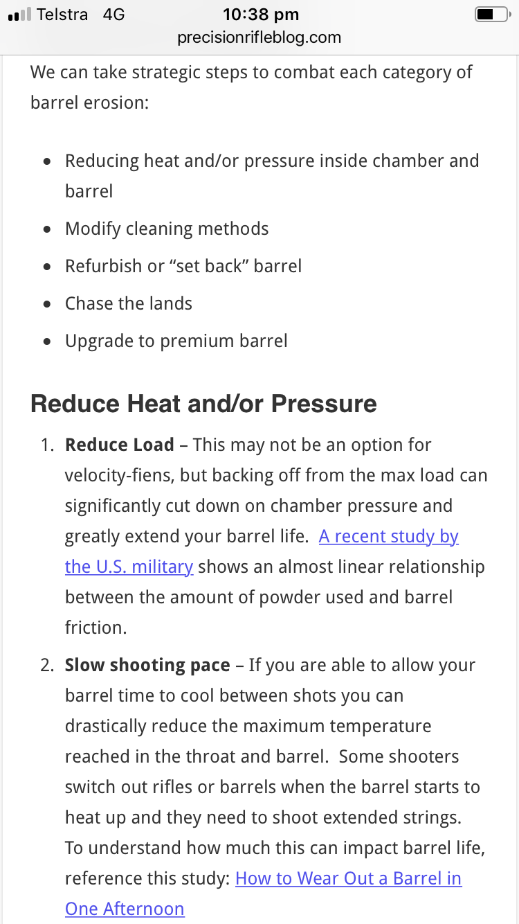

Post by Chappo » 12 Mar 2019, 9:44 pm
in2anity wrote:
Chappo wrote:I was also of the assumption that a heavy barrel equals longer life. I thought this was because hotter steel wears quicker. Am I wrong?
Mate the throat goes first - not sure how much the profile would affect this, my guess is not much. Then again a longer 24” will give you some wiggle room to get it re-cut down the track. Also my 2c I think it’s a terrible idea lugging a varmint rifle around on foot. You just need to do it once to realize how tiring it is (compared to something light).
I agree prob not much but I was just doing some reading that suggests heat does affect barrel life although letting a barrel cool down between shots would have a bigger impact than carrying a heavier barrel. In fact a sporter barrel would cool quicker.
Chappo
Posts: 249

Post by Stix » 12 Mar 2019, 10:54 pm
No you're not wrong Chappo, just not quite right...
So lets say 5 shots fired in a sporter barrel.
The same 5 shots fired in a heavy barrel.
These shots generate the same amount of heat that contributes to the same amount of thtoat/barrel wear.in both barrels.
The difference is, the varmint barrel is heavier & therefor resists "bending" (throwing shots) for longer, because it is more rigid...so all 5 shots hit the bull...
But it takes longer for that heat to travel through the thicker steel to its surface...
However, because the surface area is greater it disipates the heat quicker (once the heat is at the surface).
The sporter barrel starts to "move" (bend (?)) from the heat after only 2 or 3 shots because ot is less rigid, so the 5 shot group is a little "looser"...
But given the steel is thinner, the heat travels to the surface quicker...
However, takes longer than the heave barrel to get rid of the heat (again, only once the heat is to the surface).
Bottom line, my experience tells me a sporter barrel cools quicker...noticsble if shooting groups & waiting for barrel to cool between groups..
Not sure ive explained it that well but its the best i got right now... :drinks:
