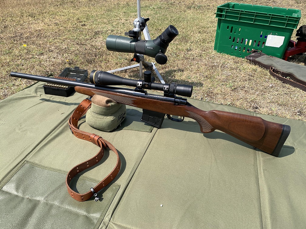

Re: Howa 6mm BR build
Post by in2anity » 29 Nov 2020, 2:52 pm
Just the standard HOWA walnut stock on my custom. Glass-bedded. They are a very chunky forend, not bad for both bagged shooting and also service sling.
Post by bobnob » 30 Nov 2020, 1:49 pm
What magazine setup you running there in2anity? And does it work?
bobnob
Posts: 103
Post by in2anity » 30 Nov 2020, 5:32 pm
bobnob that’s the Lucky13 10-shot kit. And yes it’s 100% reliable. I need the 10-shot as I use it in Service matches (non-service class).
