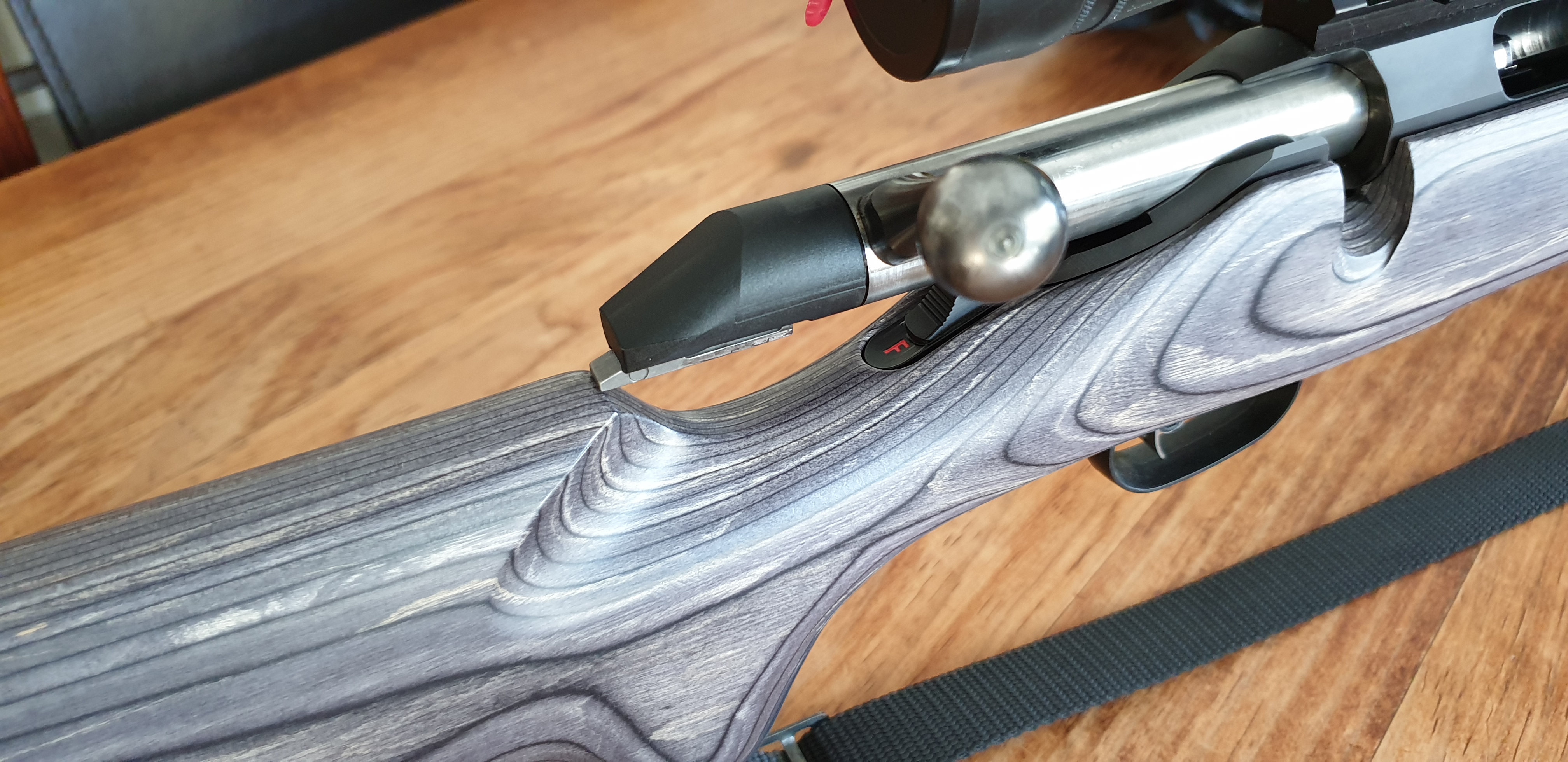

Hello all,
I've had a Ruger American Centrefire for some time now and have been relatively happy with it. The one gripe I had since it's purchase has been the cheap polymer factory stock. Recently I found Boyds and their range of laminate replacement stocks, so I ordered one and fitted it to my barreled action.
The problem I am faced with, is that the comb of the stock is a few millimetres too high for the bolt to fully retract, therefore I am forced to carefully cycle the bolt as slowly as possible every time I fire, so to avoid carving up the stocks nice finish.
Does anyone have any ideas on how I might be able to raise the action without affecting the function of my rifle, but allowing the bolt to clear the stock?
Thanks in advance for any and all suggestions.
JTF91

Definitely the right stock. Nice snug fit, dropped right in no work needed. The bolt functions, it's just a hair too low and rubs up on the stock which I'm sure will damage it if I forget and cycle it as I normally would.
I'll get a photo to show exactly what I mean.

Post by Wm.Traynor » 21 Apr 2019, 7:23 pm
JTF91,
From your pic, it looks like the tang is neither too high nor too low. Therefore it looks like your action is not too deep in to the stock. So, if your rifle is accurate enough, I would not bed it. IMO, just modifying the comb, or the nose of the comb, should suffice.
Posts: 1824

Post by bigrich » 21 Apr 2019, 8:59 pm
Wm.Traynor wrote:JTF91,
i'm real good with sculpting stuff with a 4" grinder with a 60-80 grit sanding disc, find someone close by who's competant with one,a couple of $ at bunnings for the right finish and go shoot . if it's a hunter you're going to get knocks and battle scars on it no matter how hard you try to look after it :unknown:
