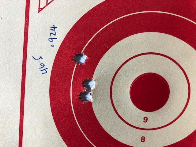

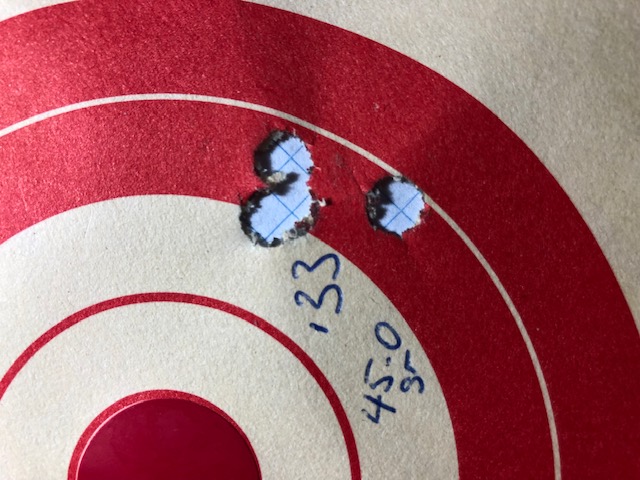

I was disappointed with my Howa 308 - shooting a variety of 150gr factory and hand loads had mediocre accuracy and a fair kick through the light weight Hogue rubber stock. I was debating whether to get a Boyd stock and bed the action etc. or just move it on and downsize. i was even looking at the Grendel. Then my favourite gun store had the Sierra 125gr Pro-hunter on sale and I thought "why not". I made up a few different loads and tested them on the weekend. All gave me sub-MOA 3 shot groups with much less perceived recoil.
the best load was also the smallest charge - 45 grains of AR2206H in an ADI case, CCI primer. i didn't chrono but the ADI manual suggest's i'd be getting 2800 fps at the muzzle. I keep to shots under 300m [most 150m or less] so performance past 300m is not an issue, and the trajectory up to 300m is pretty flat, for a 308.
i'll be using these on largish pigs (no deer in my neck of the woods) and other lighter skinned ferals if the opportunity presents while i'm out in the paddock. I read they're a stout little bullet that shouldn't blow up at those speeds. Anyone use them? i know i could go heavier [150 or 165s] and i've read some people say the 308 does well with the heavier bullets but if these will do the business on a pig i won't need to.
the worst and best groups photos should be rotated 90 degrees clockwise. ignore the 4th hole - not a flyer - it was my first fouling shot with a 150gr round i had in my box.
