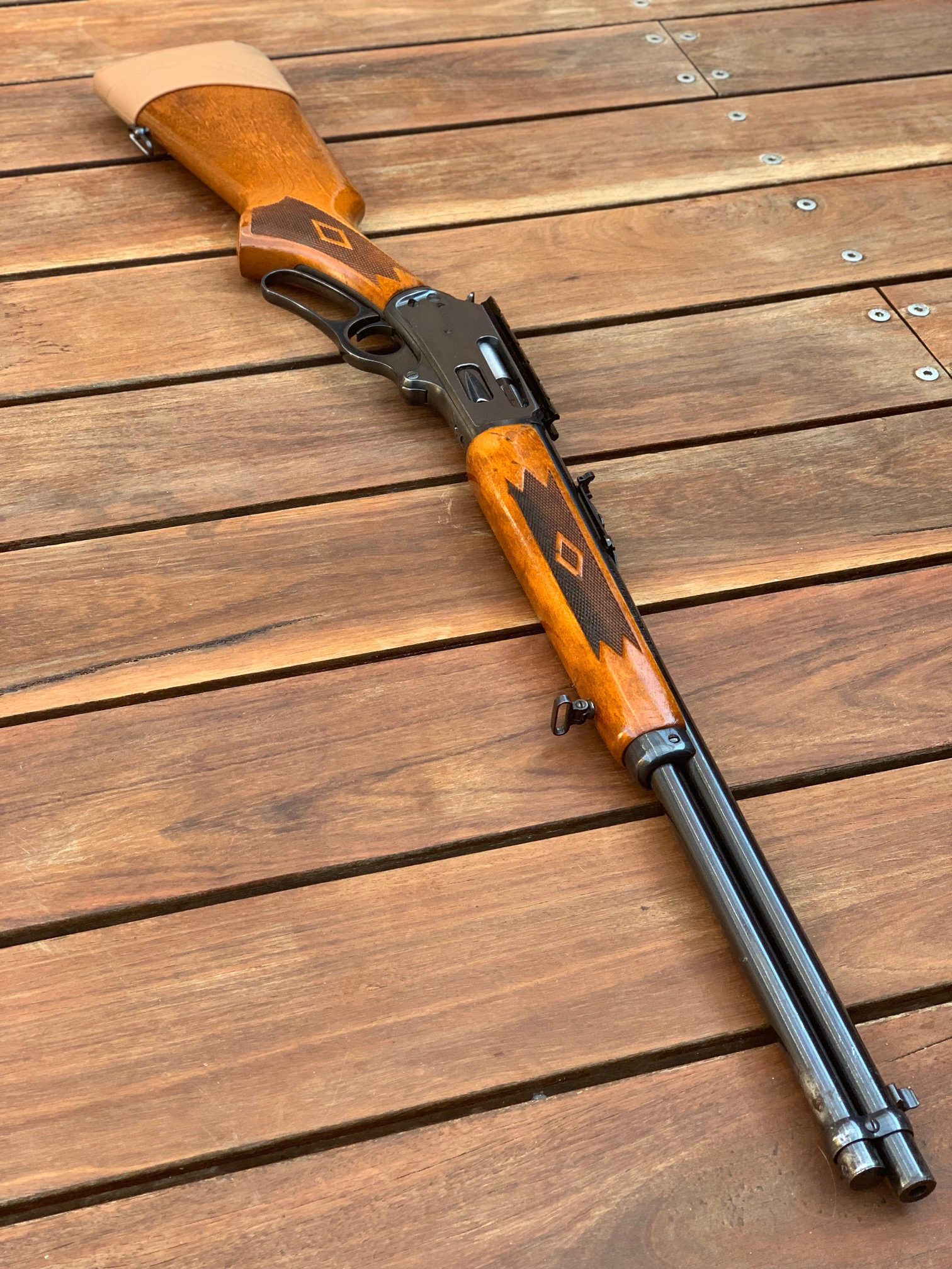

Post by in2anity » 29 May 2019, 2:57 pm
As promised (to a couple of members), here's an article I've been working for a while from my blog. It really should probably be in the gunsmithing section, but I figure more lever-gun laymen may see it here. One day there will be a part 2, but that's still a long way off. Enjoy.
The purpose of this article is to give an entry-level guide to some of the (easier) alterations you can make to improve a lever action rifle’s inherent accuracy. In truth there’s virtually an endless list of improvements the tinkerer can make. Nonetheless the return on effort somewhat diminishes following the more significant modifications. I’ll therefore focus on these fundamental (and essentially simpler) improvements. Most of my information for this article comes from the rather famous, yet sadly out of print book “Accurizing The Factory Rifle – M. L. McPherson.” And to quote Paco Kelly’s Leverguns:

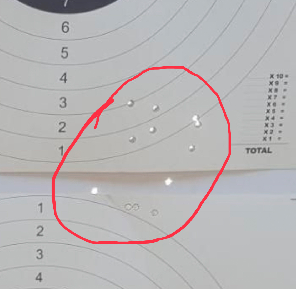

Typical full-power 50m group showing “vertical stringing”. From cold, the group starts tight, but inevitably wanders after repeated shots.
I’ve had other lever guns that also seemed to cluster nicely, but then seemed to throw a “flyer”, often more laterally than vertically. I’ll label this “lateral stringing”. Both are symptomatic of different bedding issues.

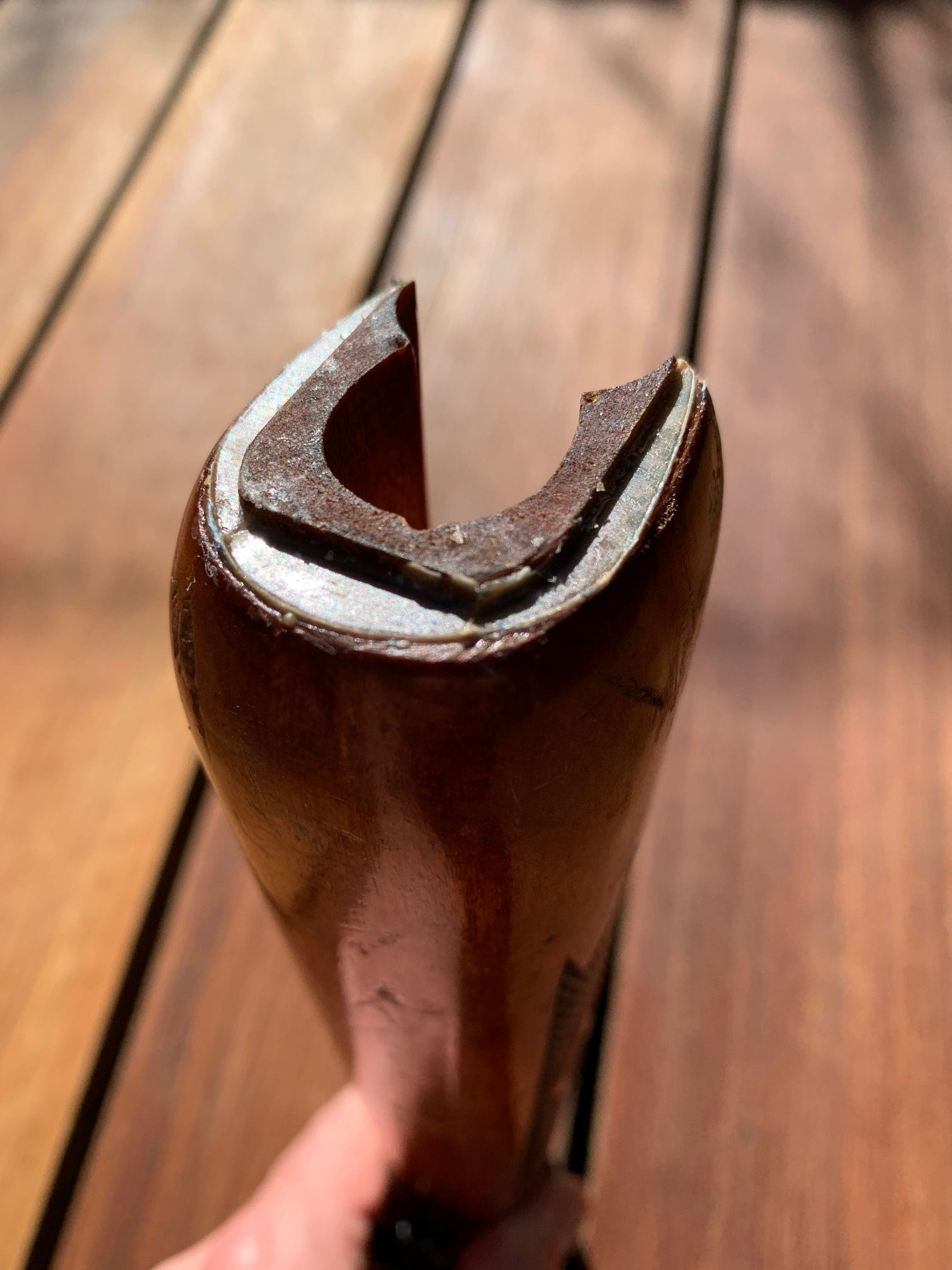

Unrelieved
Relieved – just a very light sanding on the bearing surfaces. Notice I haven’t altered the upper flats as this does not make contact with the action – only the lower flat surfaces and a tiny amount on the vertical.

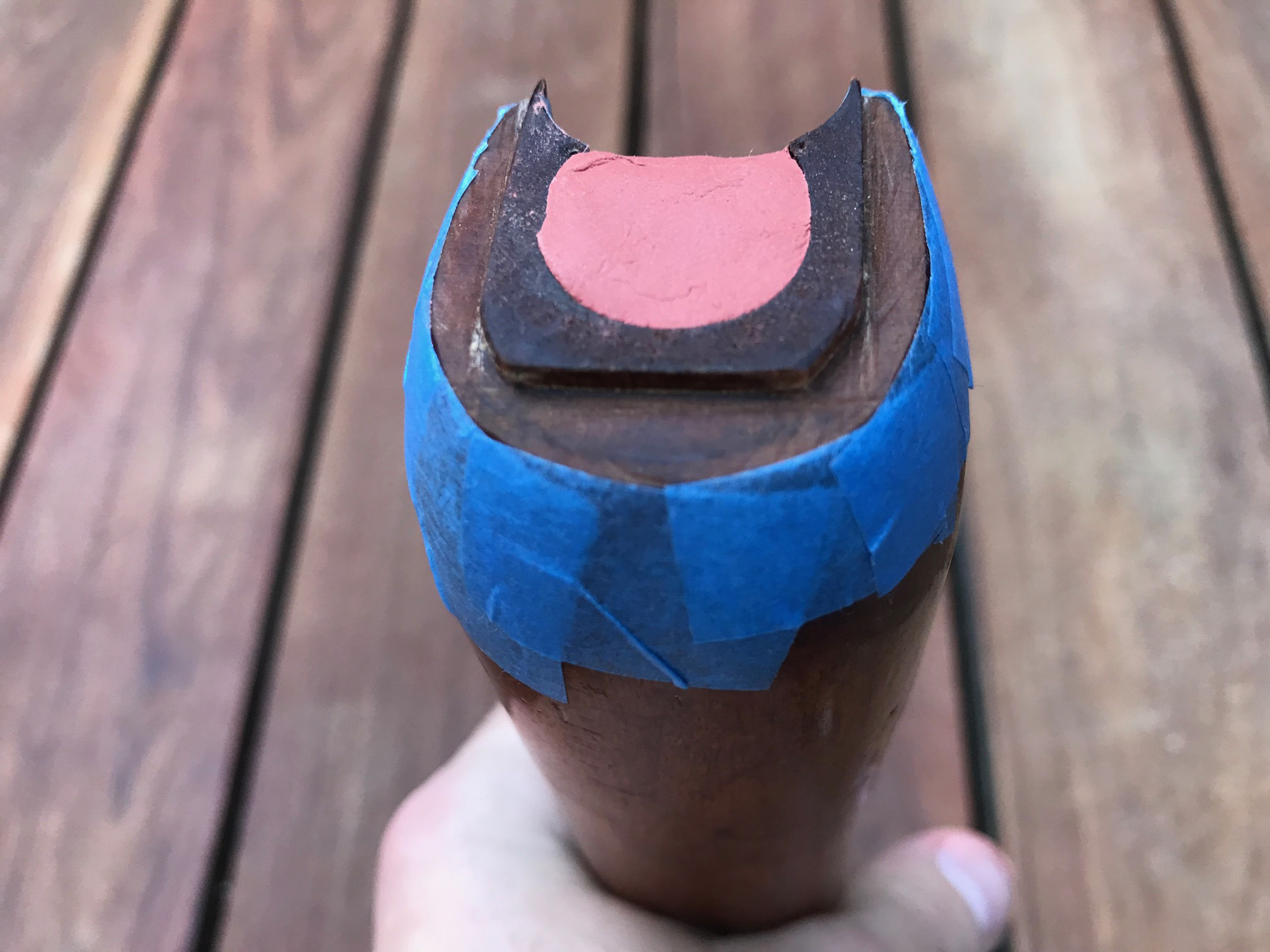

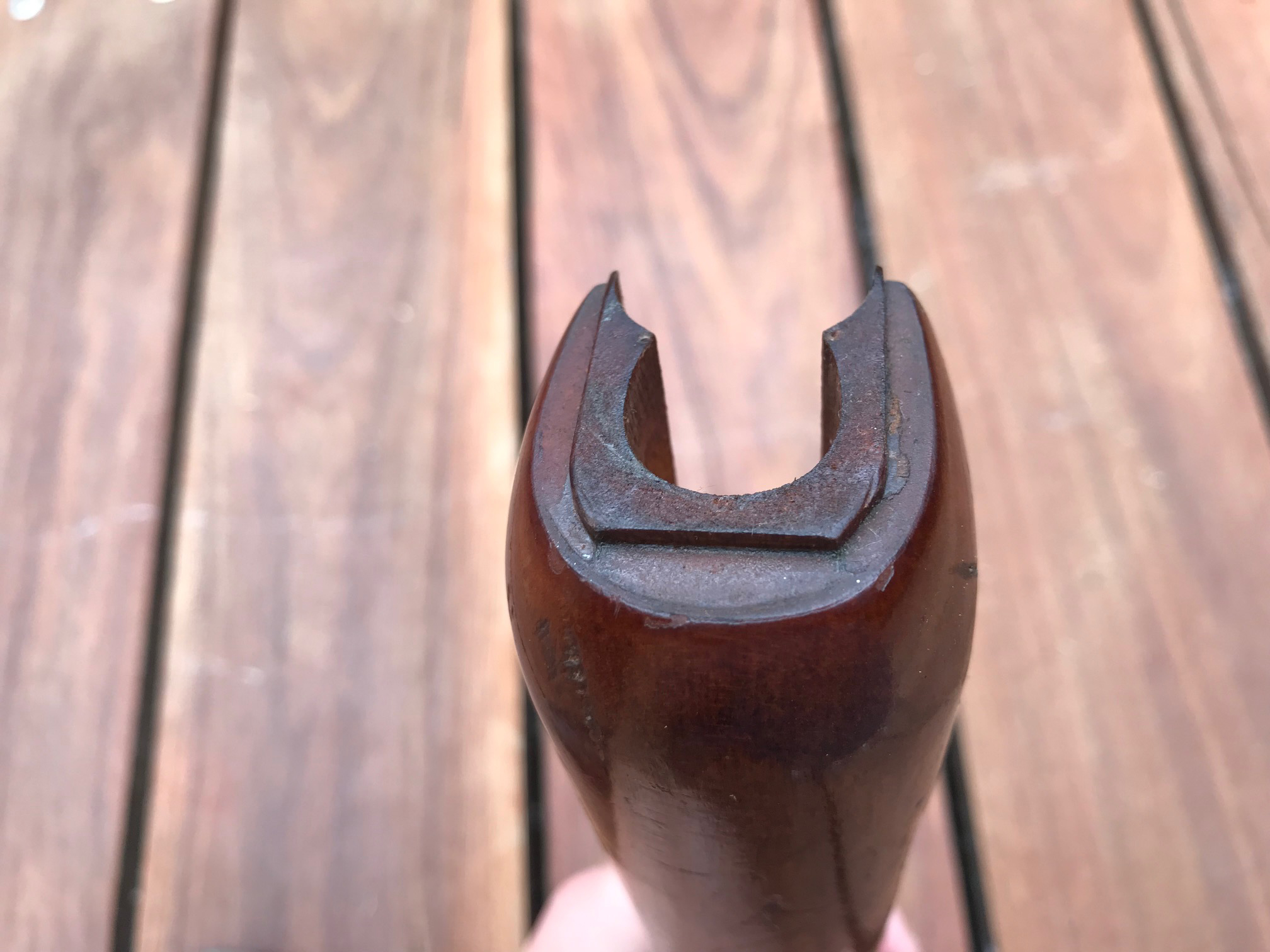

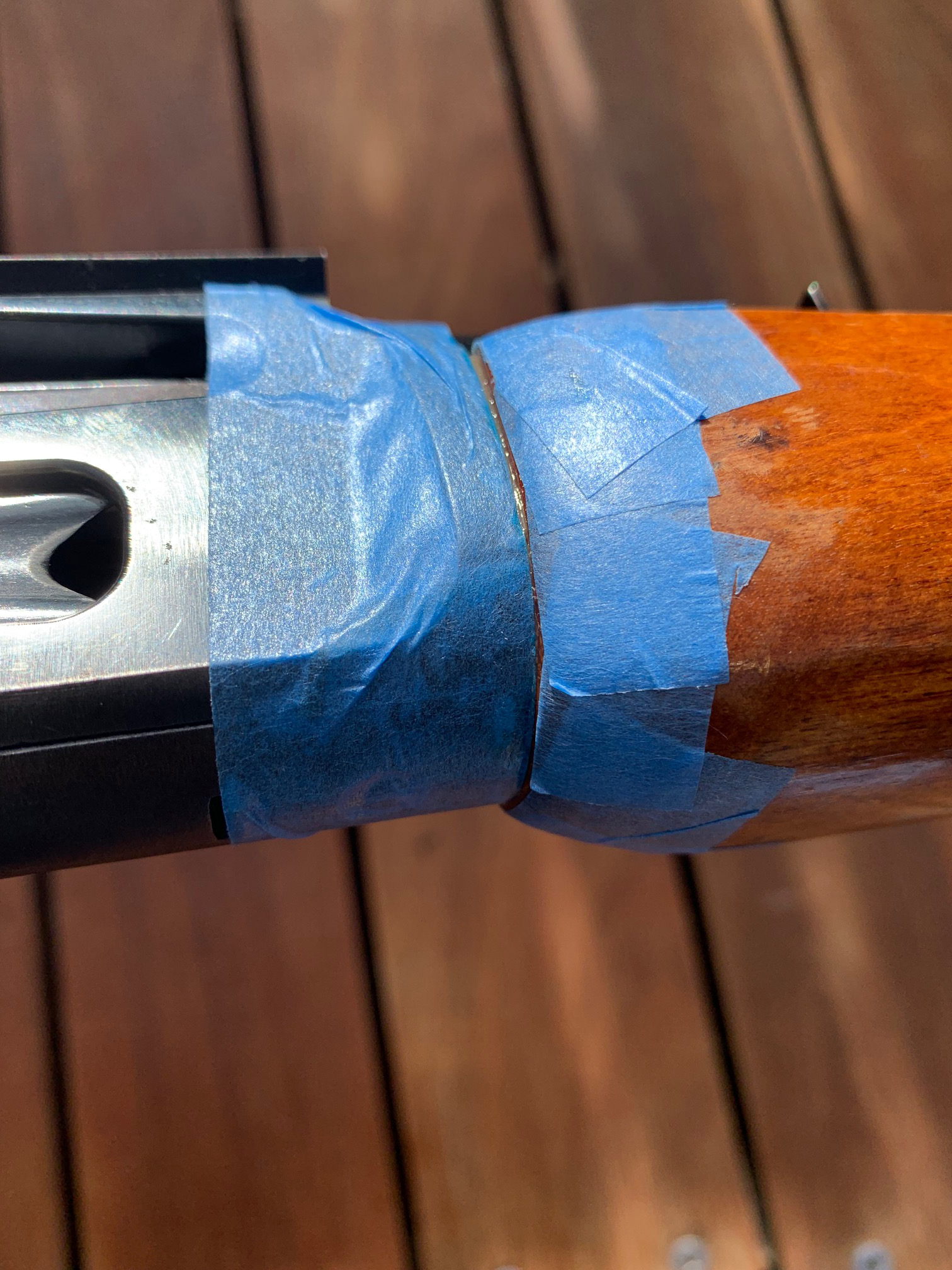

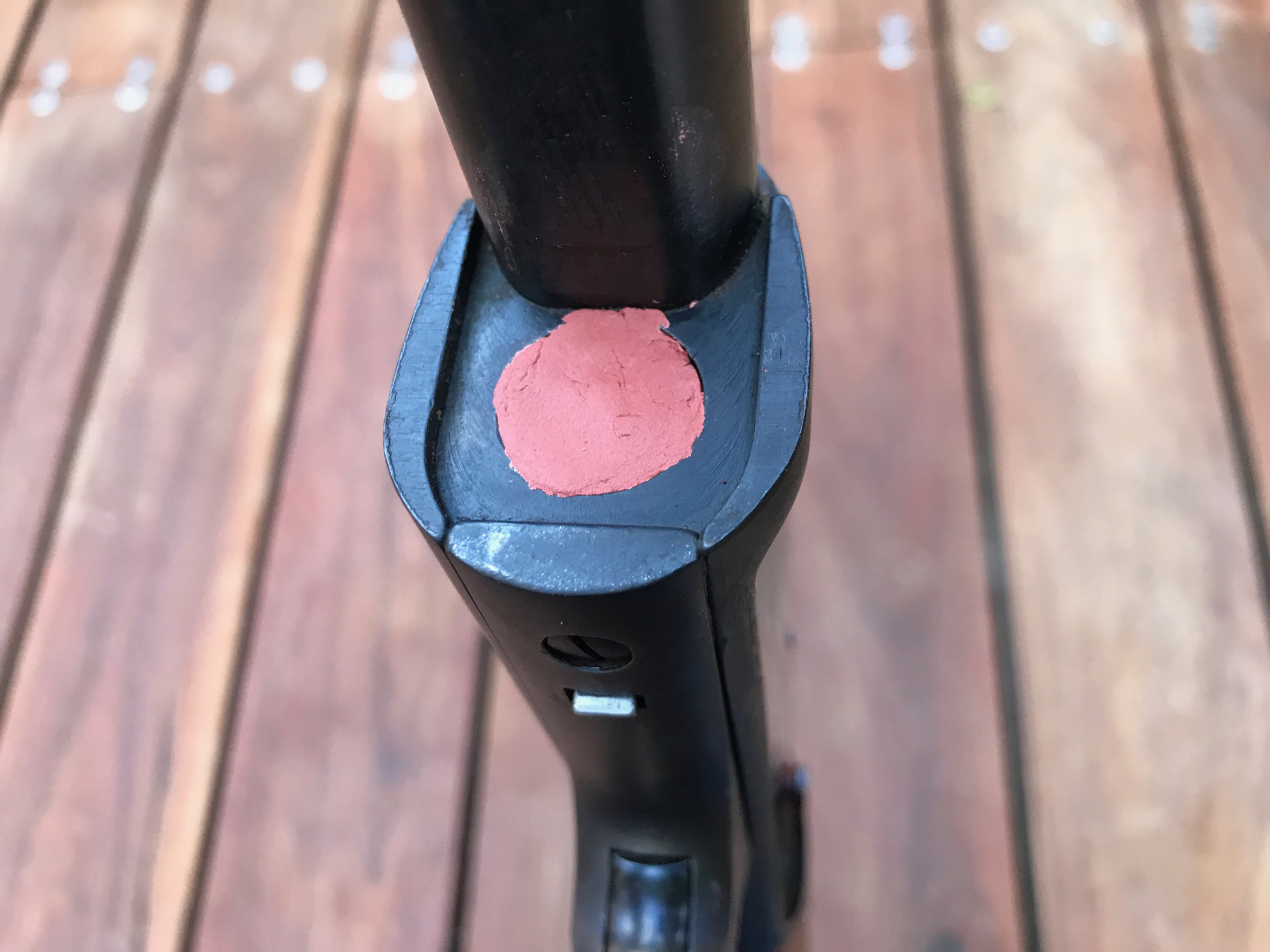

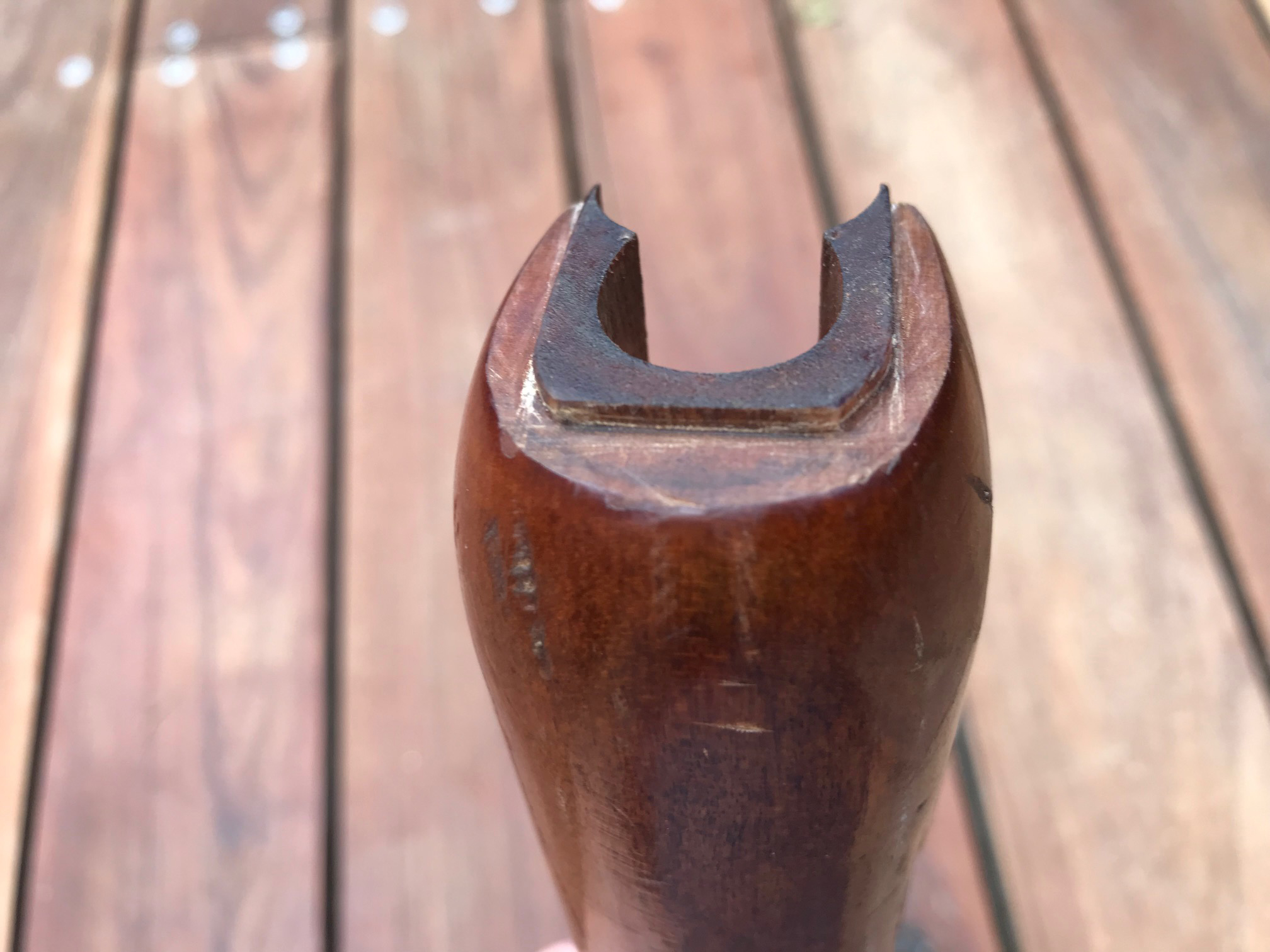

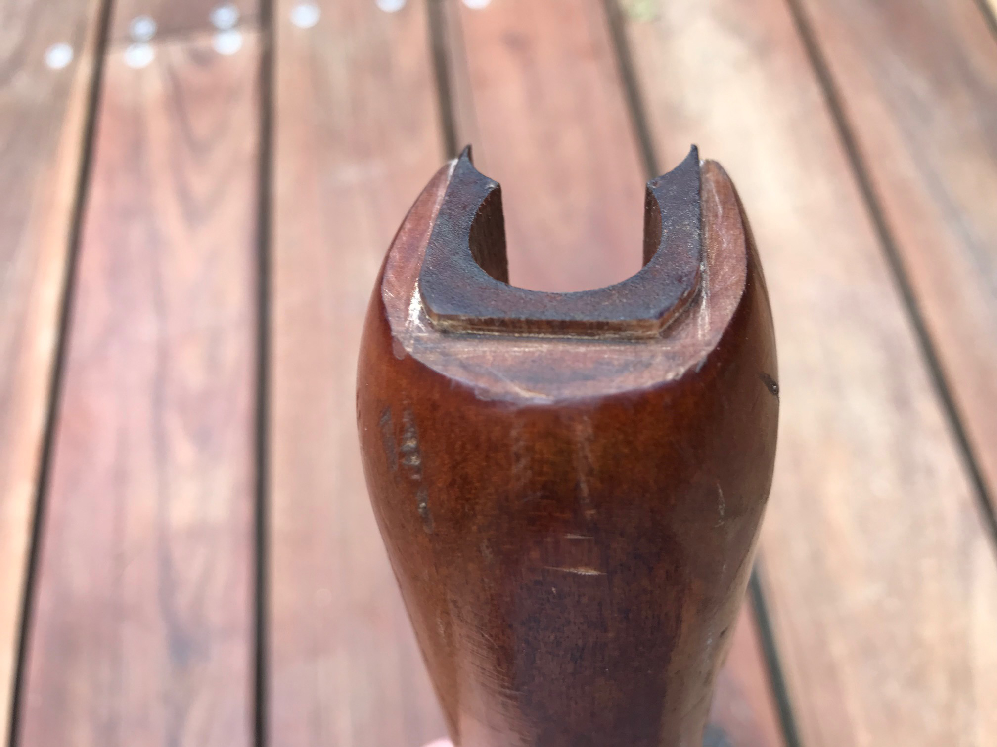

Ensure that the keyed portion of the forend that enters into the front of the receiver is clean. If necessary, use alcohol or carburetor cleaner to clean any oil from the wood. Ensure any excess solvent has evaporated, possibly use a portable hair dryer to heat the wood and evaporate the remaining solvent.

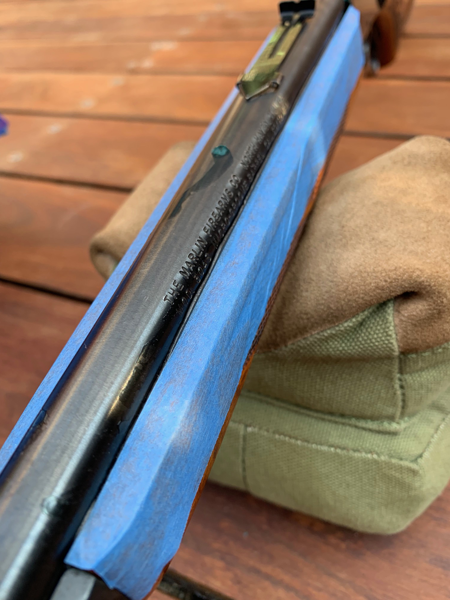

Apply multiple coats of release agent under the barrel in front of the receiver and to the areas of the receiver face itself that might make contact with the forend. Apply quality masking tape around the perimeter of the receiver, and around the adjacent perimeter of the timber forend (to protect the finish). Dam the magazine feed hole in the receiver with modelling clay, mask over the top of this. Also dam the magazine channel in the forend (preventing any bedding agent from flowing into the magazine channel). As a precaution I also dammed the narrow upward pointed channels either side of the barrel on the receiver. Basically, as neatly as possible, mask any timber and metal that you don’t want bedding agent to bind to; the only exposed area without tape and/or release agent should be the timber that keys into the receiver.

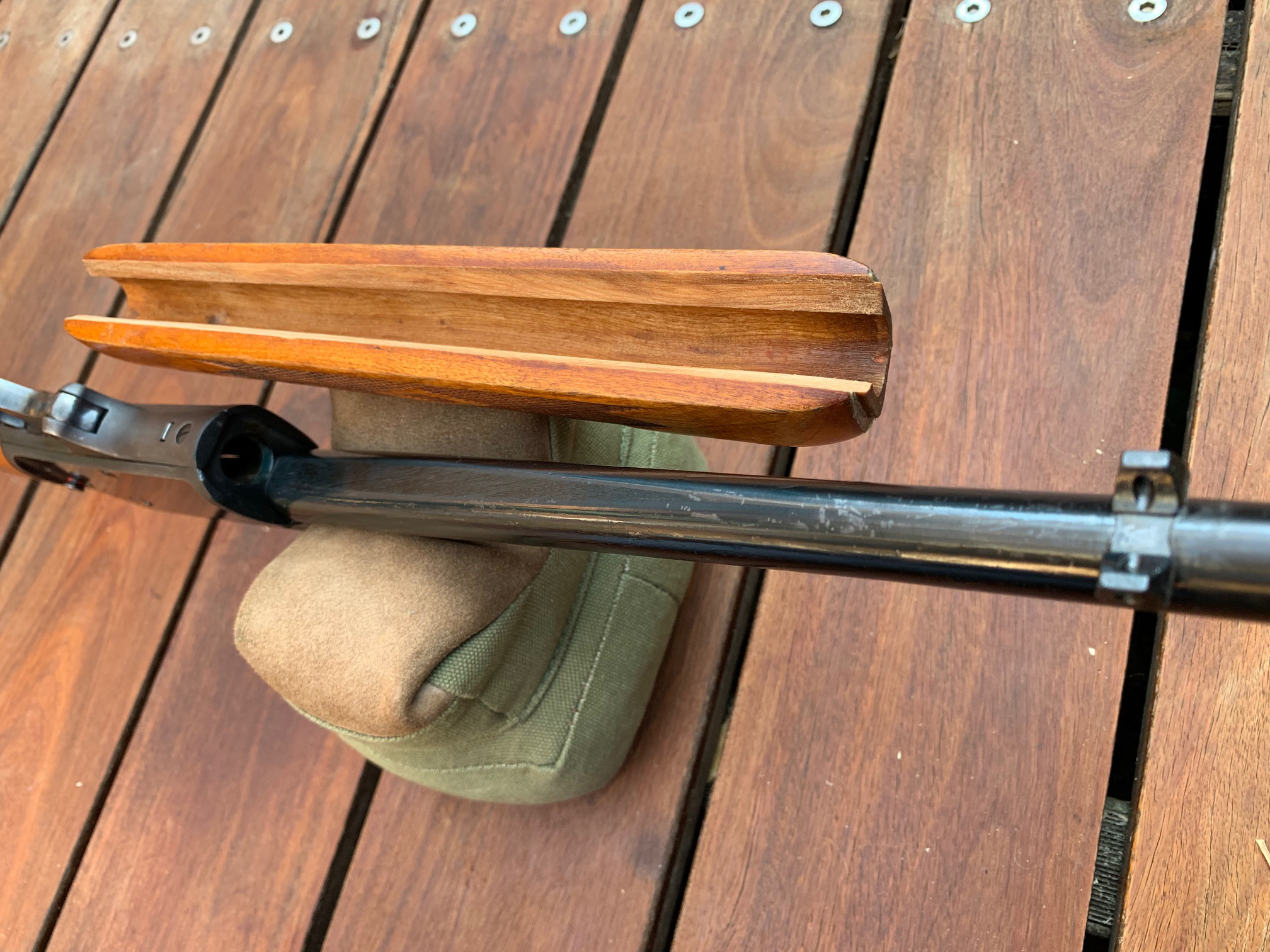

Forend ready for bedding

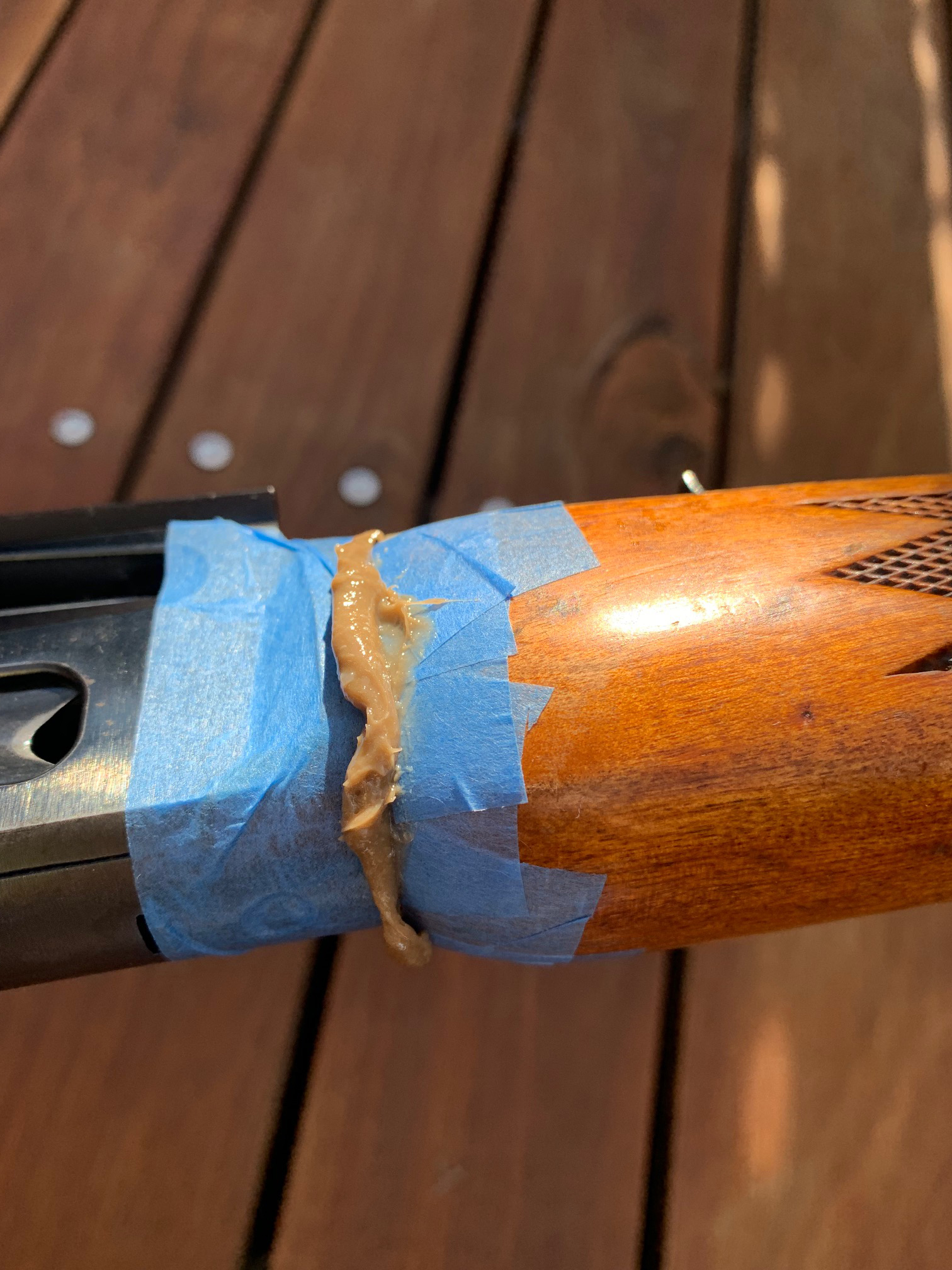

Feed tube plugged, we still need to mask and coat the action here with release agent

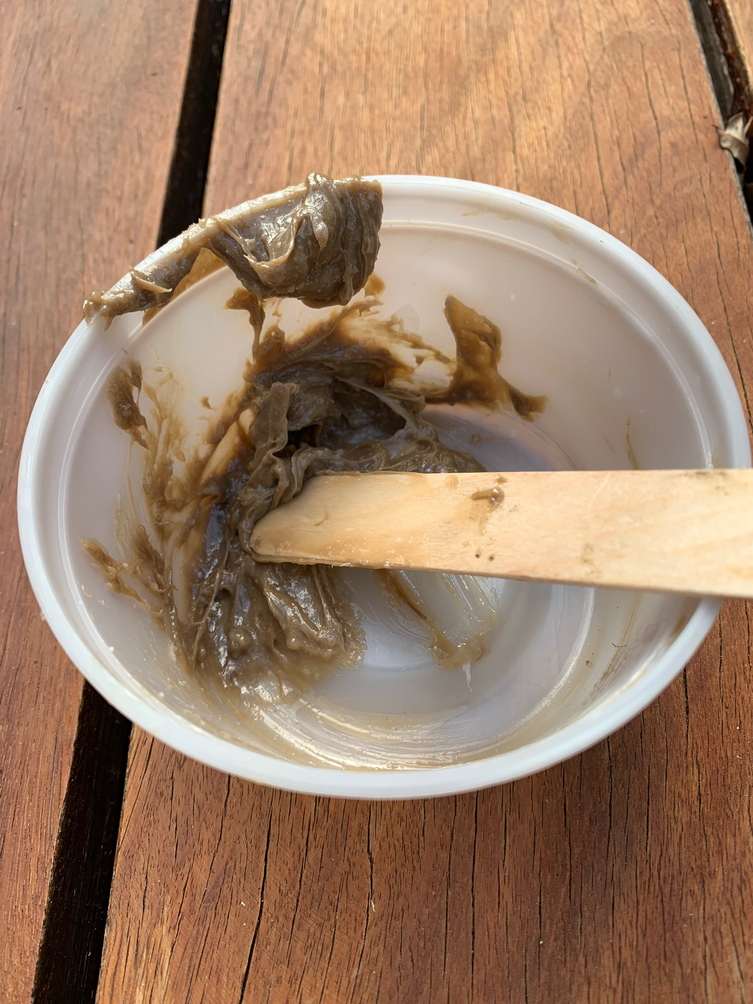

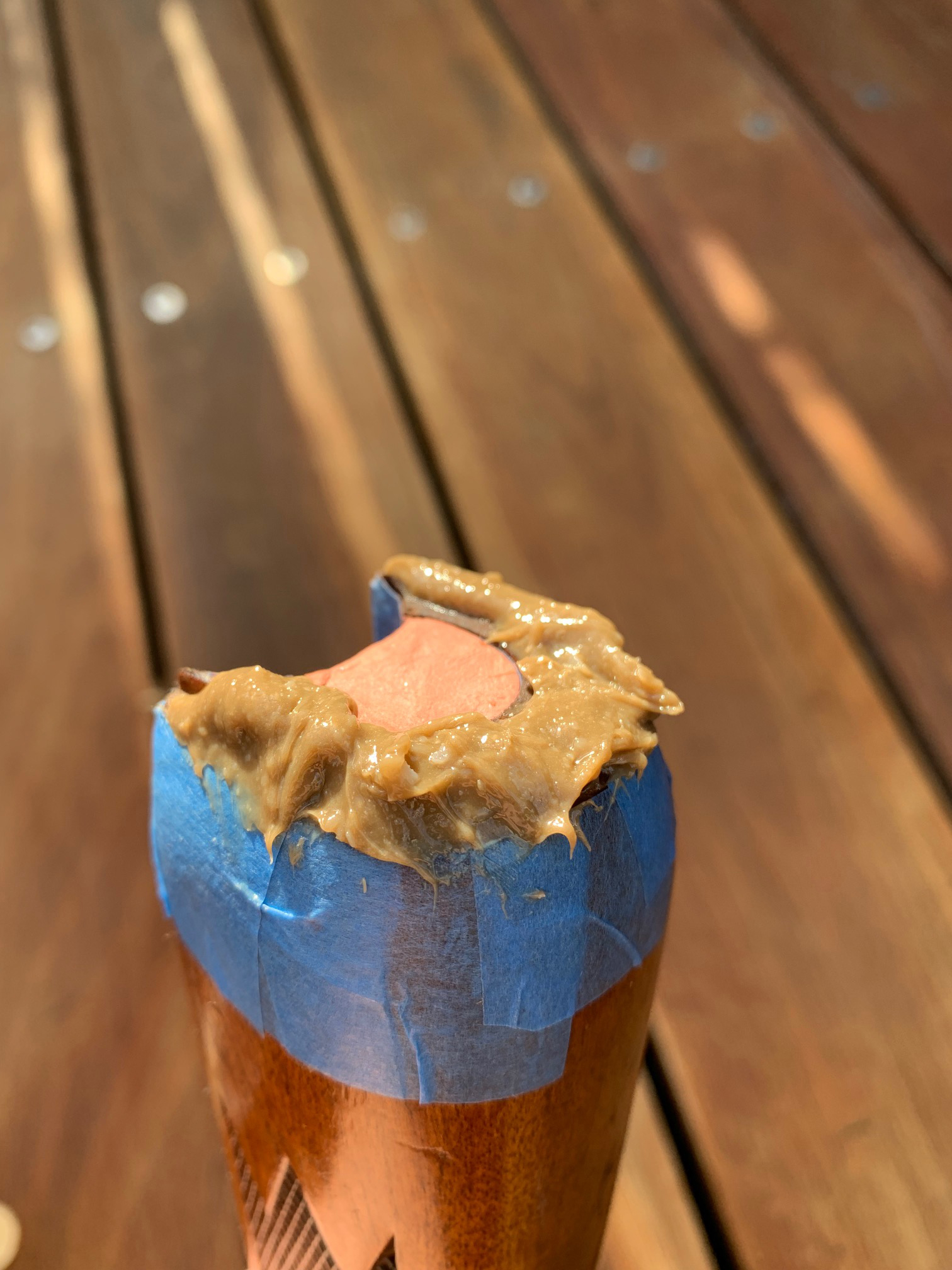

Mix a small batch of gel-type bedding agent. Since this material will be visible on the finished rifle, add a dab of colorant to match the hue of the forend. Remember a little bit of colour goes a long way.
Go easy on the colarant – a little bit goes a long way
Apply the bedding agent to the keying portion of the forend (the relieved perimeter that you just cleaned). Be sure to get a sufficient coating to adequately cover the surfaces that key into the receiver. Reassemble the forend (excluding the magazine tube). Wipe away the excess gel that extrudes out with a damp cloth.
More gel is better - we can always remove later
You want enough gel so it extrudes out like this
Excess gel can simply be wiped away
Allow to dry for 24 hours with the magazine removed and barrel and receiver supported. Do not allow the rifle to rest on the forend while the epoxy hardens, the rifle should be right side up and horizontal during this process. Once the epoxy is set the forend should come apart fairly easily.
Upon disassembly, chip away any gel that has spread up onto the upper flats surround the magazine channel - this area is not a bearing surface and thus should be kept that way. Your forend should now be a perfect fit that should facilitate easy disassembly and reassembly. This is the foundation of the next (most crucial) step; RTV silicone bedding the barrel channel.
Only the lower bearing surfaces should have the glass bed.

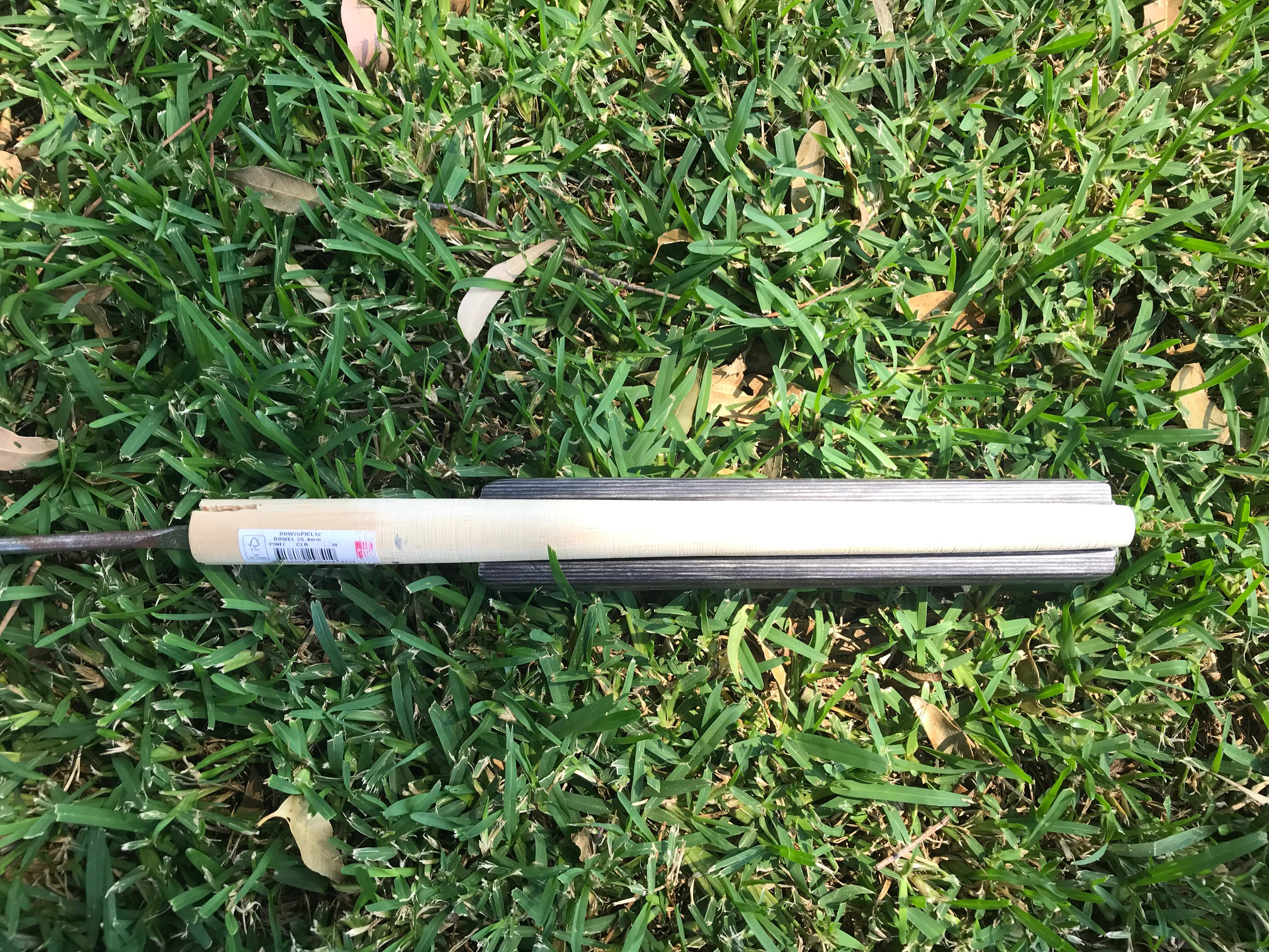

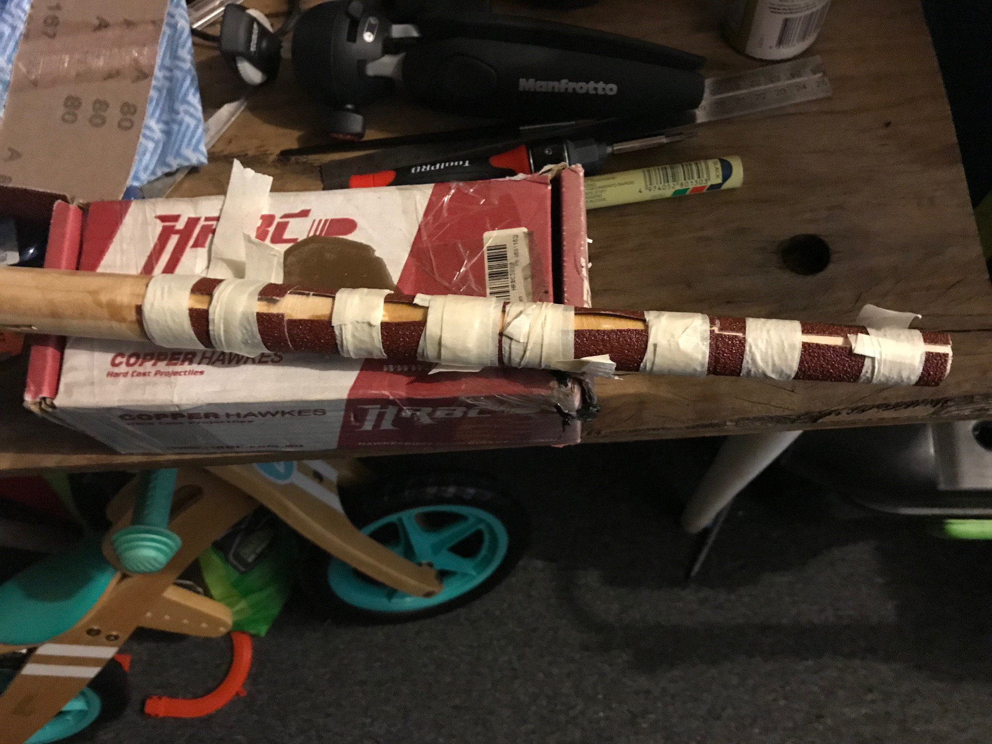

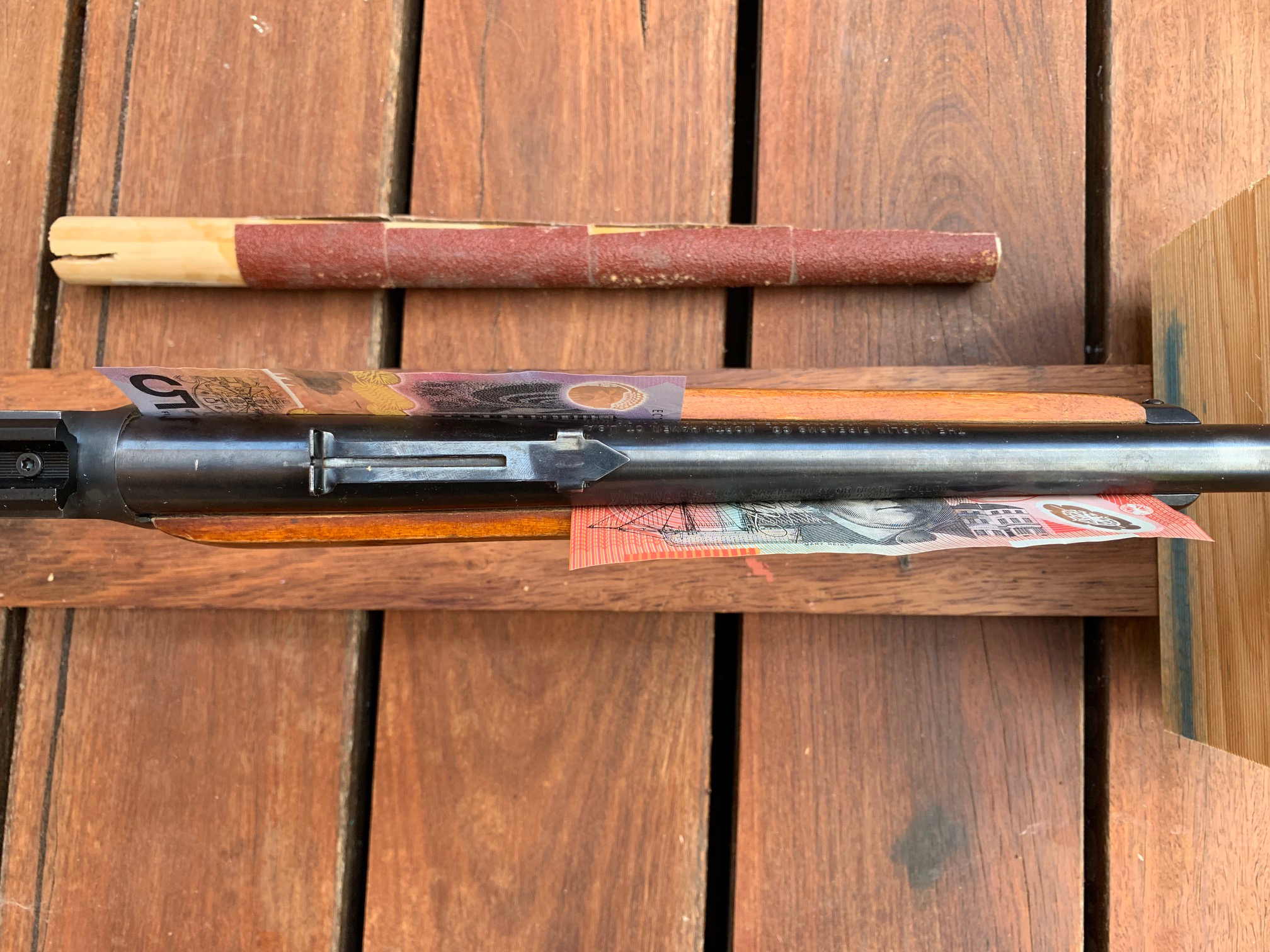

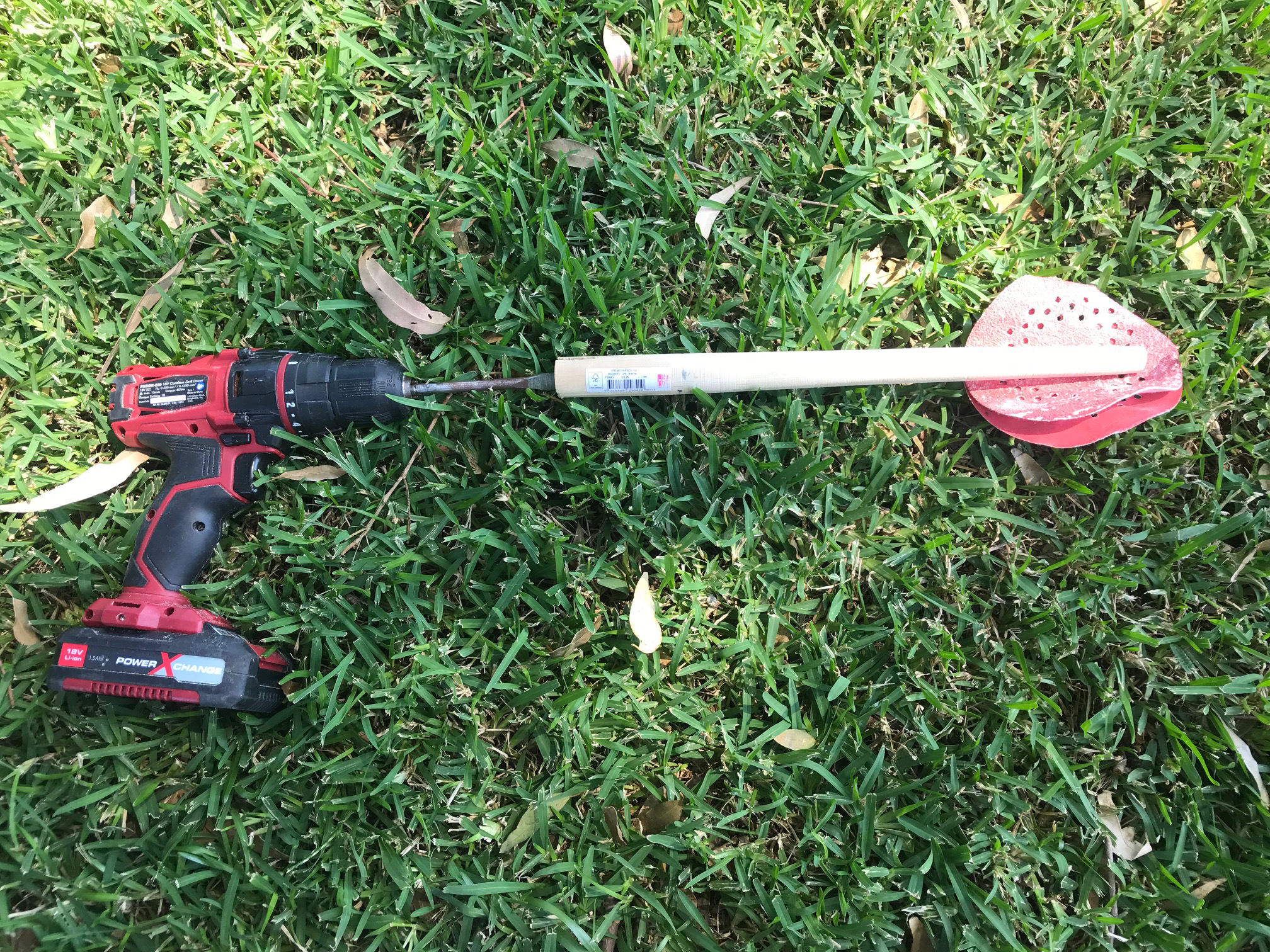

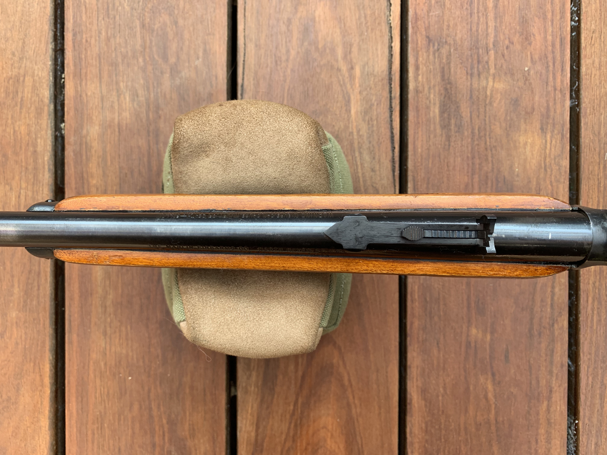

It is important to ensure that the barrel channel clears the barrel along its entire length. With a dowel that closely matches your barrel profile sand away the barrel channel until there is sufficient clearance to slip a playing card between the forend and the barrel channel with the forend normally installed. The card should not bind at any point. I achieved this by buying some 25mm dowel that matched the diameter of the barrel at its thickest point next to the receiver. I carefully turned the dowel down using 80 grit paper (and a cordless drill!) to closely match my taper. I then glued 80 grit onto this piece of tapered dowel, creating a sanding tool that near-exactly matched my barrel channel profile. As specified above, I then sanded out the channel just enough to (after reassembly) slide a few pieces of paper under the barrel with no pinch points.
The poor man’s lathe!
Keep sanding until barrel profile is matched
I attached sandpaper on using epoxy
Sanded barrel channel

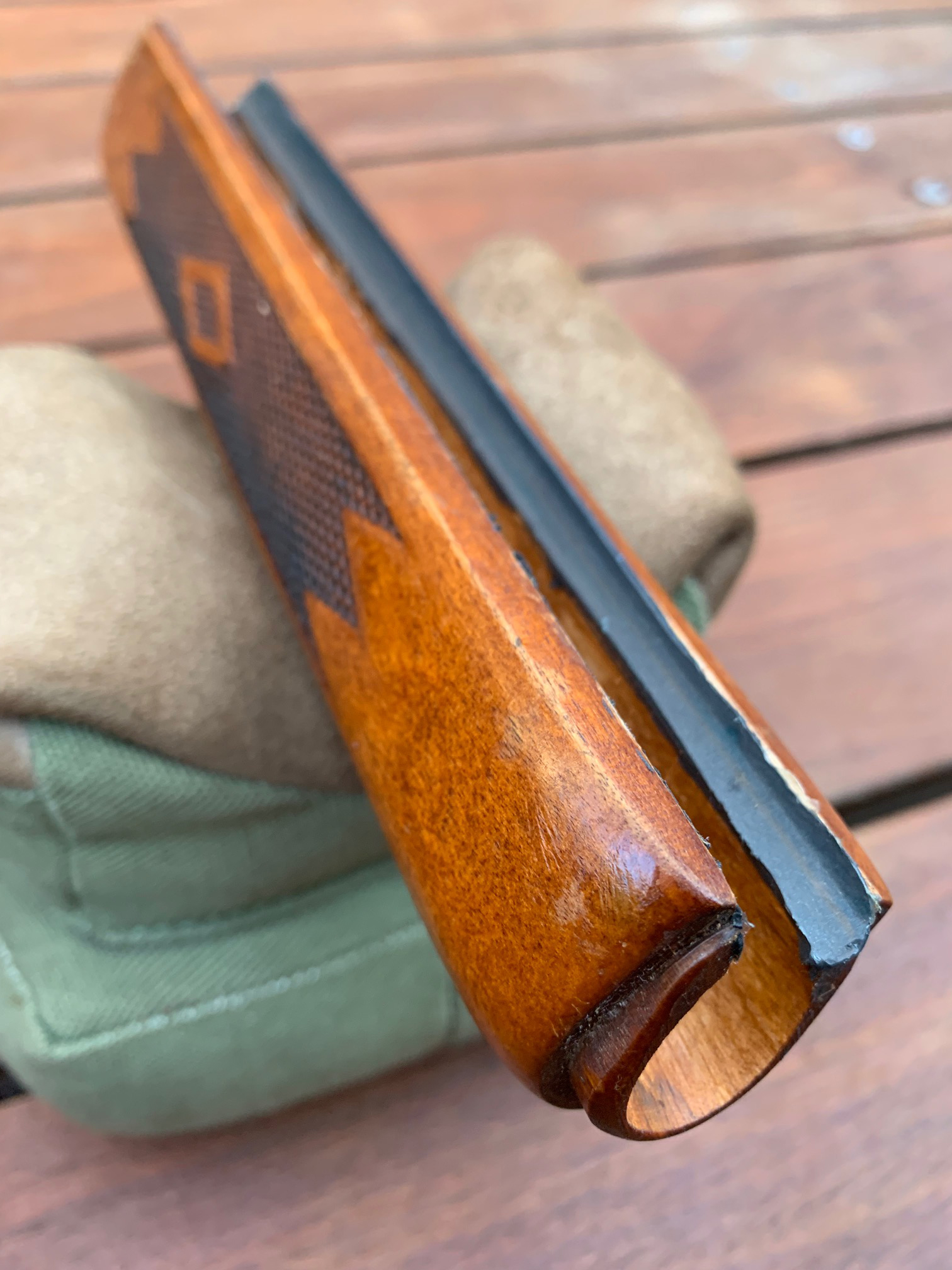

Sufficient clearance to slip a playing card between the forend and the barrel channel with the forend normally installed

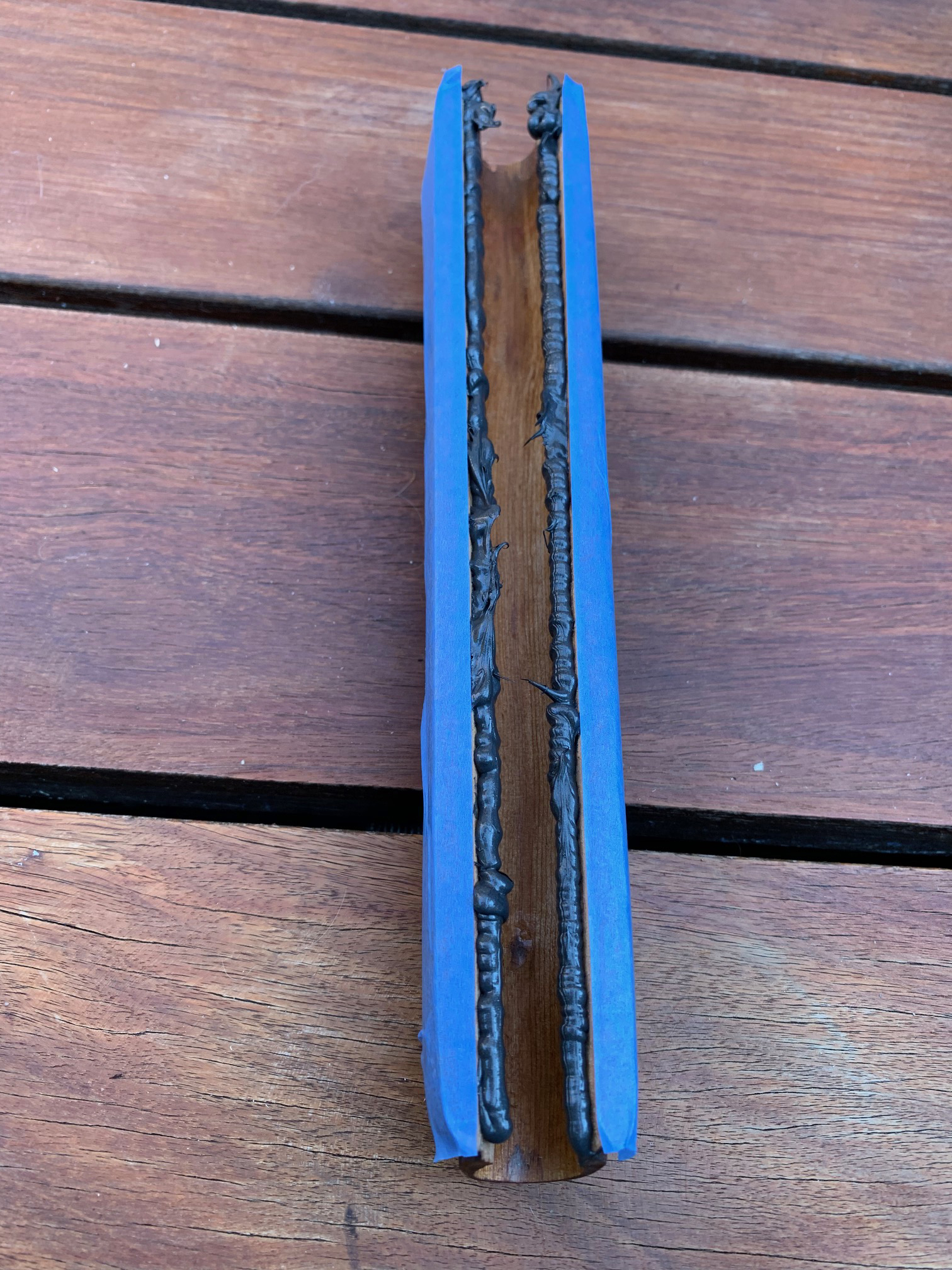

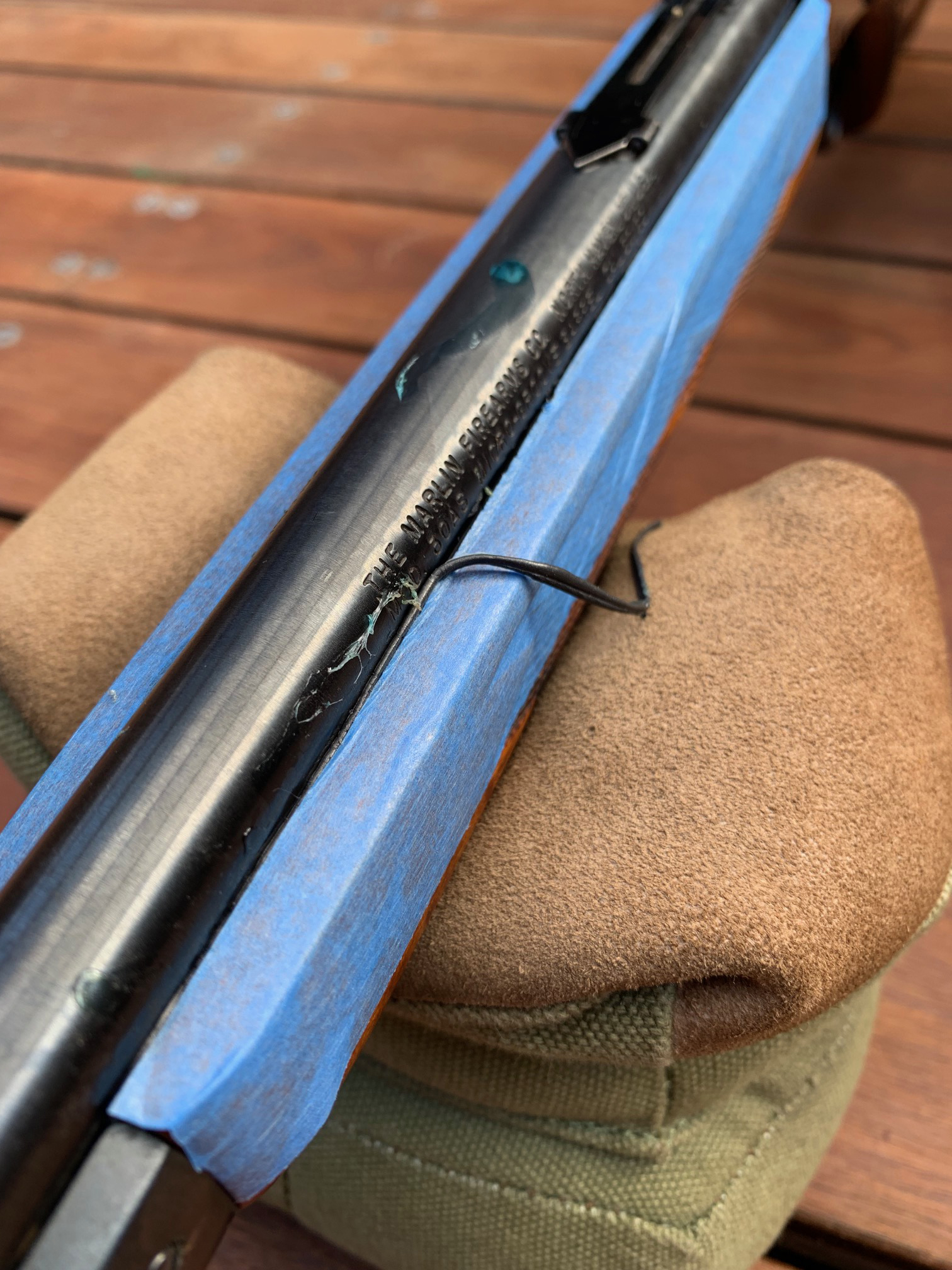

Apply a good thick coating of release agent to the barrel, especially the underside where the silicone is sure to make contact. Mask the outside areas of the forend parallel to the (newly) sanded channel - the masking should be neat and precise as this area will obviously be visible. Liberally apply release agent to the front of the receiver where the silicone could possibly extrude.
Run a large pea-sized bead of silicone down both sides of the channel (where previously sanded), enough so that a bead silicone will extrude  out either side out along the barrel upon reassembly.
Better too much than too little here – we will trim away any excess silicone once green
With the magazine tube still removed, reassemble the forend and tighten up the screws. Invert the rifle and support in the horizontal position and allow the RTV sufficient time to cure to a soft rubbery consistency, about six to twelve hours. At this time the RTV is still "green", it has not developed its full strength.
A little extrusion of silicone is what we are aiming for
Use a single-edge razor blade or an X-acto knife (or similar tool) to carefully trim away the RTV that has extruded from between the forend and the receiver. If you applied release agent properly, the RTV will not stick too tenaciously to the exposed wood or metal surfaces. You should not have any trouble cutting and peeling the extruded RTV away from the barrel and forend.
For best results lay the blade at about a fifteen degree (15°) angle to the edge of the wood. The goal is to cut the RTV layer off flush at the wood side but deeper at the barrel side.
The RTV bedded channel after curing and trimming
Not perfect, but pretty good. Especially on older rifles imperfections are less noticeable.

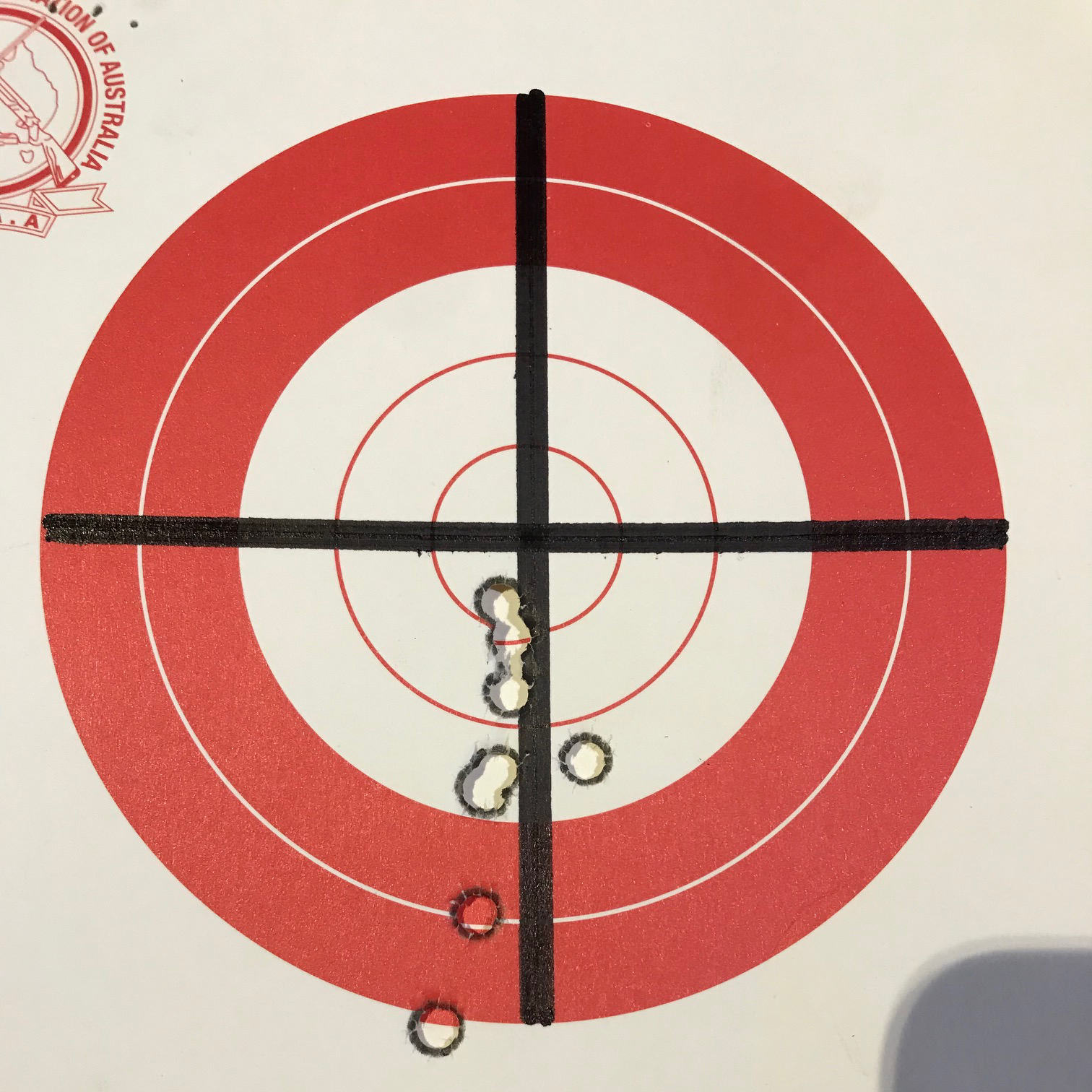

That concludes Part 1. At this point I suggest shooting some groups to get a clear idea of how your rifle groups. It may be sufficient to finish your alterations here (and skip Part 2 altogether). It really depends on the nature and to what degree you are chasing accuracy.
Following the bedding procedure, here are 9 shots in a row WITHOUT pausing between targets. 21grs AR2207/H4198 under a 150gr (~1900fps). No more vertical stringing.
BTW the above work was carried out on JM era Marlin 30AS manufactured in 1996
200m 12-shot group - for a 30/30 lever, a bit over 4" is pretty outstanding for such a long string of shots.

For those of you still interested, I finally made some time to test the RTV bedded 30AS in a controlled 50m environment. I took 9 rounds to the range. Here are those 9 shots in a row without pausing between targets:
30/30 50m group; 21gr AR2207 under a 150gr (~1900fps)
Interestingly, I did not crimp these loads. But neck tension is tight with the Hornady die (unlike the Lee die). I'd say at least -0.003". Yes, the poi shifts a little, but importantly the vertical stringing has now been eliminated. :drinks:
