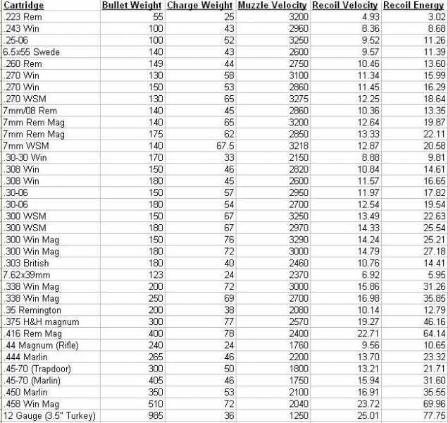

Reading the recoil comparison thread got me thinking about this. If I were to compare a 308 with a certain projectile and speed against a 243 and I were to arrive at muzzle energy figures does that help me make recoil comparisons I mean , if the 243 has 2135 foot ponds of energy and the 308 has 2648 foot pounds of energy and if the former has 24 per cent less energy than the latter, does that mean that it’s also 24 per cent less recoil ? (Not counting action type/ stock design / rifle weight / recoil pad etc.) is that how it works or do u reckon recoil comparison is more complicated?

Thermal scopes are mounted back closer to the shooter. Sometimes when shooting prone position I get a bit of a smack in the head from the back of the scope but when I look at this chart baron just posted I see that my rifle kicks about half as much as a 270 or 308 so I got nothin to winge about I’ll just cop it
