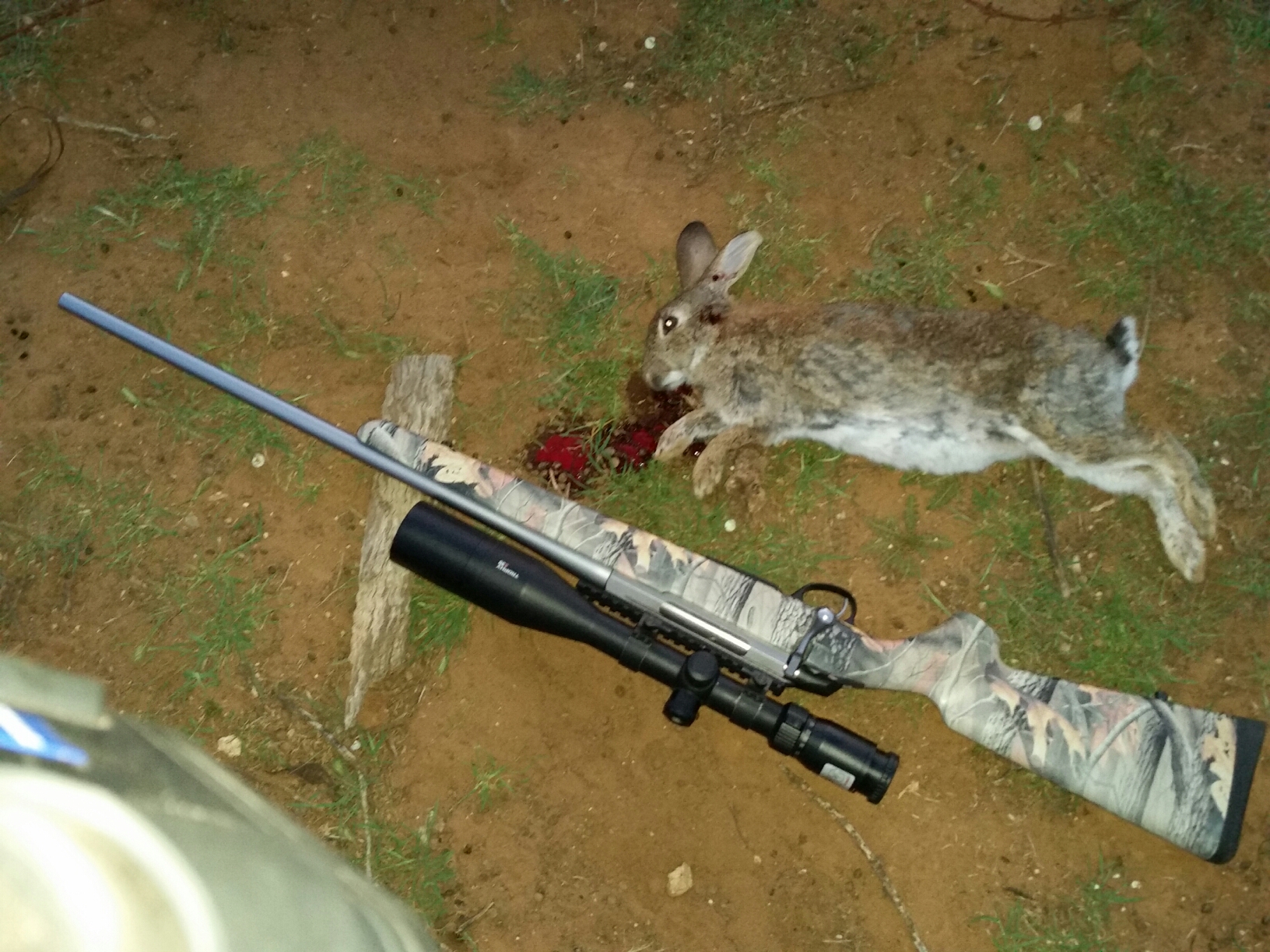

Post by Stix » 12 Oct 2019, 3:25 pm
Heres that bunny...351 yds
350 yds
2018-09-11 15.41.15.jpg (1.38 MiB) Viewed 8407 times
