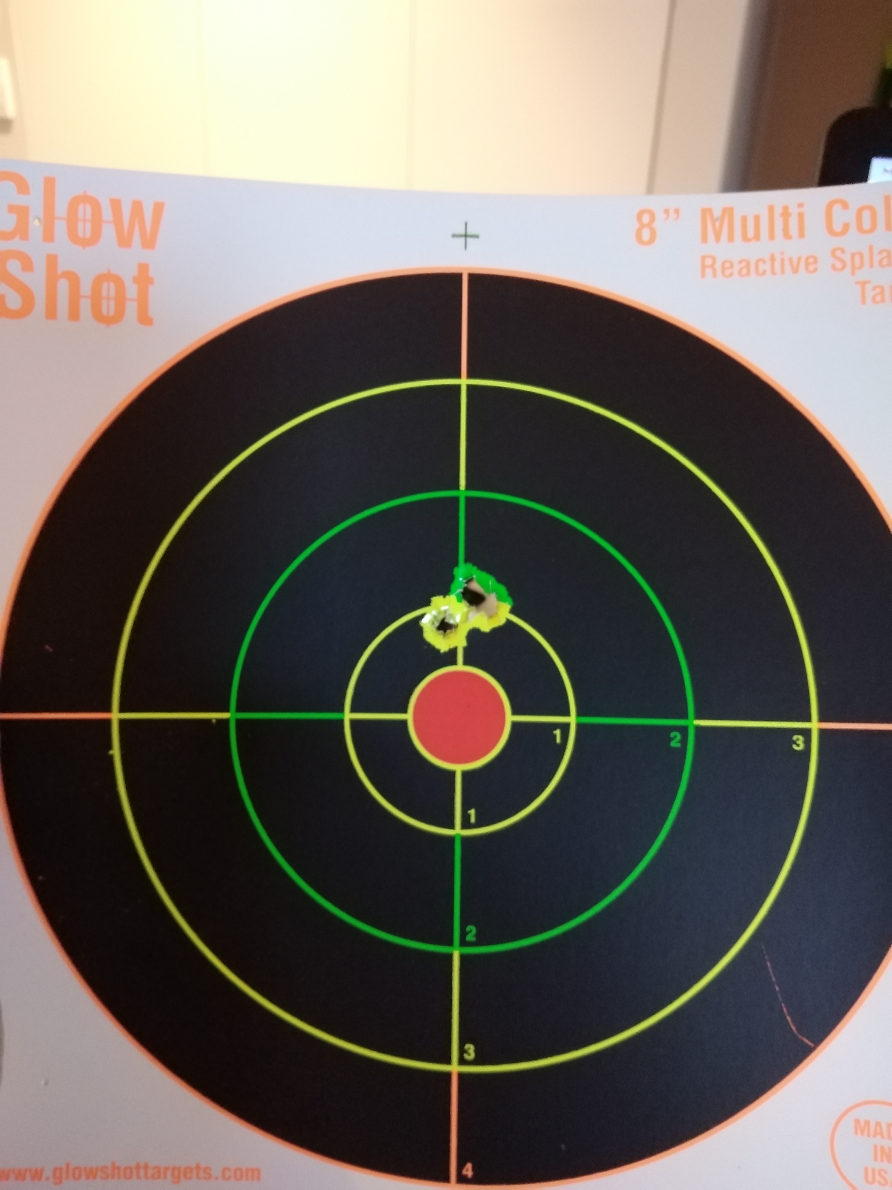

100m
I have had a 1500 sporter Howa in 308 for a while now but was pretty unimpressed withe hogue stock which never allowed me MOA with factory or reload ammo. At one stage I filled the forend with epoxy filler which firmed it up 100% and I was getting tighter groups around 1 MOA.
Now Ive bitten the bullet and put a Bell and Carlson M40 on it and I'm very pleased with the results. I tried 150 grain soft points but as you can see in the pic below, the 165 Speer SP boat tails with 42 grains of AR2208 produced good results 3 shots at .37 " @100m
I,'m also getting about 1/2 MOA at 200 m but no doubt be able to get better if I was a better shot :D

Yep Howas respond well to a decent stock, the Hogues don't seem to work well when it comes to accuracy, work fine as a walk about outfit however which is what they were designed for.
I only ever buy the barrelled actions, I have no interest in Hogue stocks.

Bloody terrible results mate Id be takin that gun back it didnt shoot MOA :lol: nice shootin thats a keeper :thumbsup:
