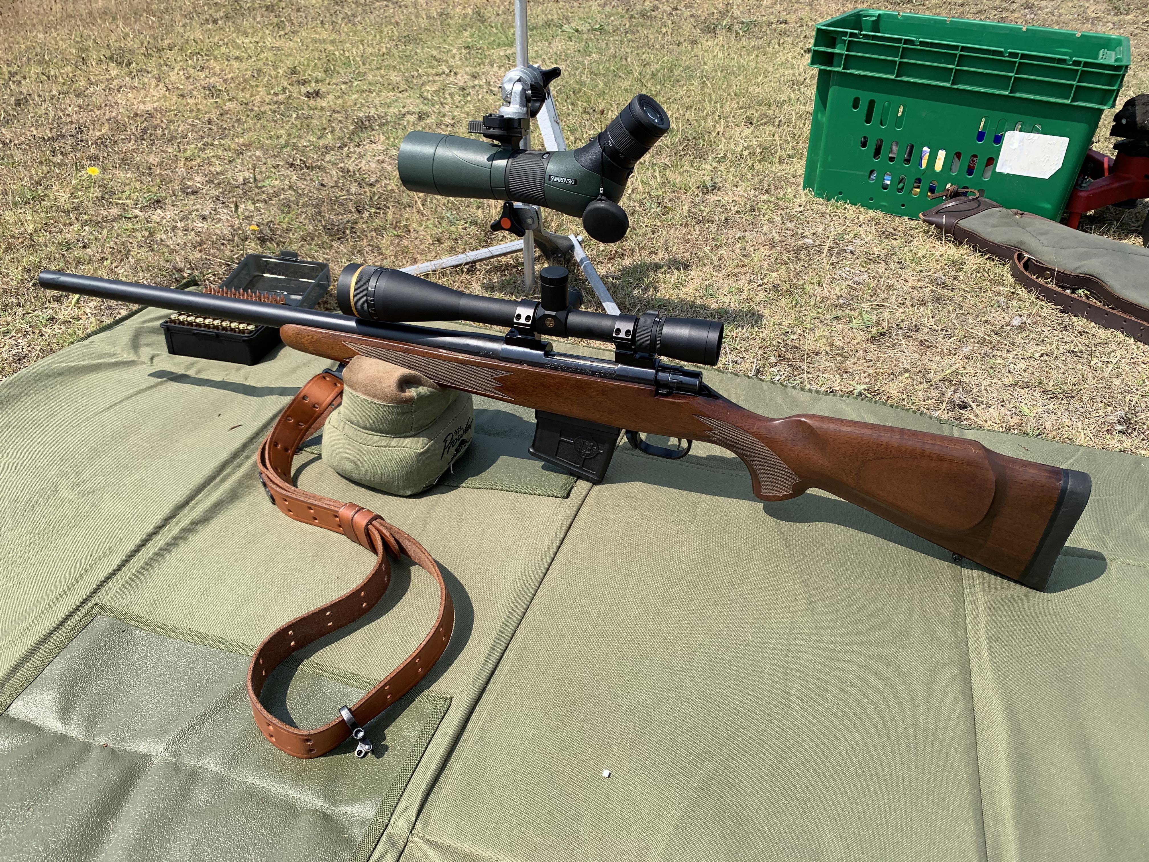

Post by marksman » 18 Jan 2020, 10:12 pm
l built a 270wsm out of my last 300wm and it has better ballistics with 150gr sst's than my 6.5x284 with 140gr bergers
l could have gone the 300wsm but the 270wsm is better for what l want, a long distance really flat shooting thumper
so far it has been put to work at over 700yds without a hitch
mine full cost including original rifle was
1000 rifle
1000 scope
350 barrel
350 stock
400 smith
200 dies and cases
l had to do a lot of fitting and finishing but it shoots 150gr bullets @ 3200fps 1/4 moa
l'm not trying to talk you into anything or trying to confuse you :lol:
the hard part is deciding what you want :thumbsup: but l know your smart enough to know that :drinks:
here is the rifle finished but it has a bigger scope on it now

Post by Member-Deleted » 19 Jan 2020, 12:45 am
Nothing wrong with that rifle by the looks mate . And What action is it built on ? And yeah 270 wsm would be one i'd look at no doubt .I used to own a Parker Hale in 270 years ago and it was a very accurate rifle and hit like the powers , it used to roll the brumbies with authority every time. yep i'll ponder that one . Ive also thought about the 7mag as well . if only I could get bits for my sako 7mm mag I could make it into a good rifle with some tinkering , maybe a trg stock but they won't fit according to GS and too expensive to buy and try. anyway got a start thanks MM
Re: Best action for rifle build
Post by marksman » 19 Jan 2020, 8:09 am
your right about stocks being hard to find for the later sako's
l had a bit of a look at richards micro fit who are usually pretty good but they only have stocks for the early ones :unknown:
this action is just an old tang safety ruger, nothing special but l was attached to it and it works
the reason l suggested the wsm is the smaller case is easier to fit in long action for the oal, my 270wsm cases with 150gr bullets are very long
its like shooting needles and as l said it is better ballisticly than my 6.5x284
you could even get a tikka action already in wsm ect... but it needs to be something you can plumb (the plumbers gun :lol: )
anyway more to think about :drinks:
