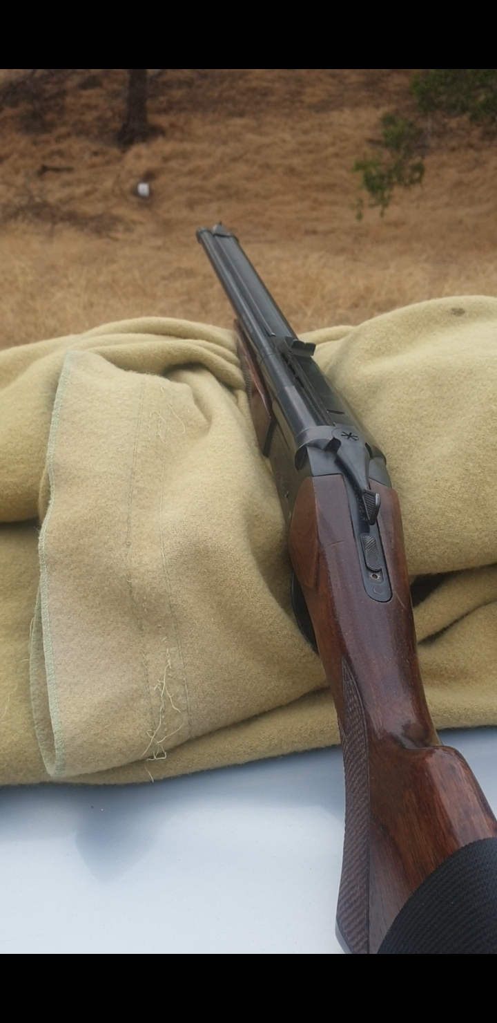

Finally bit the bullet and got the Baikal double rifle out yesterday. Been a 2 year process trying to get it regulated,with much hair pulling. Main issue being a height difference between the barrels. Well,I had an epiphany the other night,and shimmed the floating barrel from the bottom with some cardboard...
Well....first right and left combo put both bullets through the same hole ! Thinking man that was easy, proceeded to try to sight it in....wrong ! For some goddamn reason it started printing the barrels a foot apart at 30m !
Pissed off,and down to my last 8 shots,I just wound the crap out of the jack screw till I saw the barrels bend out in the middle....vióla ! 4 shots,right and left,into roughly an inch and a half at 30m...a little out of line...but bloody hell,that's just moving sights ! Finally have a good hard hitting load that actually regulates ! Woo !
Now for the harder job...getting laid...;)
Screenshot_20200119-154036_Video Player.jpg (507.8 KiB) Viewed 5466 times
Screenshot_20200119-160718_Video Player.jpg (496.93 KiB) Viewed 5466 times
Screenshot_20200119-154123_Video Player.jpg (668.97 KiB) Viewed 5466 times
