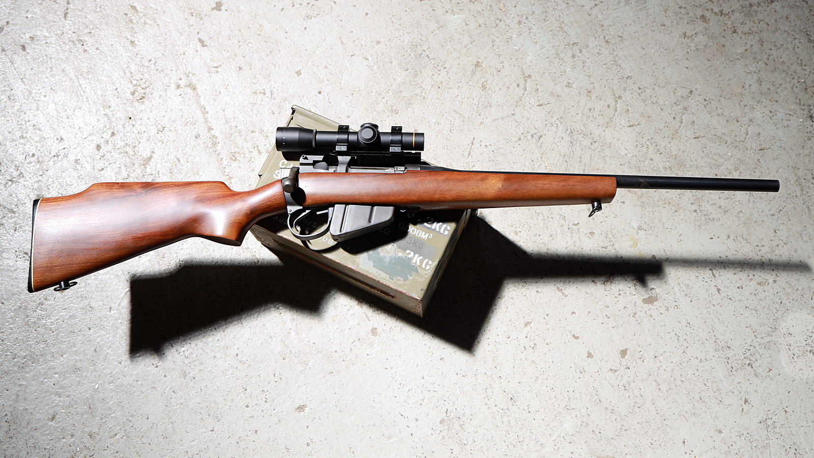

If you scored that for $200 you got a bloody bargain!
There's probably $1000 in the scope, mount, stock and magazine alone.
Is the barrel aftermarket?
Re: 200 dollars hunting rifle
Post by SHV » 01 Feb 2020, 12:14 pm
bladeracer wrote:If you scored that for $200 you got a bloody bargain!

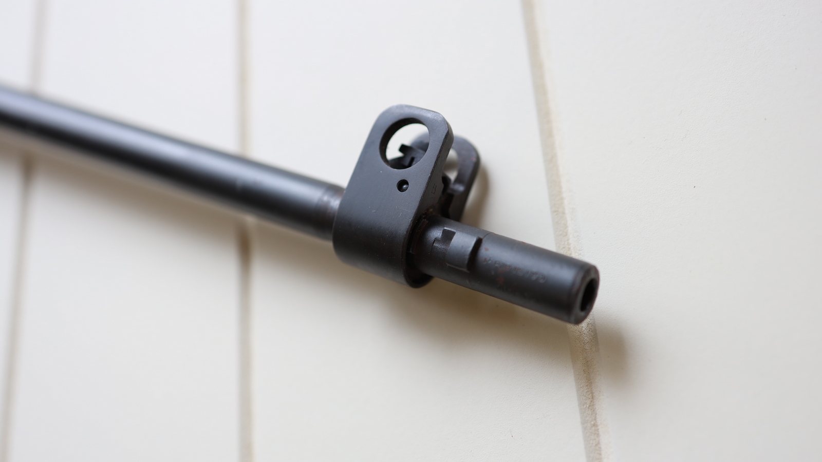

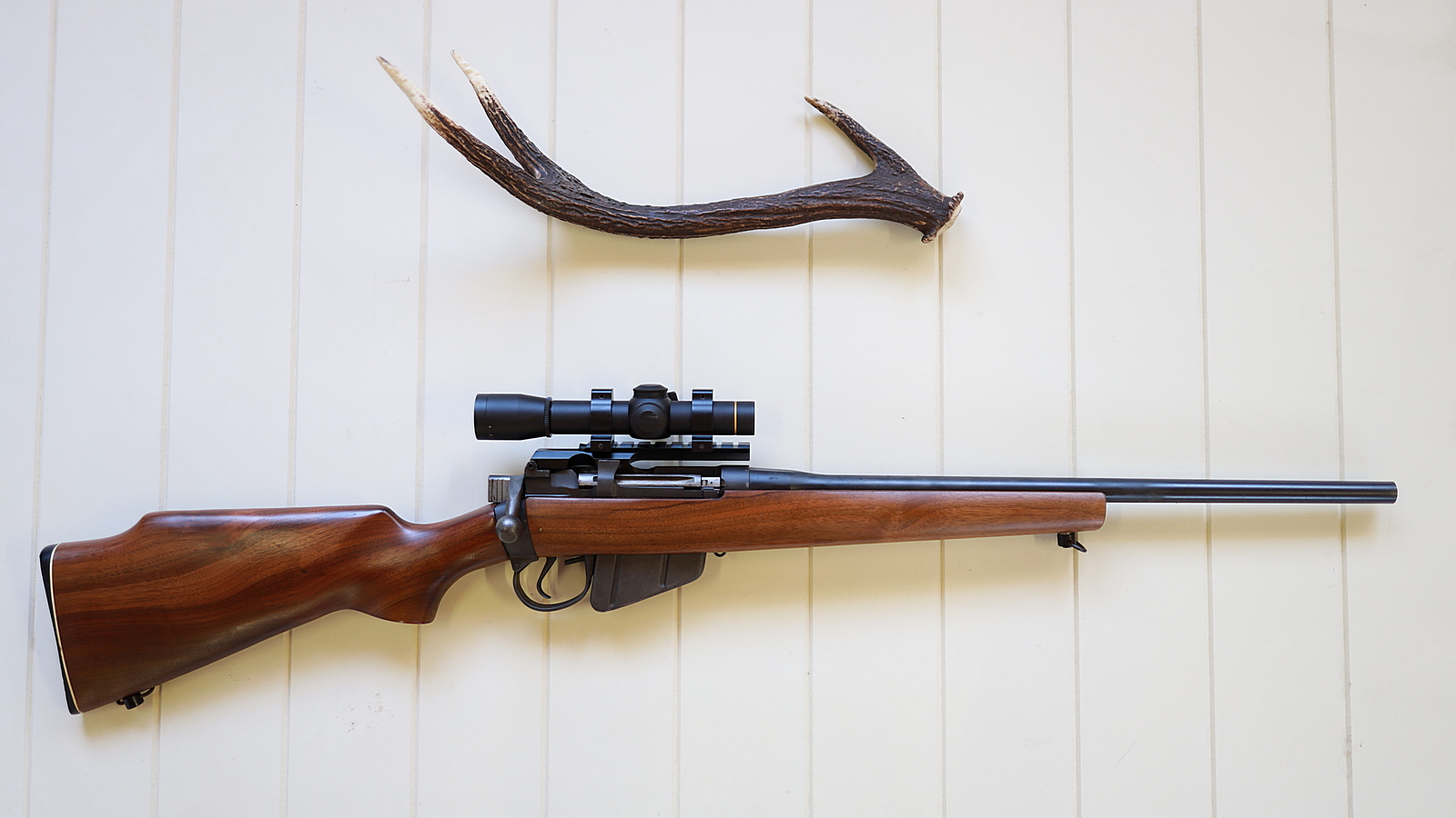

sorry for the misleading, the rifle is 200 dollars I bought the mount (75 dollars delivered) after find out the barrel is not good to shoot (the POI is far right out of front sight adjustment) also the rifling on the middle and rear part is good but no good at all in front, so I cut the barrel put the scope on, hope can find a time to try soon
for the action, stock and mag, 200 dollars still a good buy I reckon, if still can not shoot normally, maybe put a new barrel for her

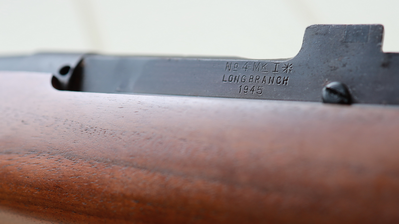

the barrel got a stamp saying it has been re-barrelled at 50's

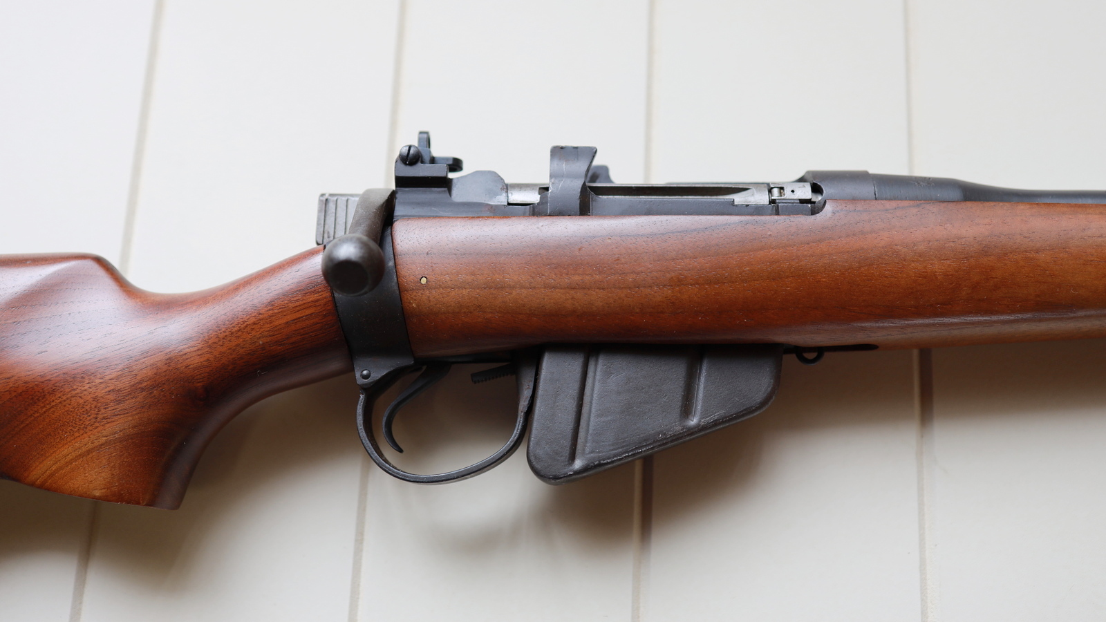

the rifle when I bought it
paid the ex owner 200 dollars, 30 dollars PTA and 45 dollars transfer, so I should say 275 dollars rifle at that time...

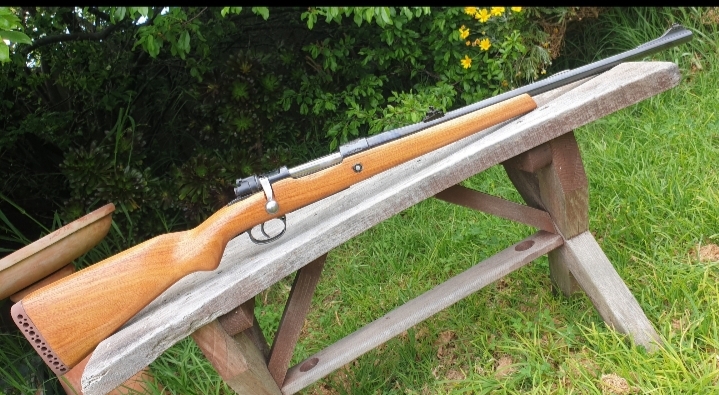

Here's my $100 mauser 98 in 35 whelen that came with 35 rounds of Remington core lokt ammo and 5 empties... ;)

That looks brand new!

l'll give you $20 for it pete :thumbsup: but l want the ammo and empties ;)

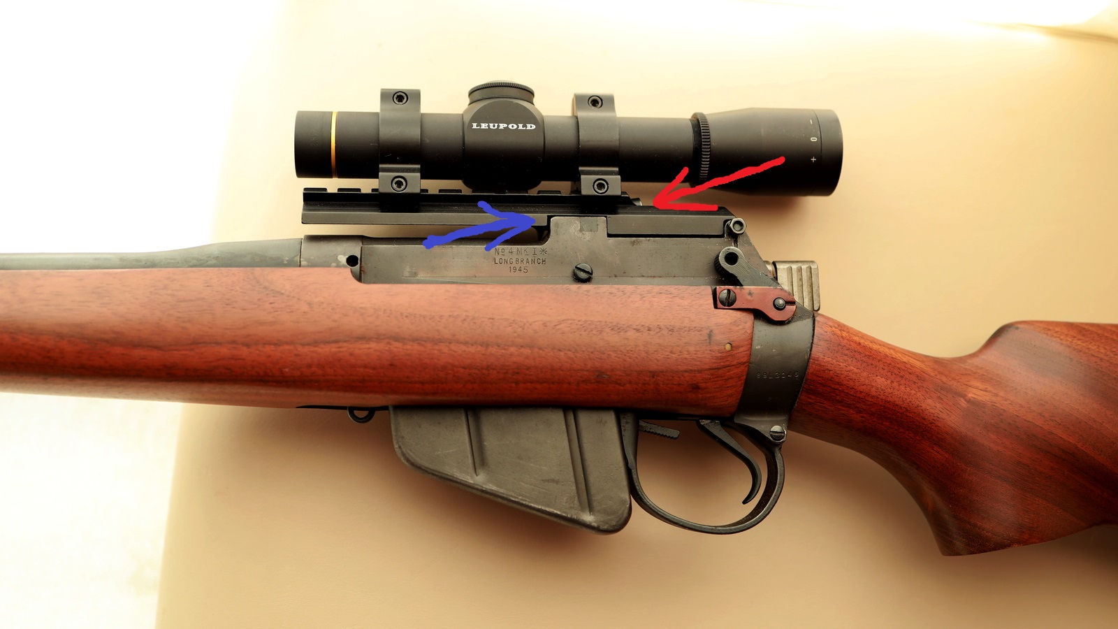

It certainly is a fine looking specimen..
Can you clarify, the rail (mount) appears to be only attached at the far rear ?????
:unknown:
Posts: 4406
Post by SHV » 03 Feb 2020, 7:28 pm
Die Judicii wrote:It certainly is a fine looking specimen..
:unknown:
there is a large bolt (red arrow) grab a metal bar (blue arrow, beneath the rail) to fix the mount in the middle as well

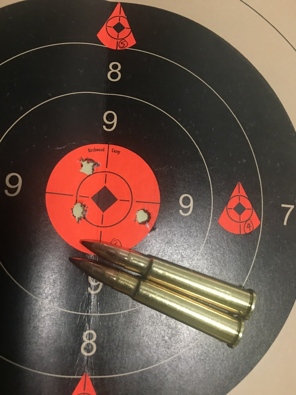

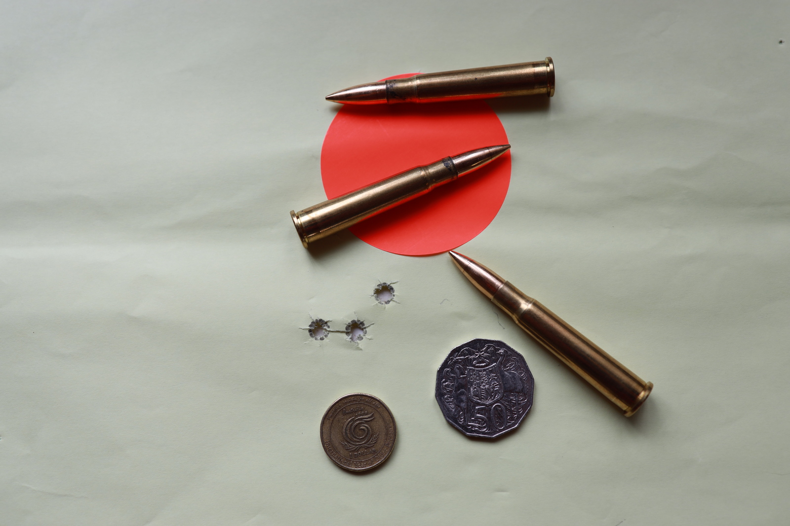

finally got time to try it, 50 meters indoor, 2.5x fixed scope
SHV
Posts: 1780
Post by SHV » 08 Feb 2020, 10:35 am
3x3 shot factory ammo groups, POI roughly the same as bore sight, looks like the problem solved
SHV
Posts: 1780
Post by SHV » 08 Feb 2020, 10:39 am
wait the barrel cooling down after each shot, best 3 shot factory ammo group
SHV
Posts: 1780
Post by SHV » 08 Feb 2020, 10:43 am
hand tools DIY barrel cutting project looks like not too bad, next time will try reload to see if more accurate and stable...

Wow that's awesome

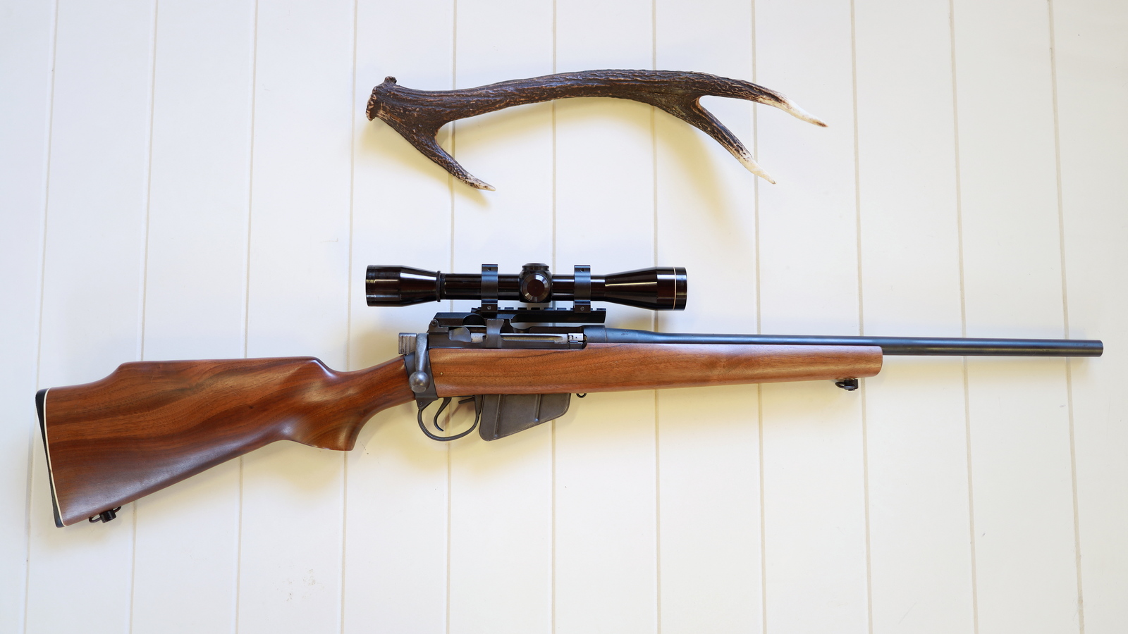

got 6 power fixed scope for her

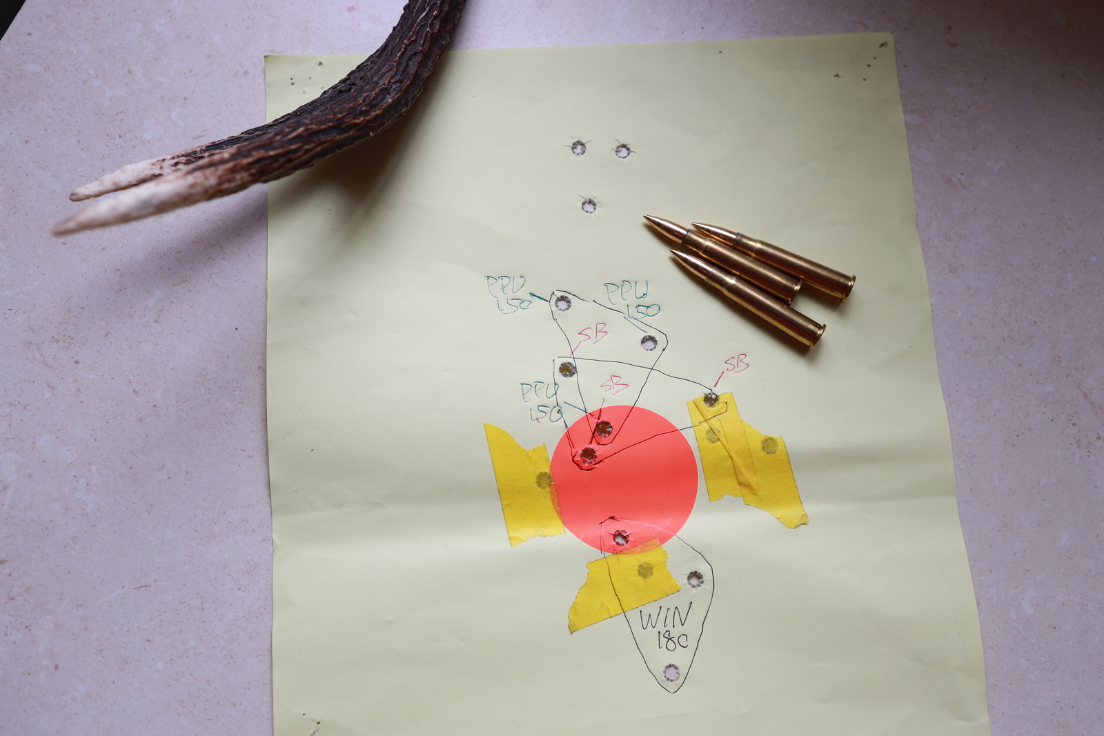

S&B ammo after zeroing the scope
