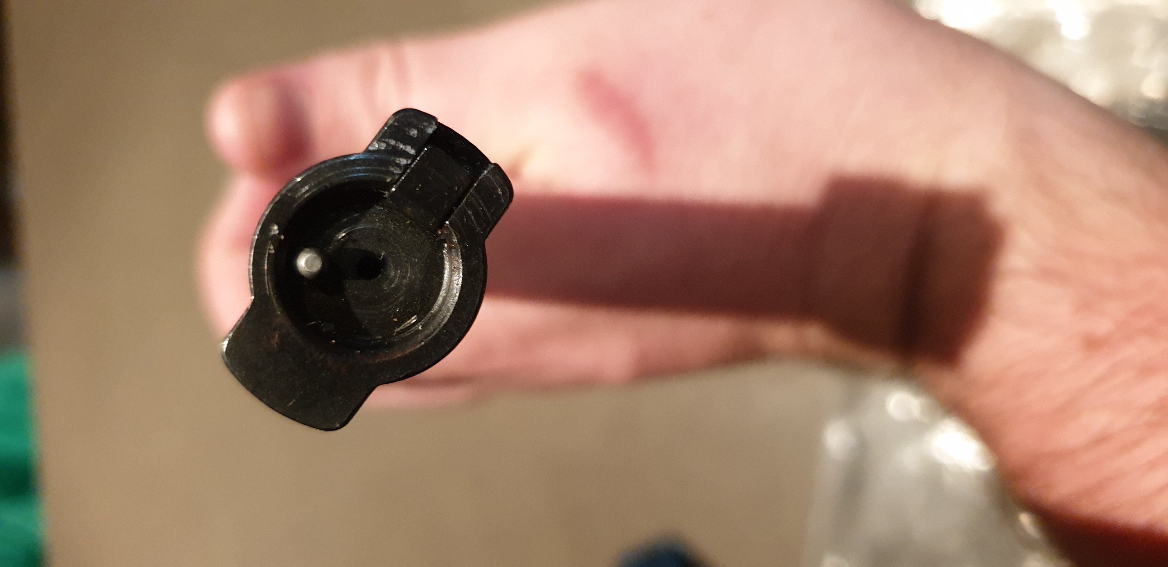

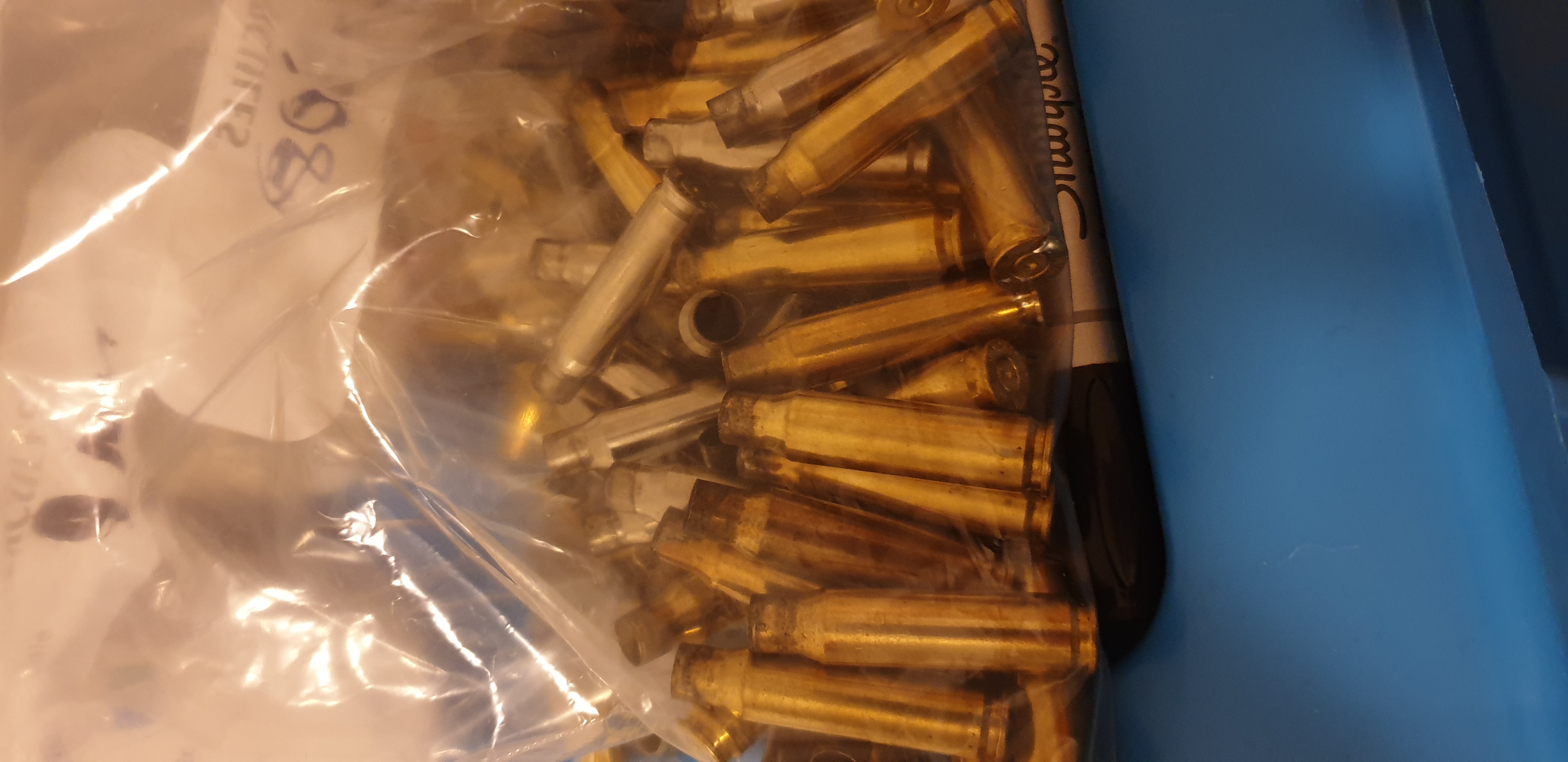

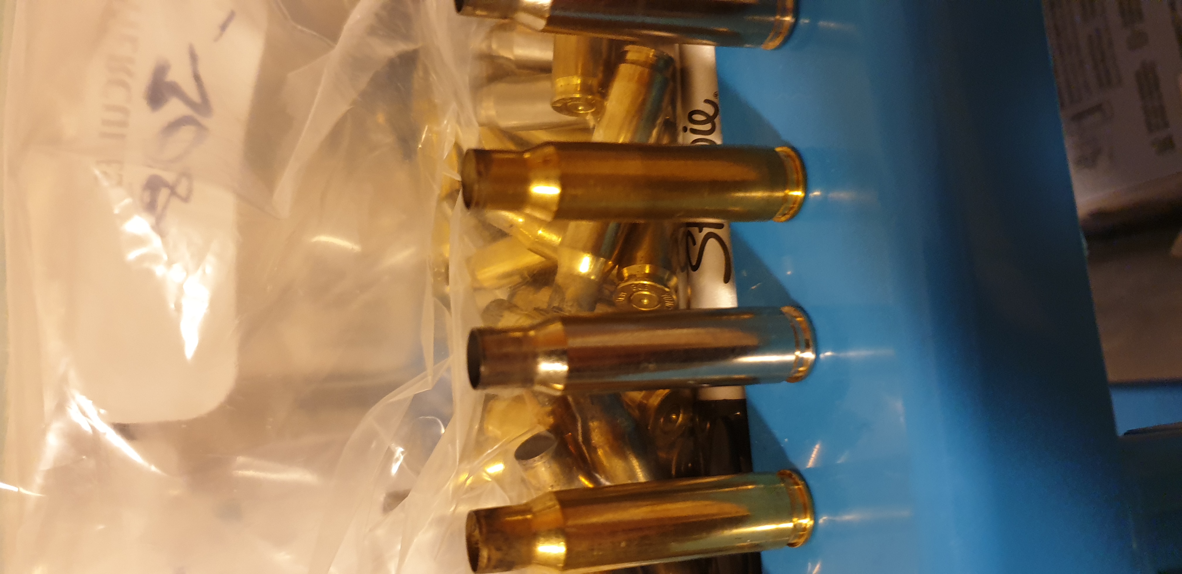

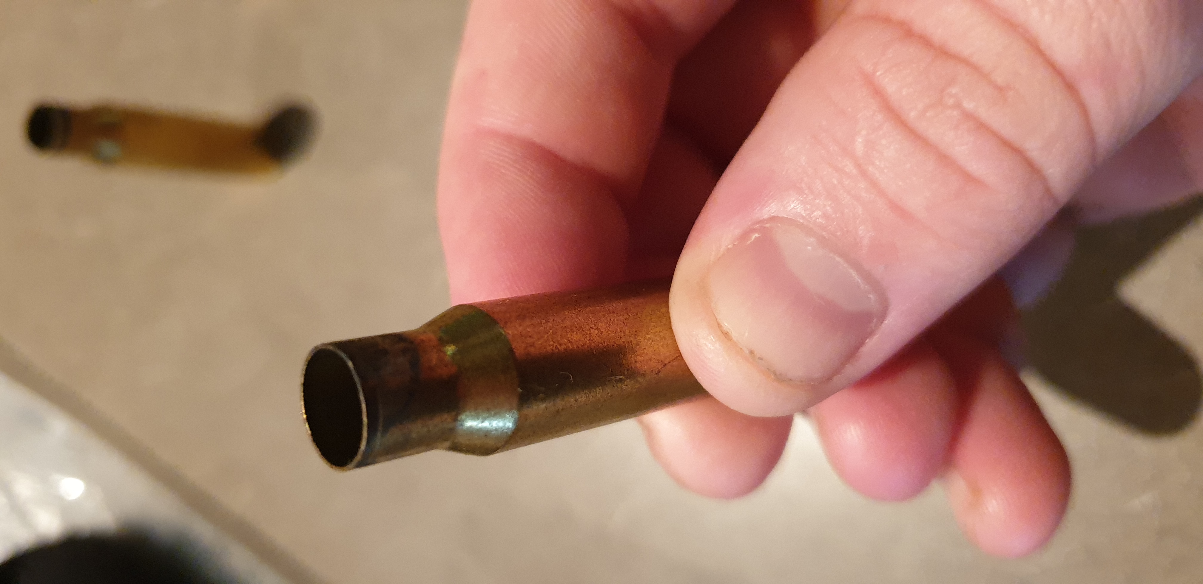

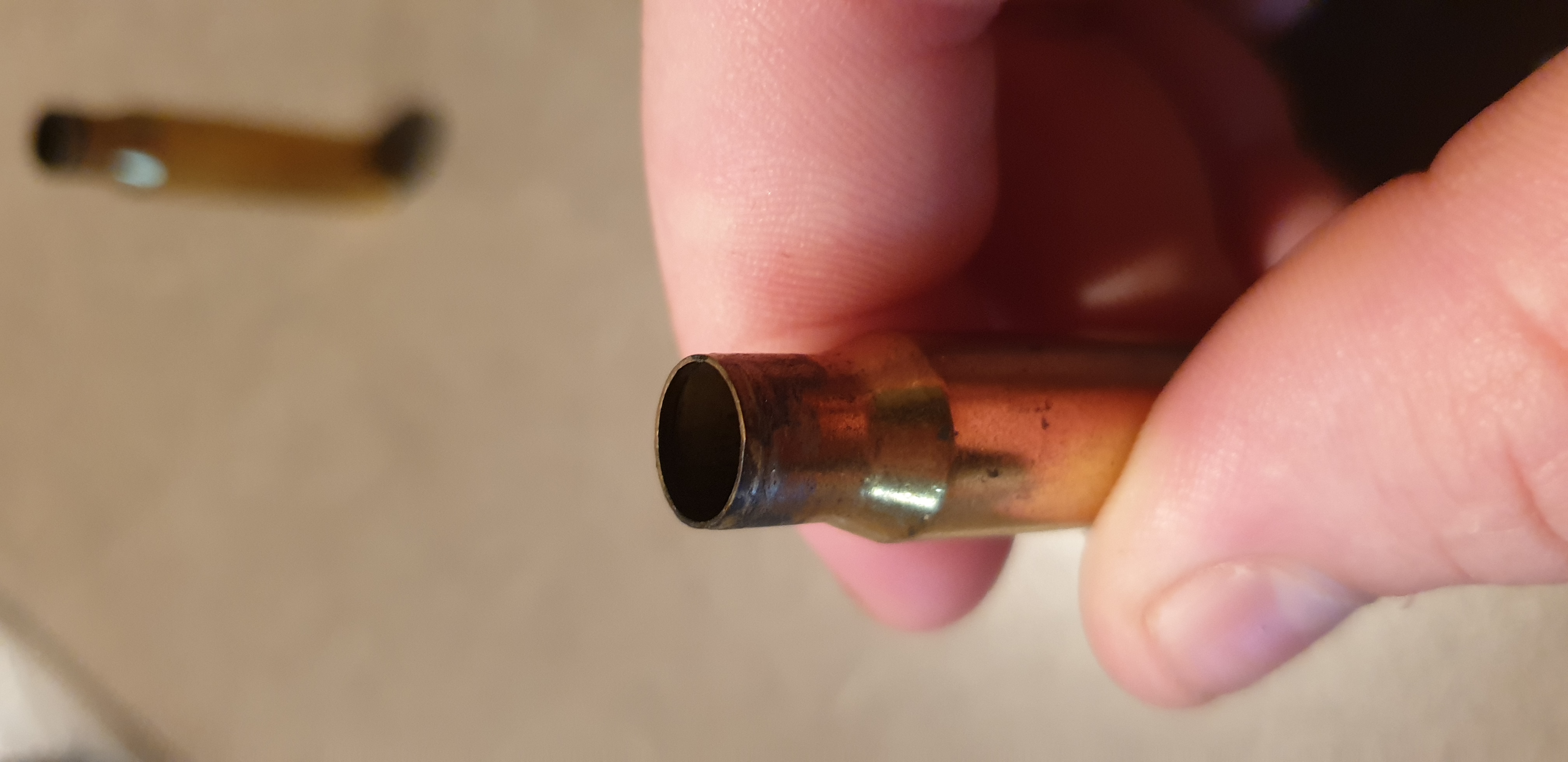

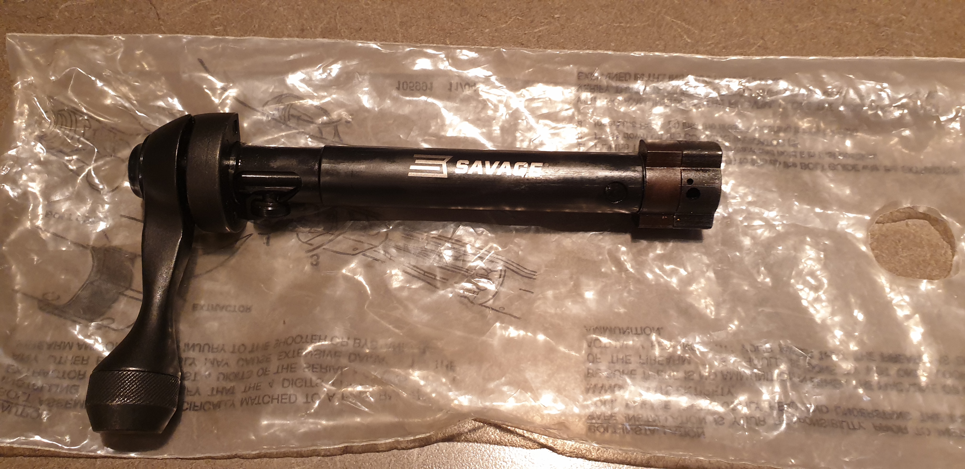

Post by Jt-2019 » 05 Feb 2020, 9:39 am
I've got all the brass that I've shot but I'm unsure wich brass is the rifleline I'll attach some photos cheers. I'll add a photo of the bolt also? That might help? Thanks for the help.

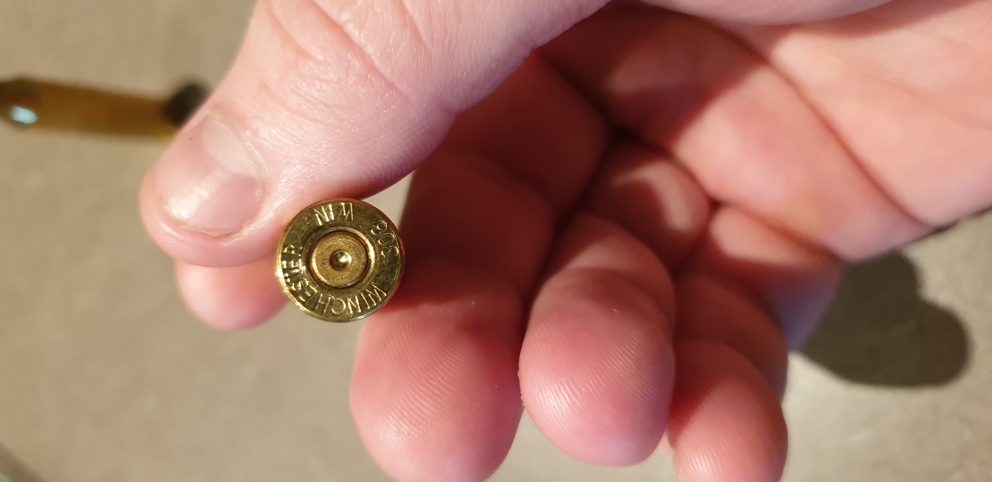

Mate close ups of the cases will help immensely. Ensure to take a photo of the bottom of the case so we can see the primer.

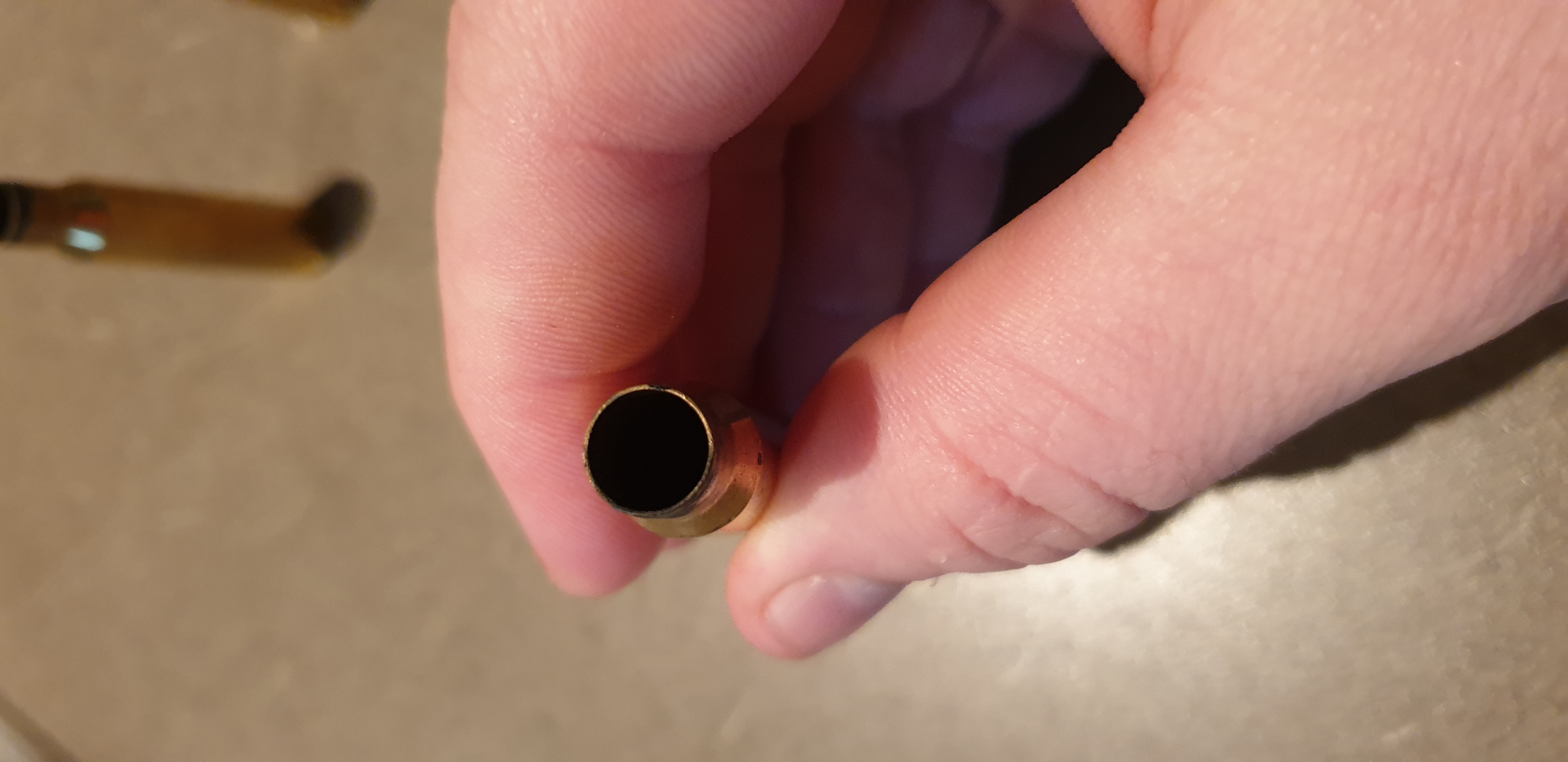

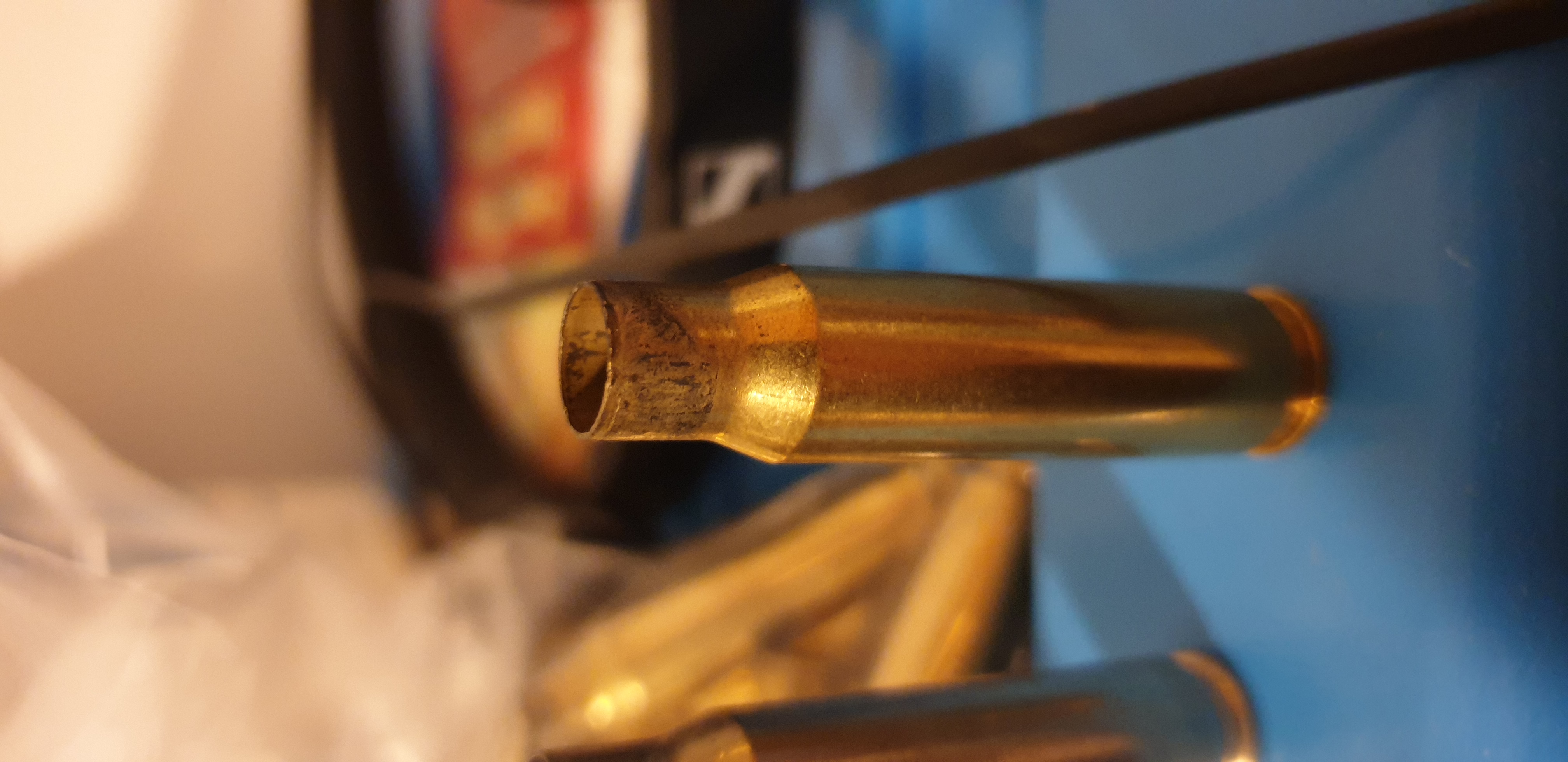

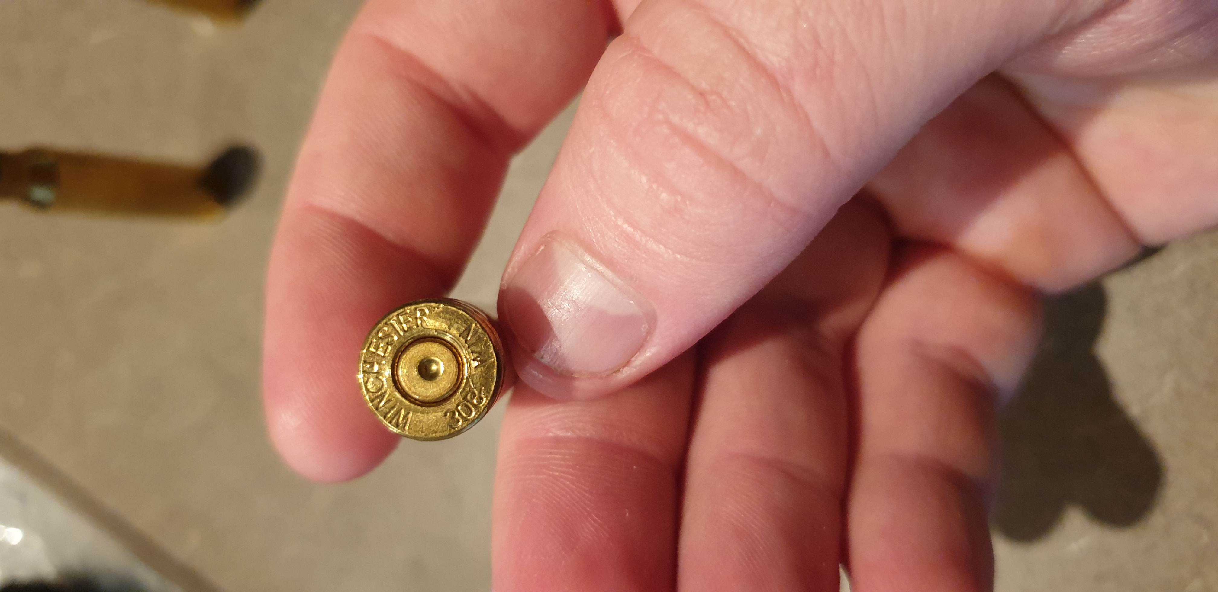

Re: Savage .308 rifleline ammo
Post by Jt-2019 » 05 Feb 2020, 10:38 am
Here's some better photos
Same case
I think this case was the one
Post by Wm.Traynor » 05 Feb 2020, 11:02 am
Yep; I can see a bright rub mark on that one at about 1 o'clock.
Post by Jt-2019 » 05 Feb 2020, 12:00 pm
Wm.Traynor wrote:Yep; I can see a bright rub mark on that one at about 1 o'clock.
Please explain so I know for next time? Thanks mate
Post by Wm.Traynor » 05 Feb 2020, 1:43 pm
I recall reading an explanation years ago that says that excess pressure drives the case into the bolt face. When the pressure is bad enough, some of the case flows into the ejector hole and stays there. When the bolt handle is lifted that tiny bit of flowed brass is broken because the bolt-face turns at the same time. This reveals the sub surface brass of the case head and accounts for the bright, curved mark.
Curious to know if it was only the one case, or all that were hard to open. Wondering if you are entitled to a refund.
