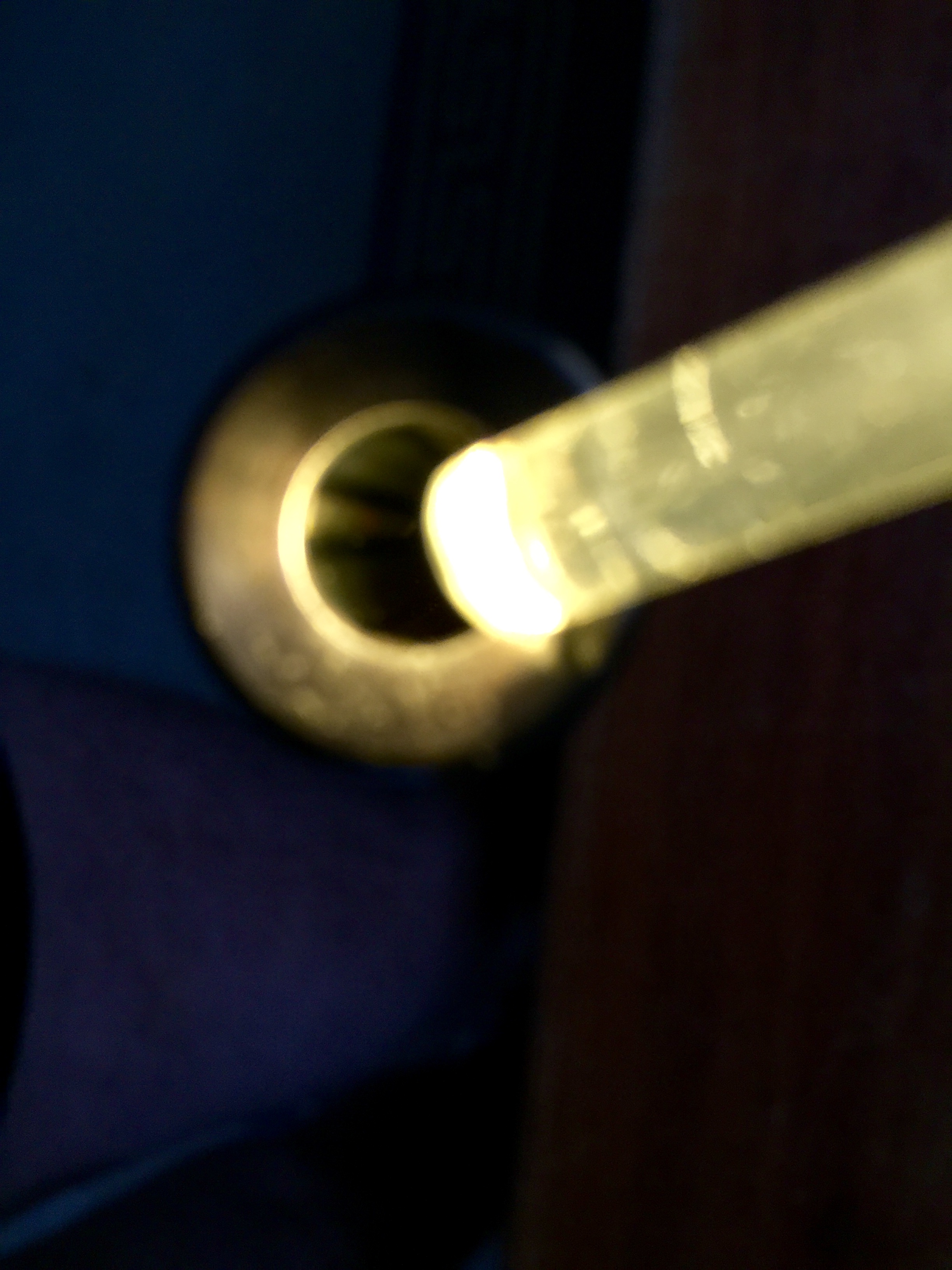

Post by TassieTiger » 17 Feb 2020, 8:15 pm
I have a query for the brains trust...
Everything I thought I knew about copper fouling (which was %*#{ all really - has been turned on its head by a local, respected gun smith.
My sauer 06 is a fantastic rifle. Shoots 168gns at 3100fps amazingly well...I could not ask for better. BUT - the last 6-10 inches of rifling have bright shiny Cu streaks that I haven’t been able to move - regardless of solvent type. It does not affect the accuracy and after cleaning, it takes a couple shots to get the really tight accuracy back...
Turns out, I bumped into my local GS - a highly respected local and I asked him the question as to what I might do to remove the streaks.
His answer was - why? If it’s shooting well, then there is no bother in leaving it there, just clean as per normal, or risk damaging the accuracy I currently enjoy...
Umm...ok. I told him my understanding was that over time, copper might result in pitting...
He said barrels are individual and will tell you what they need by their accuracy...some work well with cu streaks and will never be problematic as a result, others can’t Work with any copper what so ever in their rifling...just very individual things...
So now I’m a wee bit confused. Have I just been educated or have I been fobbed?

It has to come out. Ballistol Robosol has instructions where you can put a stopper in the muzzle and fill it up with solvent. I have never done it.

Post by SCJ429 » 17 Feb 2020, 9:50 pm
The copper is reducing the dimensions of your barrel and you are layering down copper with every shot. Accuracy will get worse over time. I would push a wet patch up the muzzle and add copper solvent, wait a while then give it a scrub. Then do it again until clean. I use Boretec which is pretty effective.
I cannot understand why you got that advice from your gunsmith. Write to John Gilles and ask him. If he agrees then fair enough but I cannot see it happening.

Post by straightshooter » 18 Feb 2020, 7:09 am
If one looks at the 'Activity Series of Metals' one will note that copper and iron are some distance apart. The further apart metals are in the series the more reactive they are.
From personal experience of borescope examination of barrels that have had long term (years) of untreated copper fouling, with the bore otherwise preserved with oil, I have found that when the copper is finally removed then the area that was covered by copper invariably has an etched appearance. Where the copper was the thickest the etching is most pronounced.
This is not good.
This is also probably why successful benchrest competitors put so much effort into keeping their bore clean.
A gunsmith may be an excellent machinist and artisan but he might not know which direction his a$$ is pointing on other matters.To say nothing of lesser exponents of gunsmithing who are skilled at misdirecting blame for their lack of expertise.

Post by TassieTiger » 19 Feb 2020, 6:35 pm
So now I’m confused and getting frustrated and likely to break something.
Since 1 o’clock today, I’ve used birch wood and Casey bore scrubber, sweets copper remover and hoppes copper remover. I’ve left some solvents in for over an hour via wet soaked patches, I’ve scrubbed wet nylon and wet brass, I’ve wet patched, dry patches - then scrubbed wet...then as a last resort - attacked from the muzzle end as well - concentrating on the last 3-5 inches, scrubbing in and out, 50-60-70 times...the copper does not look ANY different than when I started...wtf is going on. I’m seriously going to end up screwing this bore.
In contrast, the howa 1500 that had light streaks but similar, was 100% clean inside 10 minutes by...one dry patch, then one saturated wet patch, leave ten minutes, out came 3 blue patches that lighten off as they went...to nothing inside 8 patches.
The sauer? I must have 60 patches used. The rifle is not old and hadn’t shot more than 100 rounds.
I’m now thinking of taking to smith or shop - there is nothing I can do - maybe put a brush into a jigsaw or sawzall...
5 hours on this today....

It’s interesting hearing these stories. I went into the northern Tas gun shop today - described what I had tried and showed the photos. No less than 3 ppl came over and all said the same thing - according to them, some barrels will foul, (condition?) and I’ll go more damage chasing it out than leaving it in...but again, I strongly respect a no of opinions on here, who have a lot more experience-so...i lol keep working on it.

I would follow the cleaning method for when you suspect you have layering. If when using a specialist copper remover you get a clean patch, then switch back to a carbon remover. When the patches from the carbon remover come out clean, switch back to the copper solvent. I found doing this that I would immediately get more copper out. Layers of copper can be trapped under layers of carbon. In between solvents I gave Autosol a few goes too.
I did read you entire thread - the difference (I hope) is that you were removing years of negligence worth thousands of shots, where I’m trying to remove a single (albeit a lengthy one) shooting session and the barrel hadn’t had that many shots in total - records showing under 250.
But I did pinch a couple ideas - and as stock has also touched on, heating the barrel up, might be an answer...I feel that something like this will provide a breakthrough...but, after that - if it coppers up again next shoot - I’ll do exactly as MM has suggested re autosol to try and calm it down. My worry is that at present, it’s 1/2 moa - is like to keep that quality if I can...if I can’t, well it’s been a learning experience and I’ll plink away and rebarrel if and when.
