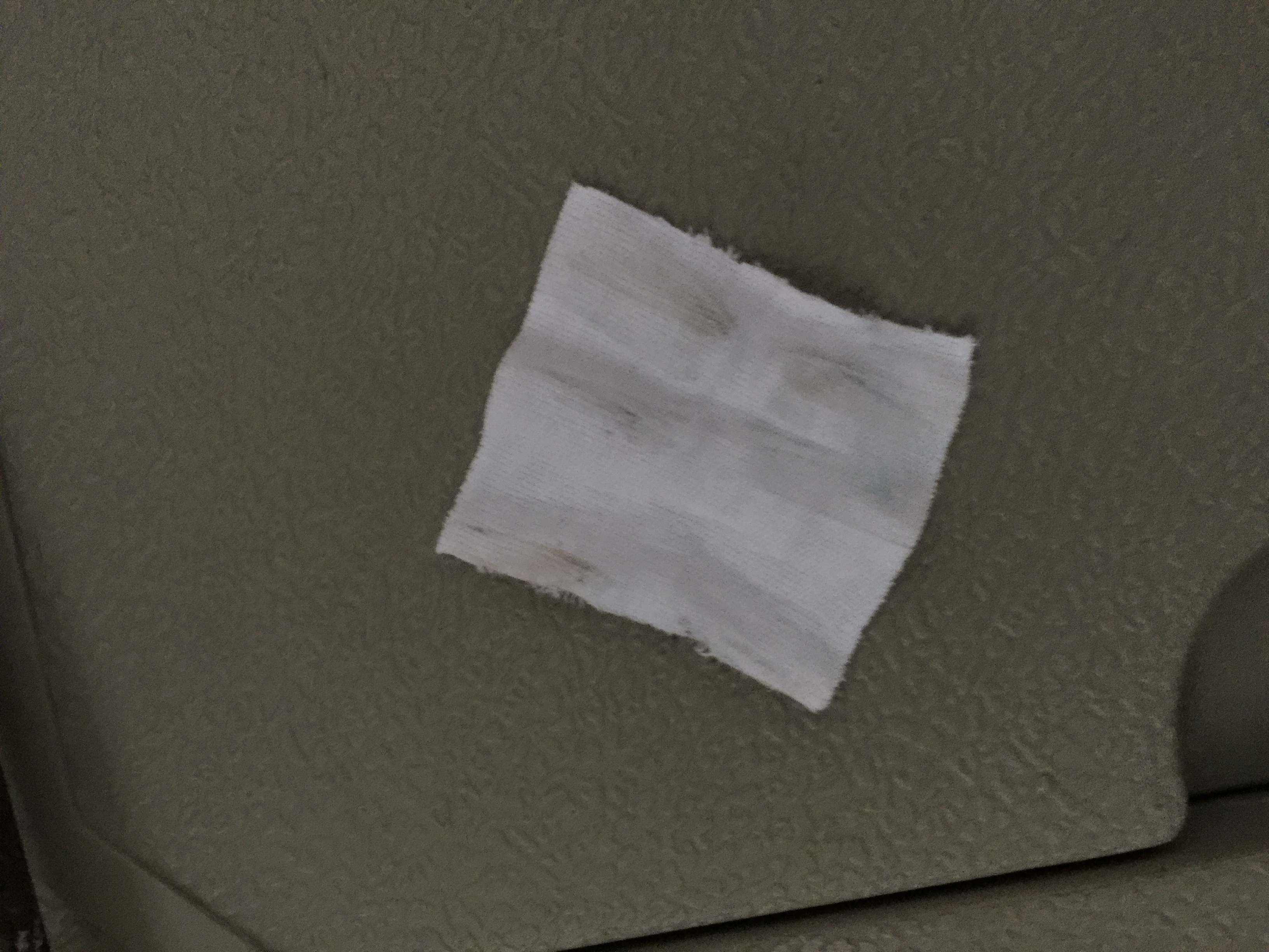

I then soaked 3 patches in sweets copper remover and saturated barrel, then soaked a nylon brush in same and scrubbed back and forth maybe 20 times then wet patches again and left for 45 mins.
Below is 2 patches that came out...1st one light tinge, 2nd one - almost clean...but streaks are still exactly as they were....what the actual...F.

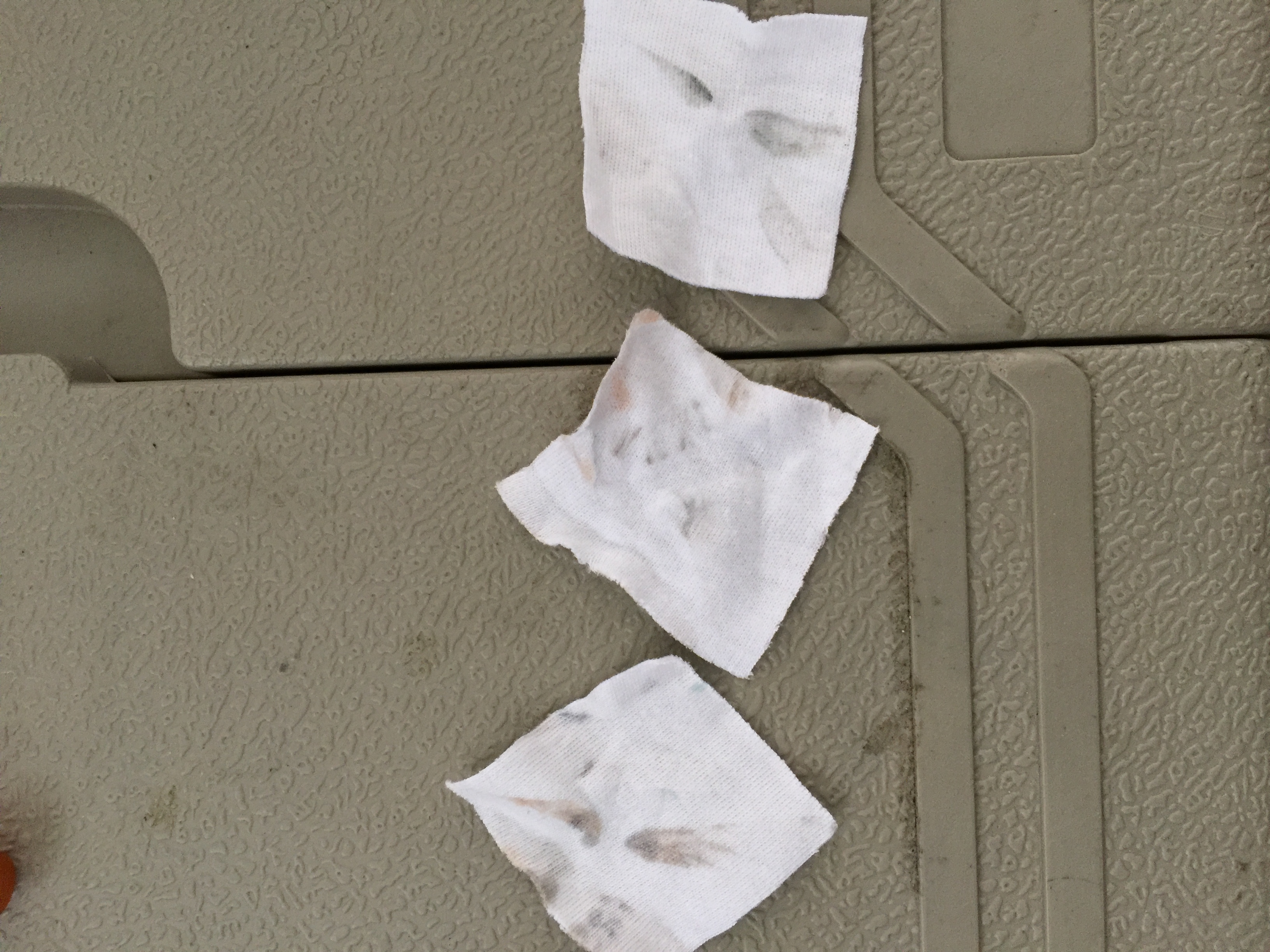

Last night, after using boretech carbon - I syringed 10mls of hoppes no9 into barrel and then about 5 wet patches to soak. I tilted rifle on an angle, blocked the nozzle with a piece of a mop brush...and left it.
12 hours later...
The first 3 patches are as per this pic...no blue, hardly any carbon, almost white.

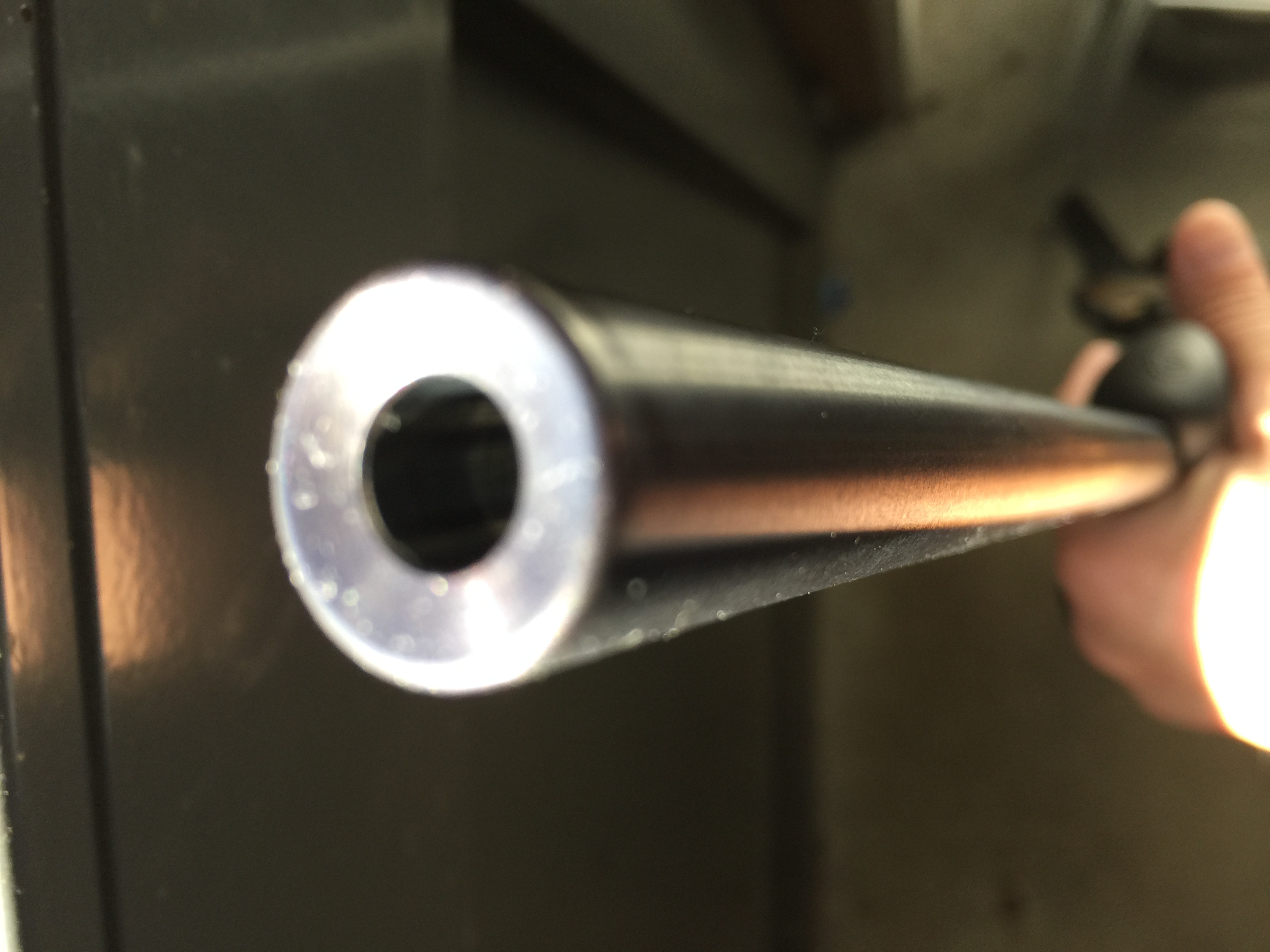

So then, I took rifle to window and FMD and knock me over with a feather.
ALL - I mean ALL of the copper is gone as per pics...
I am one very bloody confused Tiger...if someone from the forum took pity on me, flew down and broke in, cleaned rifle for me - say hello next time ya radgie.
This makes zero sense...but...it’s clean. I’ve tried 4 different solvents, various practices and the one cleaner that is known to be less than mild ends up removing the cu, with no scrubbing, no patching...wtf...where has it gone? It can’t dissolve to nothing...
I’ll now monitor next shooting and as soon as streaks appear, I’ll stop - and take on MMS advice re autosol...but kinda hoping this insane cleaning practice has knocked down a few bumps.

Post by GQshayne » 23 Feb 2020, 7:41 pm
The obvious answer it that it has not cleaned itself - you have cleaned it.
Act of God maybe? :unknown:

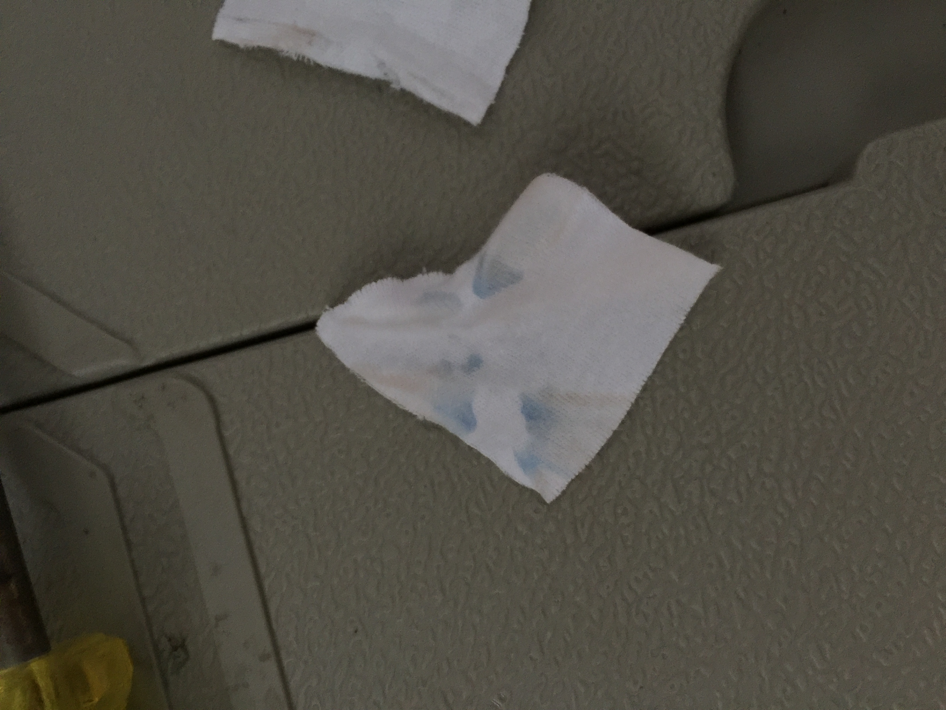

When I planned to leave some solvent in for a night, it was always going to be the known weakest solvent I had.
When the hoppes no 9 went in - there were streaks like this. (Note - I’ve never managed to get any copper out with hoppes from another rifle - sweets, belcey and chambers - yes)...no one I know, rates hoppes no 9 as a solvent...no one personally, no one on the board.
I am wondering if the boretech carbon cleaner didn’t clean out an invisible to naked eye covering over the copper, that allowed solvent to finally attack...I don’t guttenheimen know. It’s strange and weird but it’s done,
