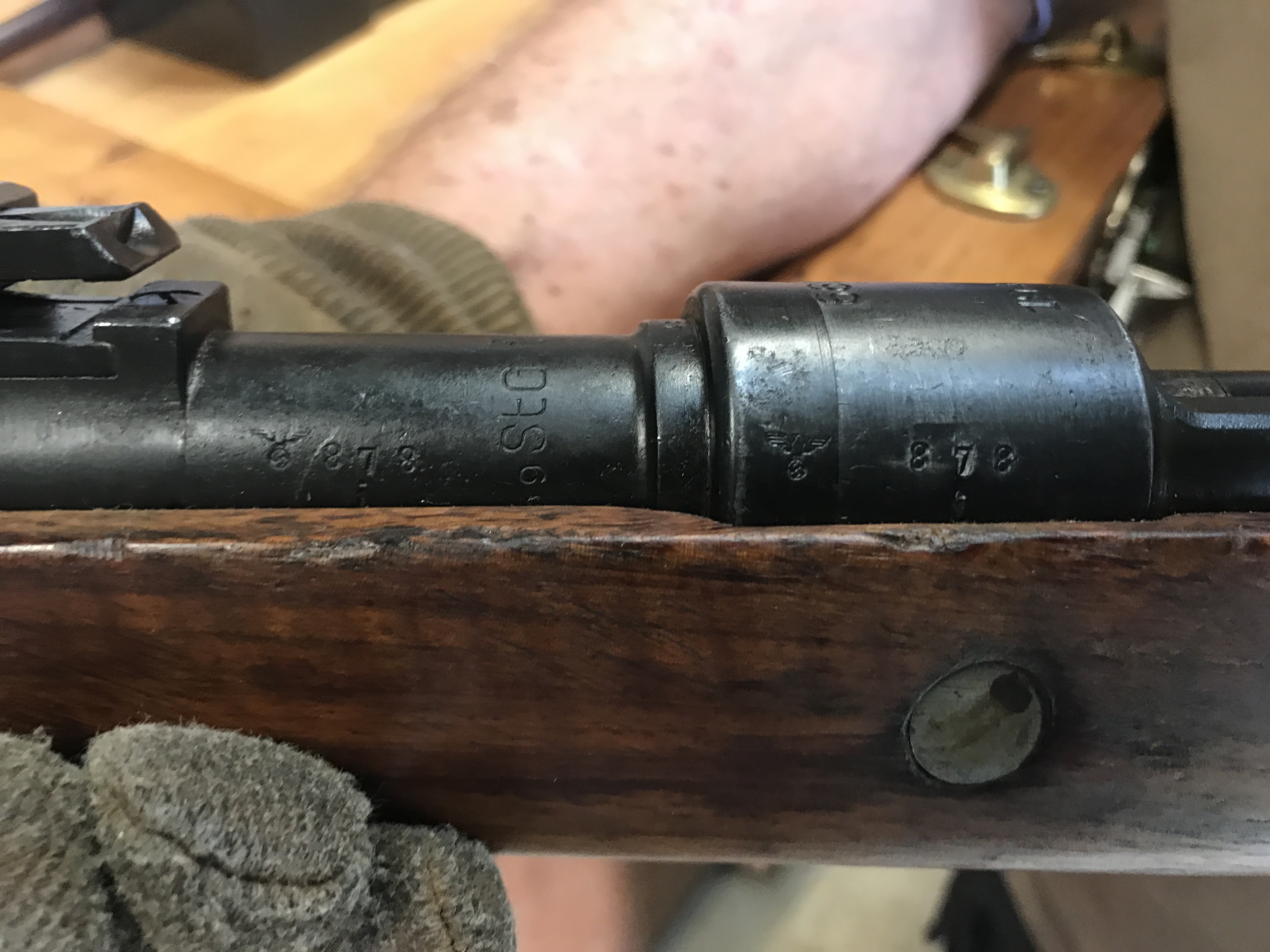

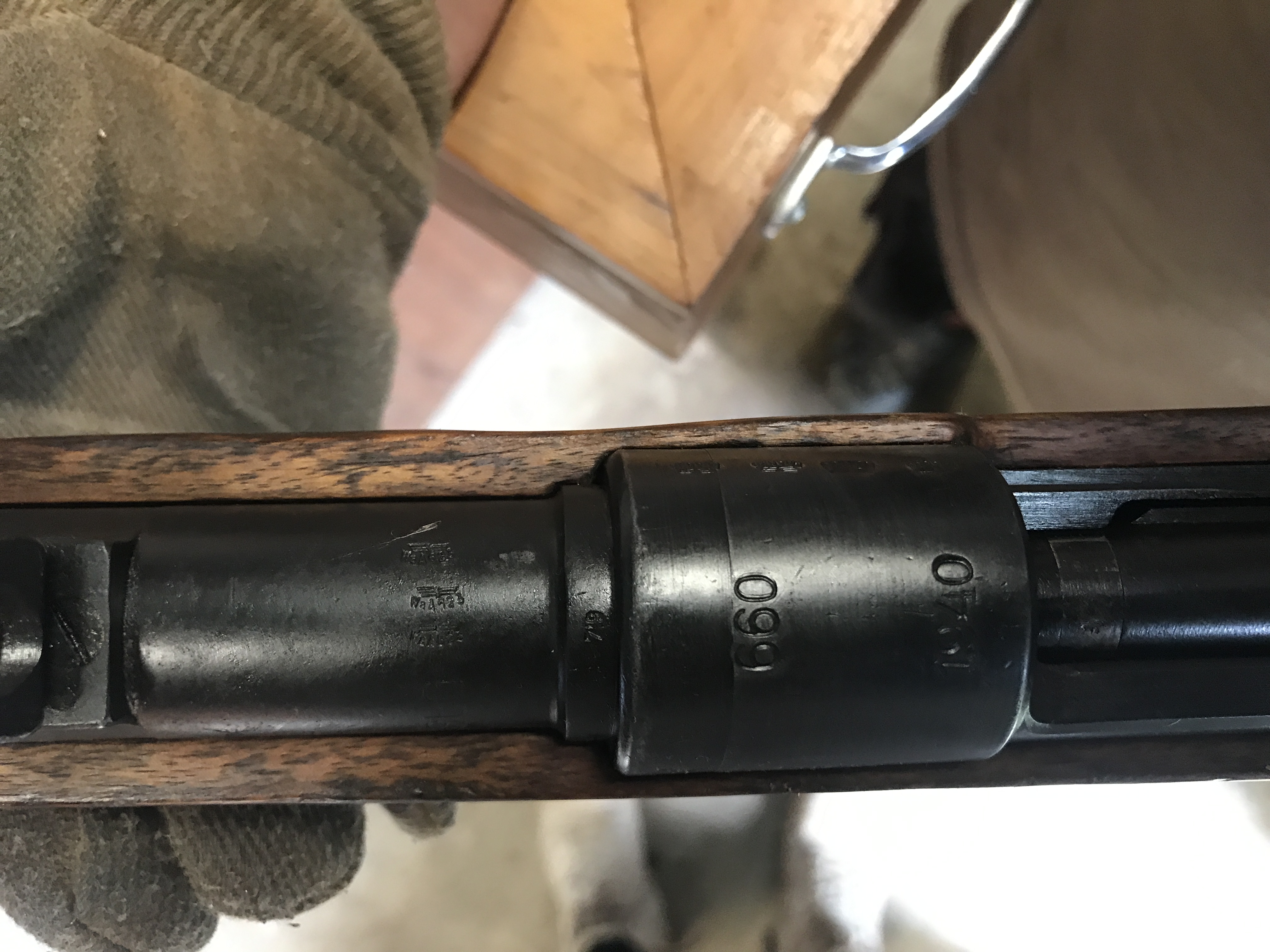

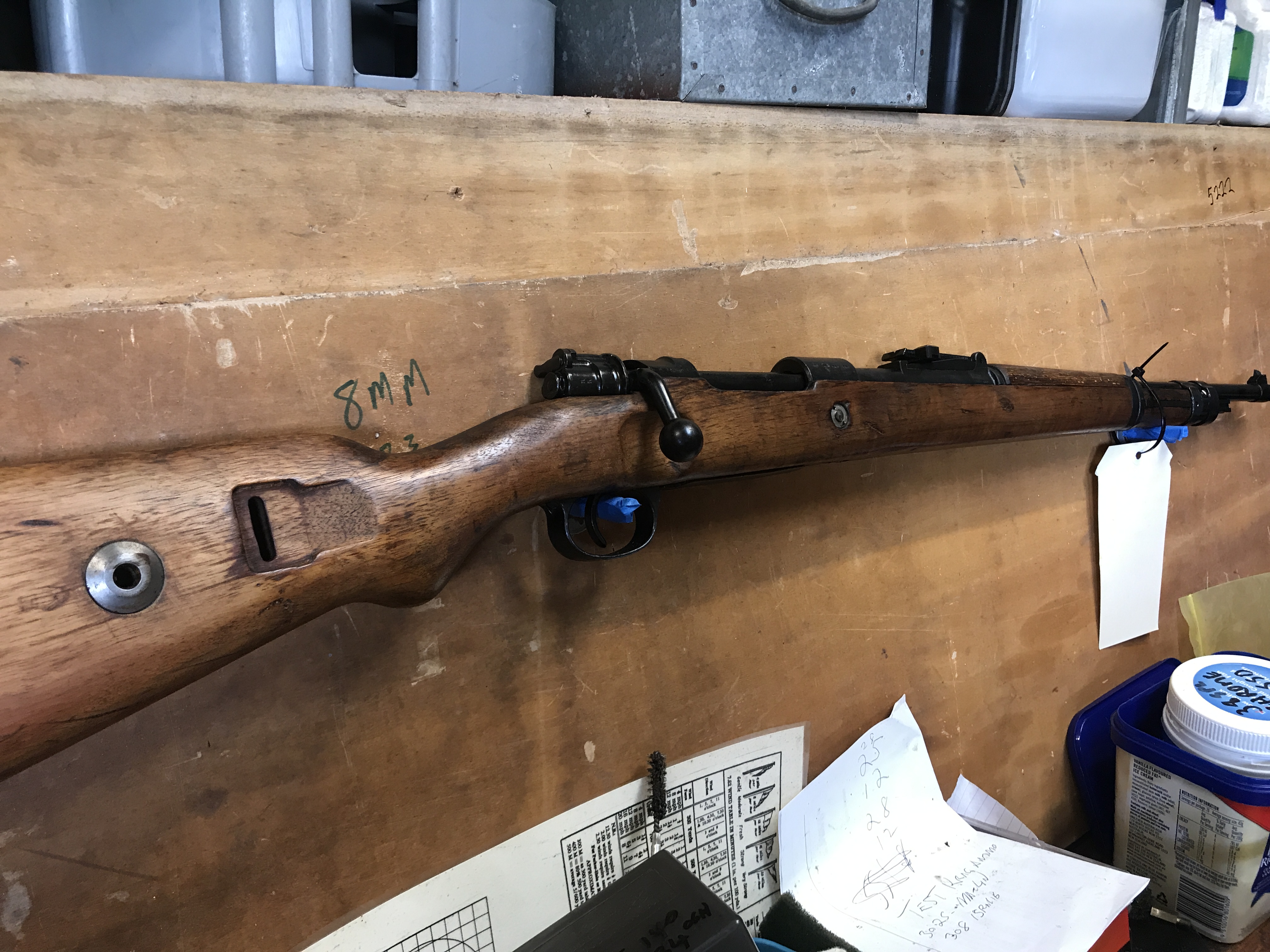

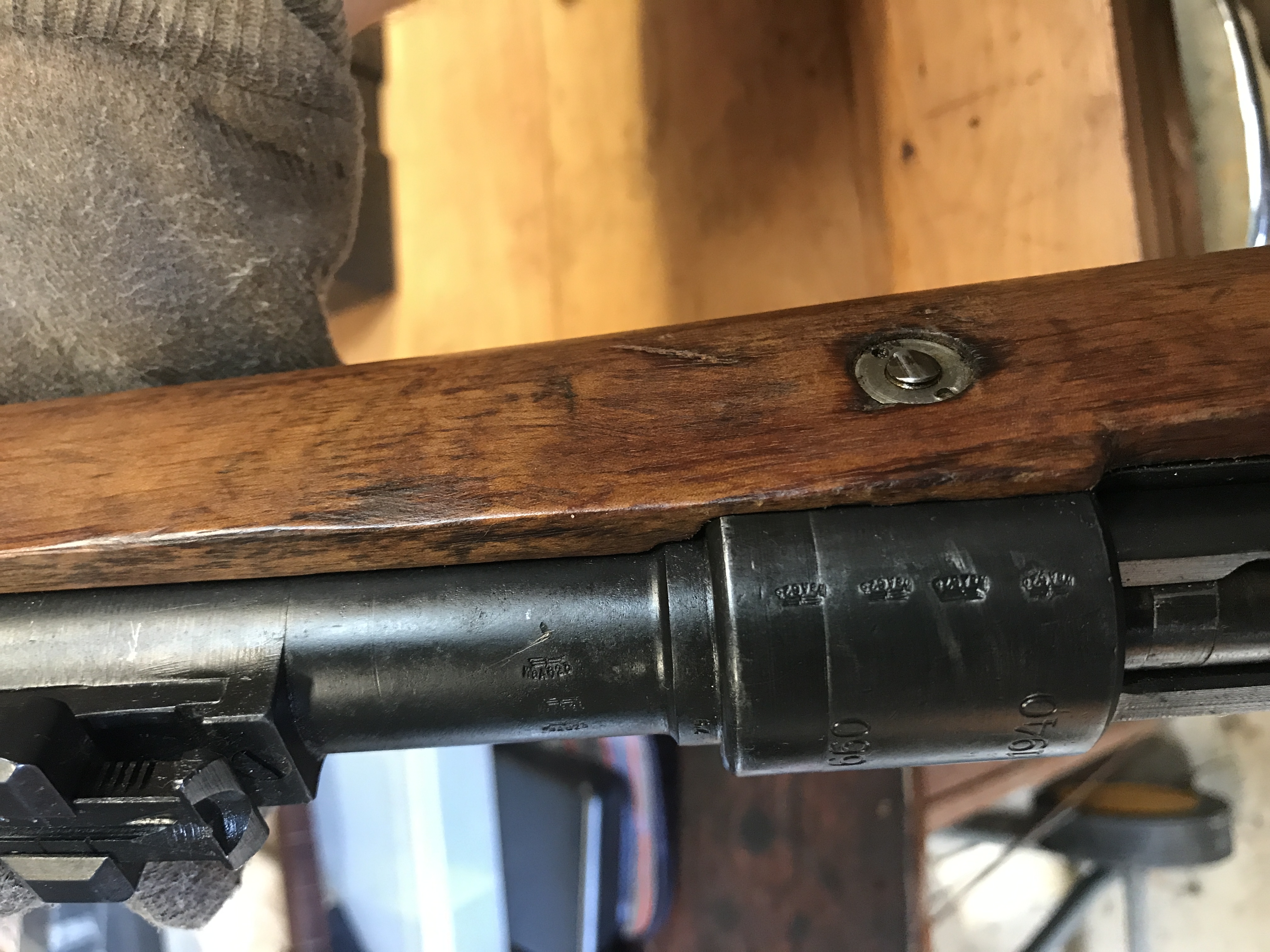

Hi guys,
First time posting please go easy on me. Just thought I’d show you all some markings from a rifle I recently purchased and grab some opinions on what you think it’s worth.
The rifle is a 1940 stamped german kar98k. It bears the receiver code 660 indicating it was produced in the Steyr factory in Austria. The numbers match up and the rifle has all the original nazi markings as it has not been refurbished or captured. The bore is in good shootable condition.
Let me know what you guys think,
Much appreciated
- J

Post by No1Mk3 » 04 Mar 2020, 6:38 pm
G'day Jmorro,
Nice Mauser, matching numbers would bring a premium, but I would lay odds it has been re-blued in some areas. The bolt handle for example is too "new" for the age and condition of the stock etc. But otherwise a very collectible piece. On a good day it is $1500 + but on a great day it would pass $2000 to someone who wanted a matching 660, In the right place at the right time you could pay a $1000 or so, just as an example the last K98k I bought was a "147, 1940" for $600 2 years ago, but I thought it well undervalued, Cheers.

Post by wrenchman » 05 Mar 2020, 2:13 am
as no1mk3 said it looks like its touched up blue if all numbers match and it has not been altered in any way you still have a gun that has good value they are getting hard to find they can still be found but its a collectors firearm.
I would still shoot it just have the head space checked many were brought back and chopped up and turned into hunting guns.

Post by straightshooter » 05 Mar 2020, 6:42 am
The 660 means the receiver was from Radom in Poland and reprocessed at Steyr. The usual practice was to put a line through the Polish WZ29 designation on the left rail and restamp with the German model identification.
Radom receivers had an overhang at the front for retaining the upper handguard and the slight step in the front receiver ring is evidence of where it was turned off in the factory.
The 1940 date is as far as I know inconsistent with when all in process production and equipment was removed from Radom and moved to Steyr.
The area around the serial number looks suspicious as do the unusually large number of other stamps. The original Radom serial number would have been a letter and 5 digits.
A picture of the left receiver rail would help with further identification.

G'day straightshooter,
660 was the dispersion code for Steyr, and was applied to those rifles made by them at that time including both M29 reworks to G29o as well as Radom G29/40 receivers. Steyr had been making these rifles on their own machinery from 1939, and Radom receivers are known bearing that date, but no earlier of course, just as G29o receivers are no later than 1939. Jmorros' rifle may be a Radom G29/40 and if so will bemarked on the side rail as such, but it may be a completely German rifle, and will carry no markings as Steyr did not mark the siderails of their K98k until 1941, Cheers.
Posts: 2333
