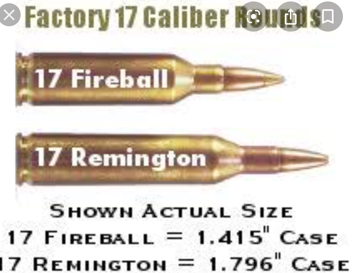

Post by flutch » 17 Mar 2020, 7:34 pm
Anyone got any experience with the 17 Remington? Not the fireball.
Previous thread had me looking, is there any advantage to these? How do the .17 pills travel at those speeds etc

Re: 17 rem
Post by bladeracer » 17 Mar 2020, 7:56 pm
flutch wrote:Anyone got any experience with the 17 Remington? Not the fireball.
Not myself, but 35 years ago I knew a pair of fox shooters with a .17Rem, that thing was a laser alongside my .222Rem.
That experience was why I just had to get the .204 this time around :-)

Post by TassieTiger » 18 Mar 2020, 8:28 pm
This means absolutely nothing...but It just doesn’t look right...like a v8 in a fuken mini.
