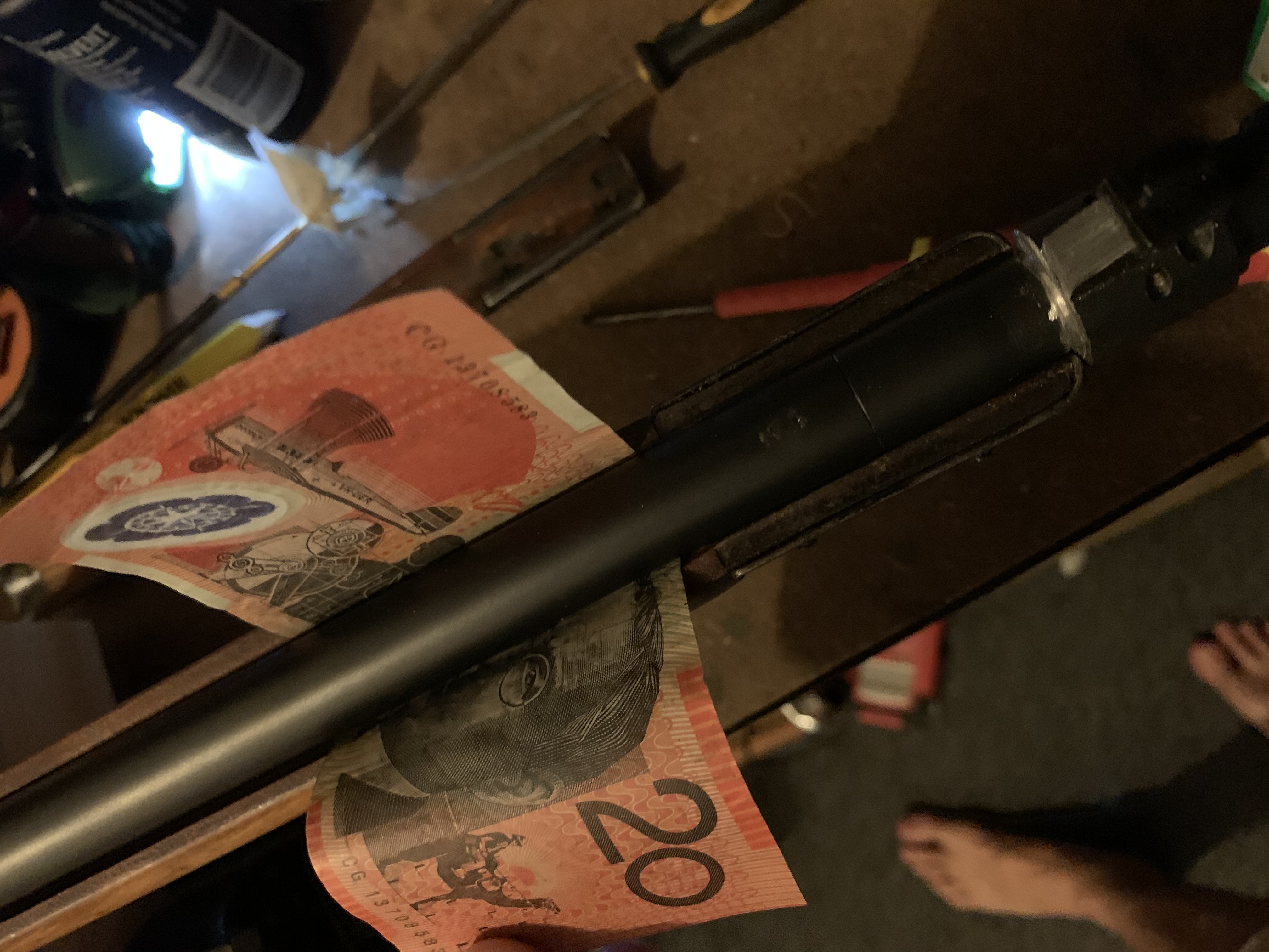

Compared with the older SMLEs, No4s generally differ in their bedding by free floating along the length of the barrel with a short downward (only) pressure bed at the end of the forend.

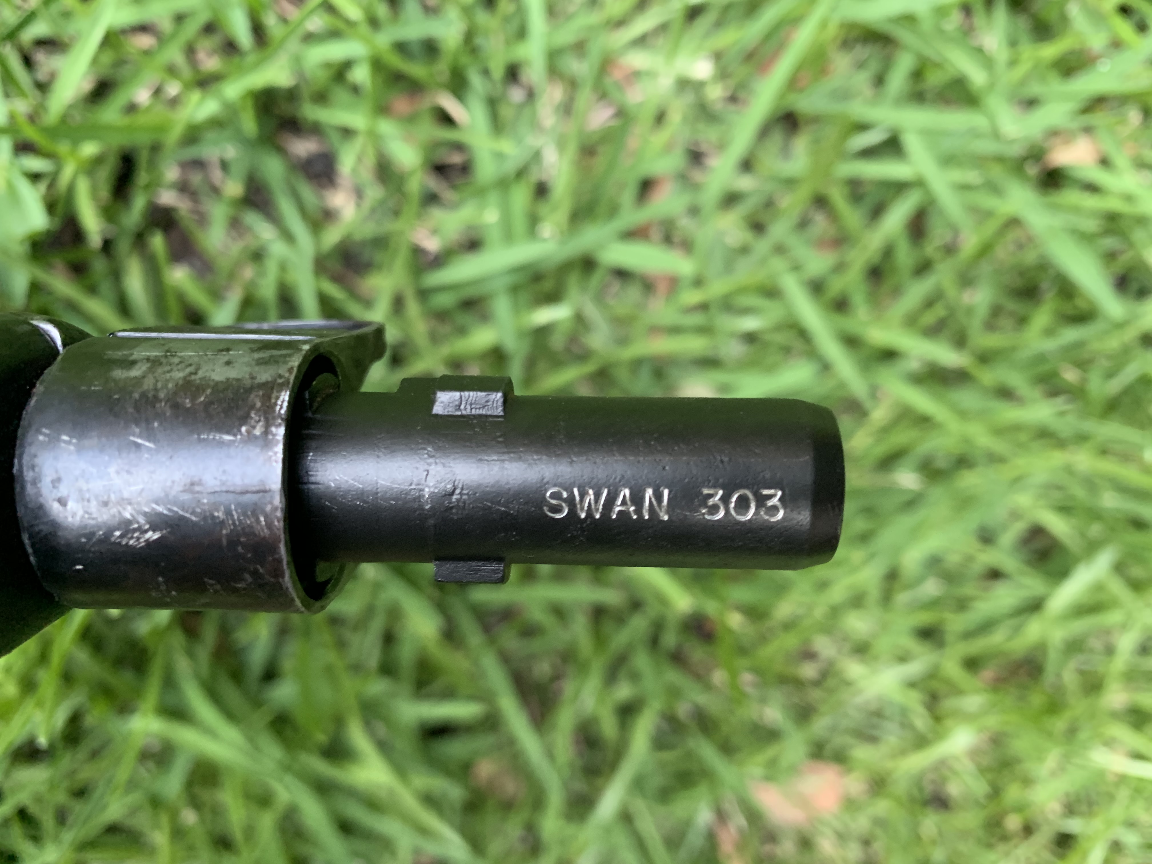

A while back I picked up a nice old No4 which had just come back from Allan Swan; surpisingly the front sight was spliced up tight against the forend. Like a lever action, as it was, the gun could shoot a tight cold bore group, but as the barrel heated, the POI wandered rather dramatically. This needed fixing; Service Rifle often demands 30+ shots in a short period. The barrels become hot.
Allan Swan

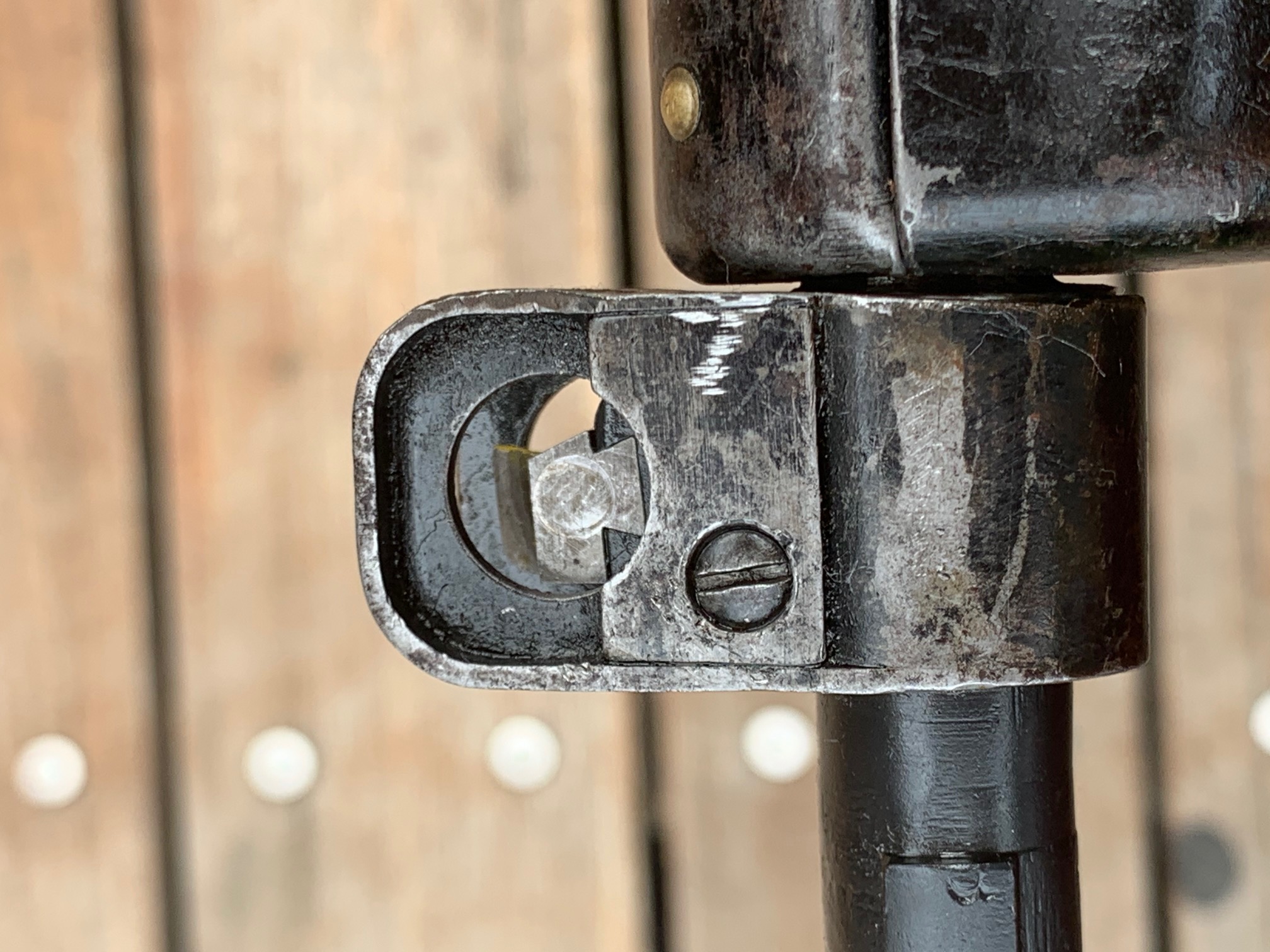

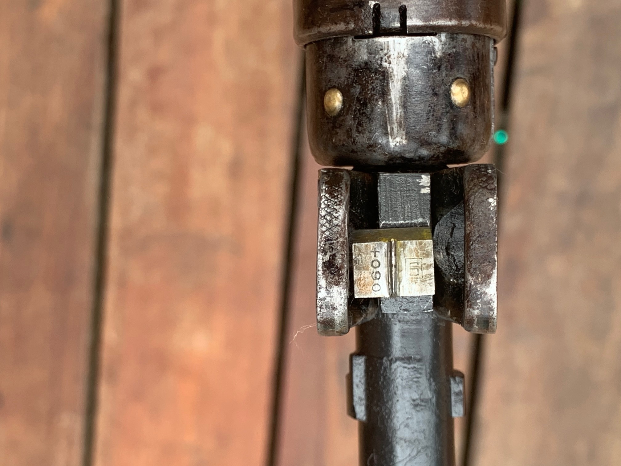

So I dug out the Dremmel and relieved the tight contact between the front sight and forend. I then cold blued the area, making the changes almost undetectable once reassembled.
Correcting the bedding, see where I've ground it to relieve the front sight.
No more contact between forend and front sight
Now the barrel can flex left/right/up, indicating the bedding is as it should be. If I'm doing my part the gun will now hold a long, consistent group, even as it heats.

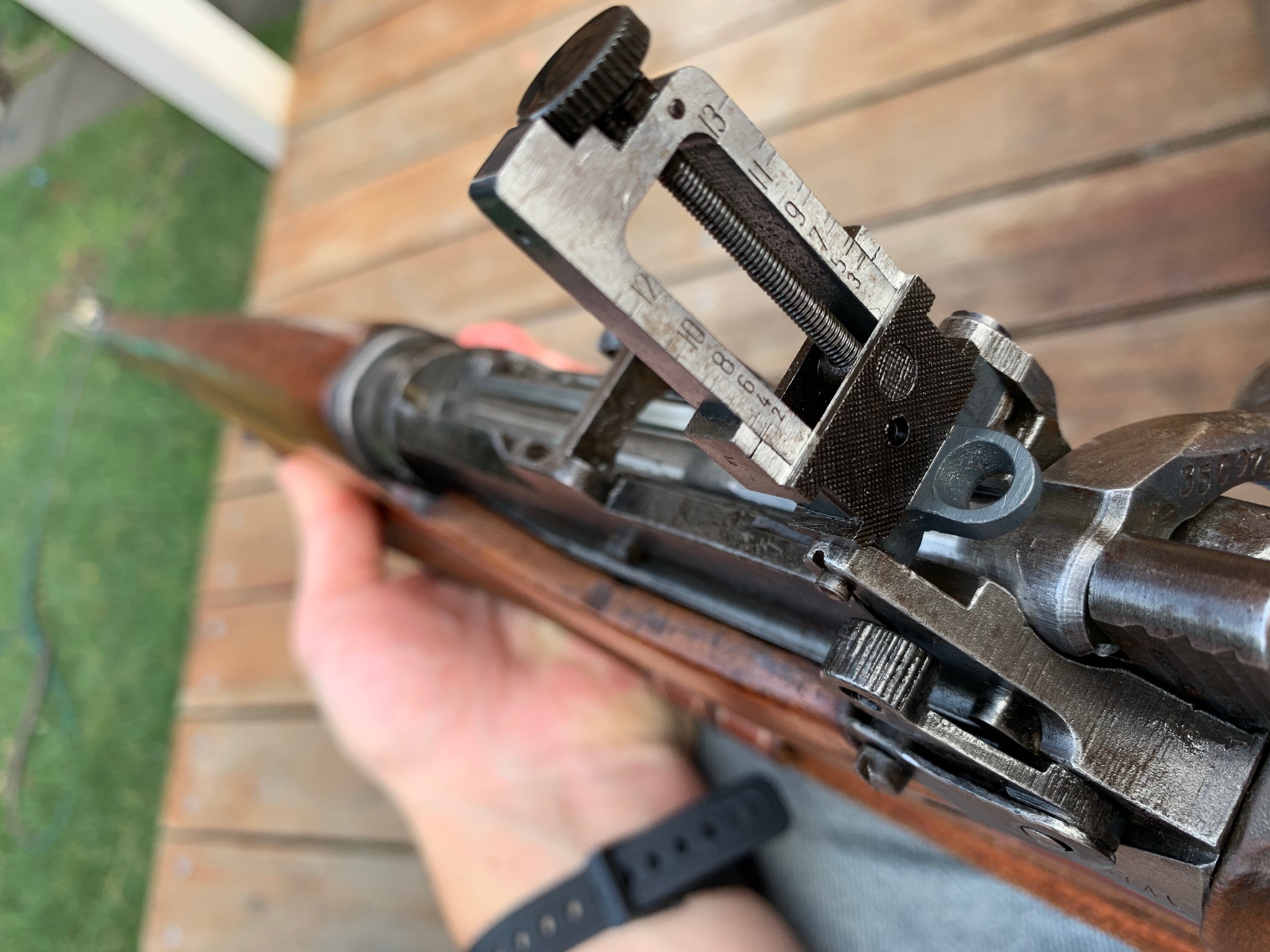

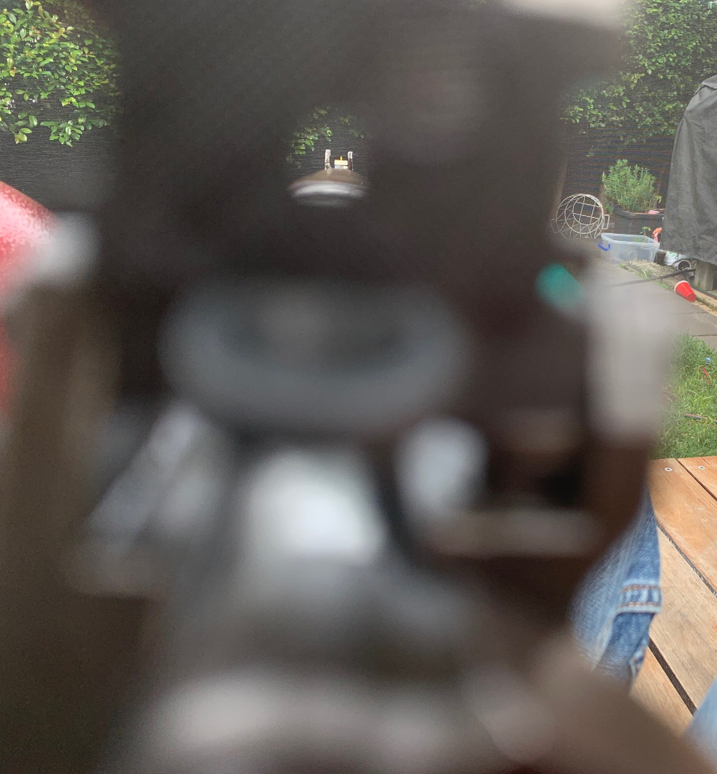

Wihout a rear mounted arpeture sight, you are really up against it. To optimise precision, one way or another, you need to be running a peep sight. The SMLEs can be adapted to take a central sight. Peep sights are essential for consistency.
A rear peep sight is an absolute must

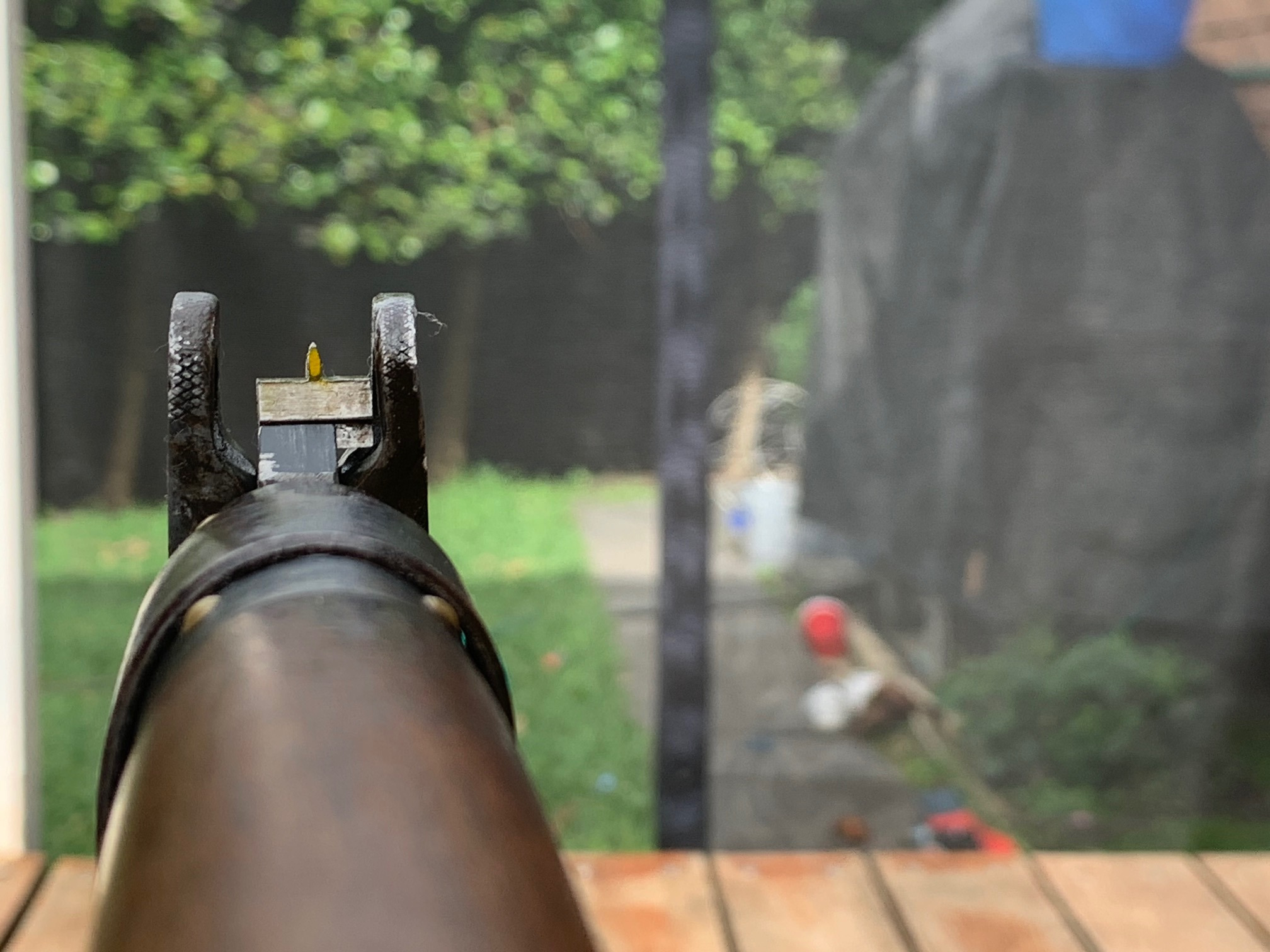

I'm still blessed with sharp eyesight, so filing the front sight from a square to a blade helps me achieve more precise windage. Meanwhile a six o'clock hold gives me more precise elevation.
A dab of yellow or white paint on the front sight helps contrast against the black targets. This only works for a front sight with an open top - the sun needs to get to it to bring out the colour.
File to a blade and paint it
See how the yellow pops out?

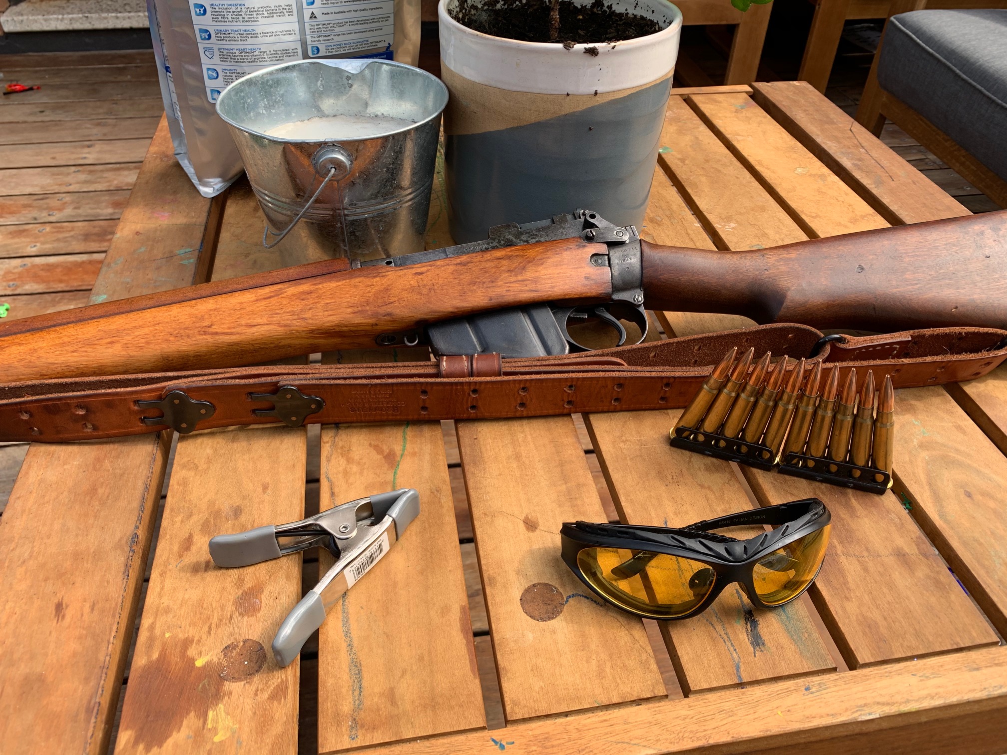

Yellow tinted glasses also makes the yellows/whites pop, helping with sight picture.
Essential kit

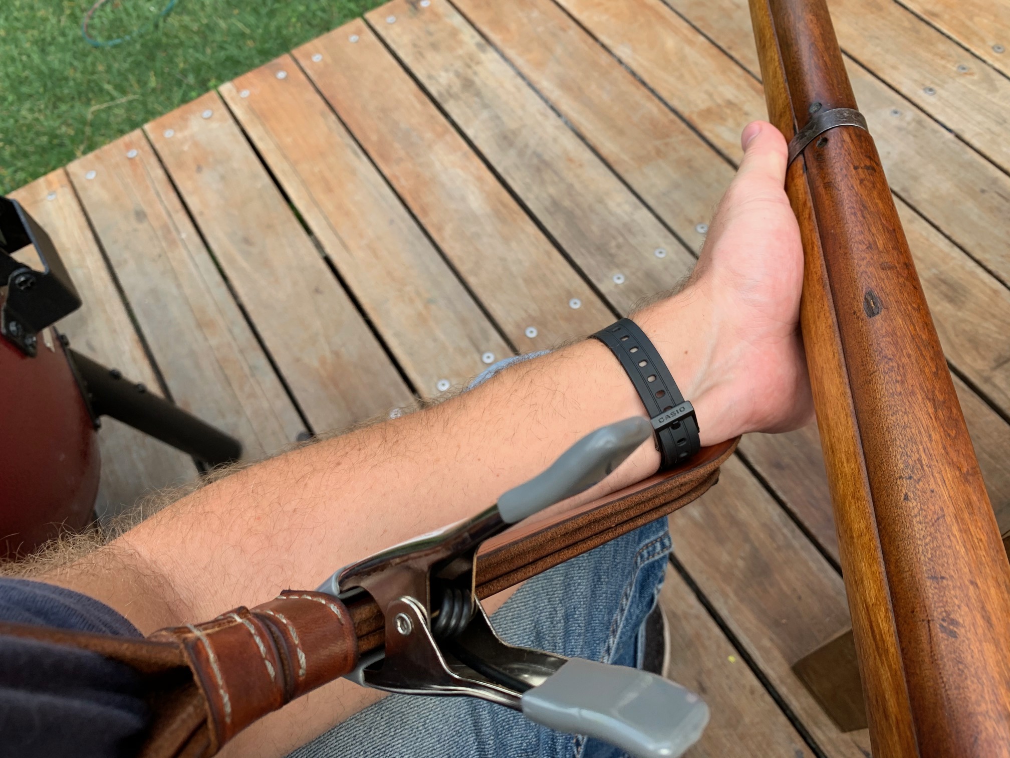

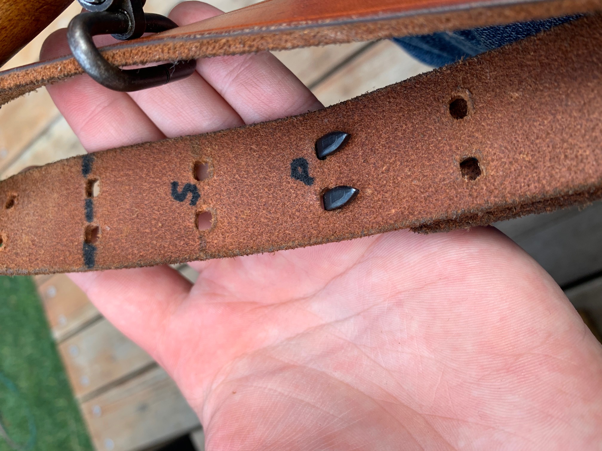

On the subject of slings, I use an m1907 sling from Brownells America - a great sling, but has a bit of a tendancy to slip, so I use a heavy metal peg to keep it tight on my bicep.
I peg my sling to stop slippage
I also have markings on my the sling for the 3-ps, standing, Sitting, Prone
I mark my sling - keeps things simple
