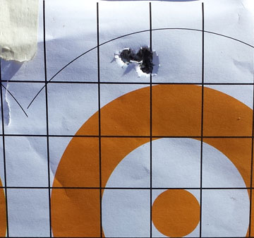

Headspace, this is the first 4 shots ever out of my Tikka that I picked up a month or so ago.
Tikka 7mm-08 group.
I gave the rifle a very thorough clean out of the box, shot that group, did a few clicks and another pair of groups and was straight into the forest after deer. 10 bullets and I was off hunting.
Like Norton said, other would say I should sit at the range for hours feeding single bullets and cleaning patches through
Why the hell would I waste a day of my life and $200 worth of ammo when it shoots like that out of the box?
Do with that information as you will ;)
