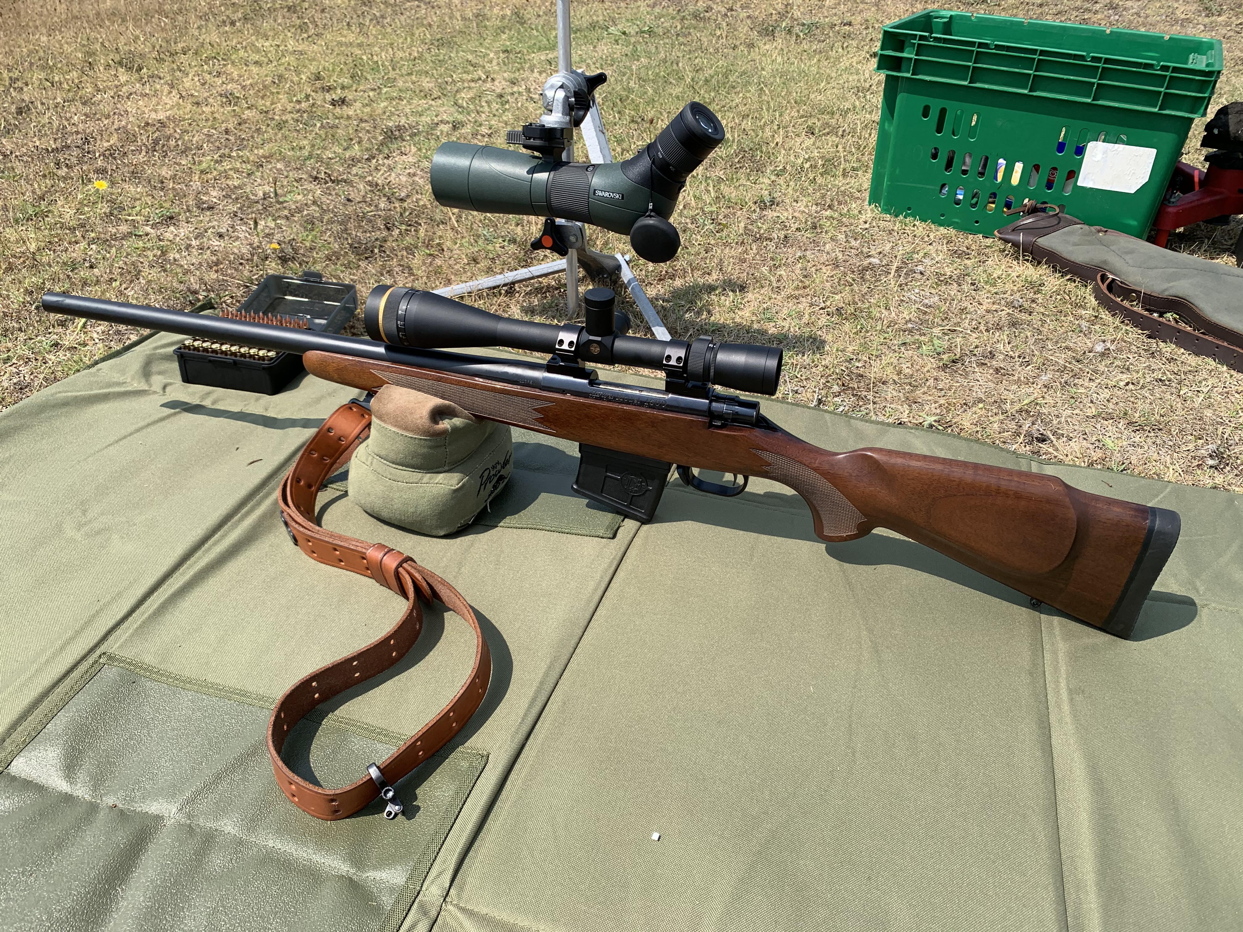

Hi mikejay - not so long ago I built a custom 223 using an old Howa walnut donor, (an old shot-out 204). It received a 1:9 heavy varmint barrel (cut to 22") and bedding job. The old Howa walnut is suprisingly heavy, but wide and dense, which was perfect for a thicker barrel contour.
I also swapped the trigger (for target shooting). I like a crisp single stage (which the howa trigger is not). Initially I tried a Jard trigger, but I was far too light for field positional. I experimented with a variety of springs which brought it back up into an acceptable region, but it still wasn’t super crisp. Ultimately I swapped the Jard for a Timney, and haven’t looked back. I also added the Lucky 13 conversion kit, because 10-shot mags are a must for the rapid and snap details. Feeds beautifully.
Without exaggerating, the gun is capable of grouping pretty much anything I feed it into 1/2-3/4 moa consistently, which is better than what I can do from the sling. I generally stick to the 69gr SMKs, out to 400m with great success.
It's a heavy thing - certainly not a carry gun - but just right for its application on the mound :thumbsup:
I looked at Remington donors but that are not better than Howas, and they are much pricier.
Custom Howa 223 target build
