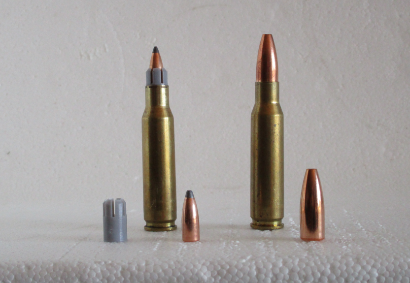

Post by wildcard6 » 04 May 2020, 3:51 pm
I'm still at the thinking stage, but one thing that's occurred to me is that using lighter bullets will require less velocity than heavy [and thus longer] bullets. I've put ten 61-grain FMJ bullets into sabots already, but I'm going to have a fossick among my bits'n'pieces to see what 40-grainers I have, because they won't need to be fired at insane speeds to stabilise them. .22 long rifle bullets stabilise at 750 fps [refer CCI Quite-.22's], so I might be able to test first with Trail Boss after all!

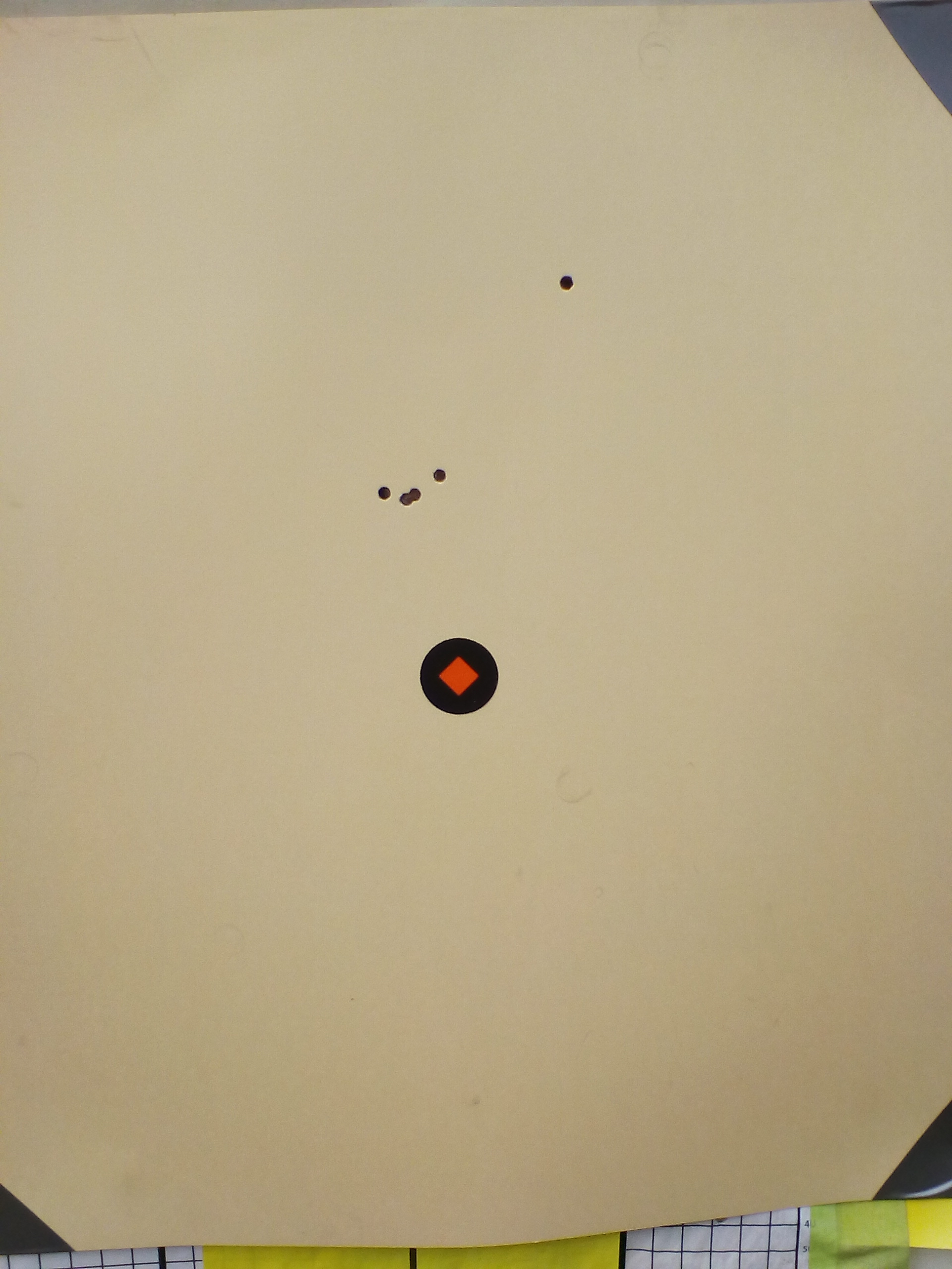

Post by wildcard6 » 14 May 2020, 8:50 pm
I finally got the chance to test three loads today. The 12 grains load of Trail Boss behind 50-grain SHOTS were no good at all. Only one bullet hot the [large] target at 50 meters. 14 grains did better, with four shots hitting the target, but still, no real accuracy of note. When I tried the 38 grains of AR 2205, things really got loud! Because I had no idea where on the target I was going to hit, I just fired at open space. I then fired at that bullet hole for the next four shots. Those four shots went 1.75" [at 50 m]. It seems clear that a stiff load of something fast-burning is the best plan, but I don't know how much more '05 is safe. I'll try 39-grains next. I'm worried that using fast burning powders could cause a sudden pressure spike, so I'll be proceeding with caution. At this stage though, the primers are not showing any signs of flattening.

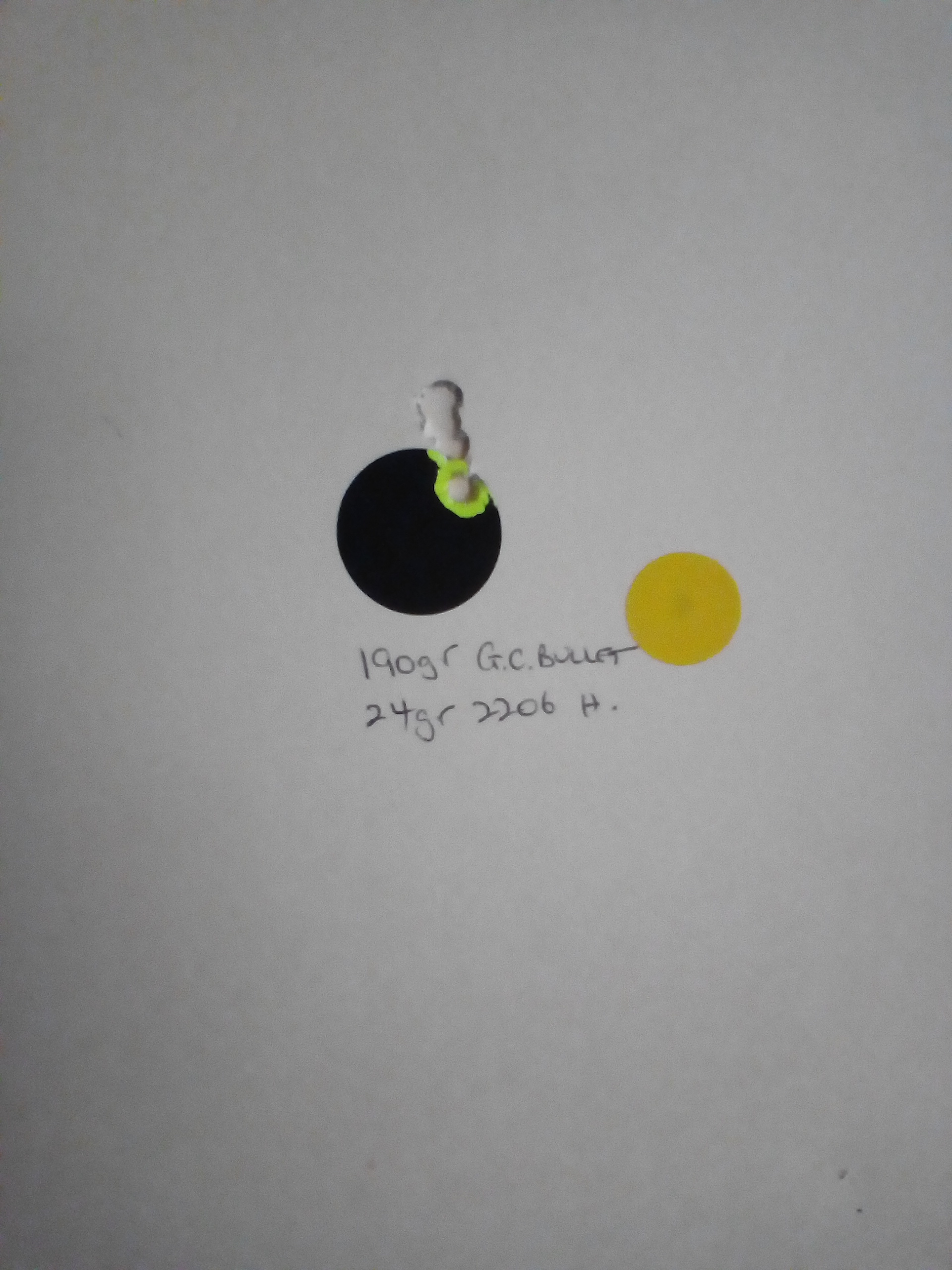

Post by wildcard6 » 15 May 2020, 11:28 am
I agree that accuracy is better with cast lead bullets. After I tested the three sabot loads I tested a couple of cast lead loads and at the same range [50 m], 190 grain gas-checked bullets were shooting .75" with 24 grains of AR2206H [pictured]. No doubt I can improve on that with seating depth and powder charge tweaking, but it is plenty as-is for 200 m Ram silhouette shooting in the condensed version of centrefire metallic silhouette we shoot at my local gun club.

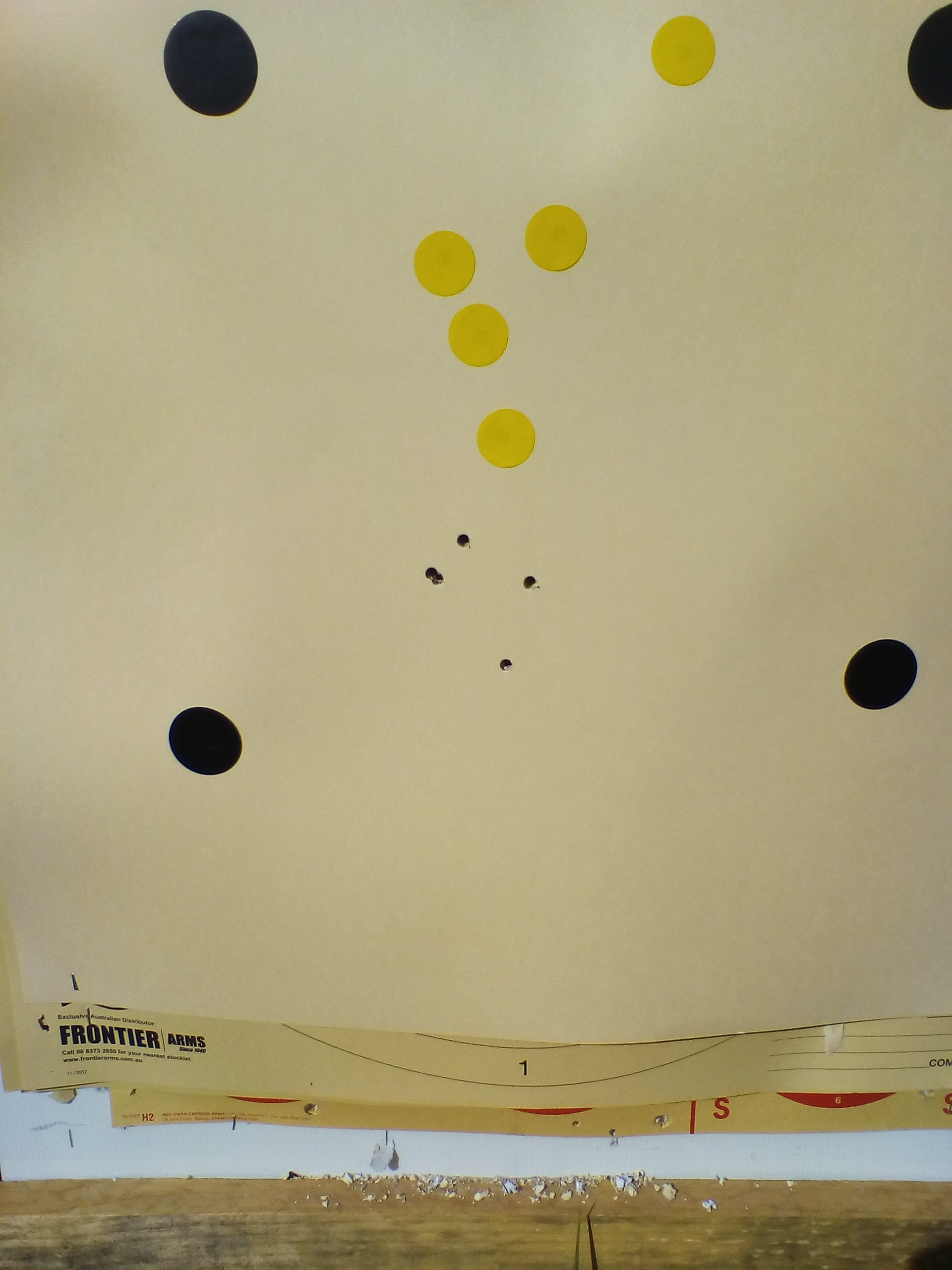

Post by wildcard6 » 22 May 2020, 11:48 am
Latest experiment results. Using 5--grain Nosler SHOTS bullets and 39 grains of AR2205 powder. Seating depth .25". Shooting at 50 meters. Three shots grouped into .5", four shots went 1", but the fifth shot blew the group out to 4.5". I thought I was onto something until that last shot! I found two of the discarded sabots about 8 meters in front of the firing line. My guess is that the one shot that blew the group so badly might not have been concentrically placed in the sabot. I'm using the 'tool' supplied for seating the bullets in the sabots, but can't see any way to control how the bullets are seated. Next time I'll try 52-grain Sierra Match King bullets to see if they improve things at all.

Post by Oldbloke » 22 May 2020, 1:39 pm
I'd try that load again.
Dodgy sabot perhaps?
